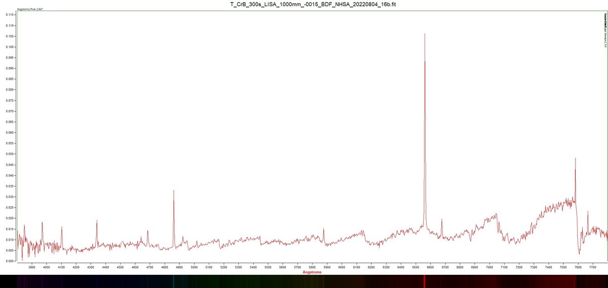

Had a more or less clear night and here another T CrB spectrum.
https://rainerehlert.com/000_Spectra/T_ ... 16b_1D.fit

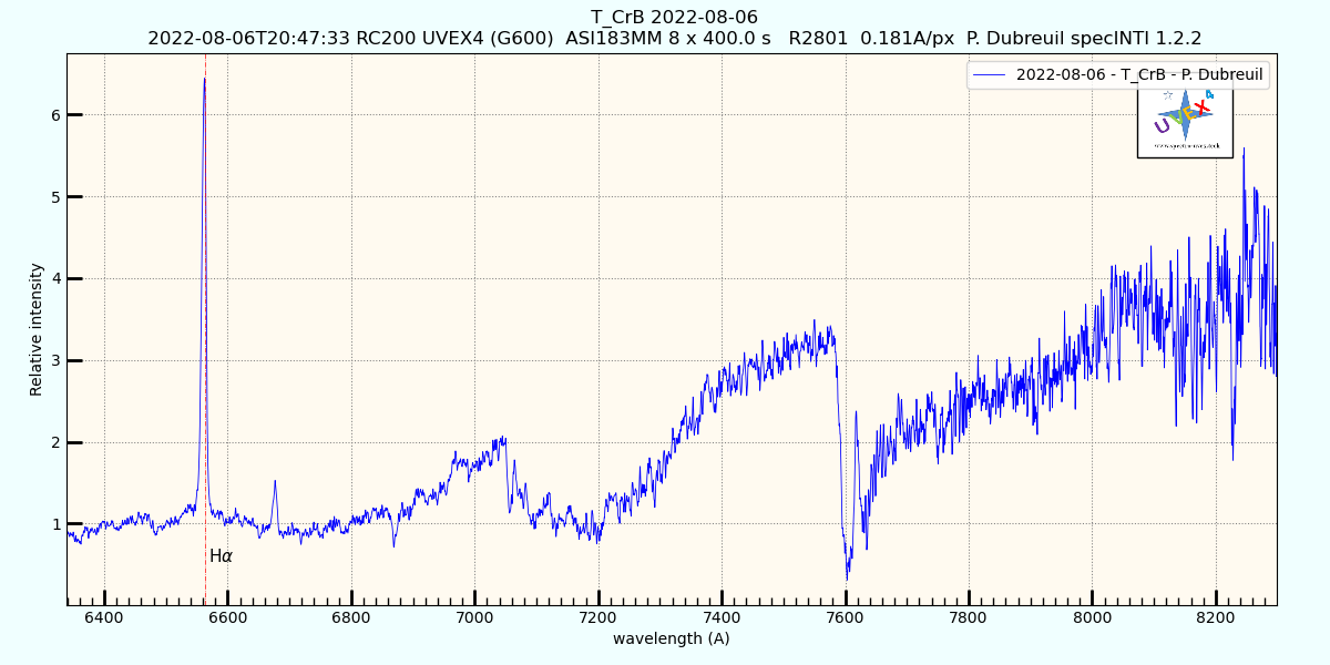

T Crb hier soir, proche IR
UVEX4 G600-750nm, slit 15µ
Spectre T_CrB 6339 to 8299.png (128.02 KiB) Viewed 8214 times
Pas vraiment d'évolution pour l'instant.

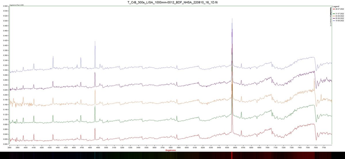

Yesterday night eg. today morning UTC time I imaged T CrB. See below the comparison of 5 spectra from 26-07 to 10-08 and I ahve the impression teh emission lines 4640 and 4684 are stronger or is it just my imagination ?
Thanks for looking
Re: Call for observations of the preoutburst phase of T CrB
Hi Rainer,
Interesting.
But the height of a line is a very poor measure as it depends significantly of the resolution at that wavelength.
The measure of the equivalent width (EW) will provide more accurate measures.
I suggest using plot spectra (Tim Lester), a very nice tool.
http://spectro-aras.com/forum/viewtopic.php?f=51&t=2820
Keep us informed!
And , as the level of the continuum is almost the same between H beta and He II, the ratio of the EW HeII/Hb provides useful information about the temperature of the hot source.
Rainer Ehlert
Posts: 135
Post by Rainer Ehlert »
Francois Teyssier wrote:Hi Rainer,
Interesting.
Keep us informed!
Hi Francois,
Thanks and I downloaded it yesterday and now I just need to understand the program and how to use it.
I was able to shoot another hour of T CrB yesterday night. Will see how it compares to August 10th ;)
Rainer
