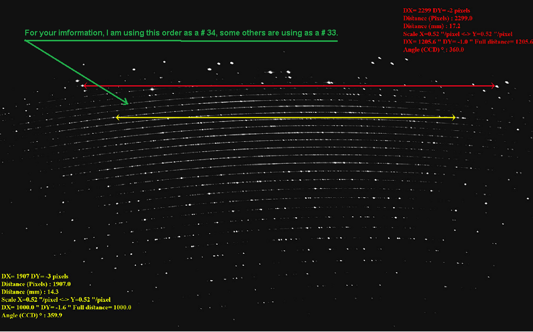

Hi James,
Sometimes when you are alone, the main problem isn't lack of self-ability but yes lack of information, I passed for this situation a lot of times.
As a complementary information I attached this picture, I've indicated two possible numerations, I don't know which of them will be better for you.
Really the Thor and Relco lamps spectra have many lines in common.
Let me know if you need anything.
Cheers, Joan.

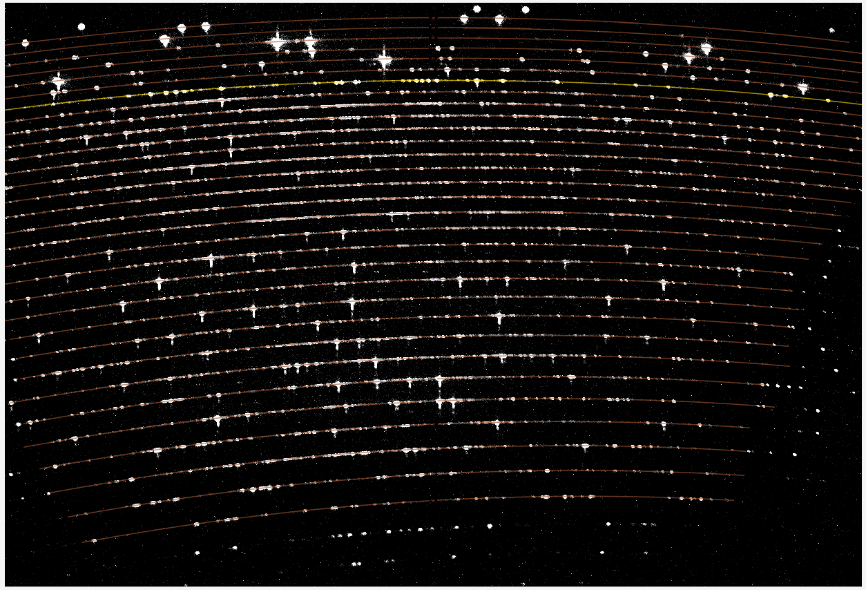

Using Francois Teyssier's 2018 post on eShel+ configuration, I was finally able to "line-up" the 3 wavelengths (6584.9A 6677.3A & 4510.7A)
to the three "circles" in check2&3 of the CamRot, ThAr, & Zone tests; see:
To get this far with my set-up (ASI6200MM Pro cmos camera and Canon 135mm F/2 lens) I had to rotate my camera so that the line connecting
the ThAr wavelength emission at 6584.9A (part of the 4-lines in Francois reference) by -2 degrees and shim the right side of the eShel with
some soda can Al skin. Note, that I manually rotated a post processed (Cmos CMED aglorithm) thor_vega image in Prism to arrive at my ideal angle;
I will have to manually rotate the ASI6200MM on the eShel to get my "ideal" -2 degrees inclination.
Here are the setting I used in the eShel set-up box:
Finally, here is the (bumpy) resolutions IsisV6.1.1 gave me for orders 29 to 58:
I probably have to improve my "slant" angles better in the def_order.LST to get more consistent resolutions.
