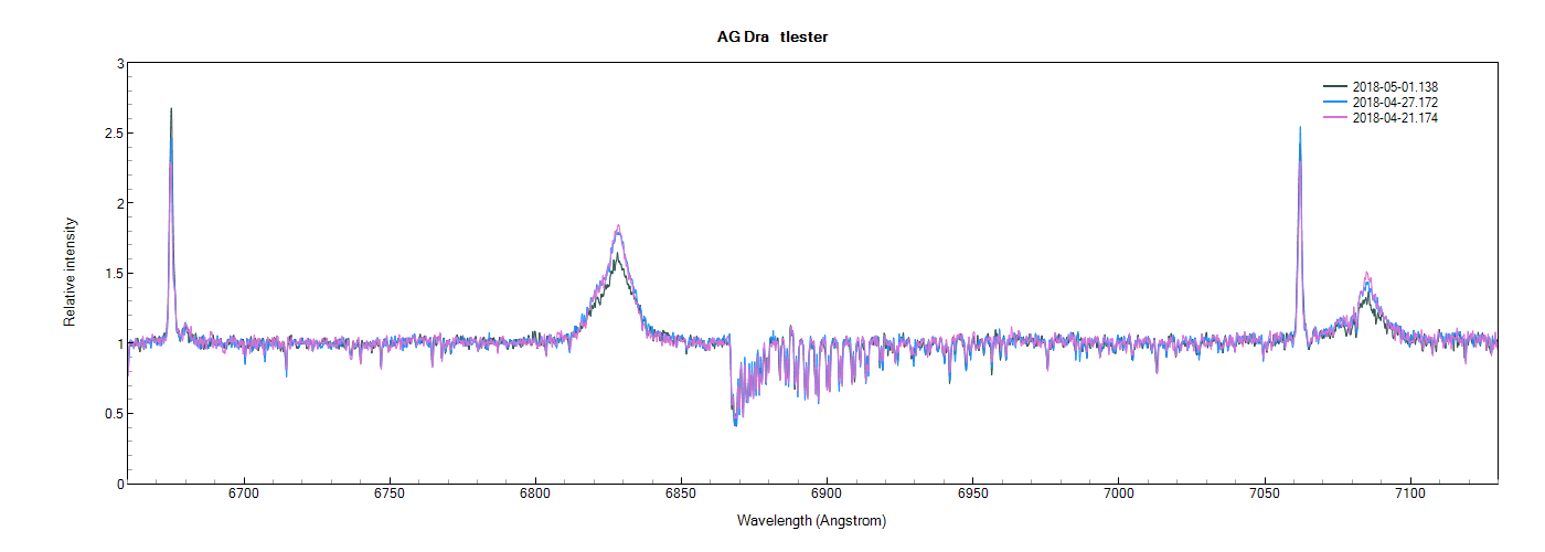

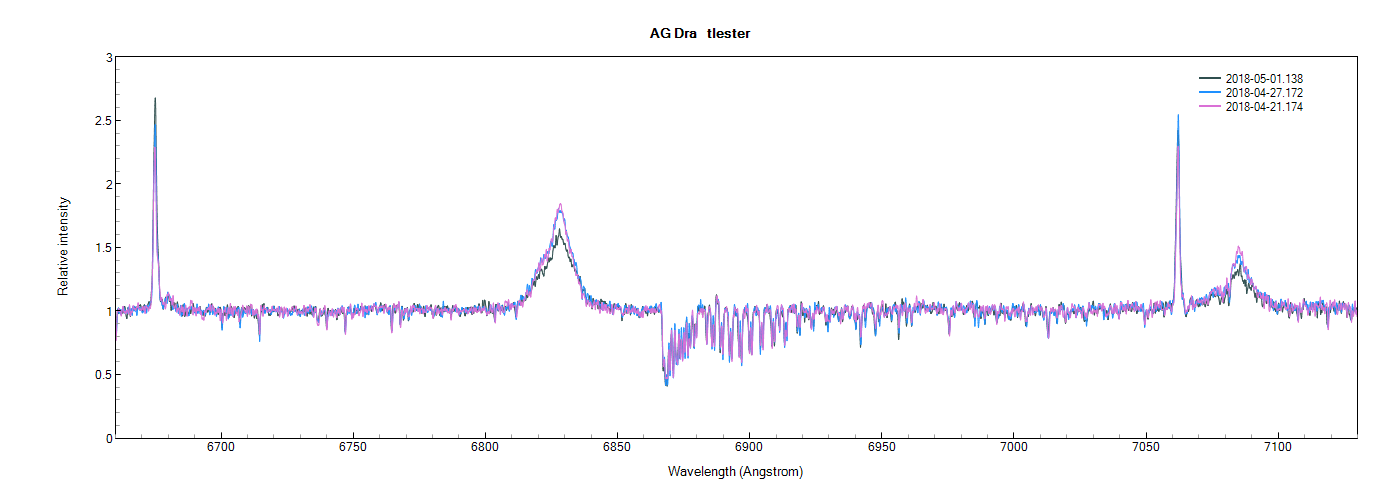

Tim Lester
Posts: 168
Location: Arnprior Ontario
Post by Tim Lester »

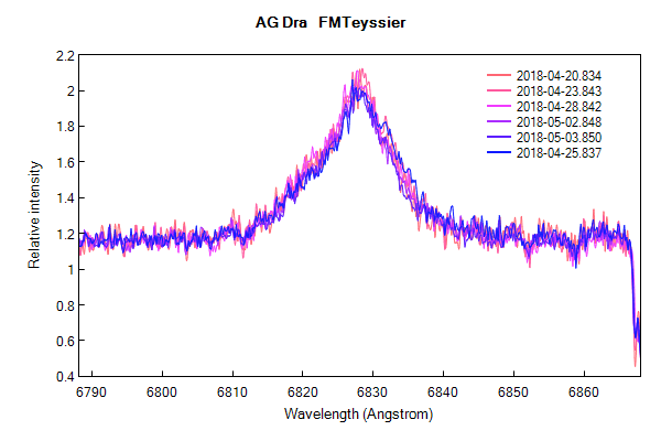

My result for May 1 compared to my last two recent spectra. Also showing recent drop in Raman feature.

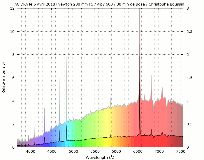

Bonjour à tous,
Voici ma contribution au suivi de AG DRA à basse résolution (R = 500) ( http://www.astrosurf.com/aras/Aras_Data ... /AGDra.htm )
Les 2 spectres suivants ont été obtenus respectivement les 6 (JJ = 2458215.504) et 24 (JJ = 2458233.419) Avril.
Le spectre du 6 Avril à 23 h 50 TU est le résultat de 6 poses de 300 s
( format PNG dans la base ARAS : http://www.astrosurf.com/aras/Aras_Data ... 06_993.png )
( format FITS dans la base ARAS : http://www.astrosurf.com/aras/Aras_Data ... 06_993.fit )
spectre AG DRA 6 Avril 2018
_agdra_20180406_993_Christophe Boussin_3700_7570.png (59.54 KiB) Viewed 9576 times

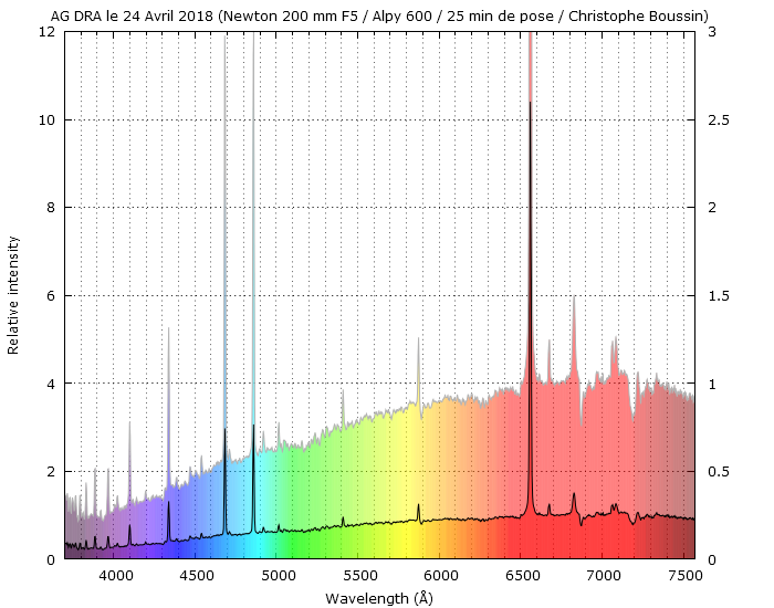

Le spectre du 24 Avril à 21 h 48 TU est obtenu à partir de 5 poses de 300 s
( format PNG: http://www.astrosurf.com/aras/Aras_Data ... 24_909.png )
( format FITS: http://www.astrosurf.com/aras/Aras_Data ... 24_909.fit )
spectre AG DRA le 24 Avril 2018
_agdra_20180424_909_Christophe Boussin_3700_7570.png (65.08 KiB) Viewed 9576 times

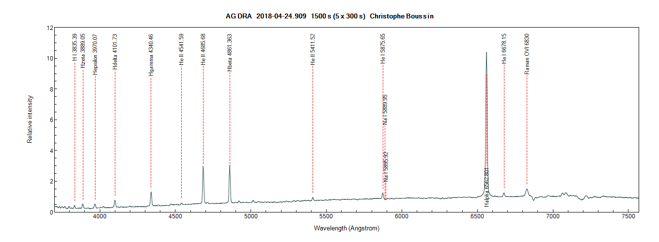

Les raies identifiées avec Plotspectra sont les suivantes :
Comparaison des spectres AG DRA les 6 et 24 Avril 2018
_agdra_20180406 et 20180424_Christophe Boussin_3700_7570.gif (85.01 KiB) Viewed 9576 times

The lines identified with Plotspectra are the following (see at the top).
The animation at the top allows you to better appreciate the evolution of the relative intensities of the lines, especially HeII (4686) and Hbeta (4861 ) between these 2 dates.

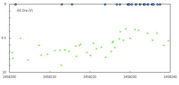

Status of the campaign
AAVSO: mean day values.
ARAS Spectra; blue dots
From AAVSO data, the target looks returning to quiescent state. Thus, short outburst.
Of course, we undergo the monitoring. Target: one spectrum/day at least

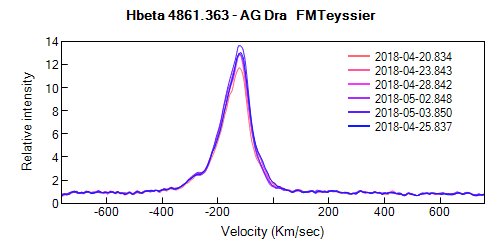

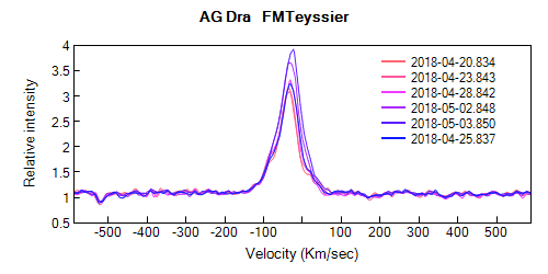

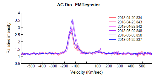

My latest observation (1.83/05/2018) and evolution:
My series
raman OVI almost stable
Variations of the width of He II
Significant variations of He I lines (singlets and triplets)
He I 5876
He I 6678

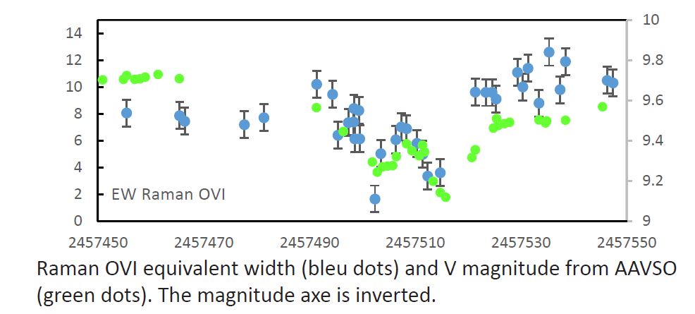

Pour mémoire, behavior of Raman OVI during the short and weak 2016 outburst
in Eruptive Stars Information Letter :

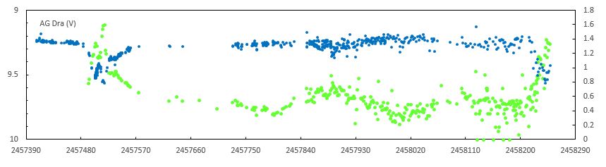

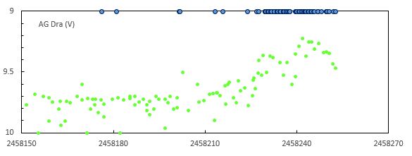

Luminosity curves since 2016 Green = V band Blue= B-V
Outburts occured on April 2016, May 2017 (weak) and May 2018
Current status
Good coverage.
Message from Jaroslav: According to photometric observations of AG Draconis obtained in previous days, outburst is not over yet and the brightness continues to increase. This is very interesting behavior because of not a very steep increase in brightness. Moreover, AG Dra slowly achieves the values similar to the maximal brightness during 2016 outburst.
Spectroscopic coverage of the outburst is very good. Thanks to all which have so far been involved. Keep up the good work!

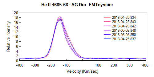

FWHM and EW of He II line

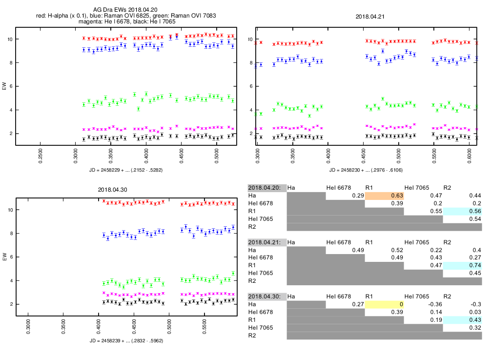

I've managed to process all of my 3 nightly series (already available on the database) into form of EWs.
As a new addition, I've extracted Pearson-correlation on the EW-serie between 2 features - in order to see which features are changing together (important to keep in mind: not absolutely).
See the calculated correlation values table in the bottom-right corner per nightly serie (here R1 denotes Raman OVI 6825 and R2 = Raman OVI 7083):
The 3 graphs are scaled to show equal time differences (a similar night window).
The first 2 series were happening at beginning 2 nights of outburst, and 04.30 is special as the Raman OVI-feature was being at lowest.
Conclusion: at different phase we can see different correlations between the feature changes (at the beginning H-alpha is correlating highly with R1, whilst on 04.30 it's near to 0). The correlation between R1 and R2 is something expected. As for HeI 7065, I am suspecting continuum determination noise might be present on it (and maybe on R2), perhaps I could work on this harder in the future.
Error estimate was brought out by measuring a nearby continuum region per-feature, and taking a whole serie's EW stddev precisely.
- Peter

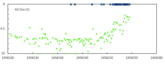

An update: finally AG Dra is fading quickly at V = 9.5 (14-05)
Hello Benji,
The Pearson-correlation is more about a choice of convenience (here I used GDL's 'correlate' function, being at hand).
I'm wondering which error estimate method spc_ew is using (need a math formula or algorithm details).
The article "Chalabaev, A. and Maillard, J.P. 1983, A&A, 127, 279" (the eps-Aur project you mentioned referring to) focuses on analysis of some Be stars H-alpha variability, but can't find any final conclusion which formula to be used in general.
AG Dra is different in many ways (features shape are not gaussian, shortterm variance) so not sure if these theories apply here.
