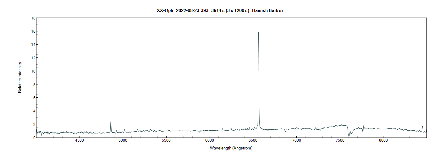

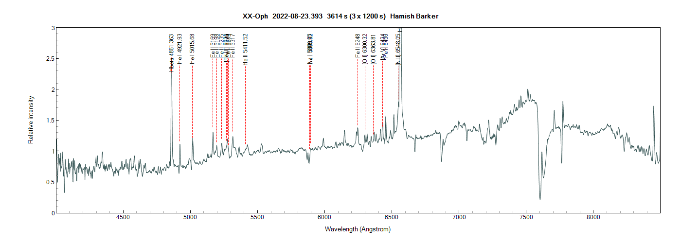

HI all,
for coordination, tonight I am observing the brightest of the southerly targets Ly Mus, XX Oph so far this evening, and may possibly get HD161213 and HD330993 if conditions remain good.
Hamish
Hamish Barker
Posts: 227
Post by Hamish Barker »

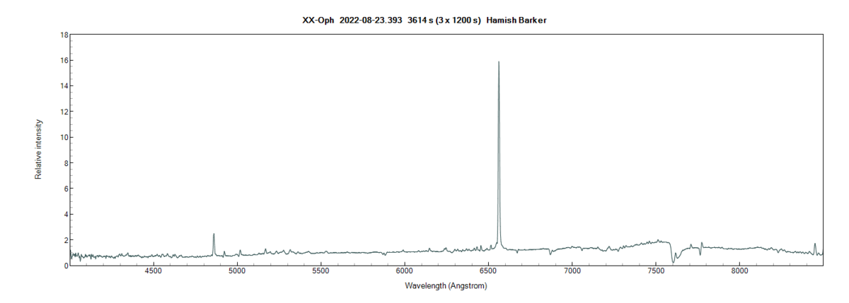

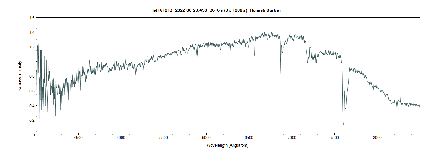

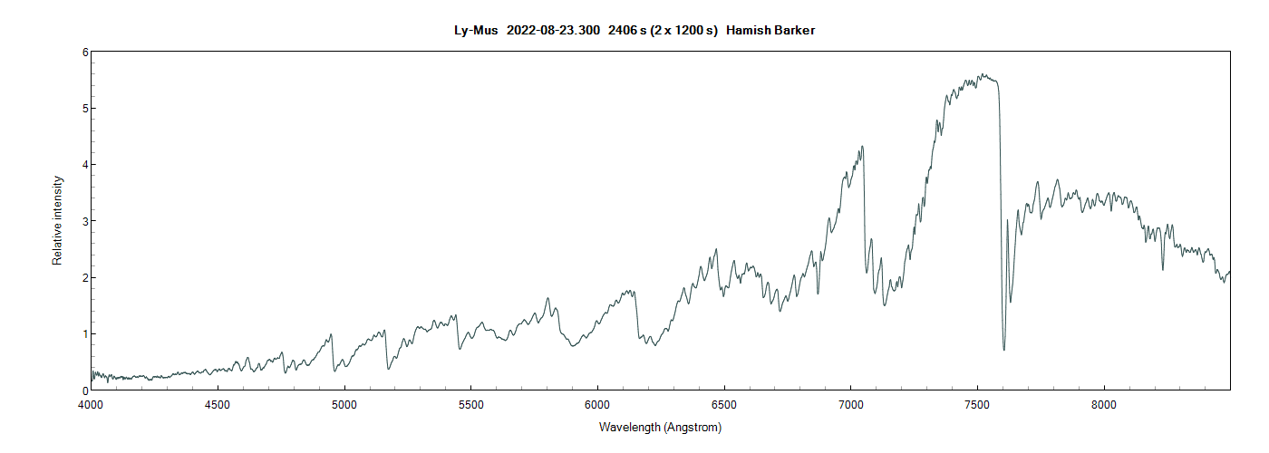

I observed all of the my list above, except HD330993, at R circa 600 and should be good signal to noise.
Hamish Barker
Posts: 227

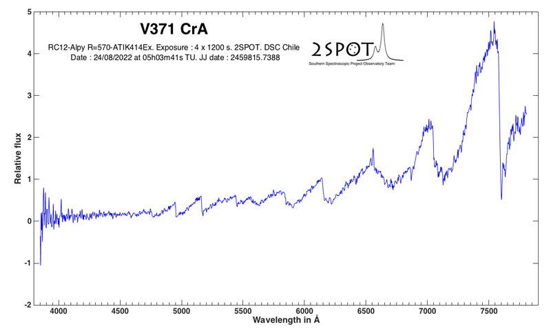

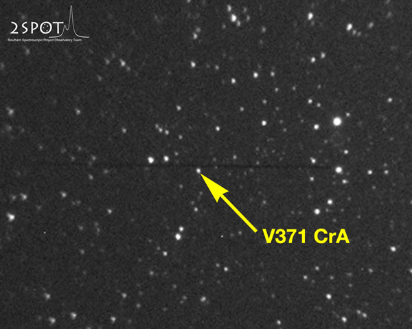

The harvest of this morning from Chile :
V371 CrA :

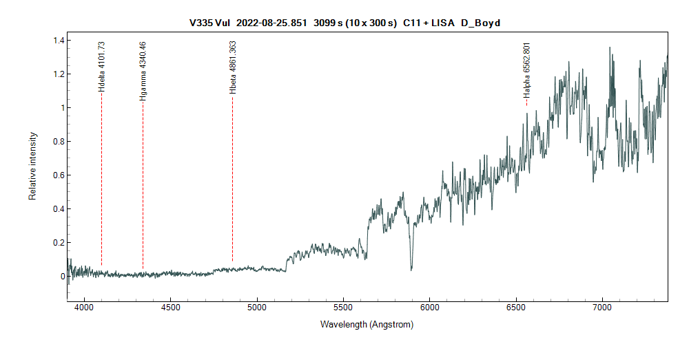

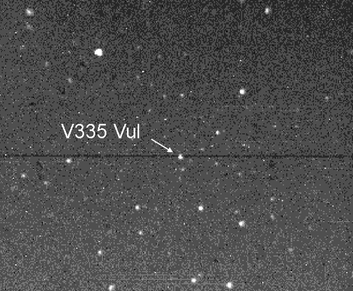

Guider image of V335 Vul
V335 Vul guider image.png (198.79 KiB) Viewed 43136 times
Spectrum of V335 Vul
V335 Vul.png (50.54 KiB) Viewed 43136 times
Appears to be a normal carbon star as classified in SImbad.

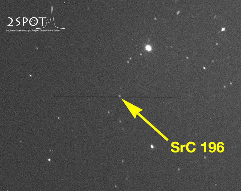

Another symbiotic star candidate close to the 47 Tuc globular cluster : SrC 196

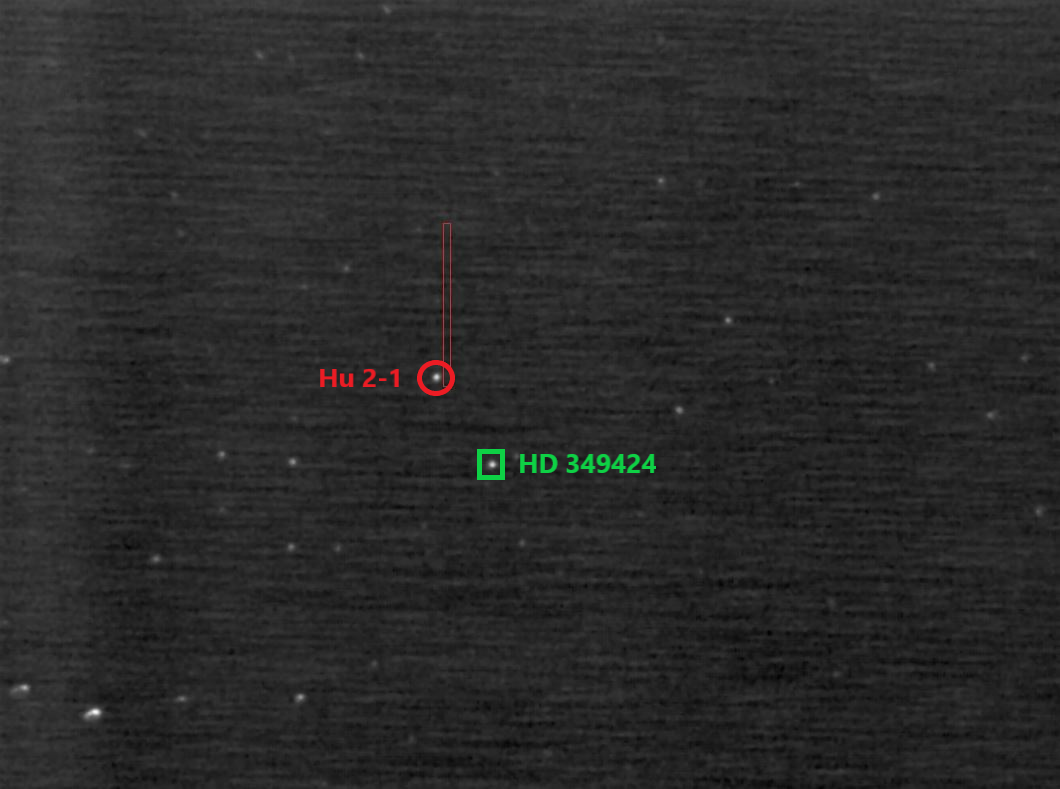

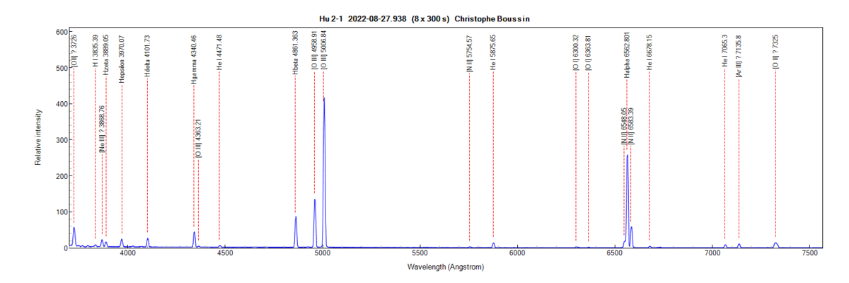

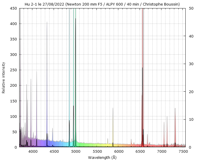

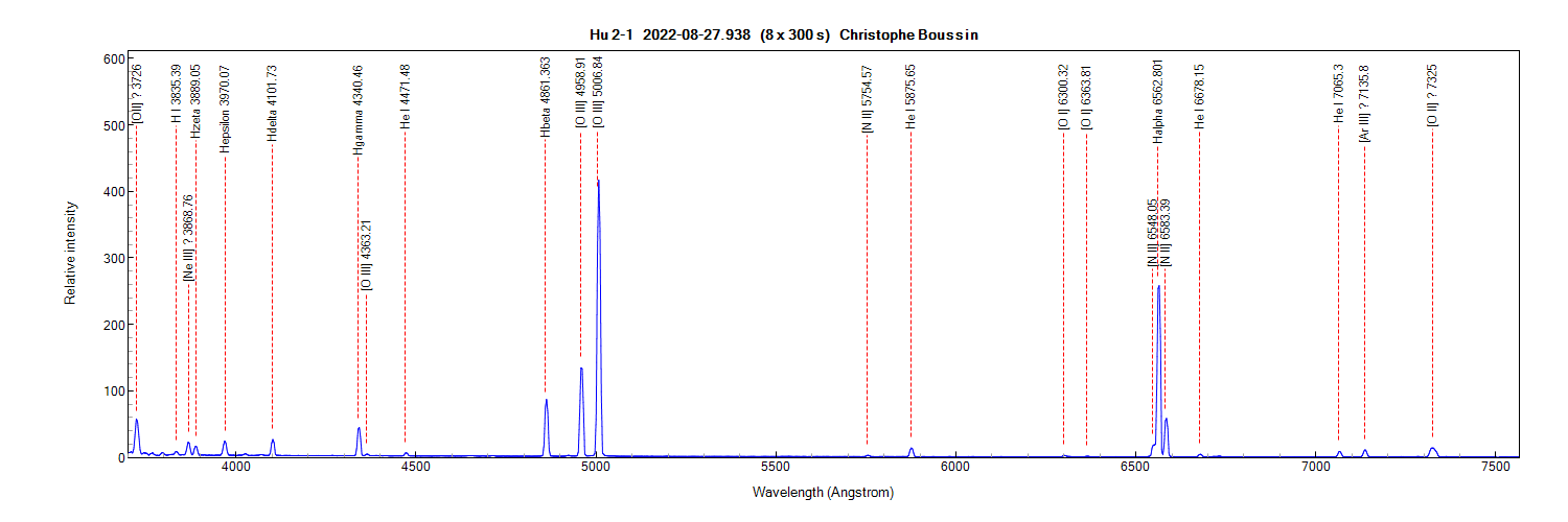

Here is my contribution to this new update of the symbiotic stars classification program.
I obtained the following spectrum of Hu 2-1 the 27th of August at 22 h 30 TU with my Alpy 600 (resolution of 535, JJ = 2459819.4379) and an acquisition time of 40 min (8 x 300s) :
Hu 2-1 on August 27th, 2022
_hu21_20220827_938_Christophe Boussin_3700_7565.png (63.47 KiB) Viewed 43051 times

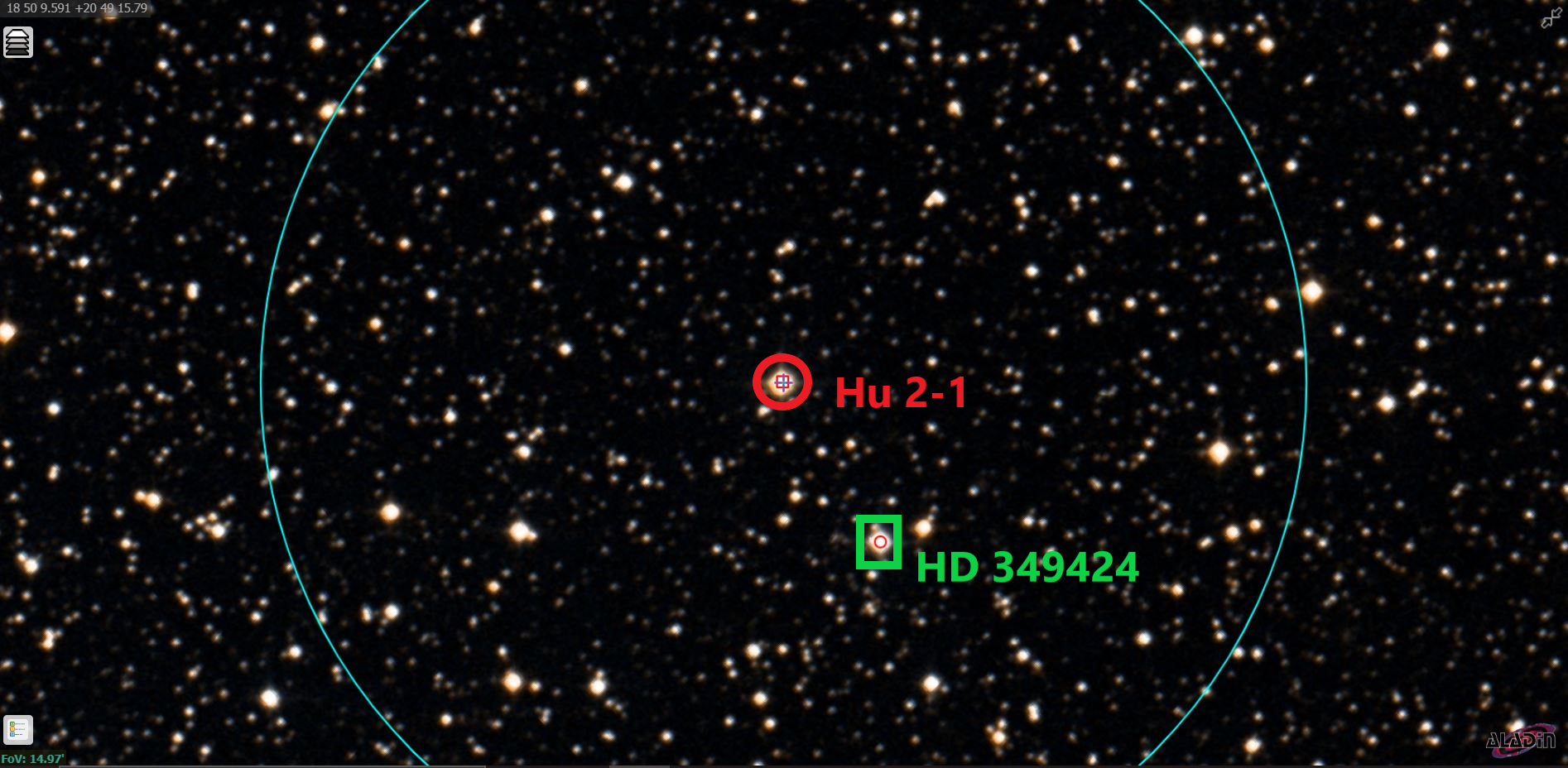

Guiding field
Guiding field
CHAMP Hu 2_1_legende.png (529.12 KiB) Viewed 43051 times
Image of the field (Aladin)

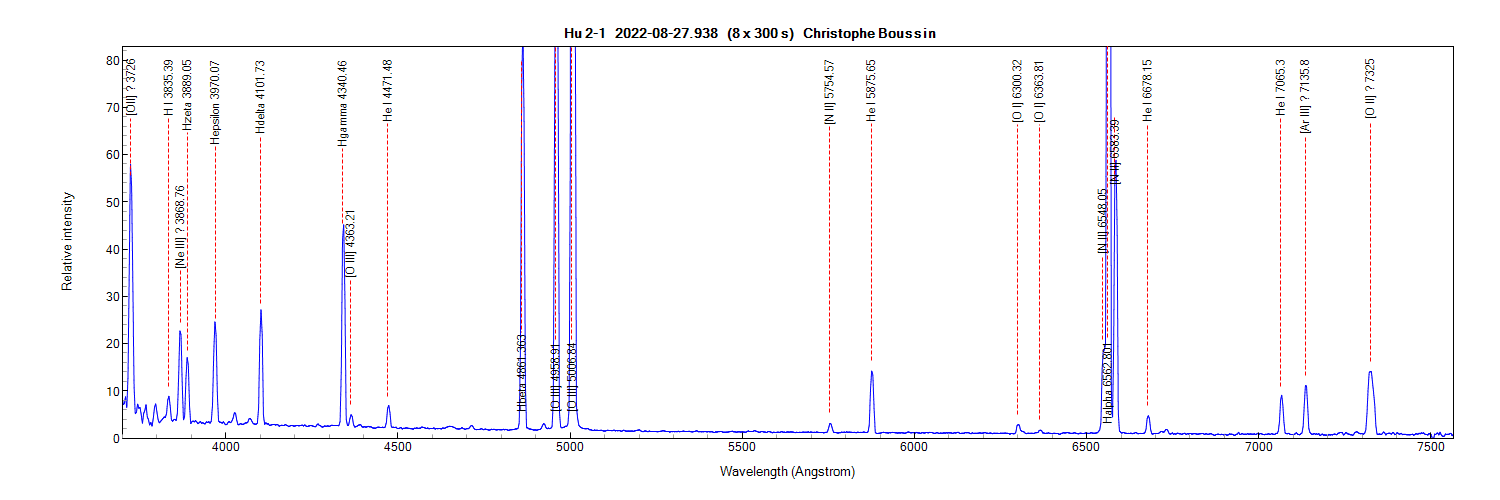

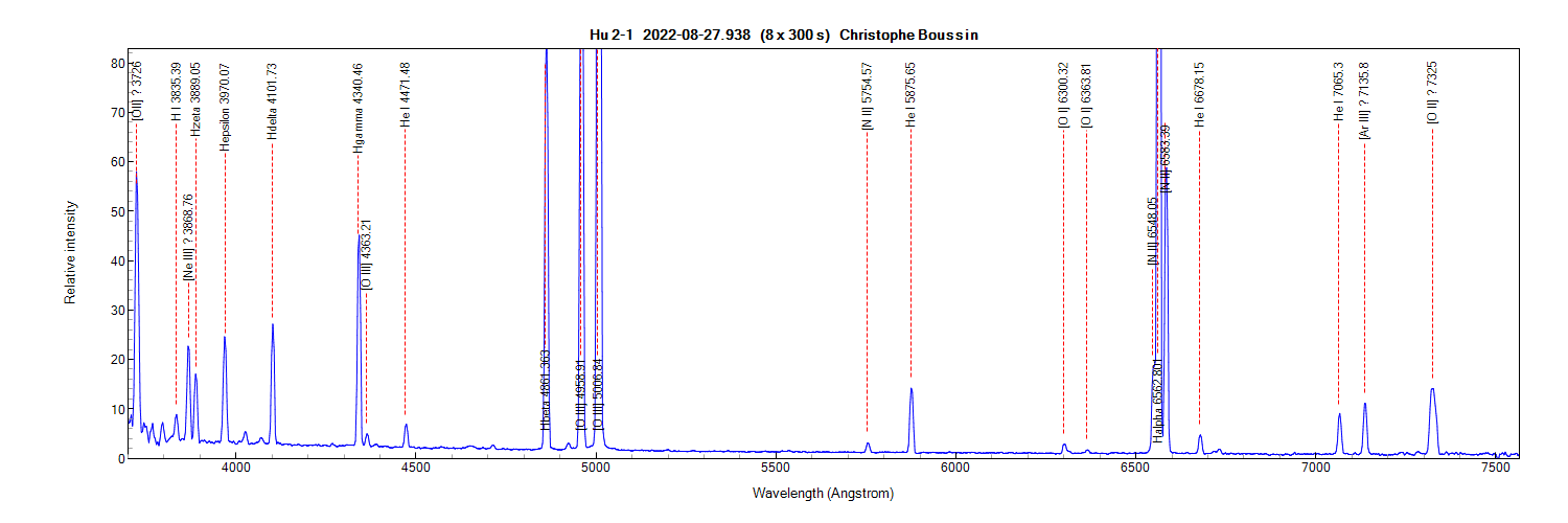

Hu 2-1 is identified as a planetary nebula in the Simbad database.
The suggested identification of the lines below seems to confirm this.
Hu 2-1 on August 27th, 2022 (identification from PlotSpectra)
Hu 2-1 on August 27th, 2022 (zoom)
Clear skies,

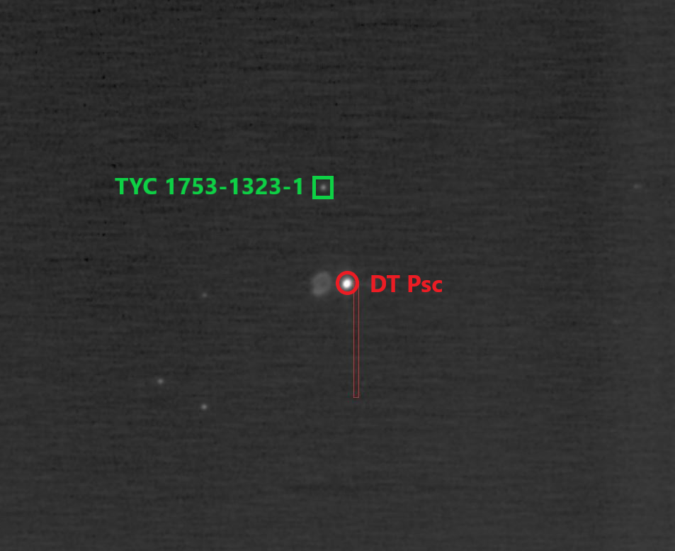

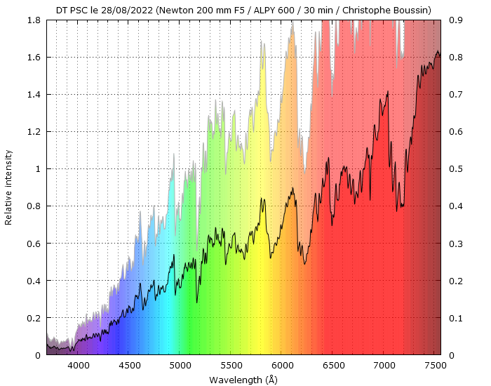

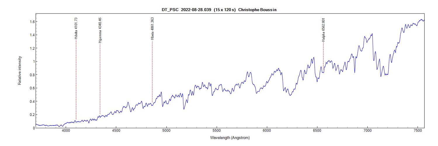

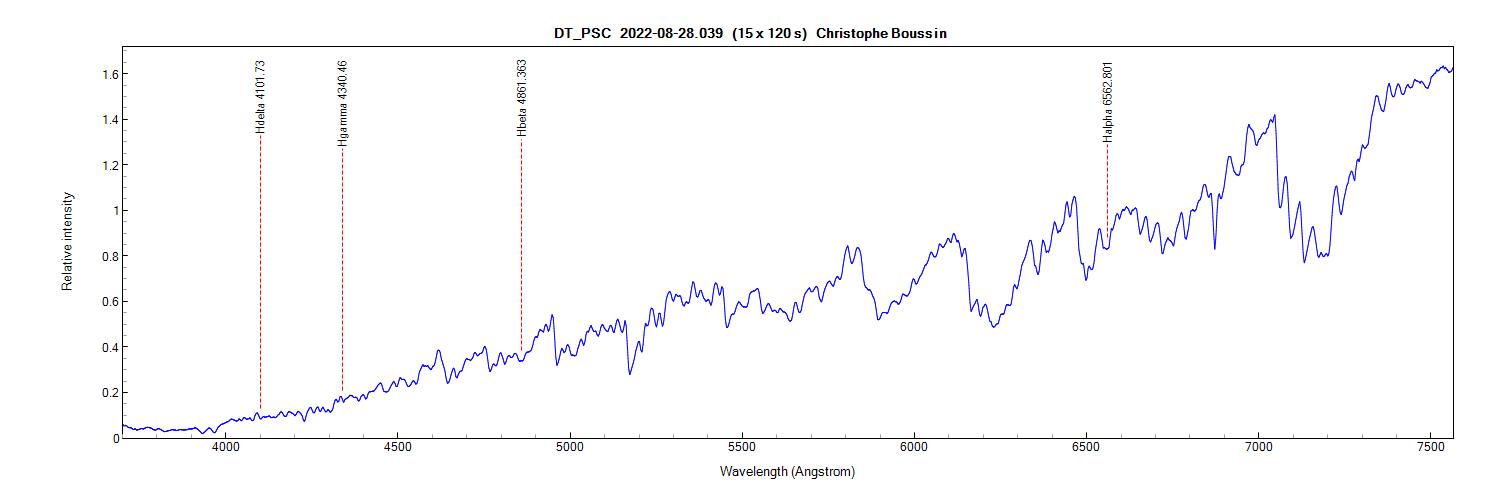

Here is my new contribution to this classification program with DT Psc, a very bright target, which is identified as a symbiotic star in the Simbad database.
I obtained the following spectrum of DT Psc the 28th of August at 0 h 56 TU with my Alpy 600 (resolution of 541, JJ = 2459819.539) and an acquisition time of 30 min (15 x 120s) :
DT Psc on August 28th, 2022
_dt_psc_20220828_039_Christophe Boussin_3700_7565.png (102.5 KiB) Viewed 42985 times
Guiding field
Guiding field
CHAMP DT_PSC_legende.png (381.07 KiB) Viewed 42985 times
DT Psc on August 28th, 2022 (identification from PlotSpectra)
No balmer lines are visible in emission in the spectrum.
Clear skies,

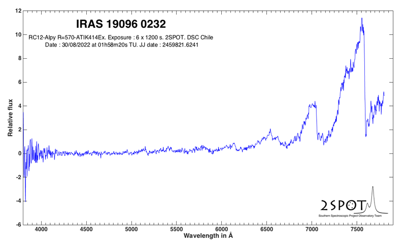

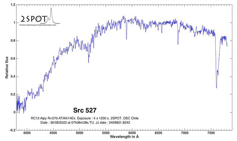

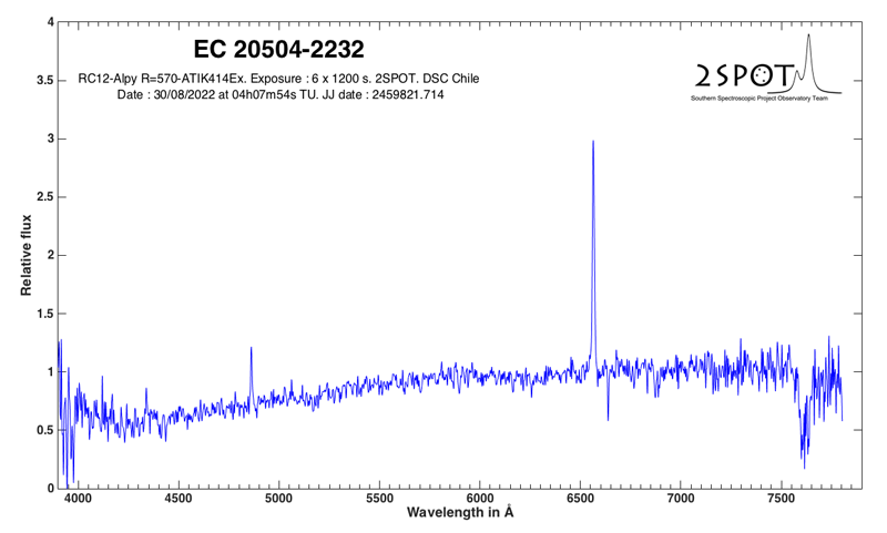

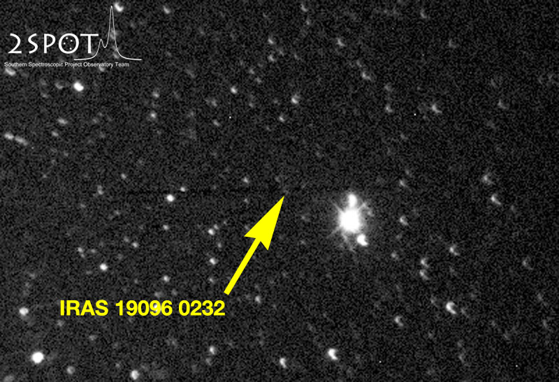

4 candidates symbiotics star taken in automatic mode from Chile (no human intervention) :
2MASS_J15292939-5612133 : Mag. V=12,1
IRAS IRAS_19096_0232 : Mag. V=14,9
EC 20504-2232 : Mag. V=14,5
Balmer's lines in emission.
SrC 527 : Mag. G=12,1 (target close to 47 Tuc globular cluster)

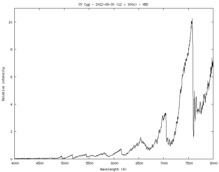

Spectrum of OY Cyg
Newton 250 + Alpy 600 + QSI RS 6.1 (remote setup)
Reference star : HD195050
OY Cyg spectrum
OY Cyg spectrum
