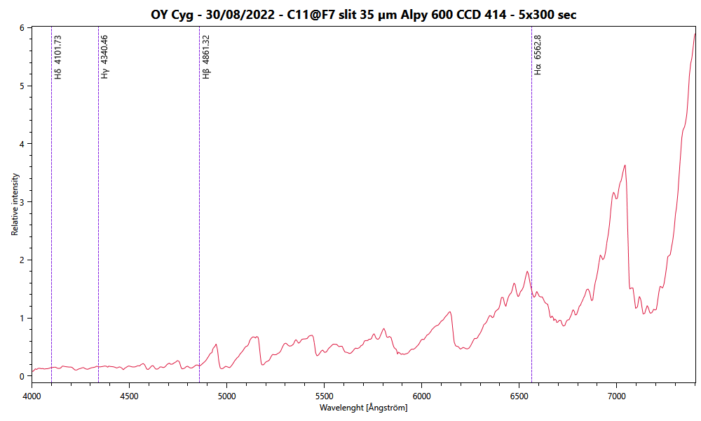

Guider image of OY Cyg
OY Cyg guider image.png (20.97 KiB) Viewed 27837 times
Spectrum of OY Cyg
OY Cyg.png (35.48 KiB) Viewed 27837 times
Looks like a M6III - M7III spectrum.

Same result as David and Vincent on OY Cyg, albeit in low resolution
OY guide.jpg (226.01 KiB) Viewed 27816 times
OY Cyg_20220901T193820.png (45.56 KiB) Viewed 27816 times

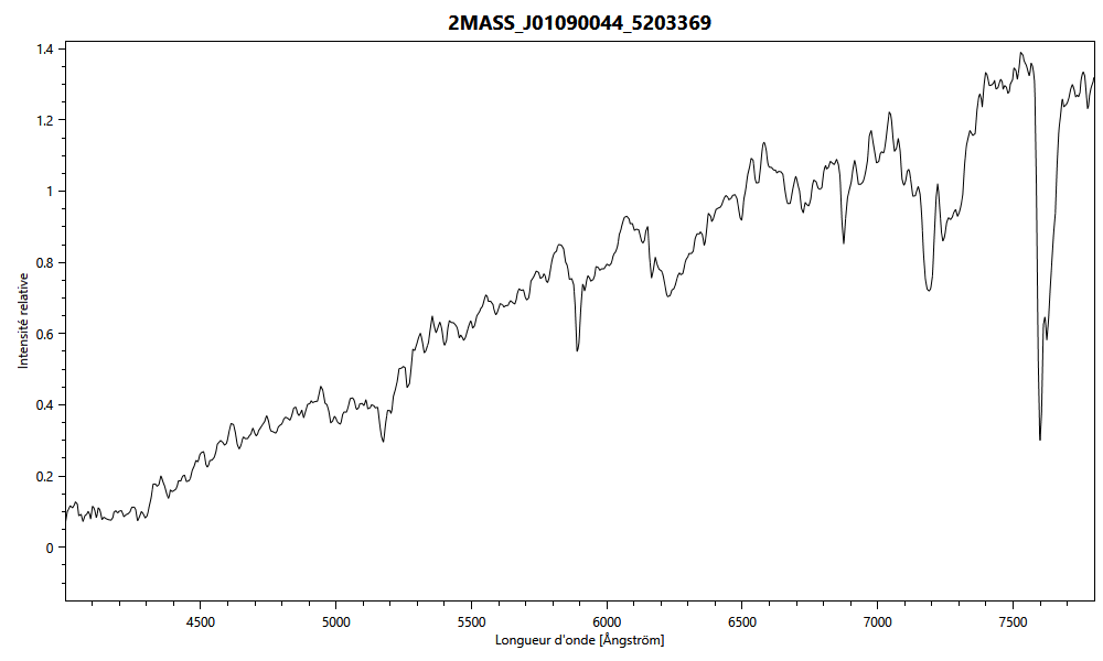

2MASS J01090044+5203369 in Cassiopea
C11@F7 Alpy 600 slit 35 um CCD 414 5x300s
Guide image and astrometry
Jean-Philippe

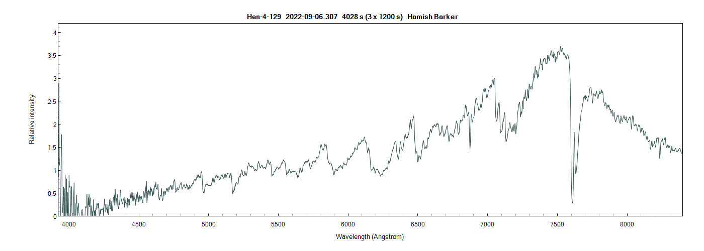

Hen 4-129 from last night. I don't have expertise to make classification of it but have submitted the fits file to Francois and Jaroslav.

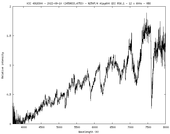

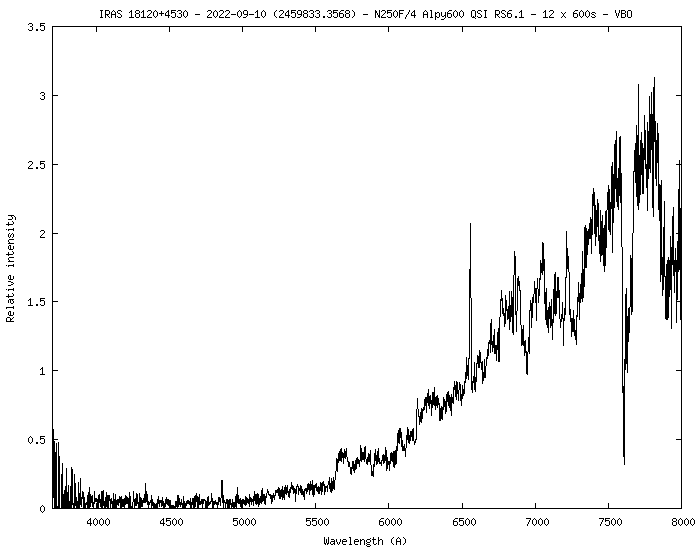

Vincent Bouttard
Post by Vincent Bouttard »

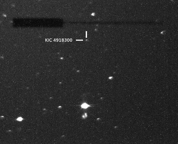

IRAS 18120+4530 and KIC 4918300.
IRAS 18120+430 seems to be a symbiotic system.
Very faint stars for my setup but a really nice challenge
Vincent
KIC 4918300 FOV
KIC 4918300 FOV
KIC 4918300
KIC 4918300
IRAS 48120+4530 FOV
IRAS 48120+4530 FOV
IRAS 18120+4530
IRAS 18120+4530

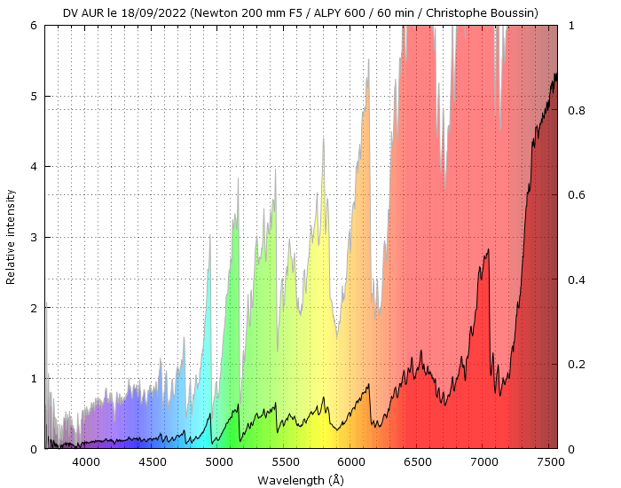

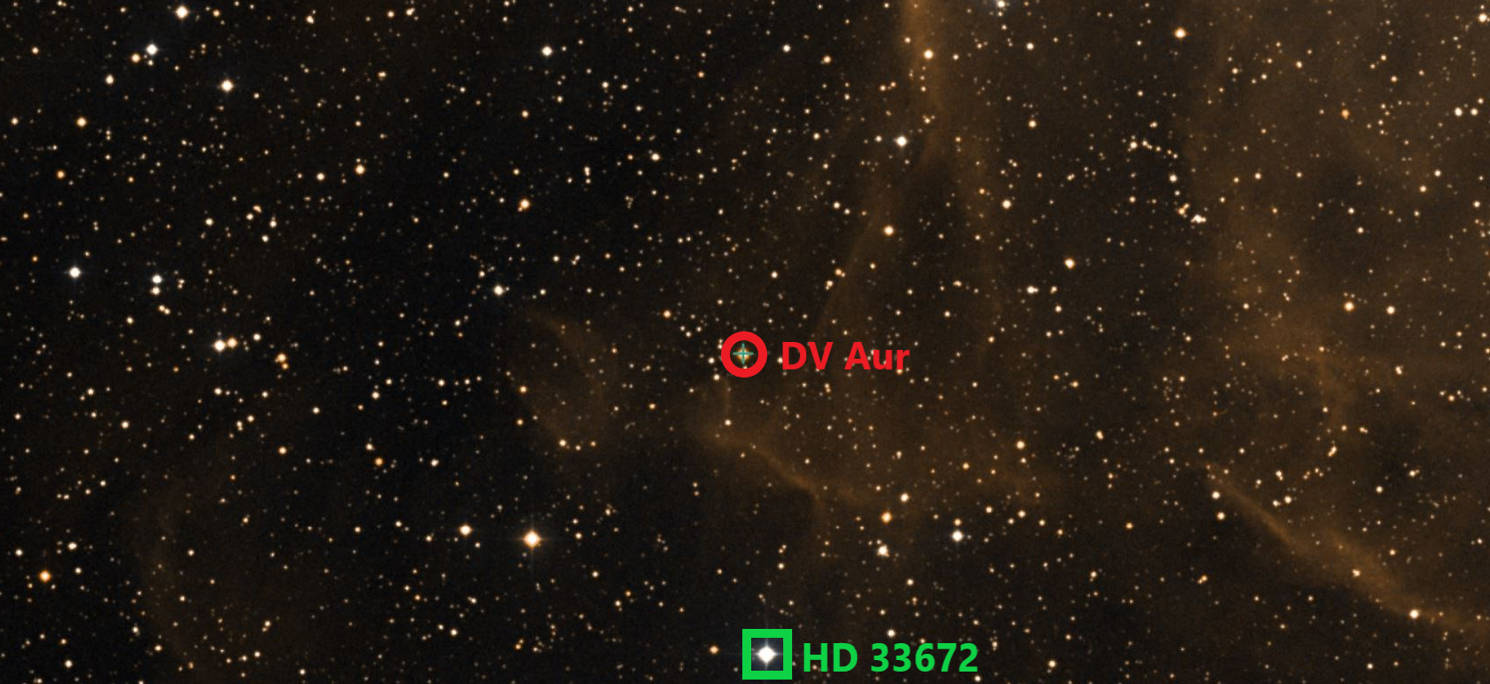

Posts: 173
Post by Christophe Boussin »

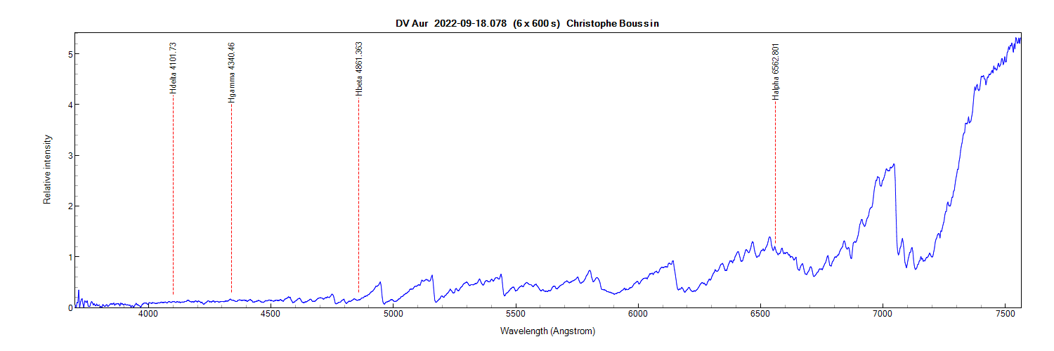

Here is my new contribution to this classification program with DV Aur which is identified as a long period variable in the Simbad database.
I obtained the following spectrum of DV Aur the 18th of September at 1 h 52 TU with my Alpy 600 (resolution of 509, JJ = 2459840.5781) and an acquisition time of 60 min (6 x 600s) :
DV Aur on September 18th, 2022
_dvaur_20220918_078_Christophe Boussin_3700_7565.png (92.15 KiB) Viewed 27444 times

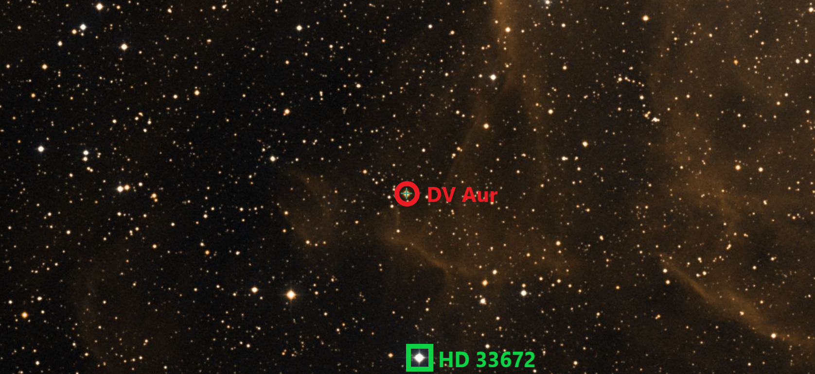

Guiding field
Guiding field
CHAMP DV Aur_legende.png (453.88 KiB) Viewed 27444 times
Image of the field (Aladin)
DV Aur on September 18th, 2022 (identification from PlotSpectra)
No balmer lines are visible in emission in the spectrum.

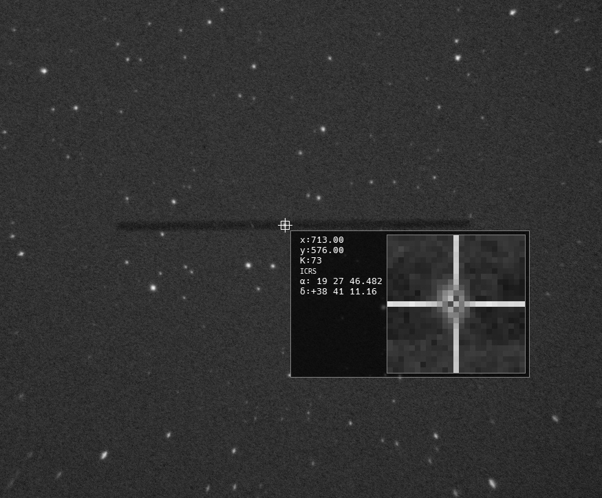

Vincent Bouttard
Posts: 2
Joined: Wed Sep 21, 2022 5:49 pm

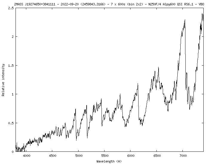

A spectra of 2MASS J19274650+3841111 with my autoguider FOV.
Vincent
JP Nougayrede
Posts: 154
Post by JP Nougayrede »
Bonjour everybody,
Another spectrum (low rez R300) of 2MASS J19274650+3841111, which seems to confirm Vincent's observation
2MASS J19274650+3841111_20220924T082205.png (63.55 KiB) Viewed 27316 times
Bon ciel,
