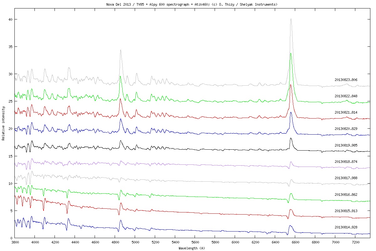

Posts: 370
Post by Olivier Thizy »
well... I must have some weather's god attention or some luck at the moment... here is my 10th night in-a-row on the nova!!!

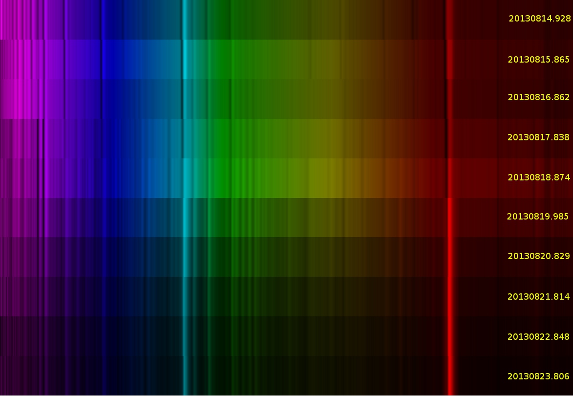

Here is the update of the graph with 10 spectra (one per night):
I also updated my colored graph with the 10 spectra, it shows very nicely the evolution:
Equipment is:
-Televue 85mm refractor
-Alpy 600 spectrograph
-Atik 460ex camera for acquisition
http://www.shelyak.com/en/

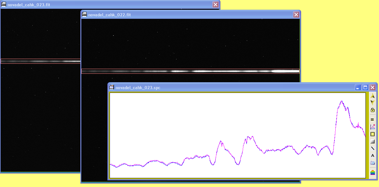

Je viens enfin de réussir à traiter mon image des raies H&K du calcium. Ca a pas été simple car j'ai pas trop l'habitude de ce coin là du spectre, mon signal était assez faible et la calibration a été délicate.
Bref, après avoir utilisé tous les logiciels possibles, j'ai réussi à obtenir quelque chose de cohérent à la fois dans VisualSpec, SPCAudace et ISIS (j'ai même ressorti un vieux SPIris de derrière les fagots...)
Ce soir, ici, c'est couvert ; j'attendrai lundi au mieux pour remettre cette expérience. Le télescope est resté dans la configuration de vendredi, ça devrait aller mieux mais je monterai le temps de pose.
I have just finish to process my image of H & K lines. It was a bit hard for me because it is the first time I went to that corner of the spectrum, my signal was quite weak and the calibration was perilous.
Anyway, I got something coherent in both VisualSpec, SPCAudace and ISIS (and a good old SPIris from an old hard disk ...)
The forecast is bad between Bordeaux and Cognac for two days. I will wait for Monday. The telescope remains in the configuration of Friday, it should be better but I surely have to push the exposure time.

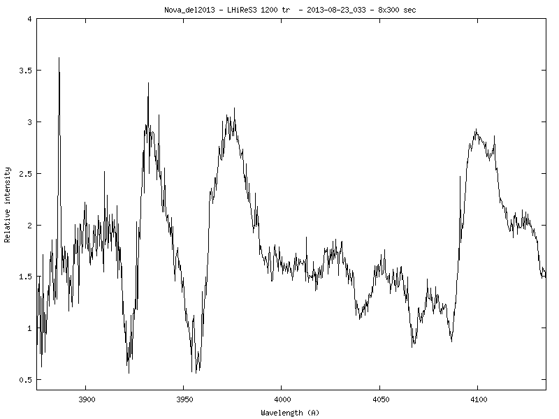

Olivier, dynamic spectrum is fantastic!
Eric, you capture CN emission at 3886A? This night, with Lhires III 600 it seems not visible...
Someone can confirm?
Ciao
Eric, very important. Evaluate your 2D and look if the feature near 3880 A is real (a cosmic rays, ...).
Presently, from Toulouse and on only one 300 sec. cloudy exposure (!) near H&K with eShel I detect anything.
Nothing there tonight.

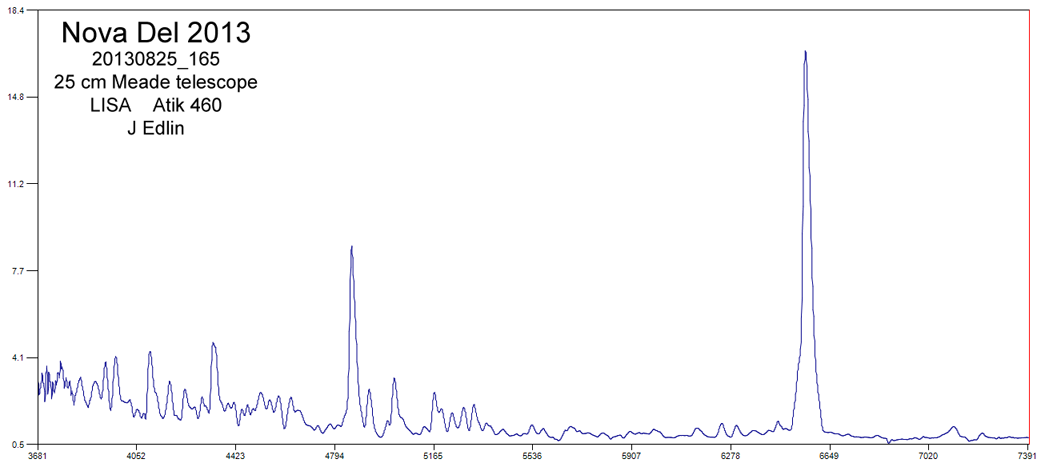

Hi, last 2 nights have been cloudy. Tonight after storms past got a 40 min clearing, just enough the get a spectrum of Nova Del 2013. Below my plot of the spectrum. Wonder when the Balmer series will stop rising??
Jim
Nova del 20130825_165 plot 80%.png (55.11 KiB) Viewed 28021 times

Hello, Ive check the 2D image and all the individuals frames ; it's a cosmic...
Eric
