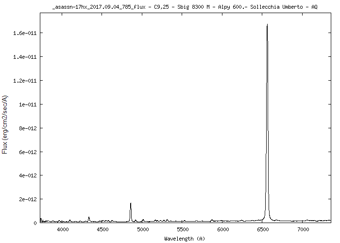

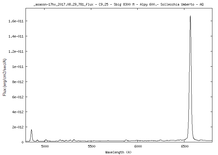

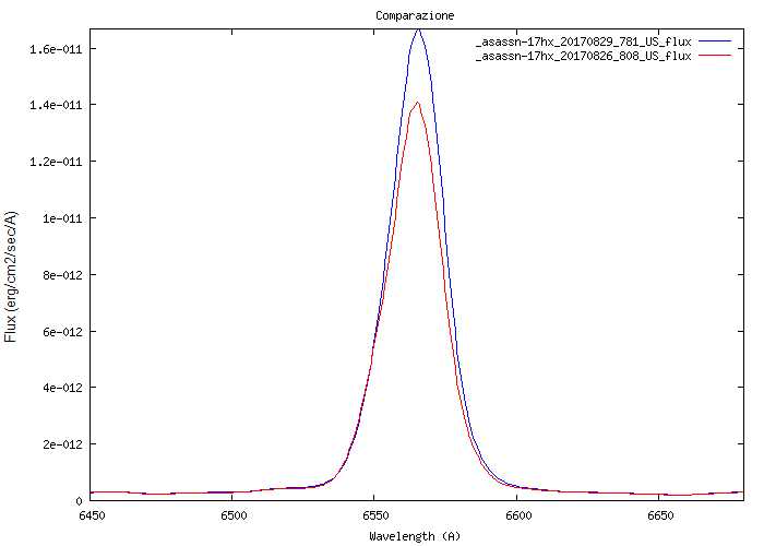

Bonsoir du tout, le profil de l'observation sur la nuit du 29-08-2017.Je joint également une comparaison entre le 26-08-2017 et le 29-08-2017 où il y a une légère hausse du H-alpha le jour 29-08-2017.

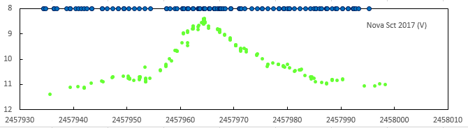

Excellent survey of a very interesting and peculiar nova
The light curve (AAVSO V) and ARAS Spectra
Now a plateau at mag V ~ 11

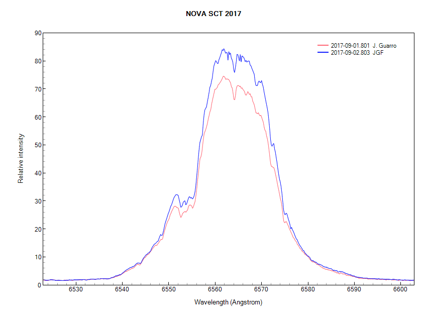

Post by Joan Guarro Flo »

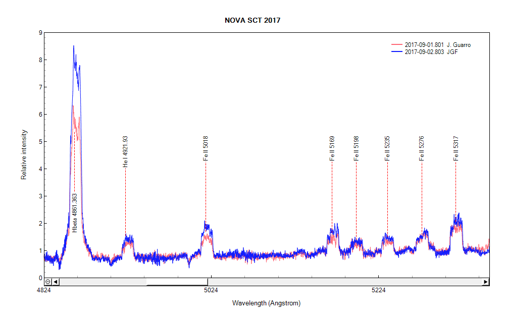

Although ns2107 brightness goes down. Over the last 24 hours it has increased its emission
Cheers, Joan.
novasct2017_DAYS 0901-0902Ha.png (31.08 KiB) Viewed 10102 times

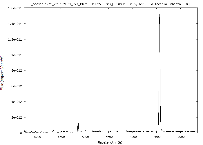

Post by umberto sollecchia »
Bonne journée pour tous, le profil spectral du jour 01-09-2017.Umberto

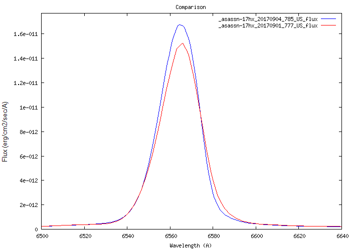

Bonjour, le profil de la nuit dernière et une comparaison dans la région H-alpha avec le jour 01-09-2017. L'hydrogène monte encore. Umberto

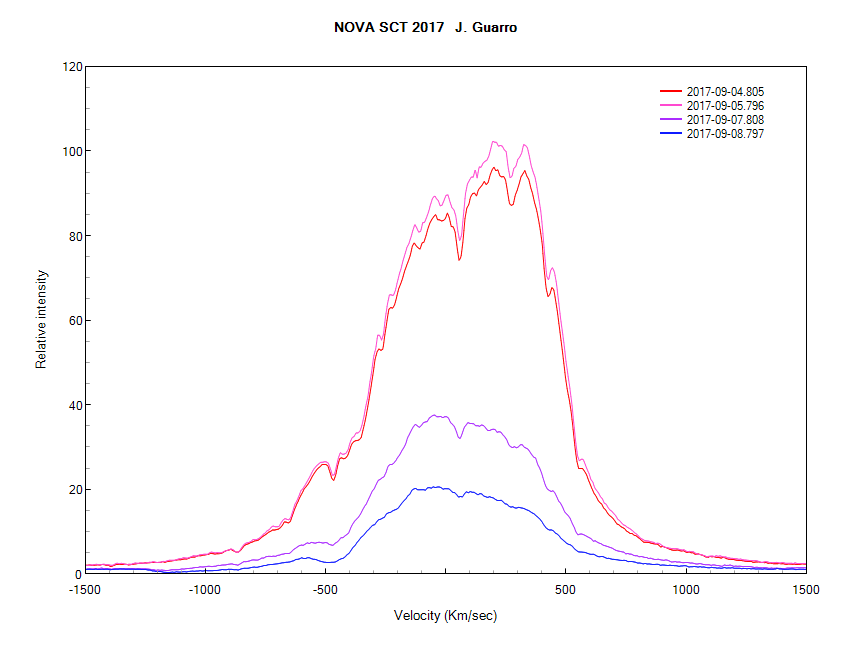

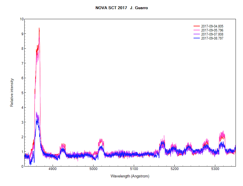

Hi all, the nova is undergoing a strong rebrightening. During my last observation, Sep 4, was shining at V mag 10.86 while this evening (Sep 8, ~ 19UT) V mag is 9.76.
The actual H-beta region spectrum exhibits lines (hydrogen and iron - helium?) with a complex P-Cyg profile.
On a low-res spectrum used for flux calibration (by Umberto, same night), I can see P-Cyg profiles on all the Balmer, helium and metals emission lines.
Heliocentric radial velocity of H-beta line (two main velocities, ~-500 and -1000 Km/s):
The comparison with Sep 4 spectrum:

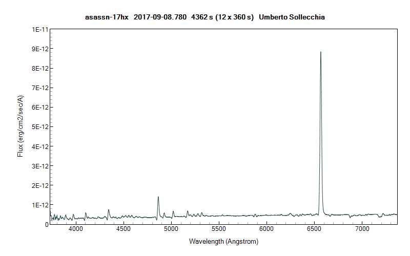

Bonsoir, voici le profil de faible résolution pris en même temps que celui de Paolo Berardi.Umberto

Posts: 731
This is a complement of Paolo and Umberto's explanations. The Hidrogen emission loses strength.
Joan.

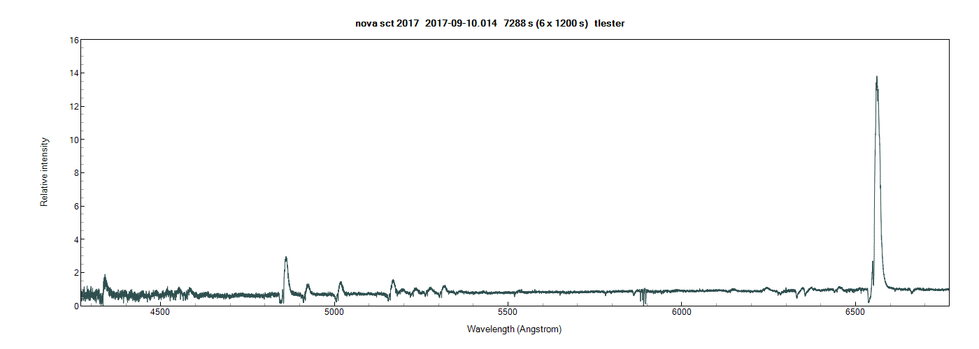

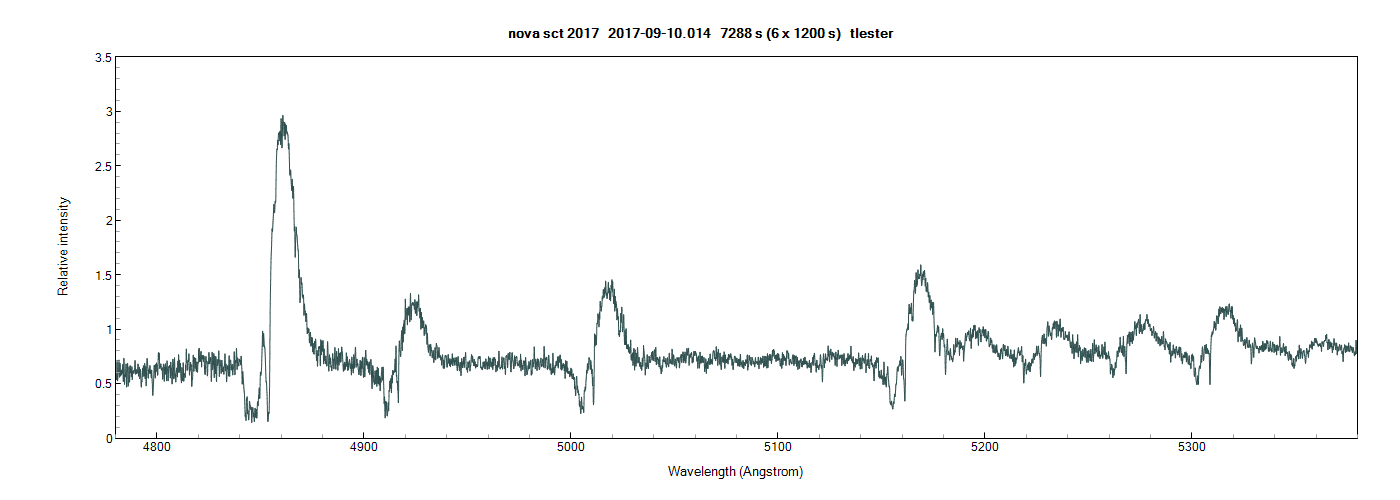

Here is nova sct on the 10th captured with my echelle spectrograph at R = 12000. It is still brightening (V mag = 9.5 on AAVSO) but it is low in the sky and difficult to get good S/N at the blue end..
