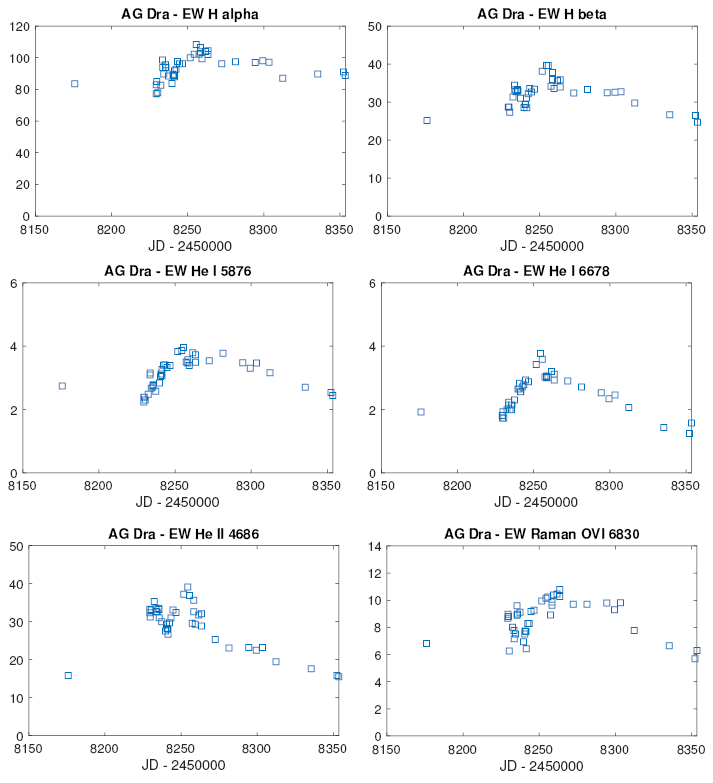

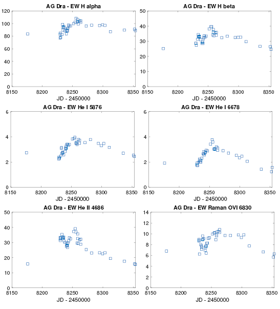

Posts: 1559

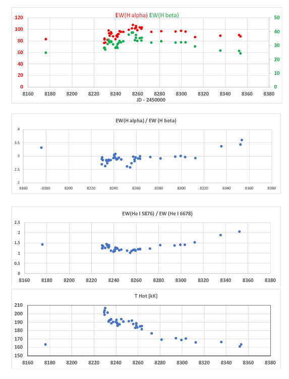

After 2018 outburst, AG Dra monitoring
Equivalent width of the main lines
Diagnostics ratios
Ha/Hb : near Balmer decrement for case B, rising
Temperature Hot Component (Iijima, 1981)

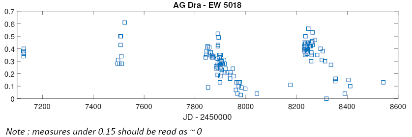

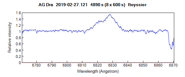

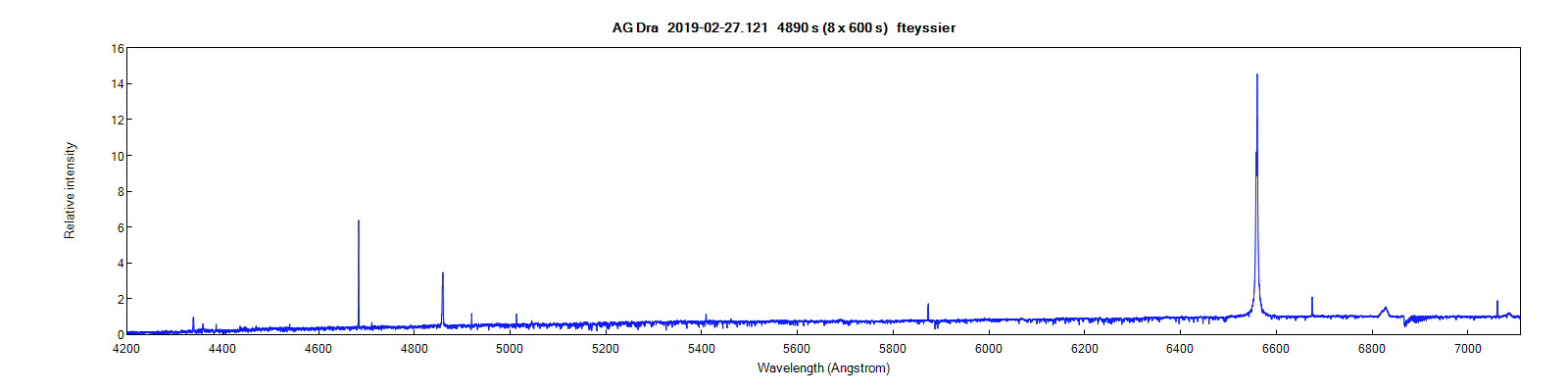

I've detected the strange emergence of a line at 5018 A (once deduced the systemic velocity) during the outbursts.

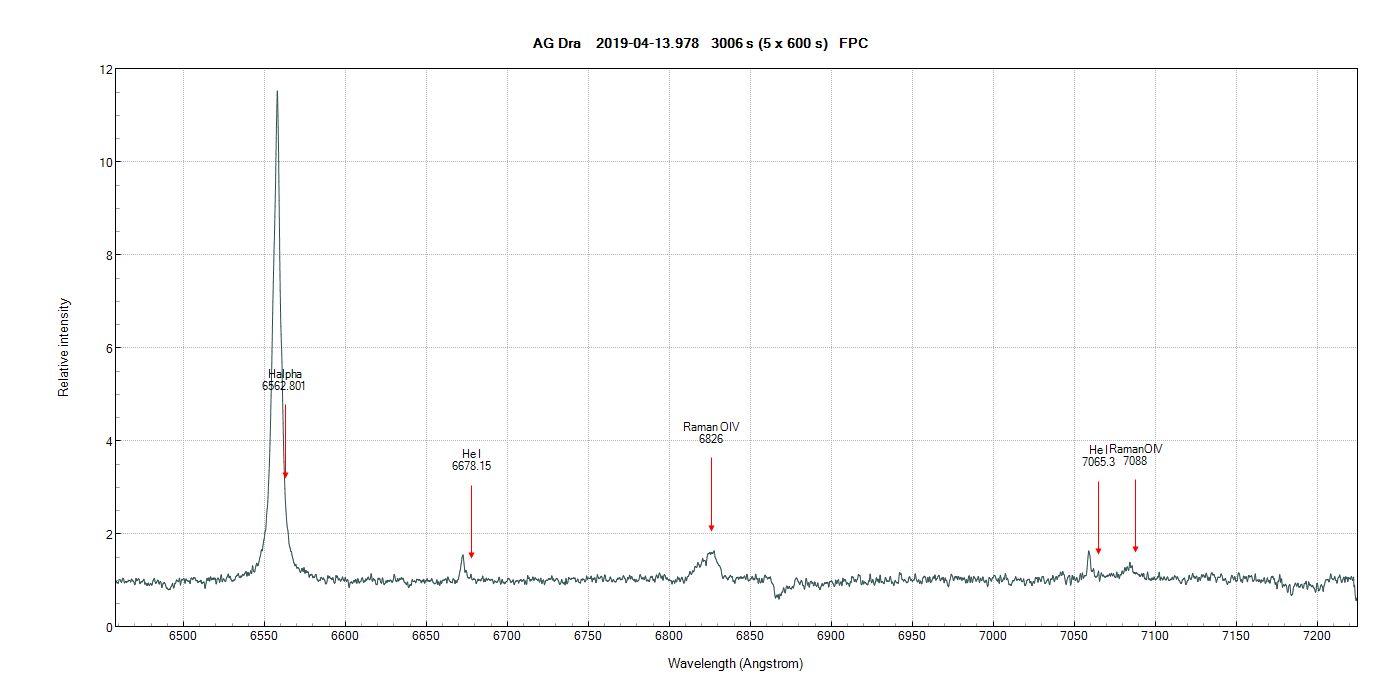

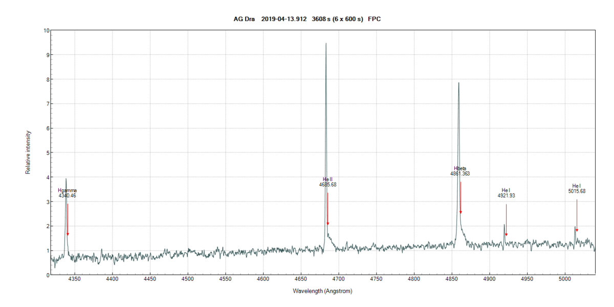

Posts: 88
Post by Francisco Campos »

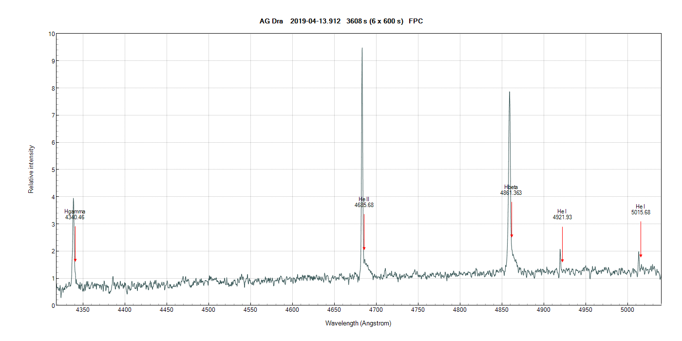

here is my contribution from the last night, taken with the DADOS and the 1200 l/mm grating. I'm not sure if these spectra will be useful or not, because the resolution is about R=4000. Plus, I'm a bit worried about lambda calibration: it seems that the bands are a bit shifted from the expected position... or maybe it is a peculiarity of AG Dra? These spectra have already been corrected by heliocentric speed by ISIS...
Well... if resolution is not enough, I would come back to low-resolution...
Greetings,
Fran
Posts: 1559
Hi Fran,
The systemic velocity is very high: -147.7 km/s (2.39 A at 4861 A)
The problem is the shape of the red edge of H beta and HeII (the "bump" is an artifact)
See e.g. Peter's spectra (R = 2500) in the database. http://www.astrosurf.com/aras/Aras_Data ... /AGDra.htm
or at R = 11000
(match well!)
At date, no sign of outburst
Let's go on. Excellent coverage for the baseline

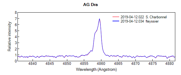

Last state of Ag Dra, a spectrum taken 2 days ago compare with my last observation the 28th March.

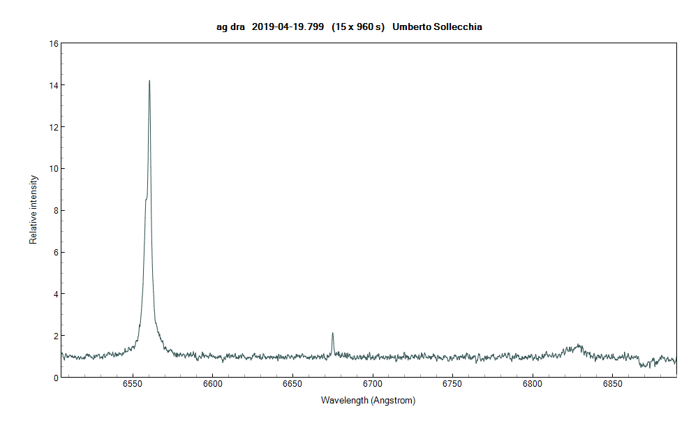

Post by umberto sollecchia »
Ma contribution, observation du 19.04.2019.
agdra_20190419_799_U. Sollecchia.png (26.8 KiB) Viewed 9770 times
Last edited by umberto sollecchia on Sun Apr 21, 2019 2:18 pm, edited 1 time in total.
He II 4686 H-beta region with Lhires III and 1200 l/mm grating, 19/04/2019.
The He II 4686 / H-beta EWs ratio is about 0.94. K giant absorption lines are clearly visible in the continuum.

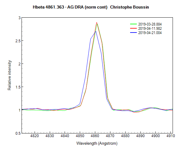

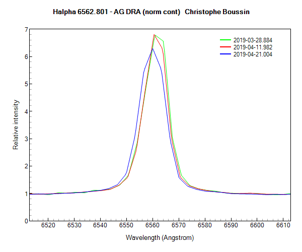

Posts: 173

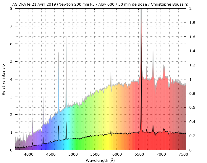

Post by Christophe Boussin »
Here is my last contribution to the AG Dra monitoring.
I obtained the following spectrum the 21th of April at 00 h 05 TU with my Alpy 600 (resolution of 503, JJ = 2458594.5039) and an acquisition time of 50 min :
AG Dra on April 21th, 2019
_agdra_20190421_004_Christophe Boussin_3700_7570.png (72.59 KiB) Viewed 9723 times

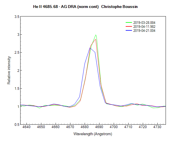

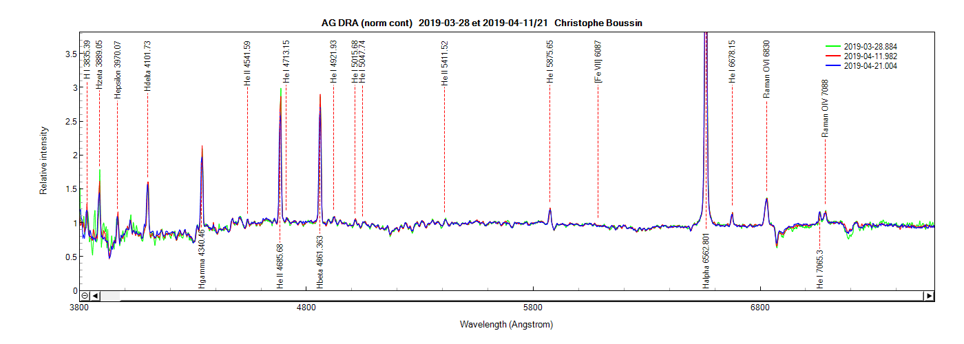

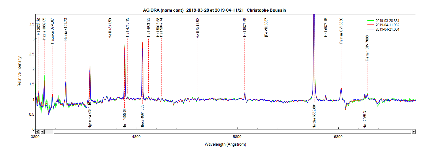

The comparison of my spectra (renormalized around their continuum) between 28 March and 21 April (with, as an indication, identification of some lines from PlotSpectra) :
AG Dra on March 28th and April 11th, 21th 2019

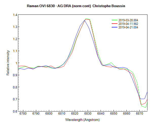

The relative intensities of Balmer lines and HeII line at 4686A are decreasing but that of the Raman OVI line at 6830A remains constant :
AG Dra (Halpha)
AG Dra (Halpha)
agdra_Halpha(normcont)_Christophe Boussin.png (22.39 KiB) Viewed 9723 times

AG Dra (Hbeta)
agdra_Hbeta(normcont)_Christophe Boussin.png (22.88 KiB) Viewed 9723 times
AG Dra (HeII 4686A)
AG Dra (HeII 4686A)
agdra_HeII4686(normcont)_Christophe Boussin.png (21.84 KiB) Viewed 9723 times
AG Dra (Raman OVI 6830A)
agdra_ramanOVI(normcont)_Christophe Boussin.png (23.34 KiB) Viewed 9723 times
