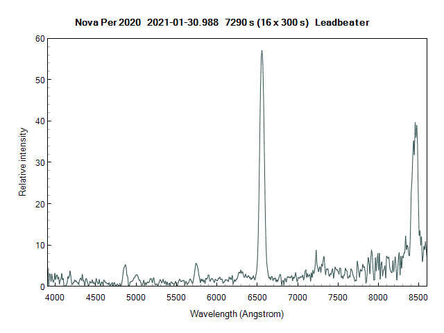

Here's my contribution "recently" (before I got started testing another spectroscope) of Nova Per 2020, taken on
04Jan21 with the LISA-IR and 05Jan21 with my Alpy600 with the modified CCDwindow on my Atik 414ex (3625-9600A):
With Possible line identifications:
(Note: All identified lines are tentative with the exceptions of the balmer and telluric lines)
Without line identifications:

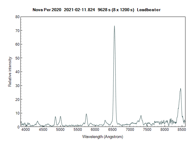

A very noisy, very low resolution (R~130) spectrum with the ALPY200 in bright moonlight and haze
a fresh spectrum of the nova (just completed).
H-alpha emission line is still very strong but its profile has changed a lot in two weeks.

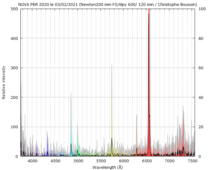

Here is my new update for the monitoring of the nova Per 2020 (finally a new clear sky for several days...). The following spectrum of the Nova Per 2020 was obtained the 3rd of February at 22 h 57 TU with my Alpy 600 (resolution of 516, JJ = 2459249.4564) and an acquisition time of 120 min :
Nova Per 2020 on February 3rd, 2021
_novaper2020_20210203_956_Christophe Boussin_3750_7565.png (65.51 KiB) Viewed 13221 times
What a change since my last spectrum on January 10th !

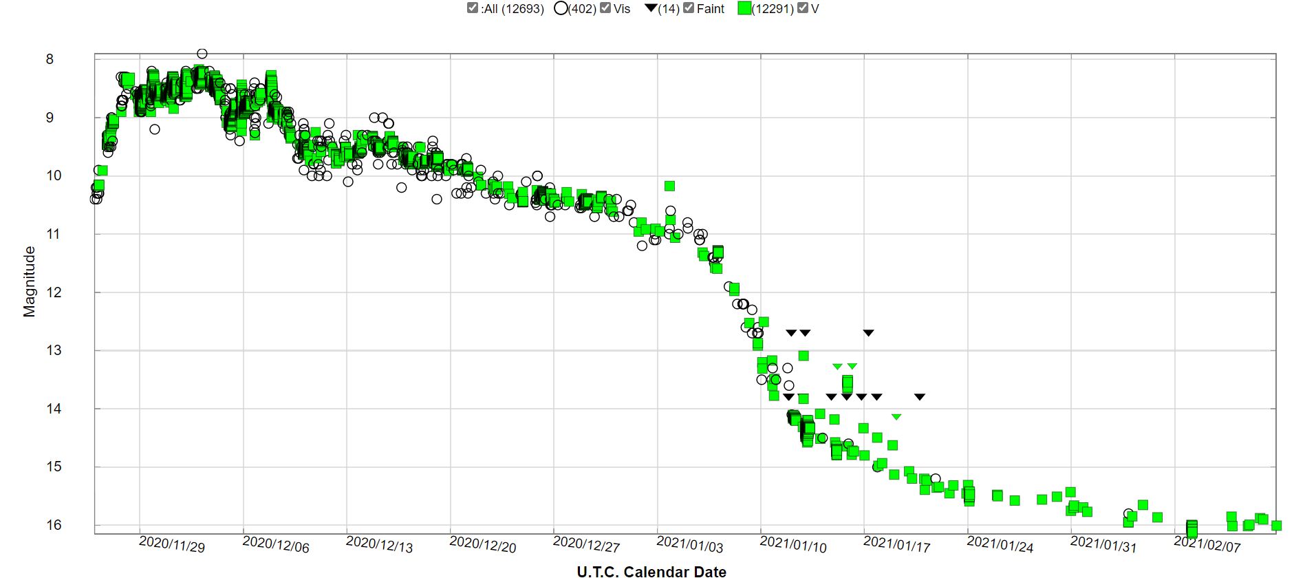

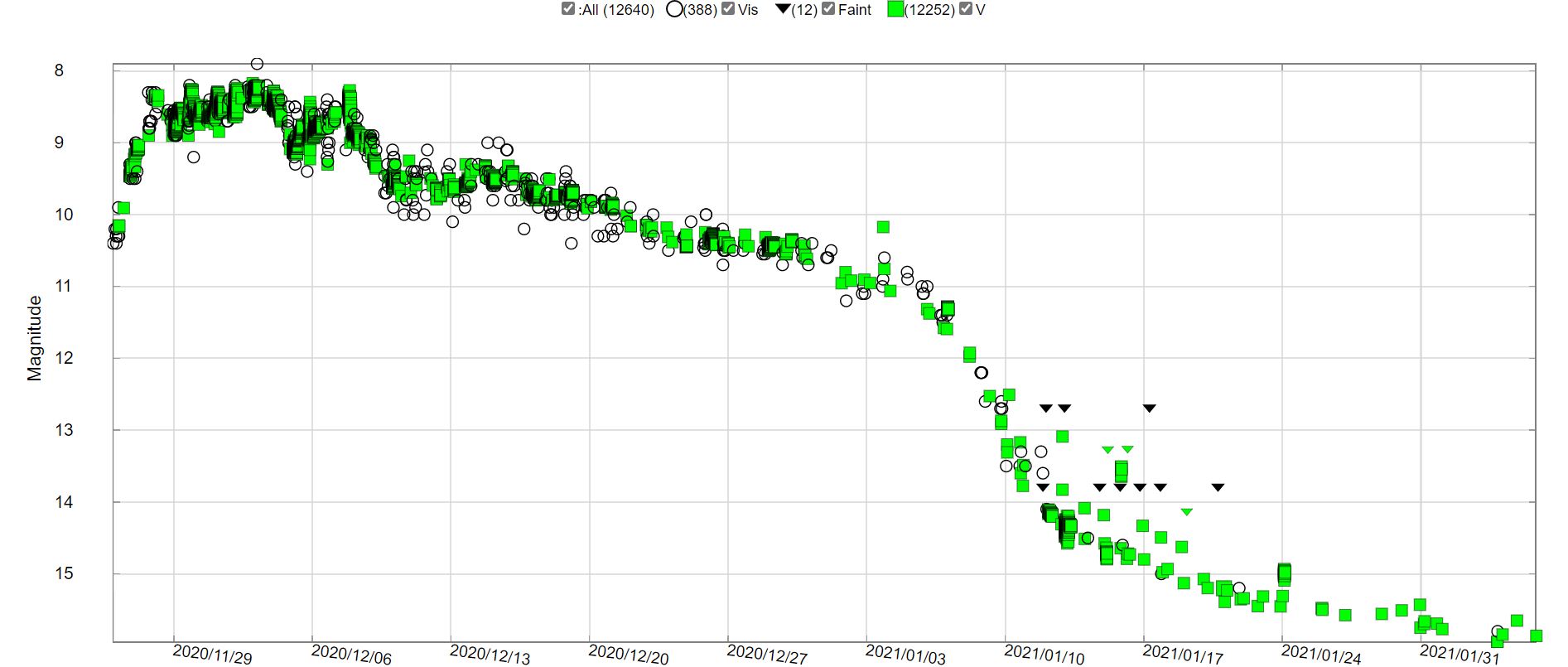

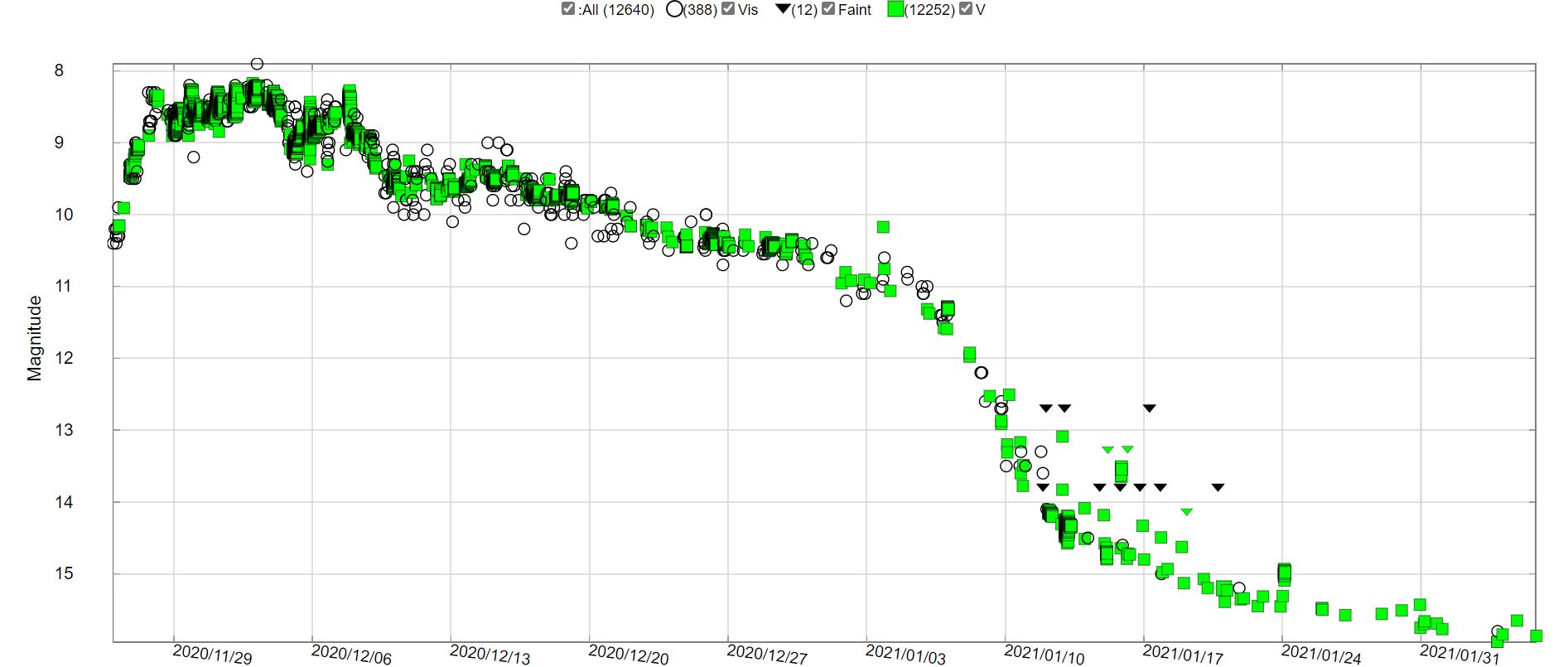

According to the AAVSO website, the magnitude of the Nova is now close to 16, a drop of 3 magnitudes since my previous observation !!
Light curve of the Nova PER 2020 (AAVSO)

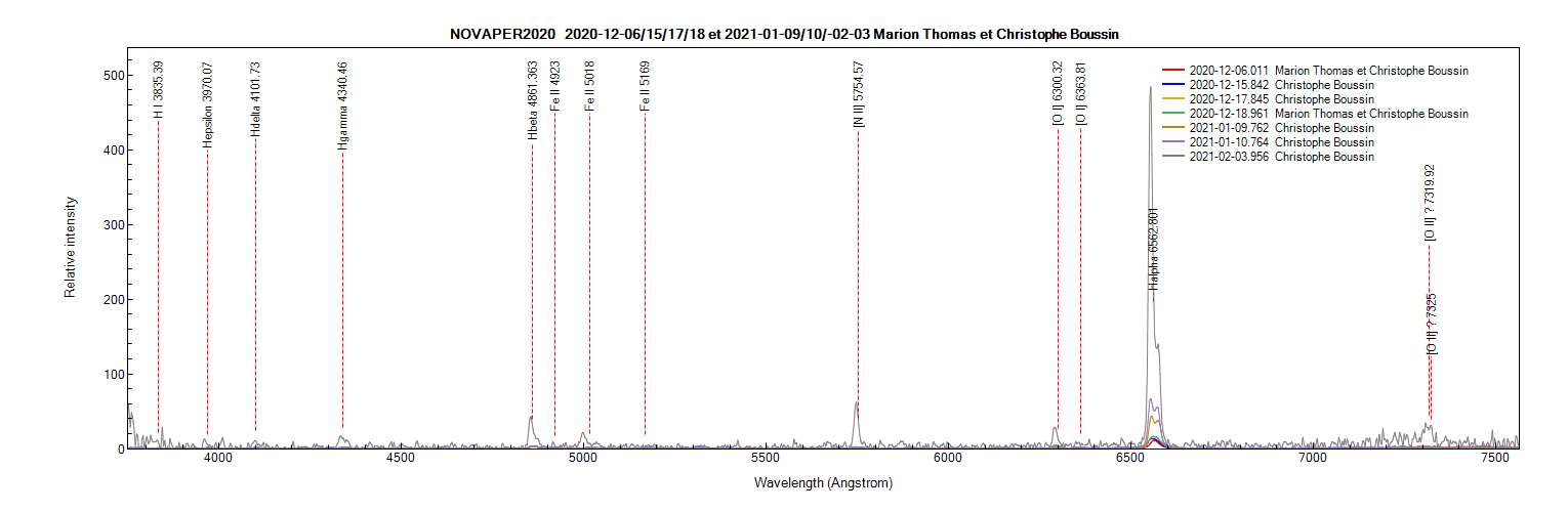

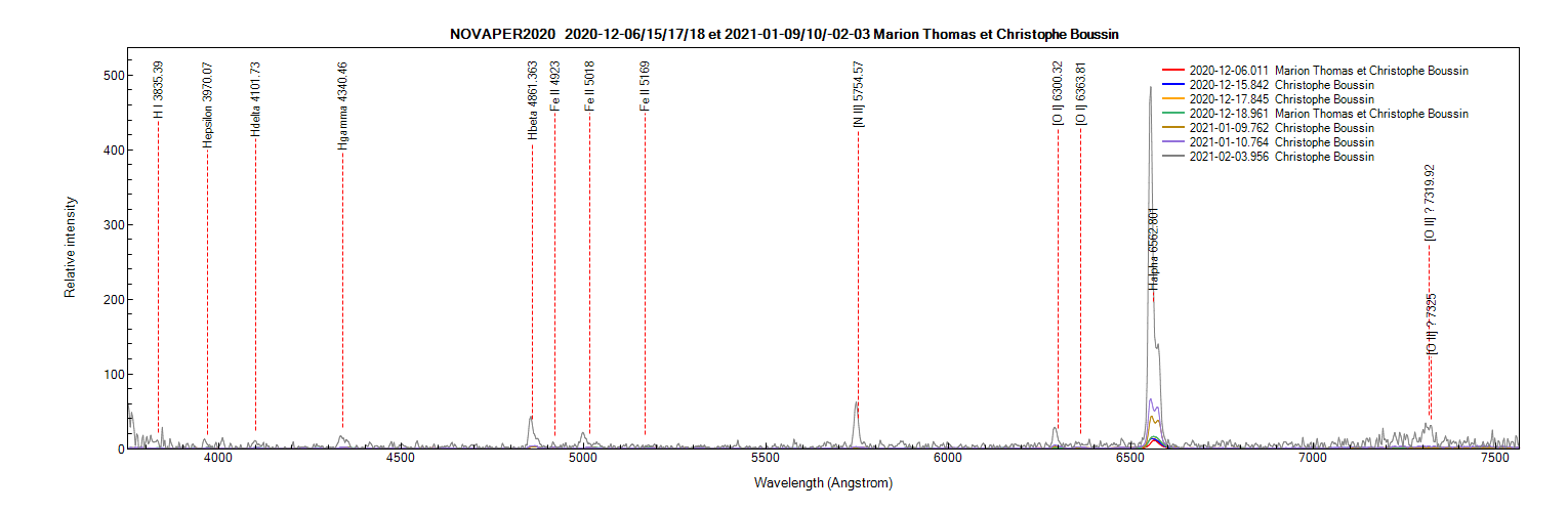

The spectrum obtained is noisy but several changes are clearly visible :
Nova Per 2020 on December 6th, 15th, 17th, 18th, 2020 ; on January 9th, 10th and on February 3rd, 2021 (identification of some lines from PlotSpectra).
It seems to me that the lines [OII] at 7320A and 7325A are now visible in the spectrum... is that correct?

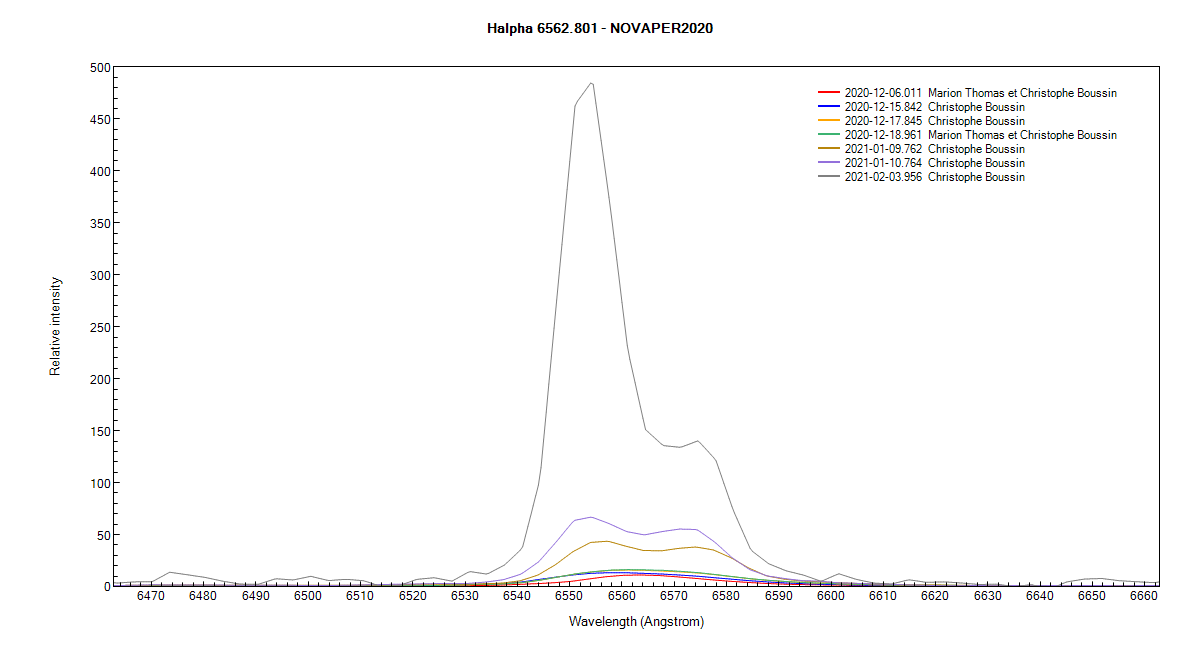

The relative intensity of the "blue" part of the Halpha line is now very clearly greater than the "red" part :
Nova Per 2020 on December 6th, 15th, 17th, 18th, 2020 ; on January 9th, 10th and on February 3rd, 2021 (Halpha line).

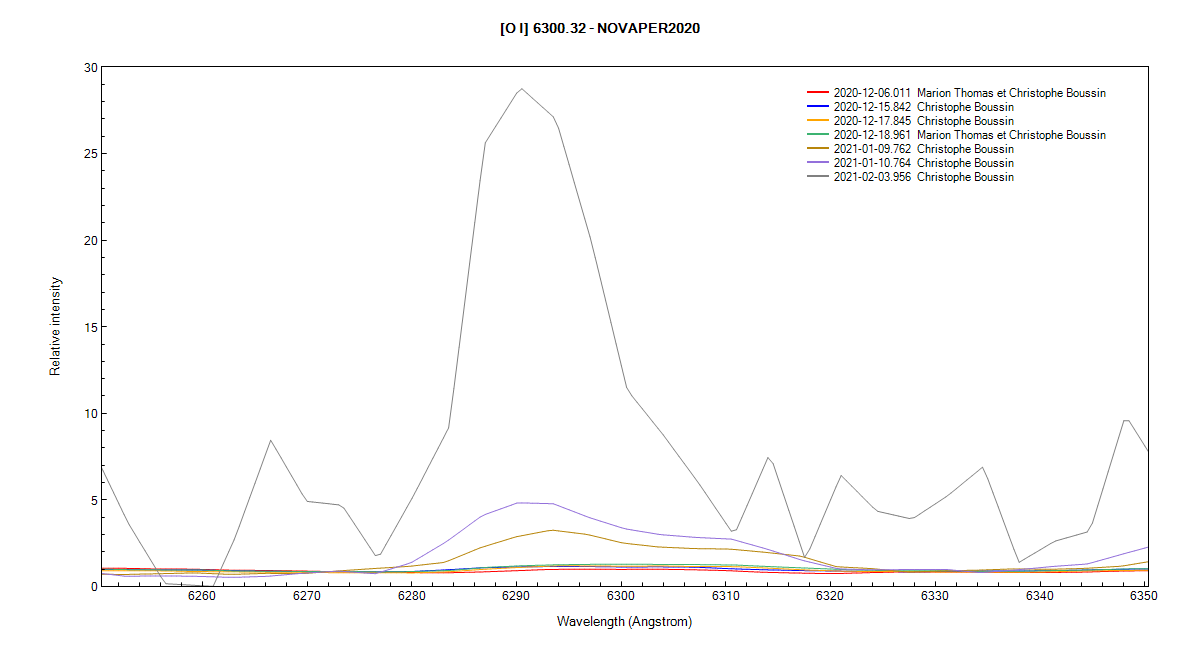

The increase in the relative intensity of the [OI] line at 6300A is more and more visible :
Nova Per 2020 on December 6th, 15th, 17th, 18th, 2020 ; on January 9th, 10th and on February 3rd, 2021 ([OI] line).
novaper2020_20210203_956_Christophe Boussin_OI.png (45.6 KiB) Viewed 13221 times

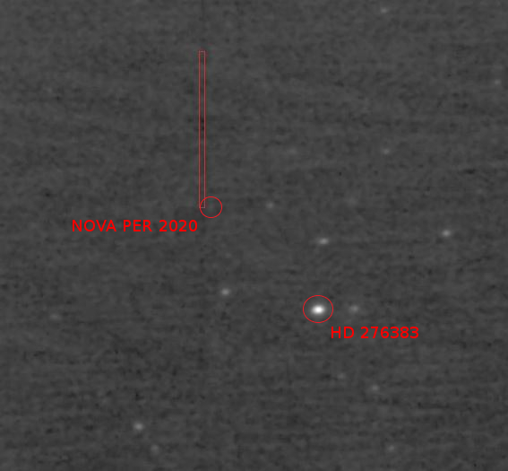

On a very starry night but also very cold night (!!), I succeeded, once again, to position the nova in the slit of my Alpy 600 spectrograph, but the exercise is becoming more and more difficult !
Guiding camera field
According to AAVSO, at the time of observation, the magnitude of the nova is still 16...

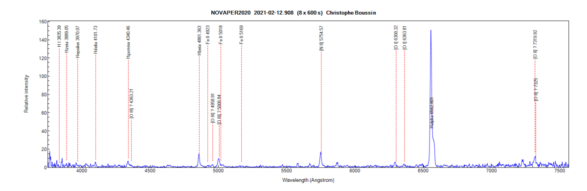

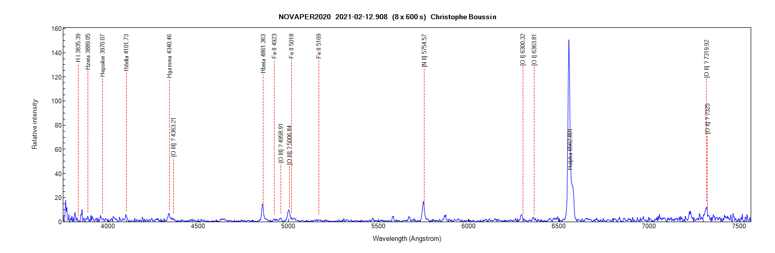

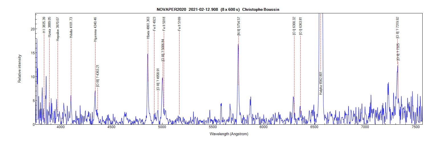

The following spectrum of the Nova Per 2020 was obtained the 12th of February at 21 h 48 TU with my Alpy 600 (resolution of 518, JJ = 2459258.4083) and an acquisition time of 80 min (8 x 600s) :
Nova Per 2020 on February 12th, 2021
_novaper2020_20210212_908_Christophe Boussin_3750_7565.png (80.2 KiB) Viewed 12974 times

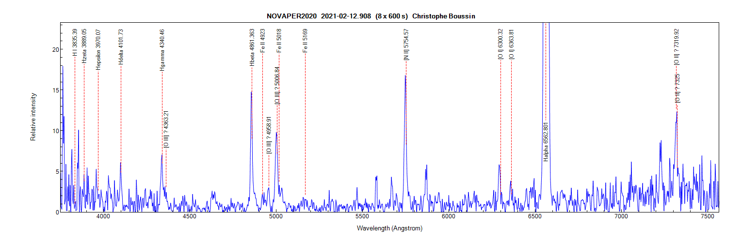

Nova Per 2020 on February 12th, 2021 (identification of some lines from PlotSpectra)
The spectrum is noisy but it seems to me that the [OIII] lines are starting to be visible...

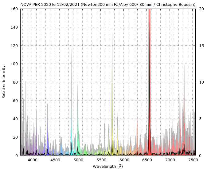

Nova Per 2020 on February 12th, 2021 (zoom)

Congratulations for your very nice spectra! The nova is so faint...
In the latest spectra it seems the [O III] doublet has grown. The broad 5007A line is clear (prominent blue peak), the 4959A line is weaker but visible. Typical intensity ratio is ~3:1.
