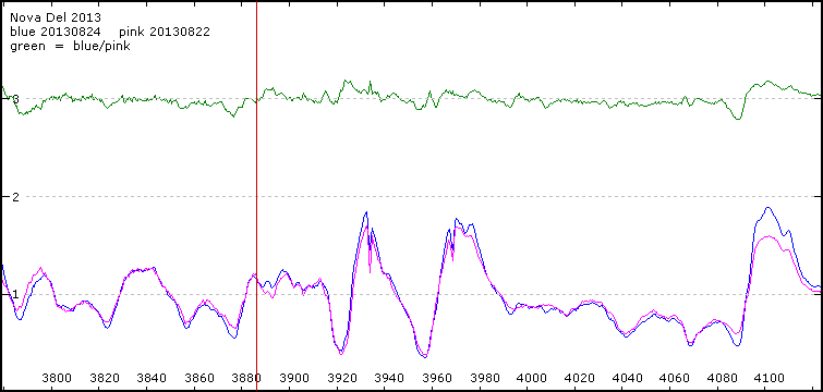

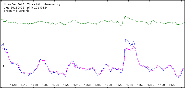

Christian Buil wrote:S
Some variation (note a feature at 4385.5 A) but not CN line at 4216 A for the
moment.
Nothing at 3886A either yet

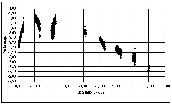

In the context of Martin´s and my post (121&122) here a Vmag observation series of Ulrich Schmidt (Berlin-Association-of-Variable-Stars, BAV-Germany) as comparison to the 8mag star GSC 16432278.
http://www.astronomie.de/astronomische-fachgebiete
Christian Buil wrote: Some variation (note a feature at 4385.5 A) but not CN line at 4216 A for the
moment.
Confirmed in my spectra on these nights (A small P Cygni feature appears in the difference at ~4381/4386 but nothing obvious at 4216)

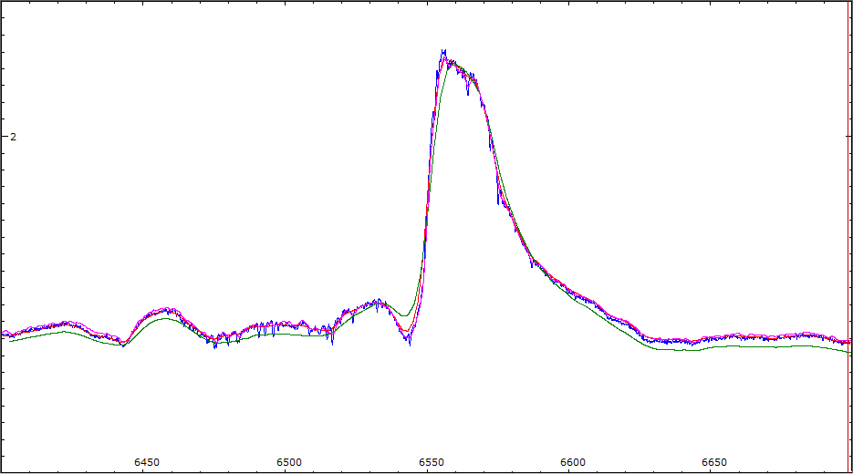

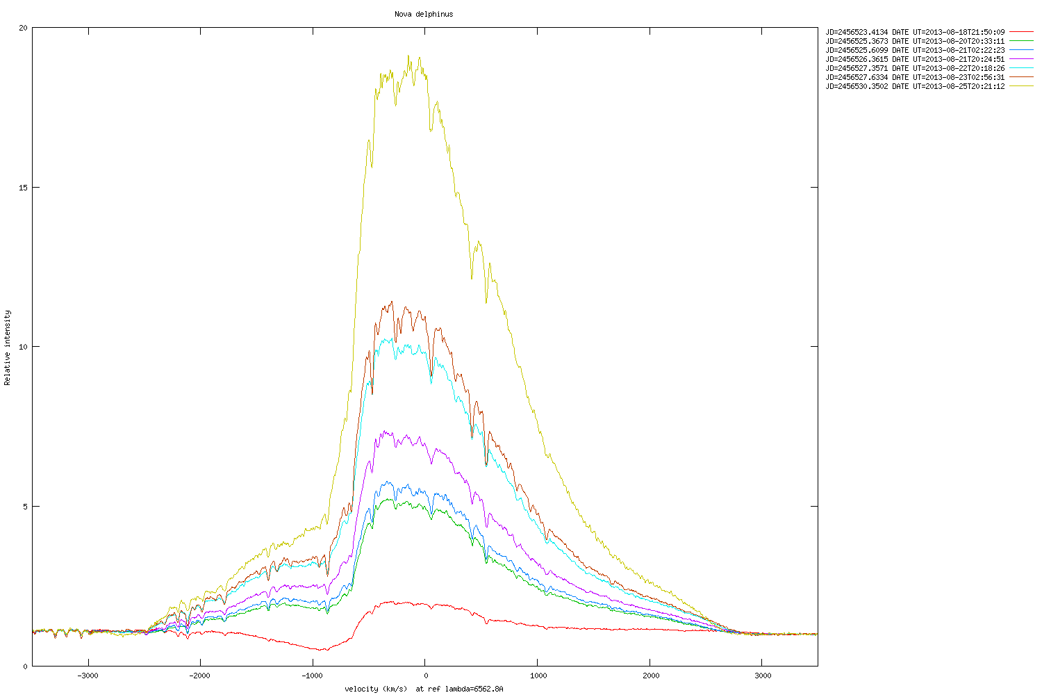

Just one very short observation tonight, in a small hole after rain.
4x90s, C14 + eShell. The H alpha is up du 18x the continium level now !
I post the data to Francois.
Regards
Thierry Lemoult
Comparaison de différentes résolutions
H alpha
Le 19 08 2013
- Thierry Lemoult R = 11000 Bleu
- Paolo Berardi R = 2500 Violet
- François Teyssier R = 1000 Rouge
- Olivier Thizy R = 600 (décalé de + 2 A) Vert

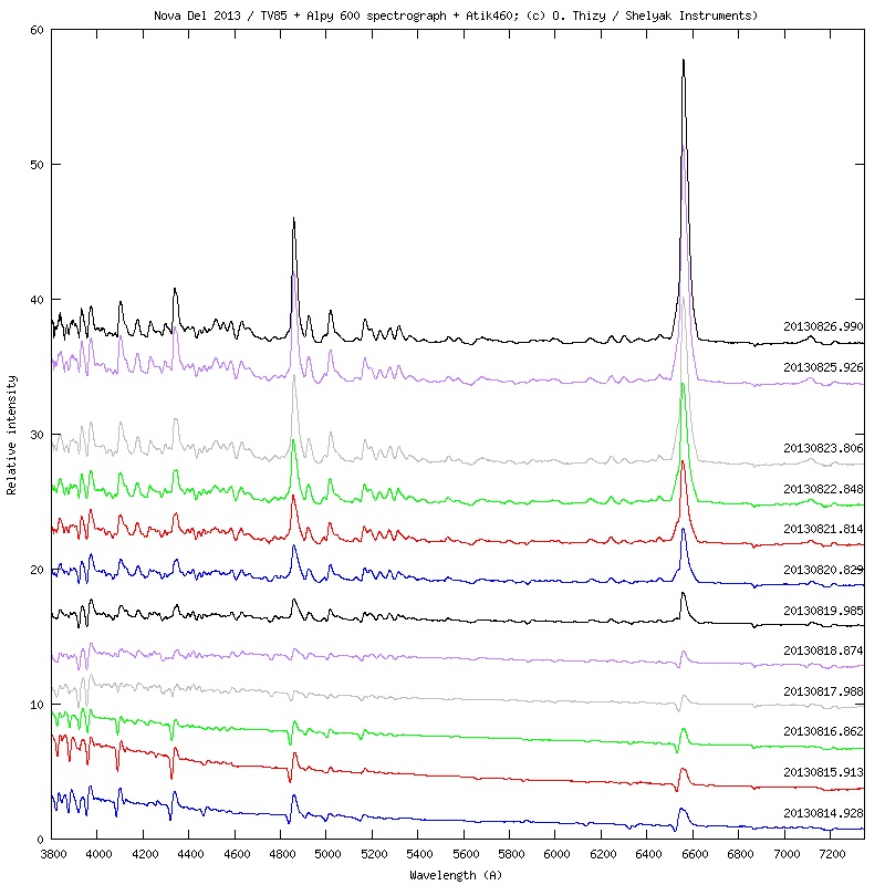

Post by Olivier Thizy »
Evolution of the nova - Halpha continues to rise...

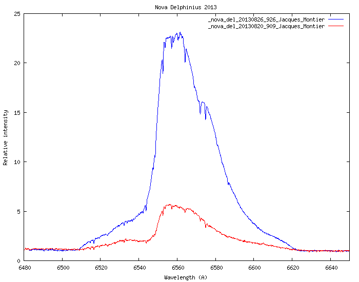

Post by Jacques Montier »
Hello everybody,
Halpha spectrum of the last night with Lhires III 2400 t/mm and comparison with the 20130820 H alpha.
H alpha rising is very spectacular !
Jacques Montier
