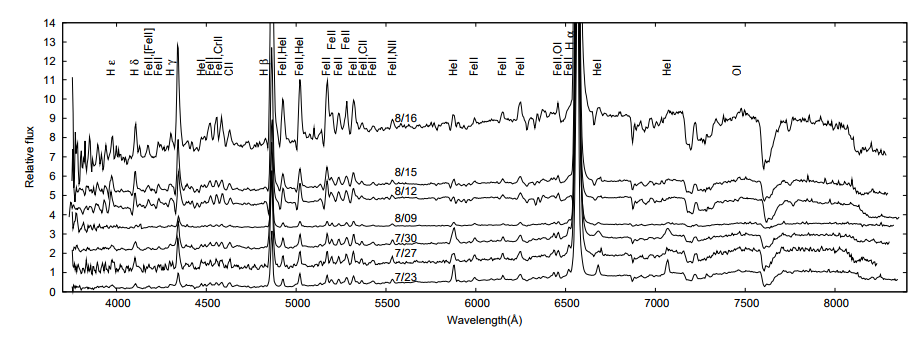

- Posts: 458
Thanks for the head-up François on the ATel message for this interesting object!
Here is a spectra I took of this object from my high altitude (2500 meter elevation) dark sky site on 27Aug17:
Shot with a 33cm aperture classical cassegrain telescope working at F/7.5 with LISA spectroscope using a 23micron slit.
According to the AASVO this object is continuing to rise in magnitude...up to V=9! I'll try to get more spectra after I re-tune the
LISA for my 45cm aperture telescope at home....alas under much worse conditions (15 km from downtown LA near sea level).

- Posts: 1562
Hi James,
Nice spectrum! It is welcome in the data base, you've just to send it.
The identification is globally correct. Of course, He I 4922 is blended with Fe II 4924 (42)
But, not for [Fe VI], for two raisons:
1) The ejecta is still optically thick, very thick, so no "forbidden" lines (collisionnaly excited lines) which require much lower density
2) The hot object (expended envelop of the white dwarf) isn't sufficiently hot at this stade to produce high ionization
Fe VI needs 100 eV photons (about 100 000 K)
Late August, T* is about 20000 K at a first order
See http://www.astronomie-amateur.fr/Docume ... sation.pdf

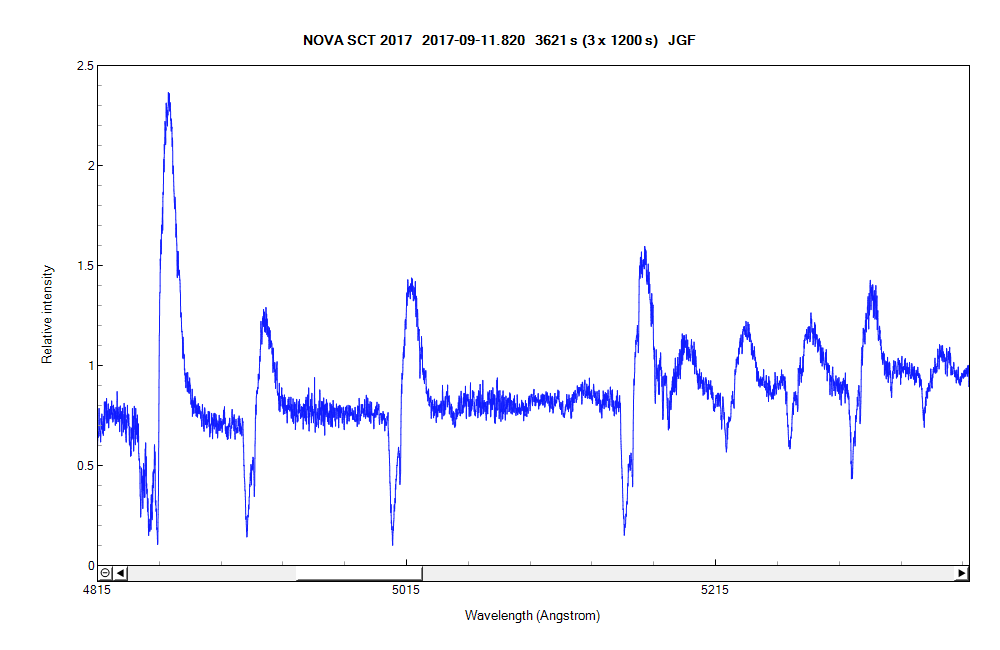

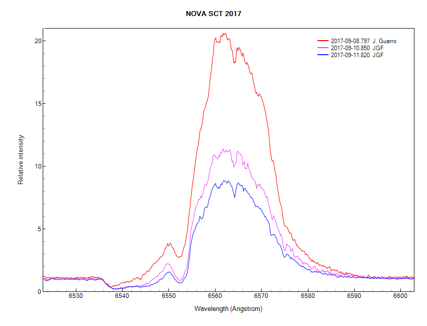

- Posts: 731
These is a new graphic of Nova Sct 2017.
Joan.
Joan.
- novasct2017_20170911J. Guarro.png (38.91 KiB) Viewed 9769 times
- novasct2017_20170911J. Guarro2.png (61.34 KiB) Viewed 9769 times

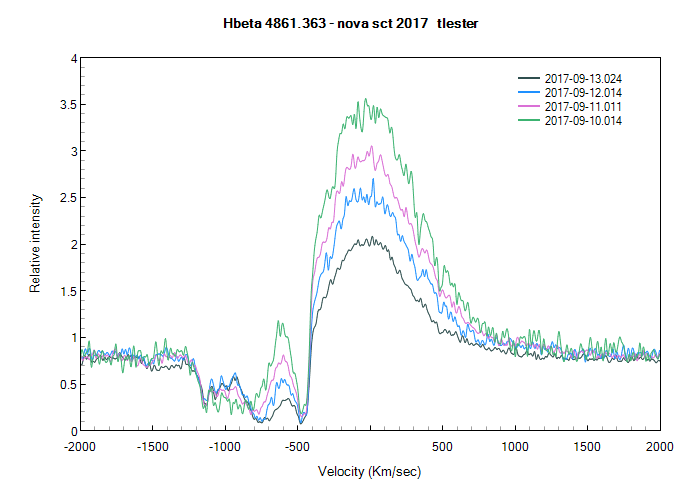

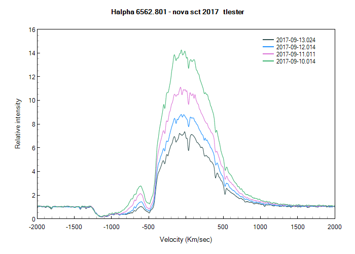

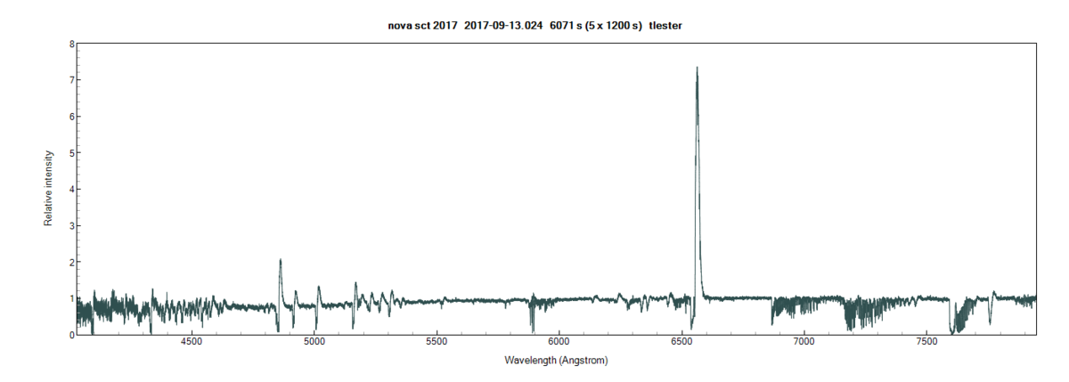

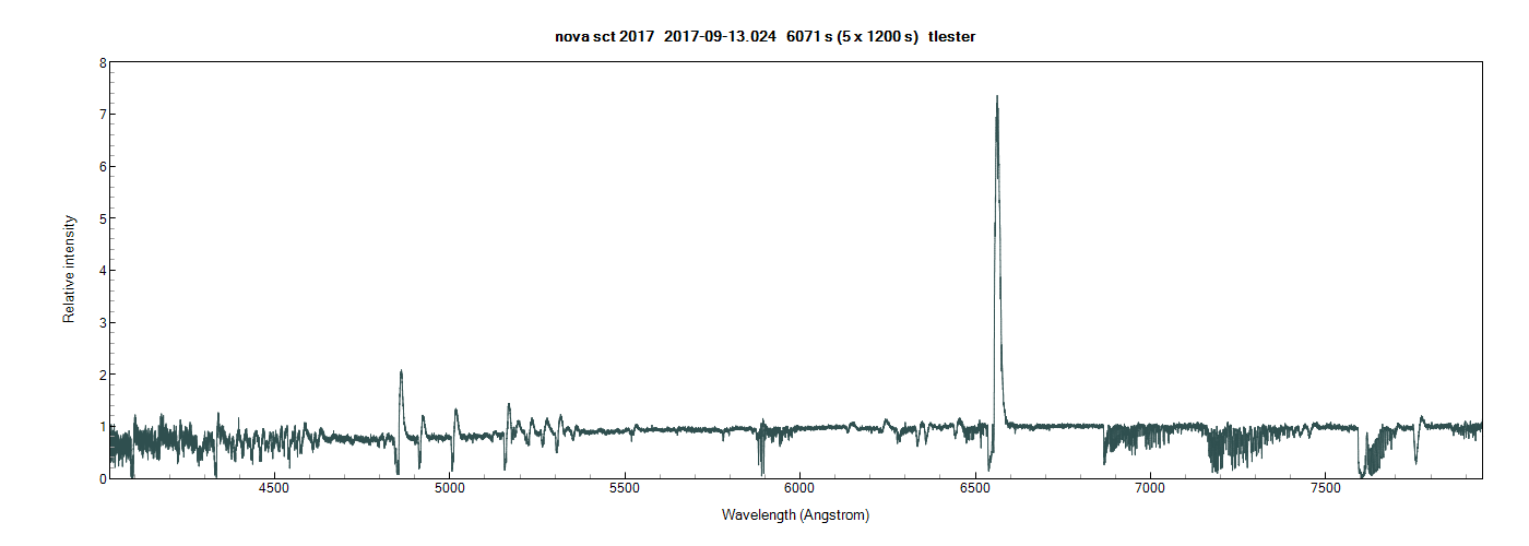

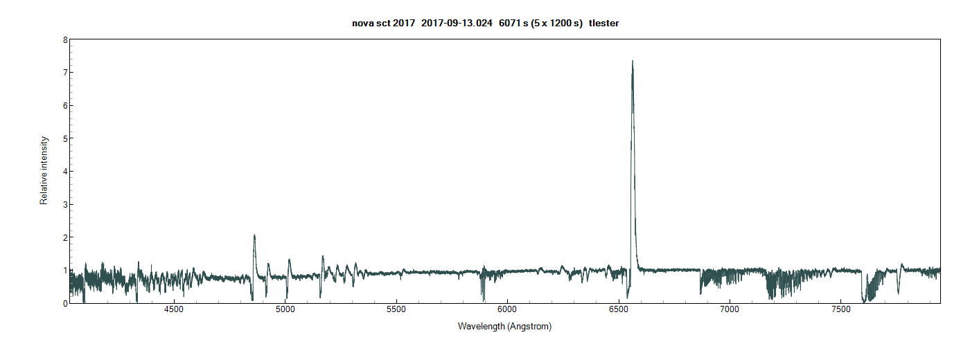

Tim Lester
- Posts: 168
- Location: Arnprior Ontario
Here is nova sct 2017 for Sept 13th. Halpha and Hbeta for the last 4 nights. Tim
- Posts: 458
Nice high resolution Ha & Hb spectrum Tim!
I was wondering how you compute the velocity plots for the Ha & Hb spectra?
Do you compensate for any rotation and/or RV before you plot multiple dates?
Its one of the items I need to teach myself as I start to use the Lhires III I'm ready to work with.
I'll shoot one or two more LISA spectra of this star then experiment with the 2400 and 1800 mm/l gratings
I have with the Lhires III.

Tim Lester
- Posts: 168
James,
I use the velocity plot feature of PlotSpectra and simply choose the listed Halpha or Hbeta as the center point on the chart settings dialog.
I do correct for Heliocentric radial velocity when I process the spectra with ISIS but generally nothing more.
PlotSpectra is available here: https://1drv.ms/f/s!AvXqhKI5kEGRjEhdaQ6jaj8AHx_L

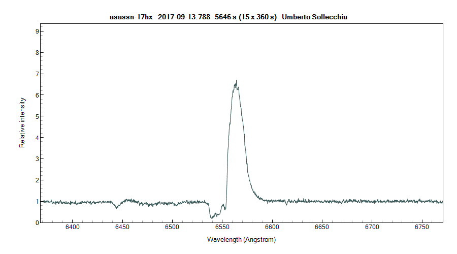

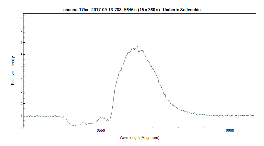

- Posts: 248
Bonne journée à tous, place le profil de la nuit du 13-09-2017, pris avec un spectroscope construit par notre cher ami amateur Joan Guarro Flo.
