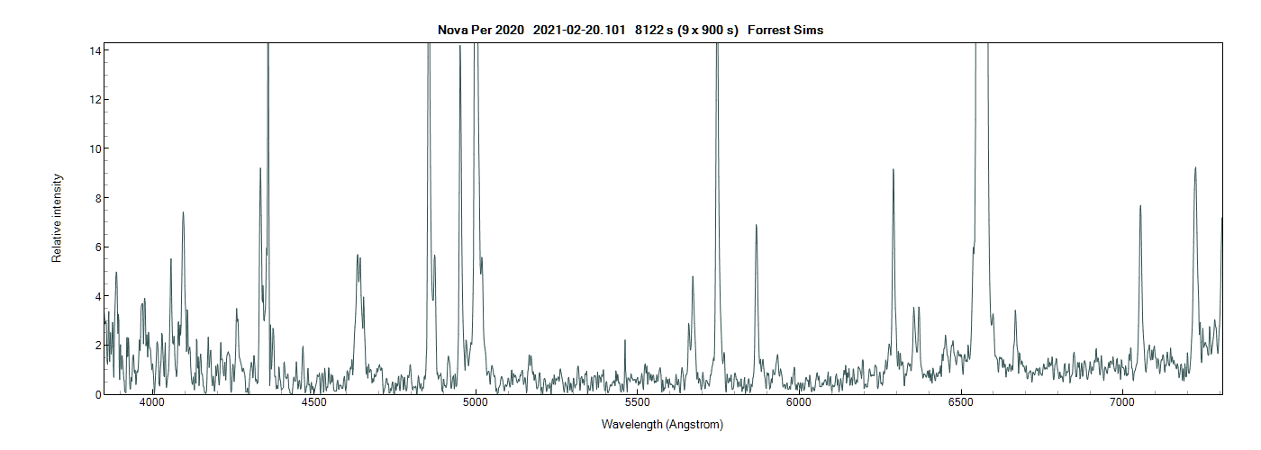

Here is my latest spectrum of Nova Per 2020. This is a single 900 sec exposure.
Nova Per 2020 900 sec binning zone.PNG (40.37 KiB) Viewed 14004 times

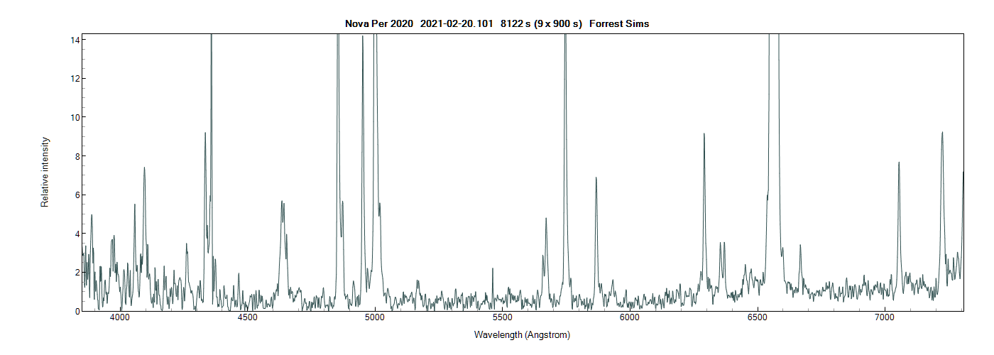

As Paolo and Christophe have noted the target is very dim now. If it were not for the strong Halpha, Hbeta and some of the Oxygen emissions the star would be invisible with my telescope aperture. David Boyd measured the V mag at 16.0 the night before my spectrum. I used a similar technique as Paolo described, using 3 sec LodestarX2 guide exposures to move the target into the center of the slit (so that it disappears completely). And then quickly start autoguiding on a nearby star and with fingers crossed hoping for the best until you see the first image. I took 900 sec science exposures so it was a long wait but worth it as you can see in the following plots.
Nova Per 2020 with (9) 900 sec exposures. I have zoom in a bit in PlotSpectra to more clearly show the emission lines above the continuum.

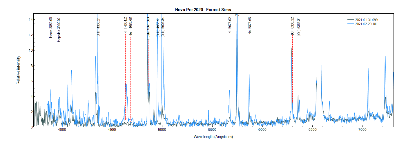

And in this graph you can see the significant increase in the magnitude of emission lines and some new lines compared to a spectrum I took in January. I have made an attempt at line identification. Perhaps others can correct and or add lines? The "feature" at 5641Å is not real and sits exactly on one of my light pollution lines:(
Good weather to all!
Woody

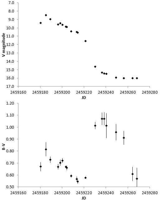

From my B and V photometry of the nova, it appears that it has now recovered from the reddening episode which began as the nova faded around JD 2459225. Were the fading and reddening the result of dust emission?

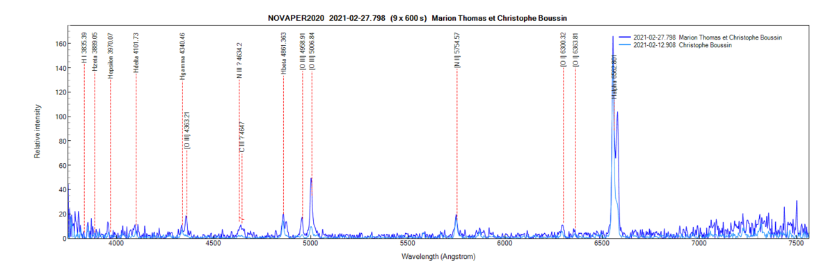

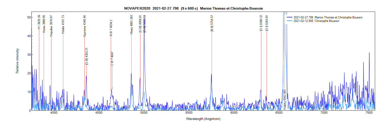

Hi Paolo, your wish has also been heard and here I'm finally back as a team with Marion for a new spectrum of the nova Per 2020. I hope you will do the next one with higher resolution !
Hi Woody, congratulations for your very nice spectra !
I also hope that you can follow the nova for as long as possible with a much more favorable sky than mine !

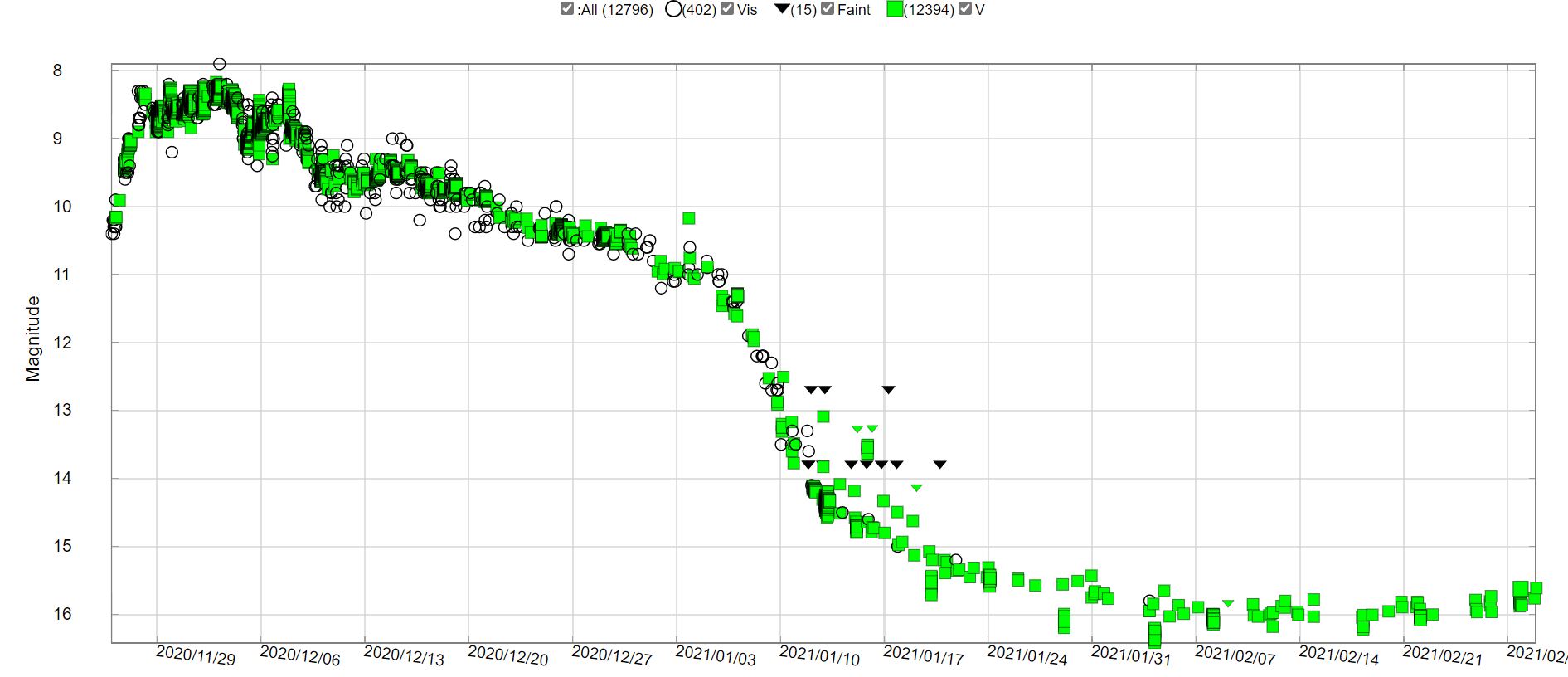

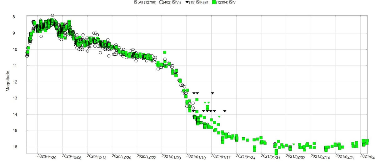

As David noted, the magnitude of the Nova, still close to 16, now appears to be very slowly decreasing...
Light curve of the Nova PER 2020 (AAVSO)

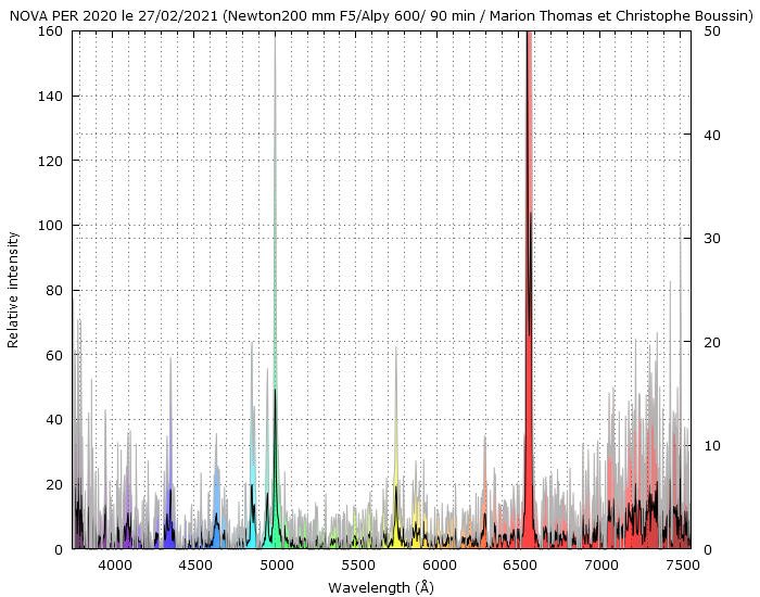

The following spectrum of the Nova Per 2020 was obtained the 27th of February at 19 h 08 TU with an Alpy 600 (resolution of 506, JJ = 2459273.2976) and an acquisition time of 90 min (9 x 600s) :
Nova Per 2020 on February 27th, 2021
_novaper2020_20210227_798_Marion Thomas et Christophe Boussin_3750_7565.png (83.69 KiB) Viewed 13890 times
Due to the presence of the full moon, the acquisition conditions were much less favorable than on February 12th !!
Nevertheless, we can notice several notable changes in the spectrum ...

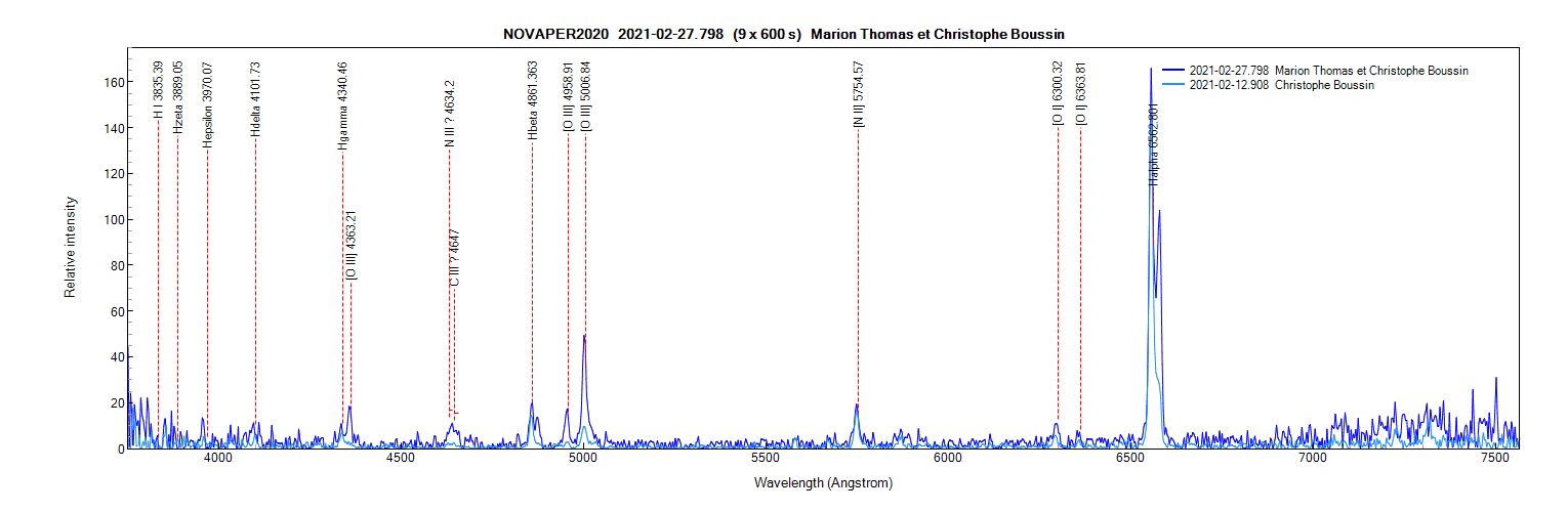

Nova Per 2020 on February 12th and 27th, 2021 (identification of some lines from PlotSpectra)

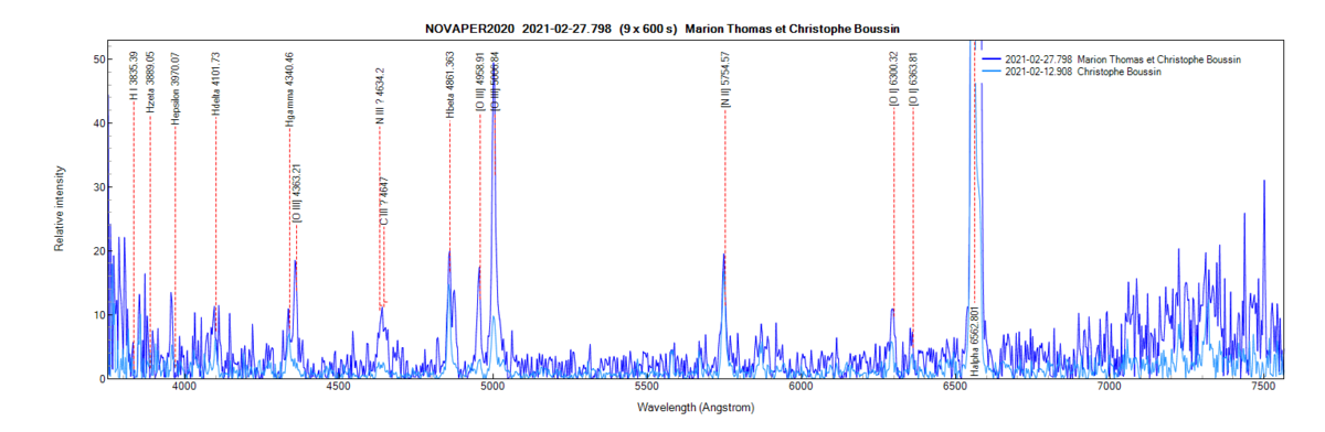

Nova Per 2020 on February 12th and 27th, 2021 (zoom)
The double peak shape of the Halpha line is very obvious and seems to be visible in the Hbeta line as well. It's more difficult to say with the Hgamma line since it must be blended with the [OIII] line at 4363A...
The [OIII] lines at 4959 and 5007A are now clearly visible and the relative intensities of these lines have increased notably since February 12 !
Could it be that the NIII and CIII lines become visible ?
