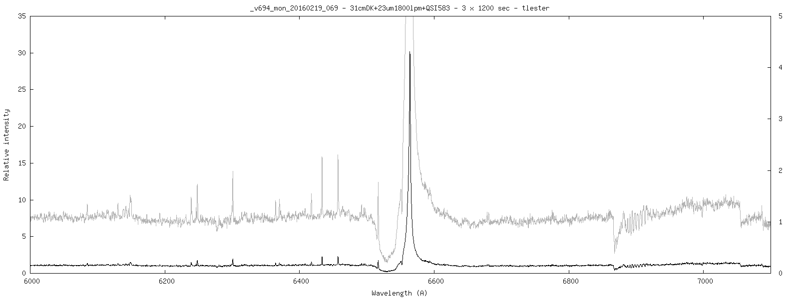

Here is my result for 2016/02/19. 6000 to 7100 ang, R = 9000. (Ambient temp. -19C!)
I used the Cflib spectra for the star HD59984 to calibrate response. It is a mag. 5.9 F5V star that is 2 degrees away from V694 Mon.
The average altitudes differed by less than 1 deg during acquisition.
