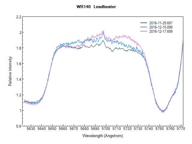

Hi all, congratulations for you spectra! Joan, the comparison for 30 november is impressive... so the spectrographs really works! ;)
Changes in the CIII line between 23 nov and 12 dec:
Re: WR140 aproaching periastron
Colliding winds effect on the CIII line is more pronounced now (green profile is the just finished observation).

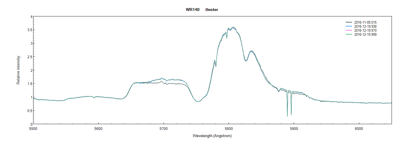

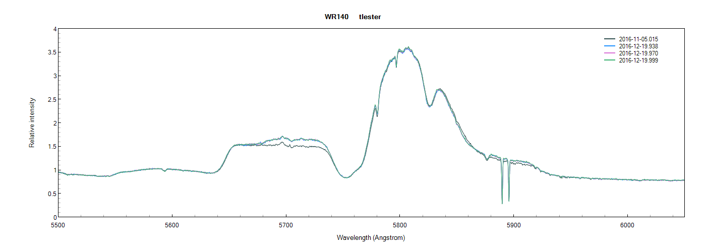

WR140 for Dec 19th compared to my last exposure on Nov 5th.
Took three sets of 3x10 min exposures. No discernible change over the three sets.

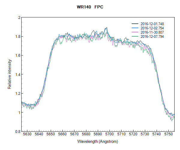

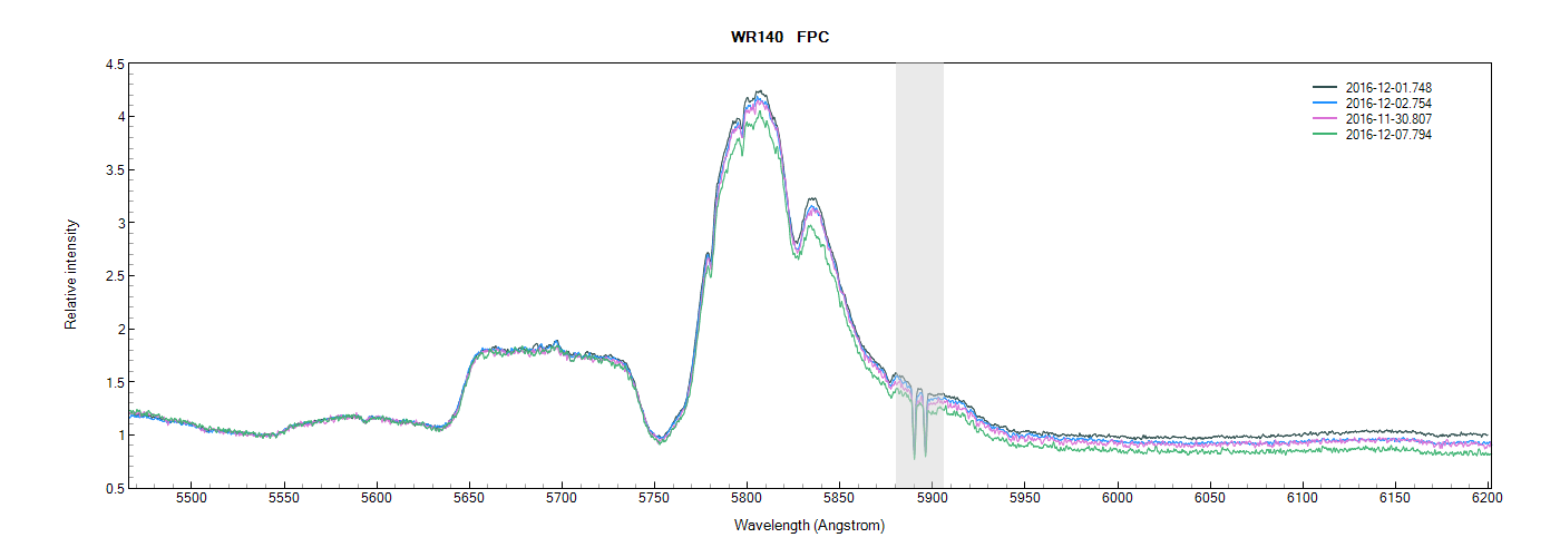

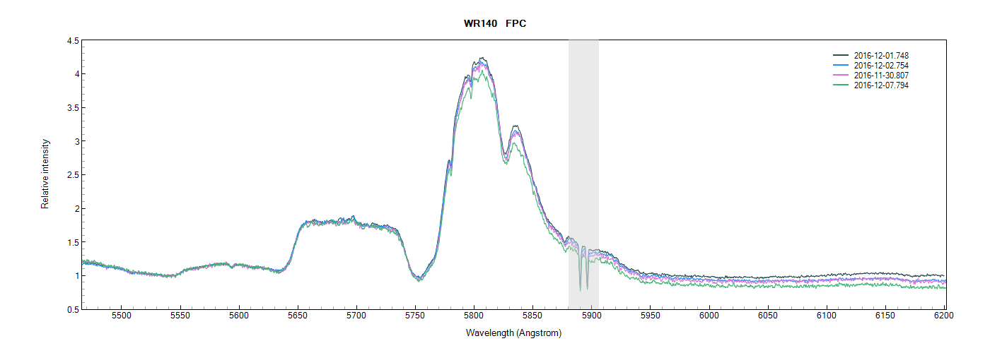

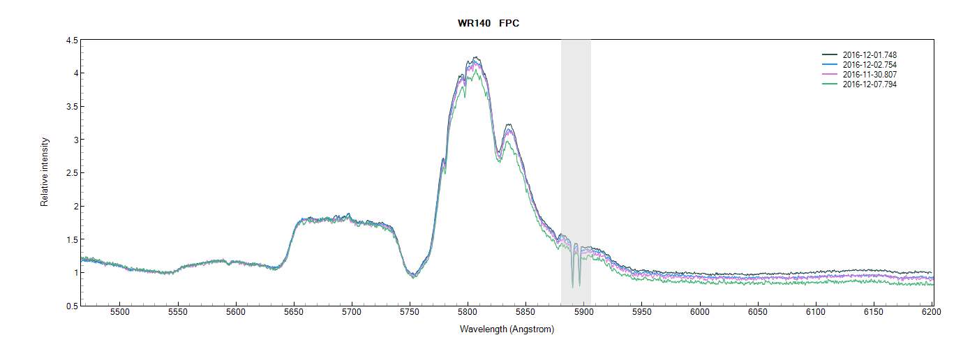

I tried to reduce my spectra but I'm doing something bad. As you see, there is a strong dispersion between the spectra except at the lambda utilised to normalize them. All spectra are corrected in response using HIP 99870.
I tried also to compare all spectra with a well corrected pattern but these differences remain. What is very curious is: why when I find the instrumental response in low-resolution spectra and correct the comparison star, the corrected spectrum matchs exactly the library's spectrum, but when working at medium-resolution this one doesn't happens. Maybe have I something bad-configured in ISIS?
Anyway, after a couple of days without observing (bad weather and other problems), tonight I resume the monitoring of WR140, but I need to know how to erase these deviations at high lambda...
Greetings
Fran
wr140_ 20161201_748_FPC sub.png (39.14 KiB) Viewed 8982 times
Hi Fran,
That is strange. How much does your instrument response vary? I do not think the instrument response changes much between observations at this wavelength and over this short range. How do the spectra compare if you reduce them without instrument response correction ?
