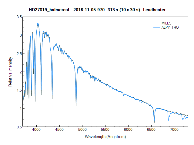

Bonjour Michel
Je ne vois pas les artefacts dans le continuum avec l'ALPY. Avez-vous un exemple?Michel Verlinden wrote: Avec l'Alpy on a toujours des artéfacts qui ne disparaissent pas après correction par la réponse instrumentale. Quelle est d'ailleurs la cause de ces artéfacts ?
- hd27819_balmercal_ 20161105_970_Leadbeater.png (37.28 KiB) Viewed 12672 times

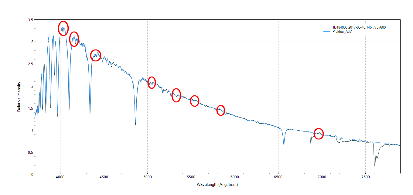

Hello Robin,
Here is an example: Iota Cyg. The artefacts are indicated (red circles) .
My question is not my cup of tea : noise, not perfect autoguiding (form of lines), fails in the treatment ?

Hi Michel,
These small differences could be real. The Pickles spectra are typical averages for a particular spectral class. The details in the actual spectrum of a star will vary with metallicity, relative abundance of the elements. My comparison is with a professional measurement of the same star from the MILES catalogueMichel Verlinden wrote: Here is an example: Iota Cyg. The artefacts are indicated (red circles) .
