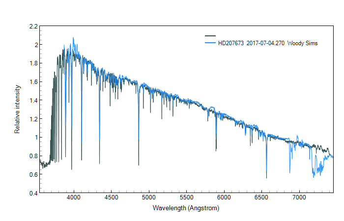

Umberto and Paulo, Many thanks. I hope I have not hijacked this thread with my questions on this curve. I will try a different Reference Star. Umberto I do see that the star you used HD179761 is in the MILES database. I do not see it in the search list for this transient target when I use either the MILES_Search_V1 tool nor the ReferenceStarFinder Excel tools. However as you suggest I will use a different star. Here is my response corrected profile curve for HD207673 (A2Ib) and also plotted the MILES profile curve from the ISIS database. They appear to be a pretty good match from 4200Å to 5900Å.
Paulo, I currently do not have a second monochrome camera to use with my Astrodon Johnson/Cousins Photometric V Band filter to obtain the V magnitude of our target. When I do get one I can use a second OTA for measuring the V magnitude. Until then, how much error do you think I would have if I used your recent measured V magnitude with my spectrum data. Is this what Umberto is using? Would this be useful with my spectrum data or way too inaccurate?
I can see in the two curves I uploaded that I need to learn more about how to slice out parts of my curve to the right of 6800Å with the ISIS Continuum tool to get a better match with the MILES curve.

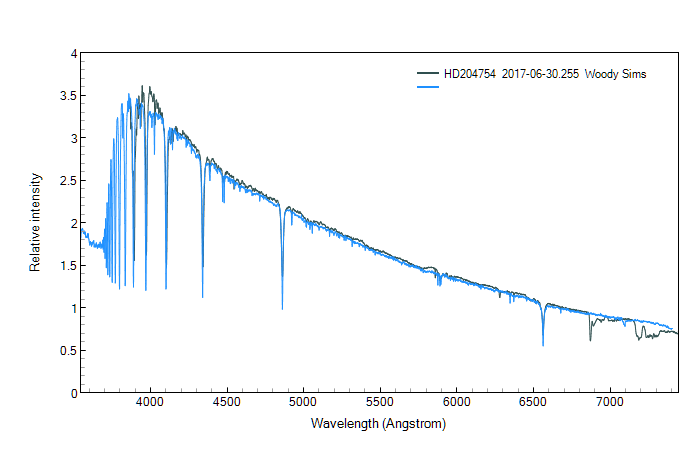

Woody, your fit is certainly valid (just a small excess around 4000A). The starlight from HD207673 seems to me very reddened for an A2 class star (see the flattened continuum and the Na D deep absorption), although the Miles catalog report E(B-V)=0. Anyway, if the library profile is the observed spectrum (like any other one in the ISIS library), your calibration is correct. You should have confirmation if you calibrate the nova spectrum with another Miles star. If not, we can try to observe and calibrate HD207673 with a response curve calculated with another Miles star, then compare it with the library profile.

Paolo, I have read you comments and spent some time thinking on your suggestions which sends me off to read and slowly increase my understanding:) Unfortunately our weather forecast is for cloudy nights for the next week. So it gives me time to look at old data and study. I pulled up my Reference star HD204754 data that I used for the assassin-17hx target on 30 June. Using Tim Lester's PlotSpectra I have two curves. The response corrected HD204754 and the MILES fits file in the ISIS database. I see the similar (small excess around 4000Å) and also the absorption lines for Na D at about 5890Å and 5895Å differences between my response corrected curve and the MILES curve. See attached plot.
The excess around 4000Å is a bit puzzling. I will have to keep and eye on this to see if I can determine the cause.

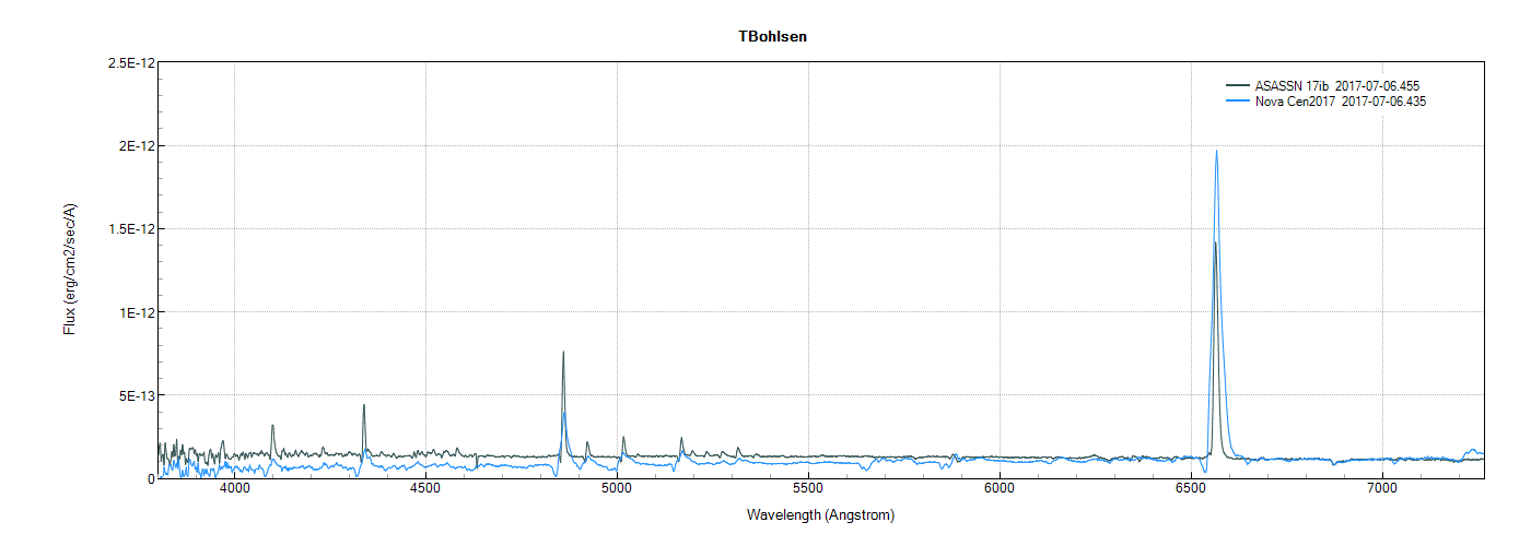

I took my first spectrum of this nova last night as well as the one in Centaurus. Below is the comparison. Very similar levels at the same time.
Terry
