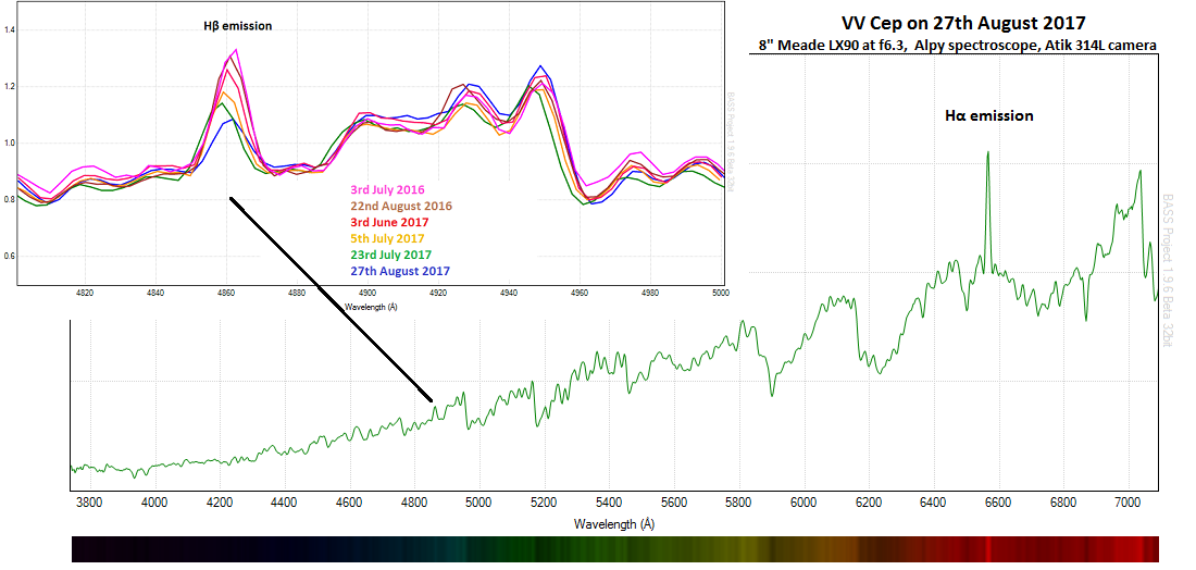

I made my last observation on 27th August and chose to look at the evolution since last year of the Hβ emission in the attached graphic. I have scaled the curves to normalise on a region around 4890Å. The eclipse seems to be well underway....
Hugh Allen

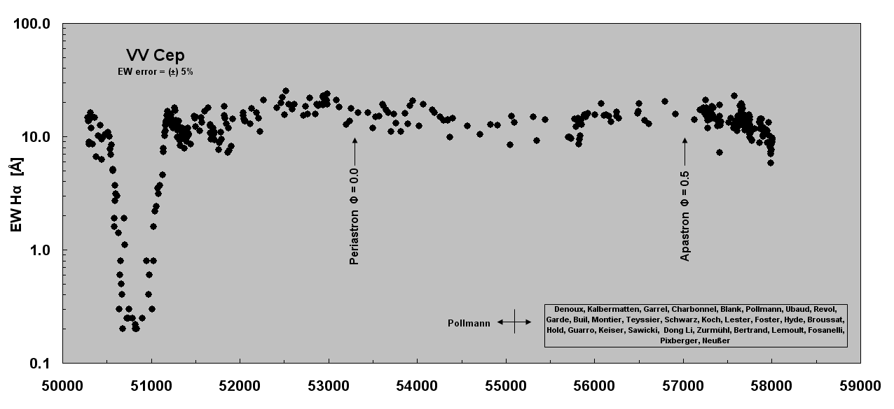

Phil Bennett wrote here:
Since we are now in atmospheric eclipse, any variation in the M star size due to pulsation would be expected to modulate the transmitted H-alpha flux (from the vicinity of the B star) correspondingly.
The attached plot gives an impression of the long-term process of the eclipse. The duration from the first to the second contact took approx. 165 days (~ 5.5 month) in 1997. That means a decrease of ~ 2 Å/month for Hα.
As you can see in that plot, this time the definition of the first contact is very difficult. If we would estimate this at ~ 2457900 (end of May), then the second contact would be to expect ~ at the end of October.
Ernst

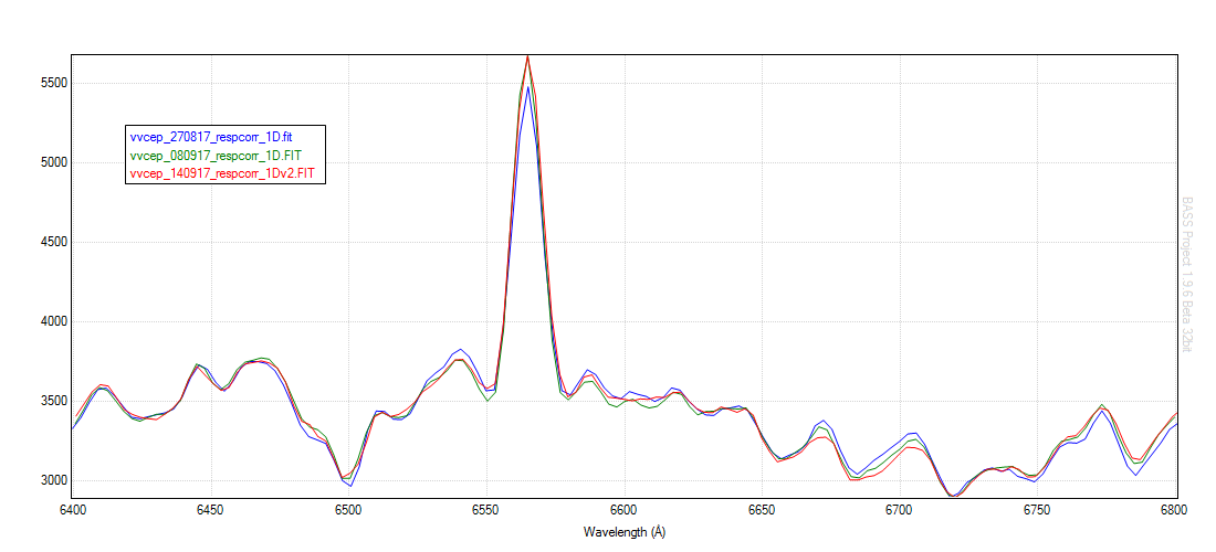

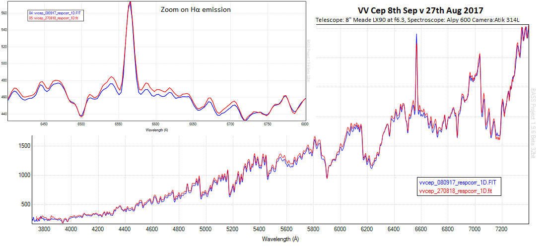

Thanks Ernst for your interesting feedback. I captured another spectrum on Thursday night with again little apparent change in the Hα intensity
Hugh Allen

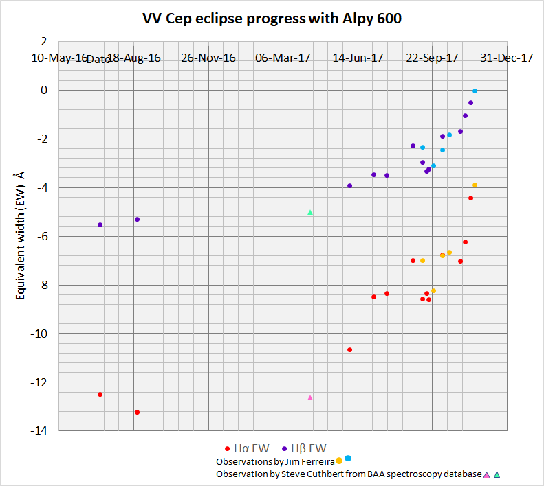

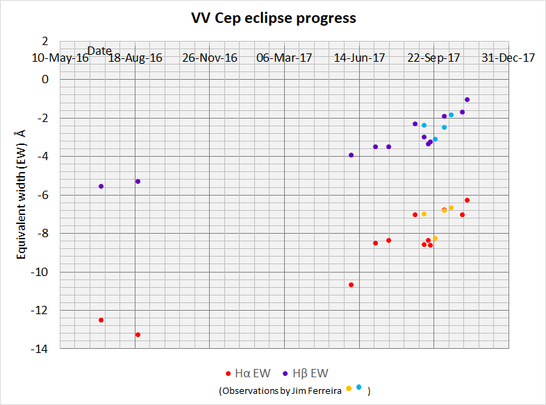

I have plotted my estimates of the evolution of the Hα and Hβ equivalent width (EW) since my first VV Cep observations in summer 2016 - I just wish I had made more observations before the summer of 2017 to get a longer baseline. Jim Ferreira was kind enough to let me also include several of his own recent Alpy 600 spectra:
VV Cep Hα and Hβ EW evolution Jul 16 - Nov 17.png (26.29 KiB) Viewed 25081 times
To calculate the EW values I converted the spectra intensity scales from relative to absolute flux. I used a Vmag light curve generated from the AAVSO database to obtain an estimate of the Vmag on any given date. I converted from relative to absolute flux using the calculator in BASS.
The on-going decline in EW is clearly visible, along with occasional periods of re-brightening that are I think also seen in Ernst Pollman's high resolution reports. It's been great fun following this star and using spectroscopy as a wonderful observing tool
Hugh

Latest update with new observations by Jim Ferreira and myself, and also an observation by Steve Cuthbert from the BAA Spectroscopy Database that helps fill in the baseline approaching the onset of the eclipse. As of 18th November the Hβ has all but disappeared and the Hα continues its steady decline. Maybe the radius of the Hβ region is smaller than the Hα, or perhaps the extent of the Hα region is greater than the size of the red supergiant so it will not completely disappear?
Hugh
Hugh Allen

Phil Bennett
Posts: 10
Joined: Mon Aug 24, 2015 7:40 am
Re: VV Cep evolution at low resolution
Post by Phil Bennett »
Hi Hugh,
H-alpha remains visible as a weak emission line right through totality, so the area of H-alpha emission must be somewhat larger than the size of the M supergiant's projected disk.
The higher Balmer lines (H-beta, H-gamma, etc) all vanish during total eclipse.
Phil Bennett
