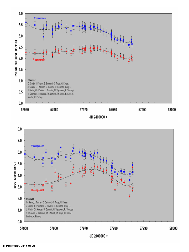

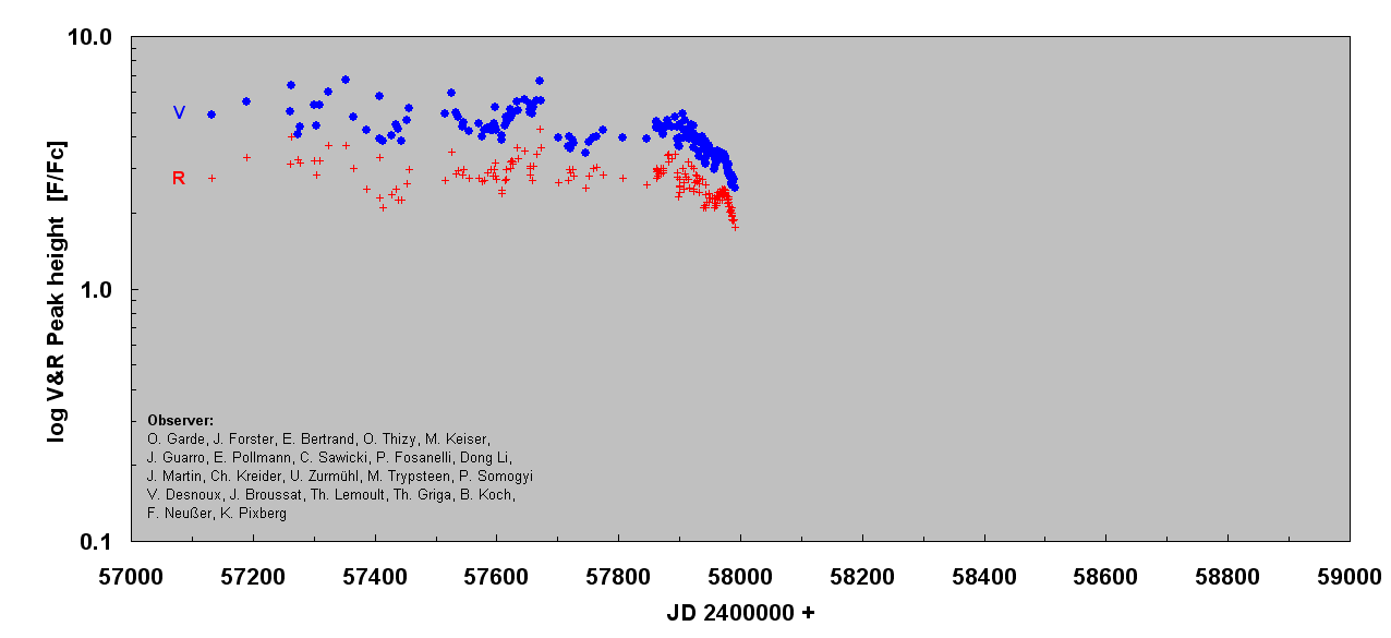

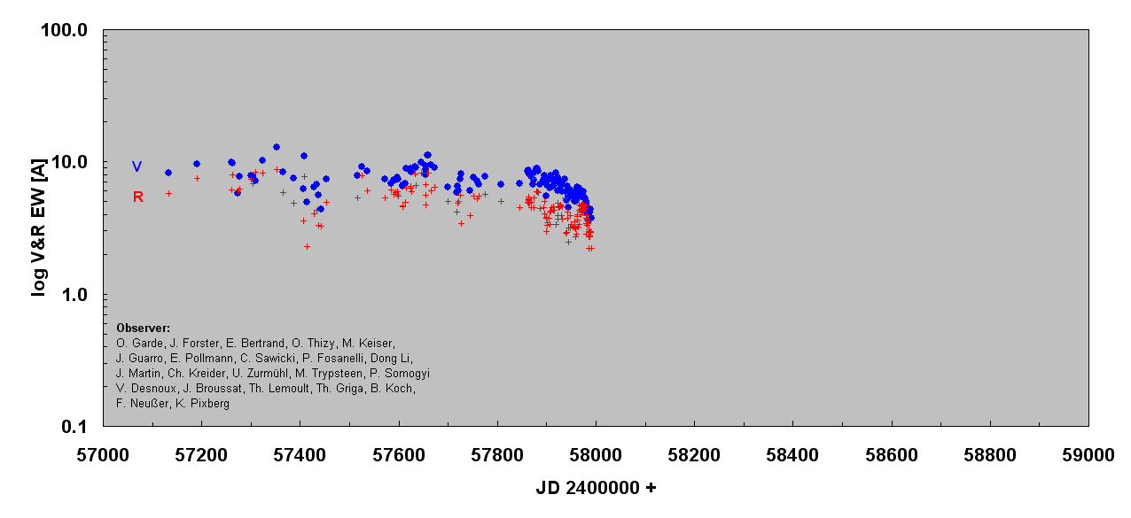

Dear colleagues,
the somewhat different form of the diagrams (logarithmic ordinate, longer time base) shows for V&R EW and PH from my point of view that we are already in eclipse at least since end of May this year (JD 2457900).
Comments are welcome!
Ernst

Dear Ernst,
This analysis gives a remarkable turn in the project. This points towards your latest re-calculation of the beginning point of the eclipse, which I think was in the beginning of June. With this latest graphical presentation it seems to be even earlier. What is the standard deviation of the measurements in respect to the mean values of R and V (PH and EW) ? Perhaps also an R to V plot? Perhaps another refined calculation of the date?

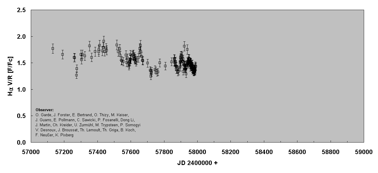

Dear colleagues,
here comes the Halpha V/R plot.
Two things confuses me:
1) It seems there are cyclic V/R variation with "periodes" (?) of approx. 40-50 days.
2) (see the both plots above from Friday).
V&R EW and PH seems to decrease simultaneously, although R (compared with V) should descent with a certain time delay, corresponding its formation diametral on the opposit side of the disk.
Any idea?
Ernst
marcoastro+
Posts: 28
Joined: Thu Oct 11, 2012 8:12 pm
Re: Observation state of the campaign
Post by marcoastro+ »
Many thanks, Ernst for this quick calculation of the V/R graph.
1) Short cyclic character
could be caused by an apsidal motion of the accretion disk, typified by an unequal distibution (hence, rotation) of matter in the envelope.
2) No major delay between V and R descents
This indicates that the descents of the V and R component are somewhere "locked" here in their changes.
Kind regards,
Marc.
