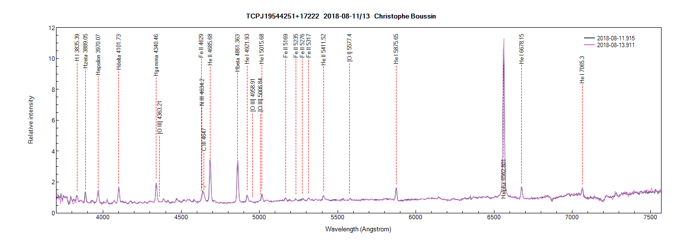

After a very rainy and covered night yesterday...I was able to resume tracking TCPJ19544251+17222 again.
The spectrum below was obtained on August 13 at 21 h 51 TU with a resolution of 504 (JJ = 2458344.4336) and an acquisition time of 65 min (13 x 300 s) :
TCPJ19544251+17222 on August 13, 2018
_tcpj19544251+17222_20180813_911_Christophe Boussin_3700_7570.png (104.07 KiB) Viewed 30202 times

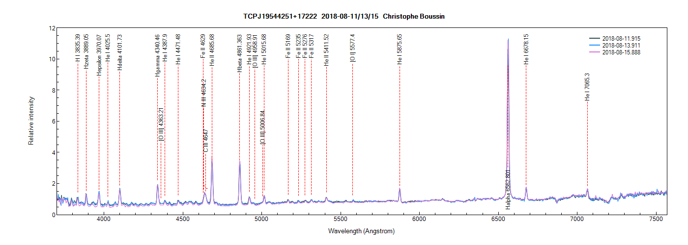

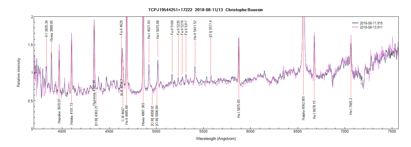

The comparison of the spectra obtained on August 11th and 13th with some identified lines :
TCPJ19544251+17222 on August 11th and 13th, 2018
TCPJ19544251+17222 on August 11th and 13th, 2018 (zoom)
The Balmer, HeI and HeII lines are clearly visible. Some FeII lines seem to be present in the two spectra as well the [OI] line at 5577A...but [OIII] lines are not visible.

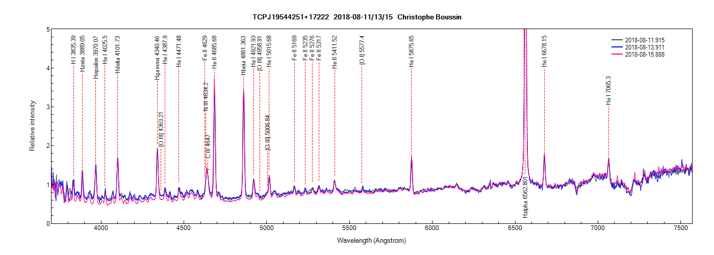

The comparison of spectra obtained between August 11 and 15 does not show any obvious evolution at low resolution :
TCPJ19544251+17222 on August 11th, 13th and 15th, 2018
Nevertheless, it appears (maybe…) to be a slight increase in the relative intensity of the HeII line at 4686A.
TCPJ19544251+17222 on August 11th, 13th and 15th, 2018 (zoom)
However, this remark need to be confirmed by new observations...

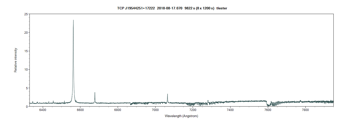

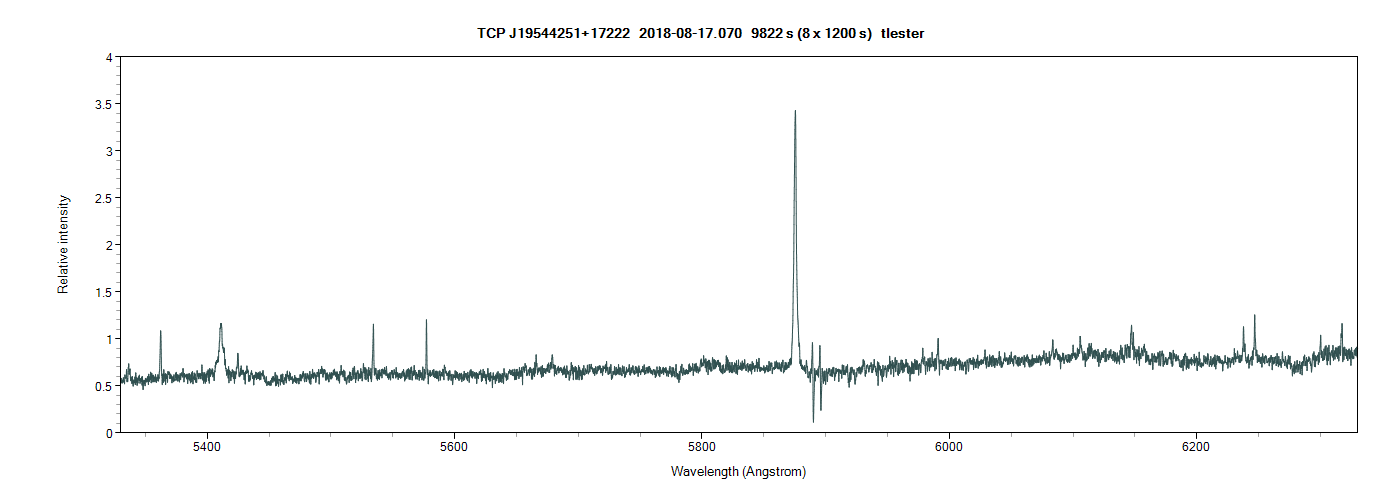

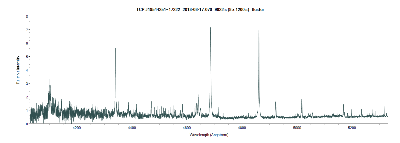

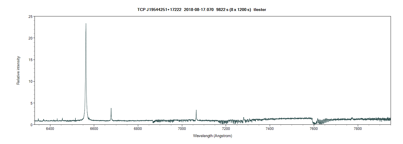

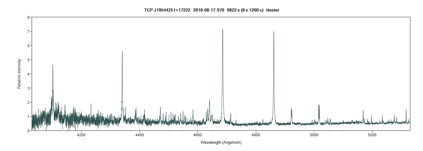

My result for Aug 17. A difficult target for Echelle spectroscopy and conditions were not ideal - very high humidity and haze.
