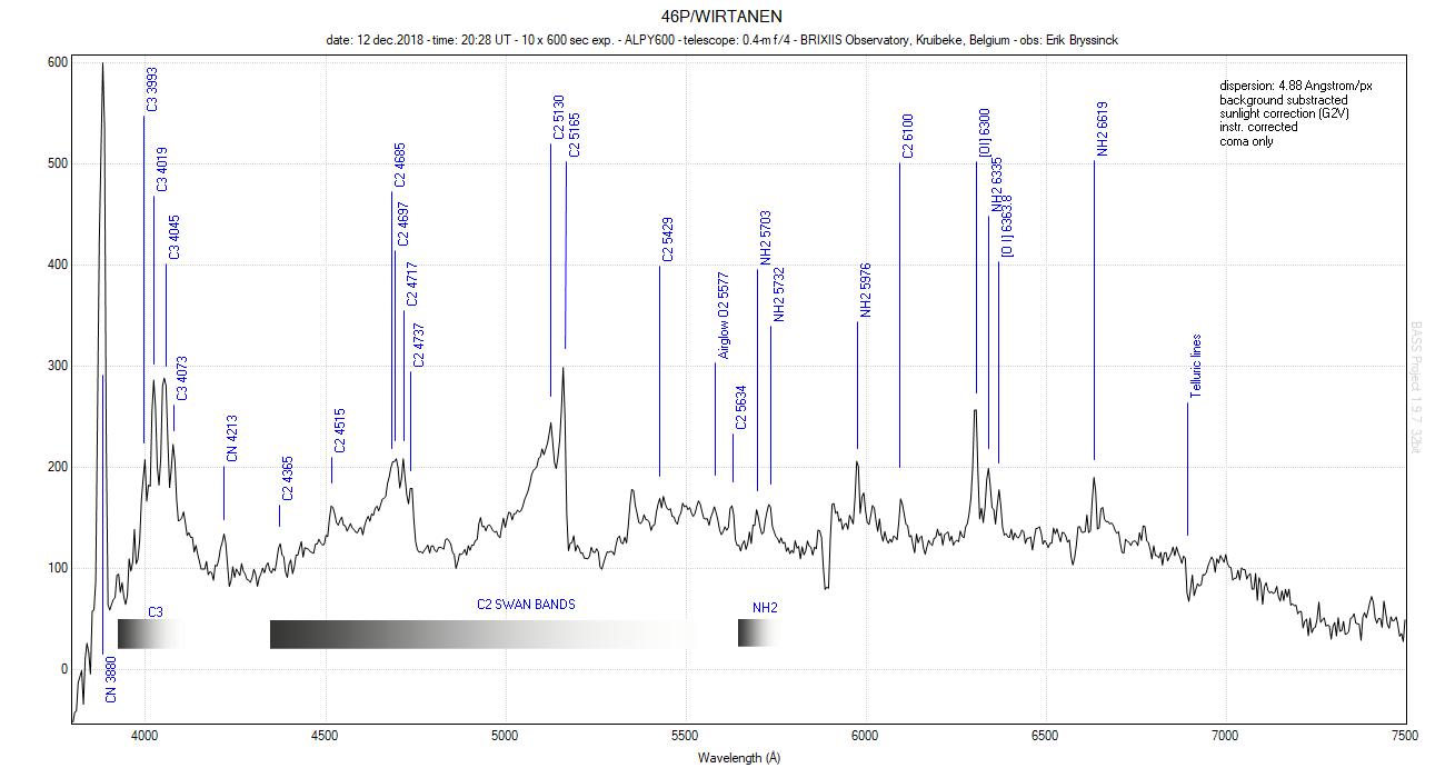

Here my result of the 46P/WIRTANEN spectrum taken on 12 dec at about 20:29 UT. I live in a high light-polluted area and it is always difficult to correct the background and substract the light-pollution. I took 10 x 600 sec images of 46P with the ALPY600 and after that about 5 x 600 sec of trhe background on almost the same altitude as the images of 46P taken before. I see in all the 46P spectra images
a change in the background due the climb of the comet during the observation. Unfortunately i couldn't take a sunlike star because clouds where coming in. After the dark and flat and background substraction. as correction of the sun spectrum i took a spectrum from the catalog of a G2V star. I got the result below.
Erik Bryssinck
