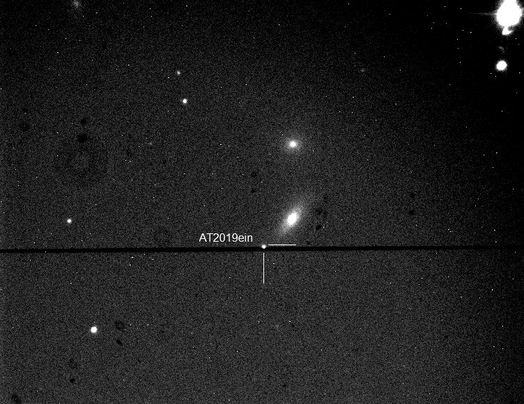

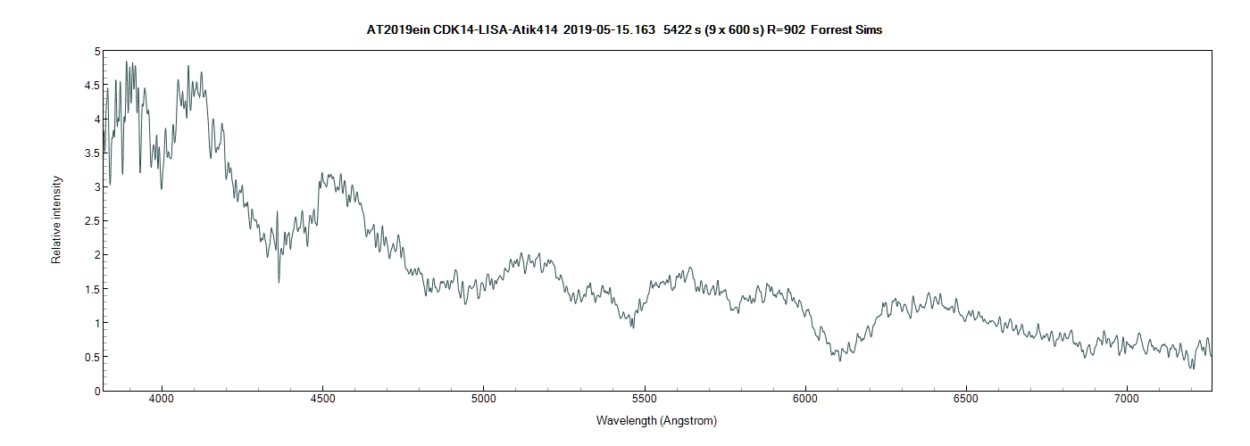

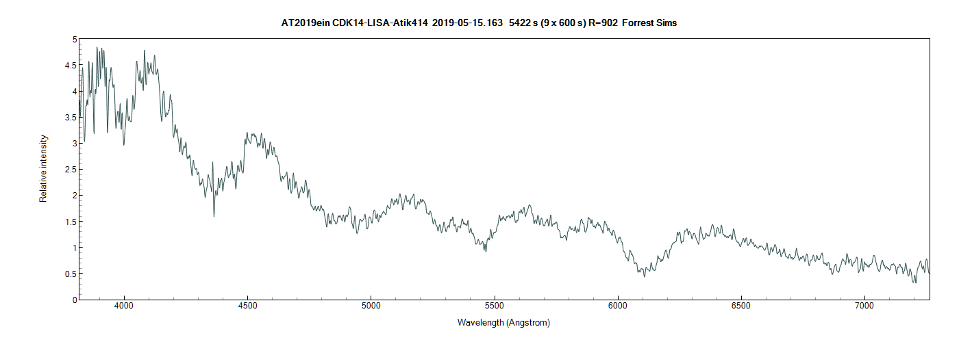

Here is my contribution on AT2019ein taking 9 600sec exposures using my Shelyak LISA with 23 micron slit. Amazingly, guiding was really good using the target star on the slit. I smoothed the data slightly using a filter value of 1.5.
Woody
AT2019ein guiider image rotation zero.jpg (132.22 KiB) Viewed 13146 times

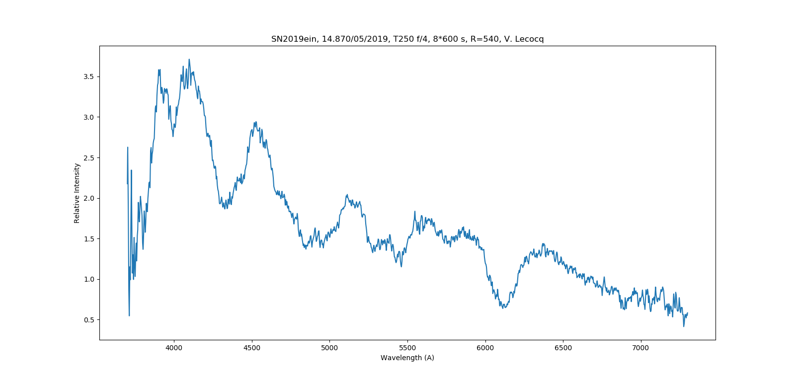

Vincent Lecocq
Posts: 40
Re: SN 2019ein
Post by Vincent Lecocq »

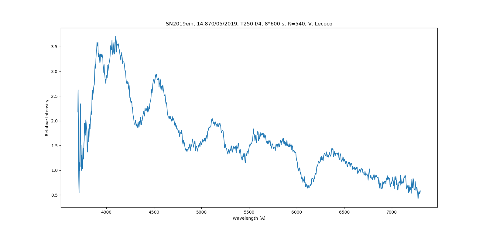

hello,
here's also my modest contribution to this event. Low resolution spectrum (Alpy600, CCD Atik 414 sur un Newton D=250 f/4) taken yesterday, with a very present moon (but clear skies heavenly !!),
Vincent

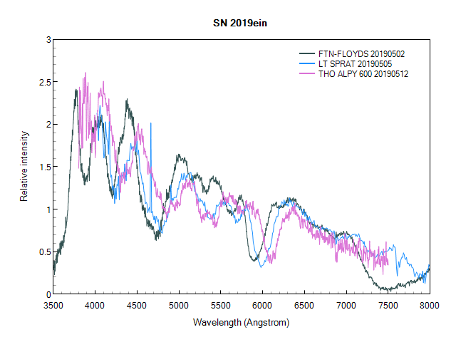

Early spectra from TNS overlaid on my spectrum 20190512. Note the reduction in blue shift of the Si II line with time.

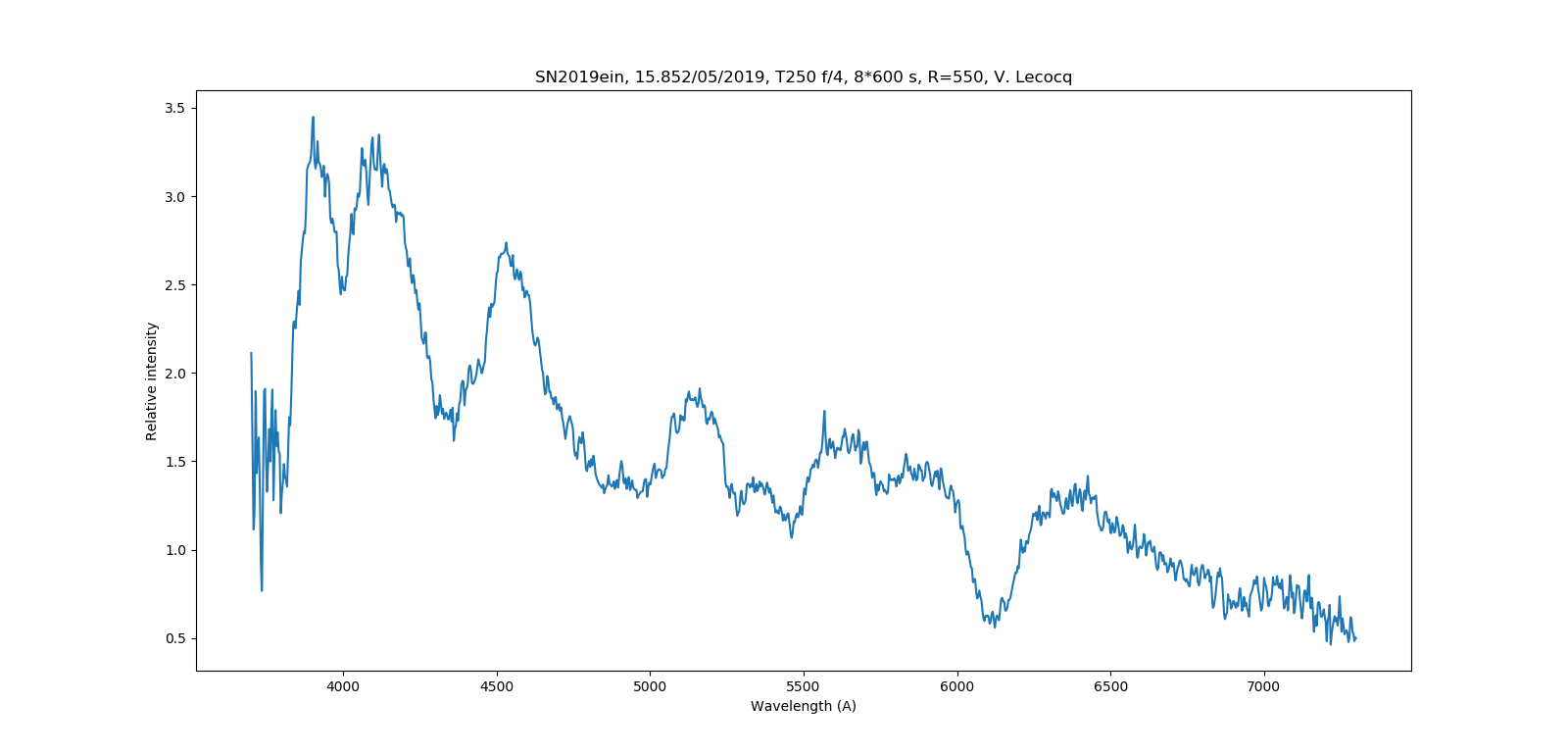

Vincent Lecocq
Posts: 40
Re: SN 2019ein

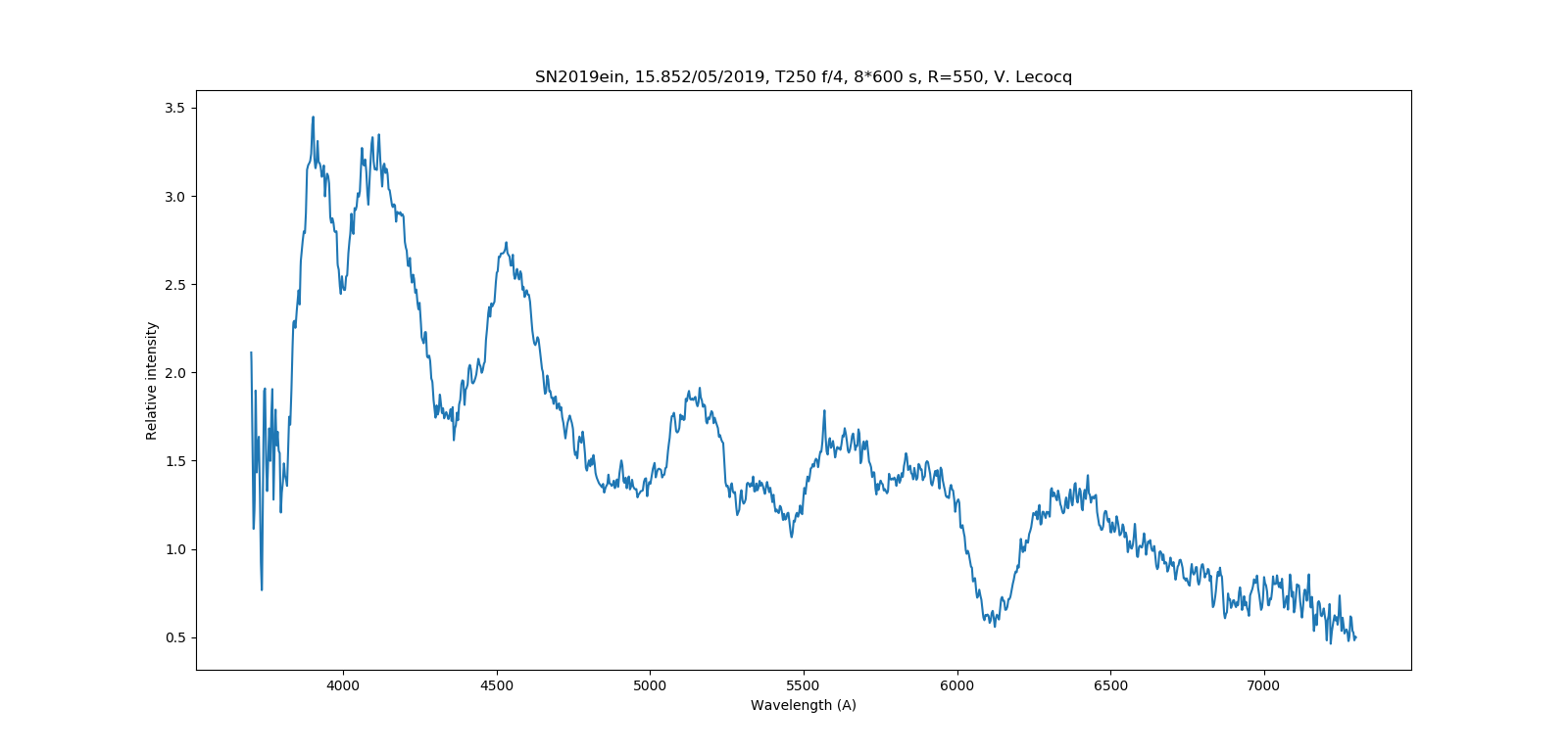

and here it is for yesterday's night ... still very present moon of course, but last chance of good weather for somedays ... .
Re: SN 2019ein
Petite accalmie hier, j'ai pu faire le spectre de cette supernova :) .
La raie du SiII qui arrive à 6127.5A ce qui me donne un vitesse d'éjecta toutes vitesses réduites de - 13 045 km/s
On note toujours une vitesse assez élevée ~19 jours après sa découverte (1/05/2019).
Alpy600 - C8 + red x0.63 - poses de 900s x 8 - Atik414EX.
