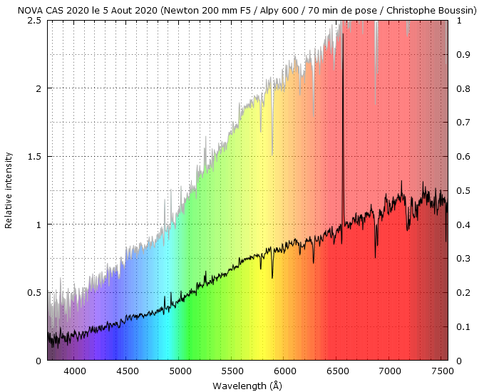

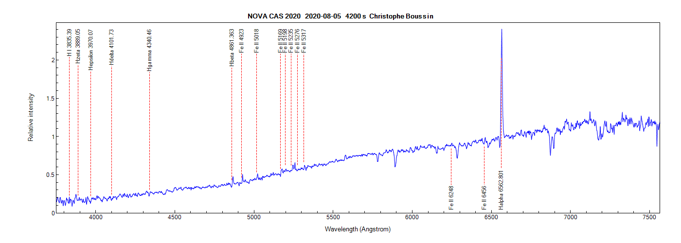

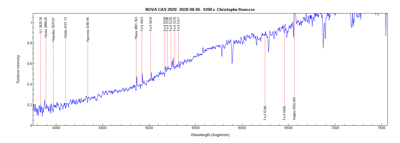

I obtained the following spectrum of nova Cas 2020 the 5th of August at 00 h 02 TU with my Alpy 600 (resolution of 506, JJ = 2459066.5013) and an acquisition time of 70 min :
Nova Cas 2020 on August 5th, 2020
_novacas2020_20200805_001_Christophe Boussin_3750_7565.png (92.05 KiB) Viewed 9310 times
Nova Cas 2020 on August 5th, 2020 (identification of lines from PlotSpectra)
Nova Cas 2020 on August 5th, 2020 (zoom)
As David, I noticed also P Cyg absorption profiles on the Halpha and Hbeta lines and on some Fe II emission lines.
Clear skies,

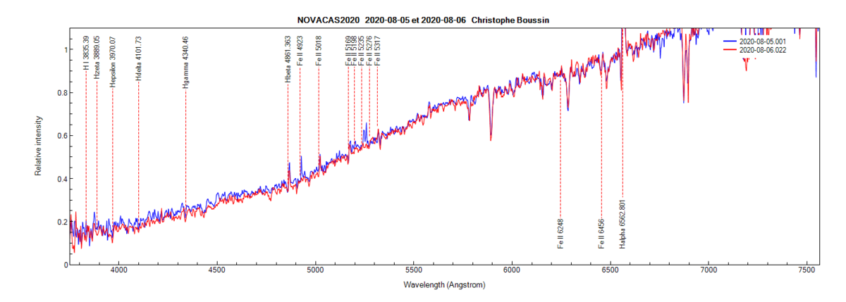

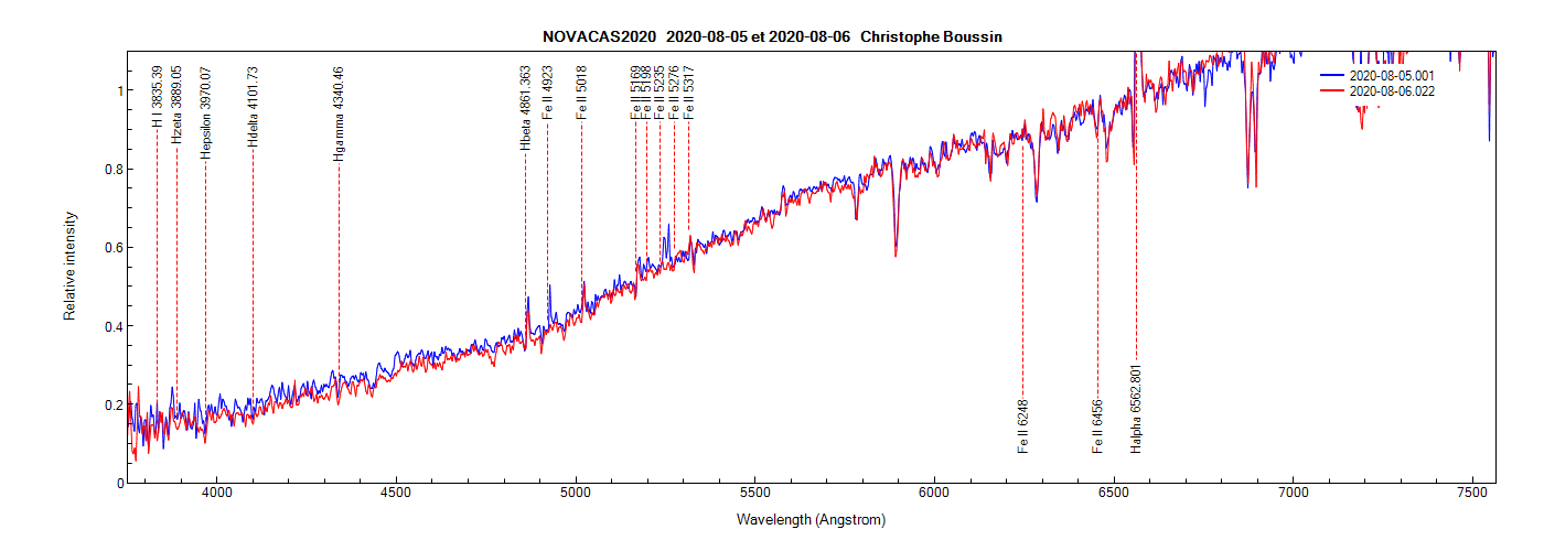

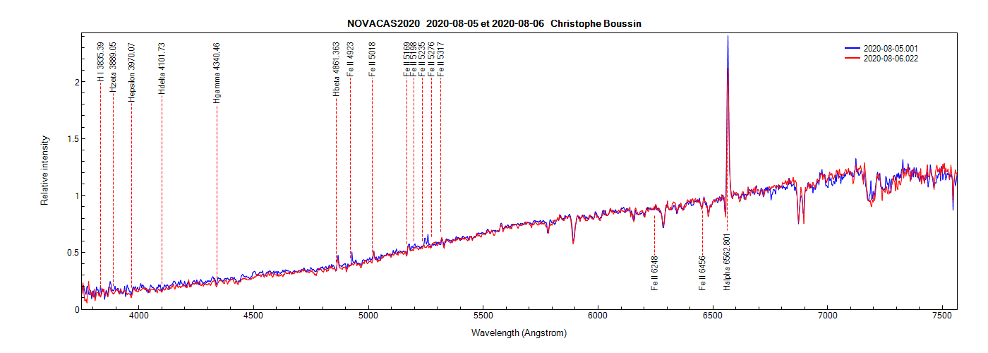

Here is my update for the nova Cas 2020 with the following spectrum obtained the 6th of August at 00 h 32 TU with my Alpy 600 (resolution of 507, JJ = 2459067.5225) and an acquisition time of 75 min :
Nova Cas 2020 on August 6th, 2020
_novacas2020_20200806_022_Christophe Boussin_3750_7565.png (89.85 KiB) Viewed 9252 times
Nova Cas 2020 on August 5th and 6th, 2020 (identification of lines from PlotSpectra)
Nova Cas 2020 on August 5th and 6th, 2020 (zoom)
Clear skies,

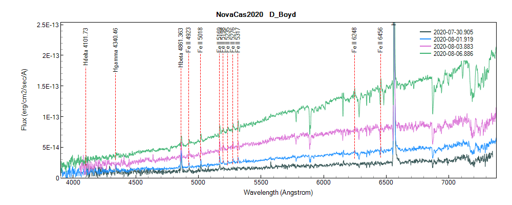

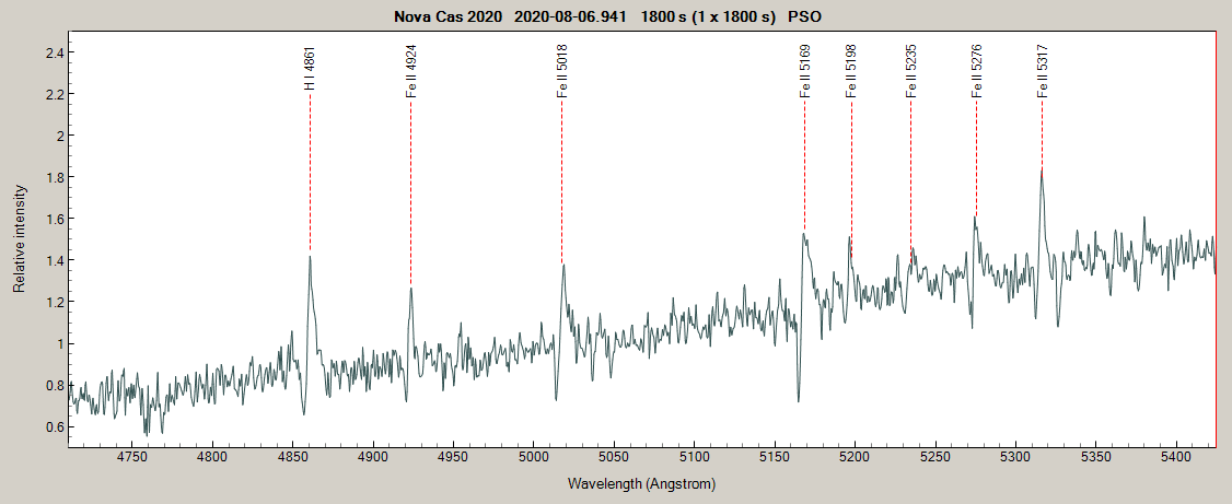

The nova now appears to be approaching its maximum brightness with V = 11.56. Fe II lines are still present while the flux in H-alpha and H-beta has decreased to 1.9E-12 and 1.5E-13 erg/cm2/sec respectively. P Cyg absorption is still present on H-alpha and Fe II lines extending to -600 km/s.

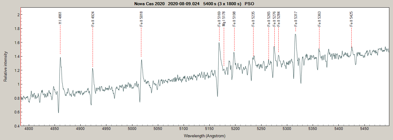

At same night as David, R~2000, cloudy sky (could save only 1 x 30 min), 300 x 1200 Newton + APM Barlow 2.67 + LHires III + 600/mm grating + 35 micron slit + ATIK 428 EXm:
Very similar Fe II features to the eShel shown by Christian 1 day before (08.05), except that I have no pollution in this region at all.
Minor double absorption present above noise (4763A, 5041A, 5367A +/- 7A) but I can't determine their origin.

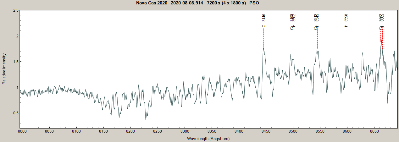

Inserting an orange wratten filter, experimented in two IR regions with the 600/mm (visual) grating.
First taken the O I 7773 region (7450-8160A):
Next, captured the region with O I 8446:

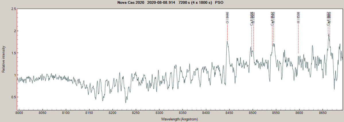

The strong Paschen end contaminated all the O I 8446 and Ca II triplet P-Cyg profile (I'd expect the Paschen serie even stronger at larger wavelengths).
After then, revisited the H-beta / Fe II region - this time with 3x30 min exposures:
Comparing to previous, no change in 2 days above noise. Unidentified absorptions visible.

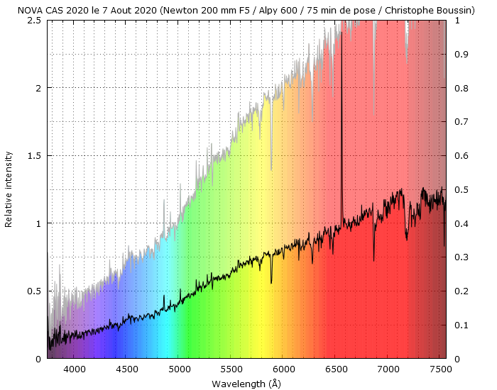

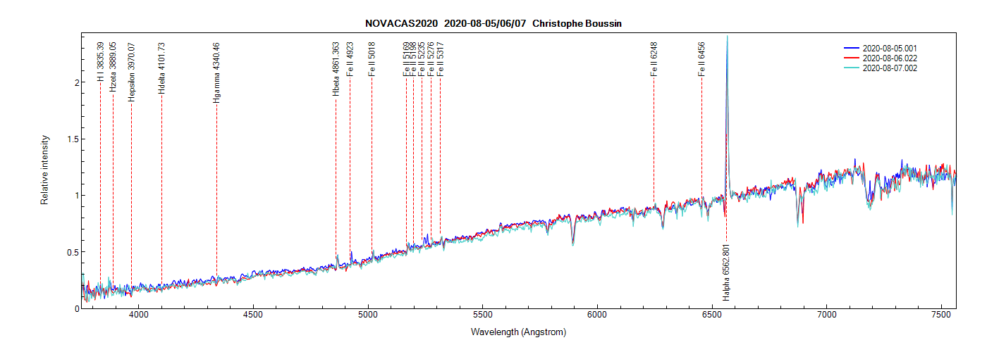

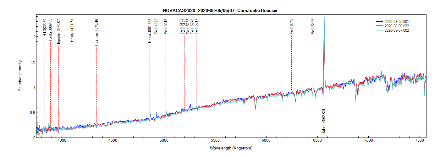

Here is my new update for the nova Cas 2020 with the following spectrum obtained the 7th of August at 00 h 03 TU with my Alpy 600 (resolution of 507, JJ = 2459068.5023) and an acquisition time of 75 min :
Nova Cas 2020 on August 7th, 2020
_novacas2020_20200807_002_Christophe Boussin_3750_7565.png (95.02 KiB) Viewed 9074 times

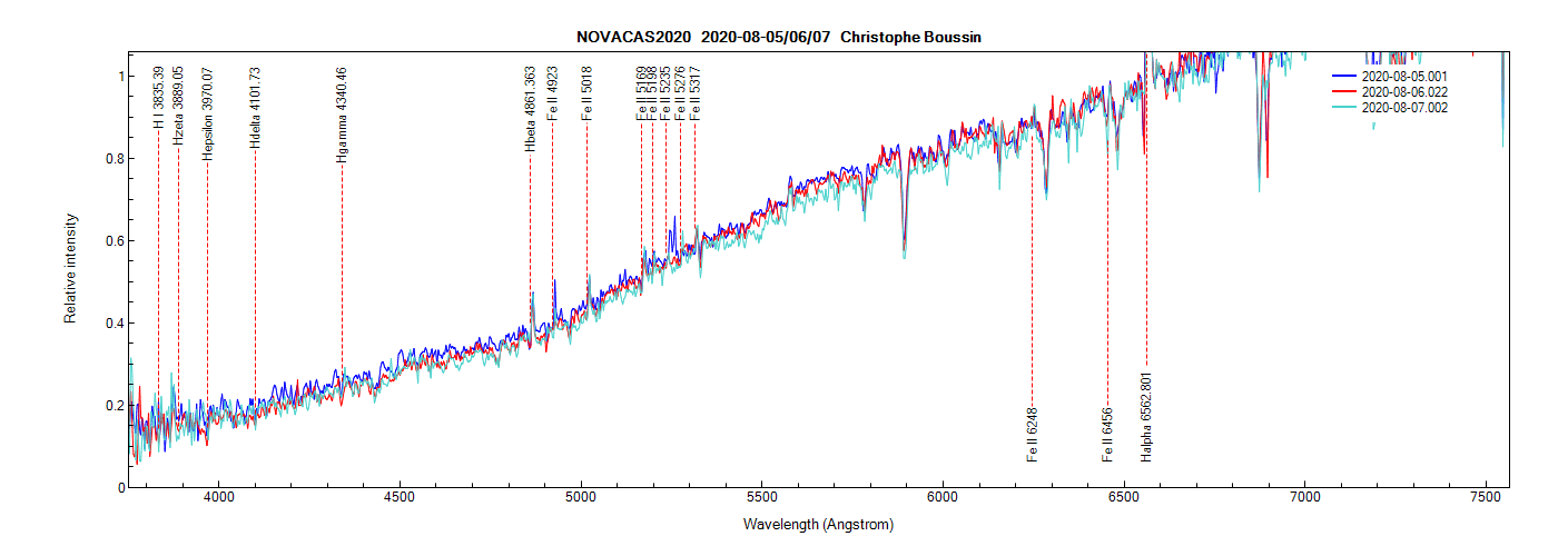

Nova Cas 2020 on August 5th, 6th and 7th, 2020 (identification of lines from PlotSpectra)
Nova Cas 2020 on August 5th, 6th and 7th, 2020 (zoom)
Between August 5 and 7, I didn't notice any significant changes in the spectra.
And in the last days, unfortunately, the weather has become too uncertain to continue my observations.
Clear skies to all,

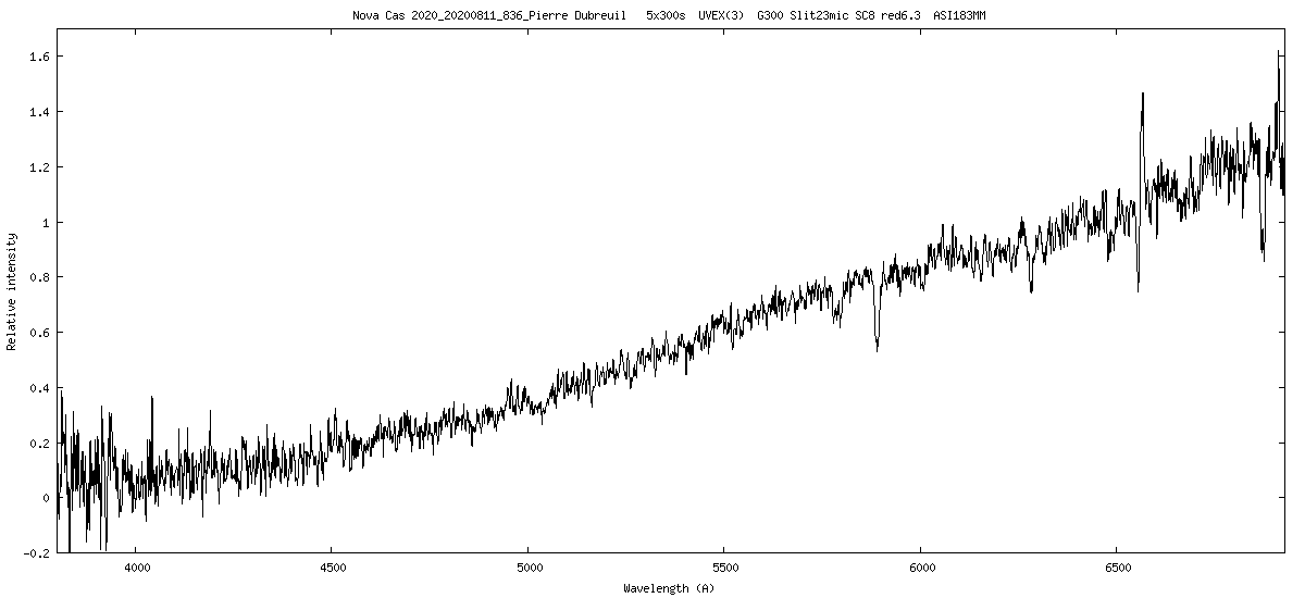

Post by Dubreuil Pierre »
Bonjour à tous
Ma petite participation
5x300s sur Nova Cas 2020 hier soir avec UVEX(3) G300.
_novacas2020_20200811_836_Pierre Dubreuil.png (10.27 KiB) Viewed 9051 times
Clear skies to all

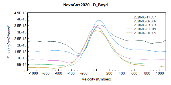

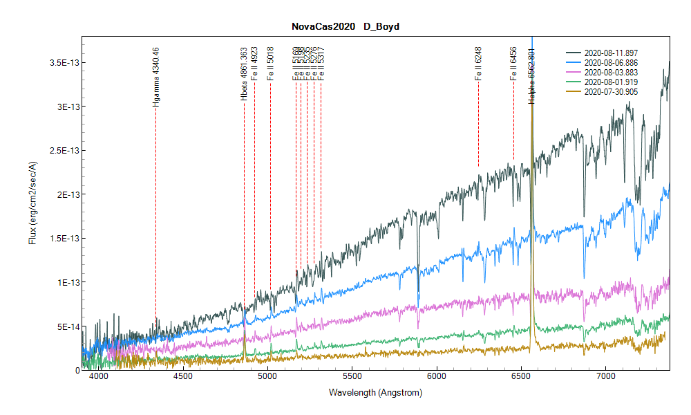

The nova appears to have reached its maximum brightness in the visual band at V ~10.8 around 10th Aug. On 11th Aug its B-V colour index reddened to 1.93 compared to a mean of 1.65 over the previous 10 days while it was brightening. The spectrum on 11th Aug shows a further increase in continuum flux compared to 6th Aug. The H-alpha line flux has decreased to 8.1E-13 erg/cm2/sec.
The P Cyg absorption dip on the H-alpha line extends to -700 km/s relative to its rest wavelength and has deepened with maximum absorption now at -240 km/s compared to -280 km/s on 6th Aug and -430 km/s on 1st Aug (see below). P Cyg profiles remain on H-beta and Fe II lines.

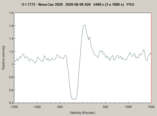

We report the results of our continuing optical low and medium resolution spectroscopic monitoring of Nova Cas 2020 . We cover the interval reported in ATel #13903, #13905, #13919 and now extend it through Aug. 10. The spectra cover the period from 2020 Jul. 30.7 UT to Aug 11.9 UT with resolutions from 500 to 11000 in the spectral window 3700-8700A, exposure times of 1800 to 13000 sec, and S/N ranging from a low of about 20 to about 100 (peak line fluxes). The O I 7773A multiplet showed P Cyg profiles from the first spectra on Jul. 30.8. From Aug. 1.8 on, Fe II 5018, 5169 and other optical Fe II transitions showed P Cyg profiles. Aug. 8.3, the Ca II IRT showed weak emission, while O I 7773, 8446A both displayed P Cyg profiles (with absorption depths of around 60% and 25%, respectively), similar to the Pa series. The 7773A multiplet absorption was complex and broad, centered around -180 km/s but extending to nearly -500 km/s with emission extending to +300 km/s. On Aug. 4.9, blueshifted absorption appeared on the Na I D1,D2 lines at -190 km/s with an equivalent width EW = 0.1A. The absorption radial velocity was the same as all other P Cyg absorption on all Fe II lines (especially 5018, 5169A). On Aug. 6.8 the absorption had increased to EW = 0.5A with no change in radial velocity. The metal line absorptions displayed consistently lower radial velocity than the Balmer lines, whose asymmetric absorptions were deepest (Halpha, -250 km/s; Hbeta, -210) while extending to about -620 km/s; the emission to absorption equivalent width ratios were 3.8 (Halpha), 1.1 (Hbeta). Several blueshifted low ionization metal absorbers, e.g. Mg II 4481, Ti II 4764, and Si II 6347, 6371A, were present on Aug. 4 through Aug. 6 and persisted but were not well resolved in the later spectra. The Si II doublet showed weak emission through Aug. 6. There is a complex spectrum of weaker metal lines, all at low velocity, and the development of this nova shows similarities to nova DN Gem 1912 (McLaughlin 1965,POMic,9,113). No evidence was found of He I 5876, 6678, 7065 in any spectrum; on Aug. 11.9 the flux upper limit for He I 5876A emission was < 1.2E-15 erg cm-2 s-1 (uncorrected for extinction). As reported in Atel #13905, the interstellar DIBs are relatively strong including 5780 (EW=0.57A), 5793 (0.3A), and 6613A (0.37A). Based on the velocity range of the interstellar Na I D components (V(LSR)=-46,-9 km/s, ) and the width of the profile, 140 km/s, the LAB survey (http://adsabs.harvard.edu/abs/2005A%26A...440..775K) gives a total N(H)=8.2E21/cm^2. The H I displays a higher velocity, -65 km/s (mean), than the Na I components so this is a likely upper limit to the line of sight extinction. In light of the still rising optical flux and the lack of any forbidden lines (including [O I]), the nova may be a case of a highly inclined aspherical ejecta still in the optically thick stage with the initiation of the recombination wave known from other novae in the pre-maximum stage. Observations are continuing, the spectra are available at the ARAS Nova Database.

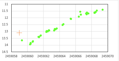

The AAVSO V lightcurve
