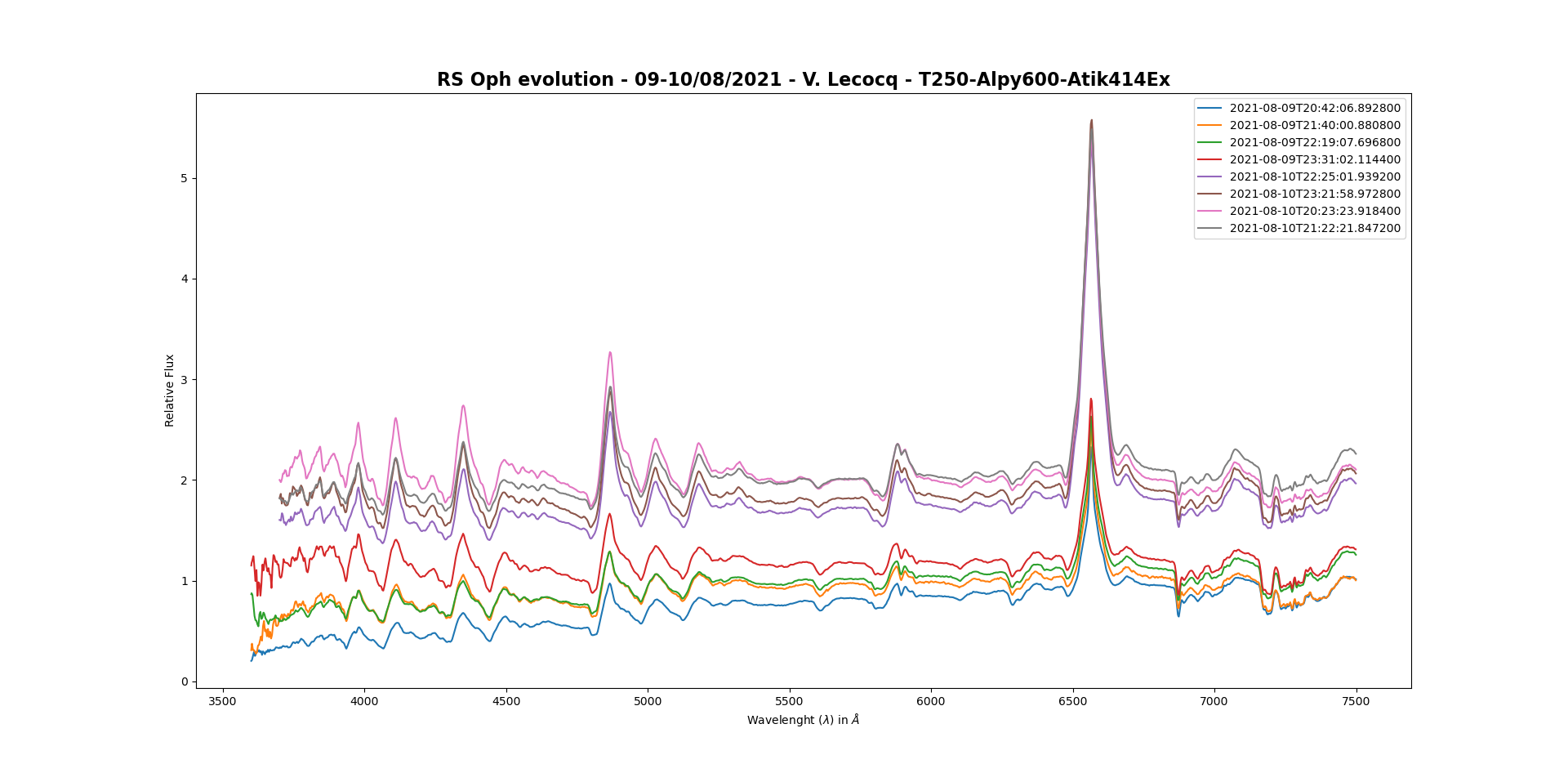

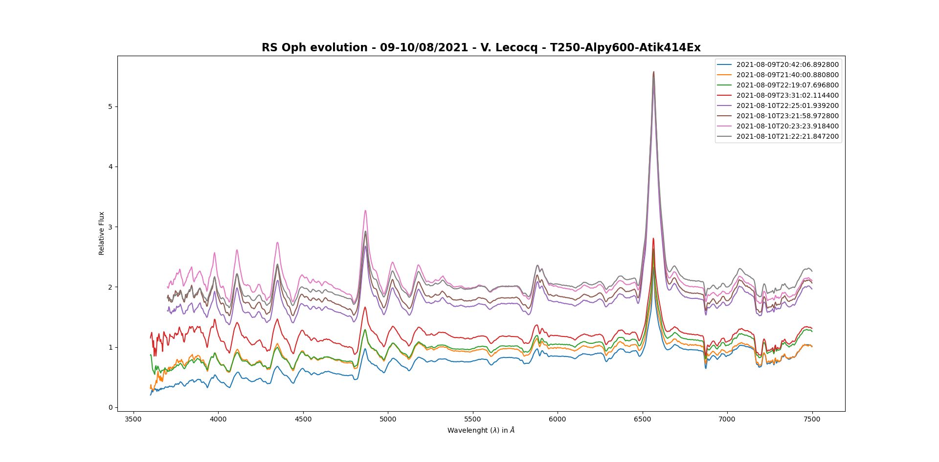

Vincent Lecocq
Posts: 40
Post by Vincent Lecocq »
]hello,
a quick comparison between 09/08 and 10/08 low-res spectra of RS Oph, to be continued !
vincent

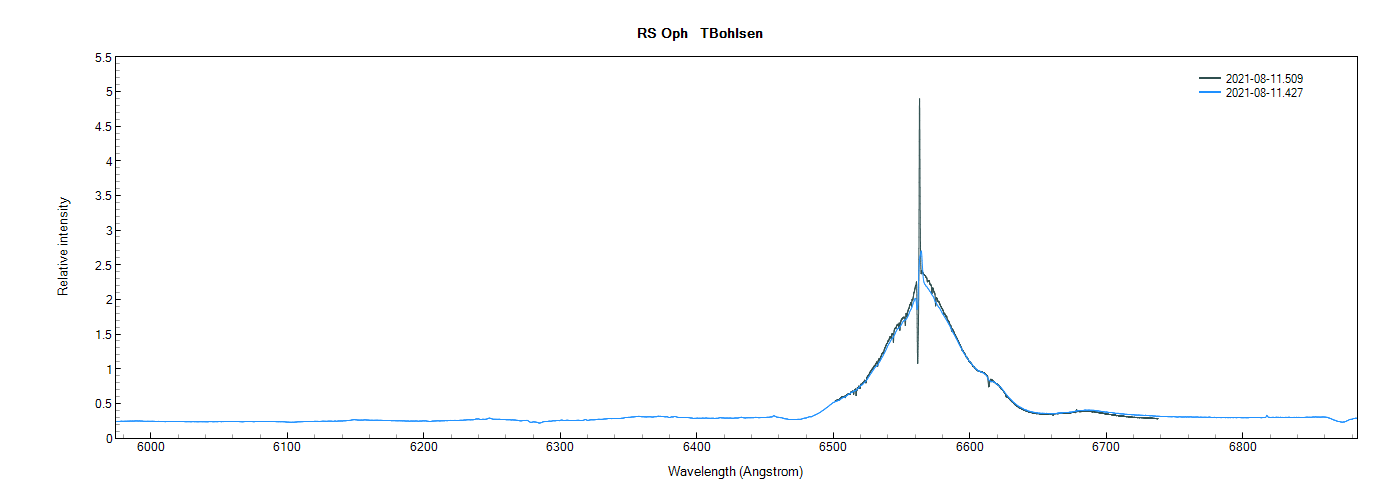

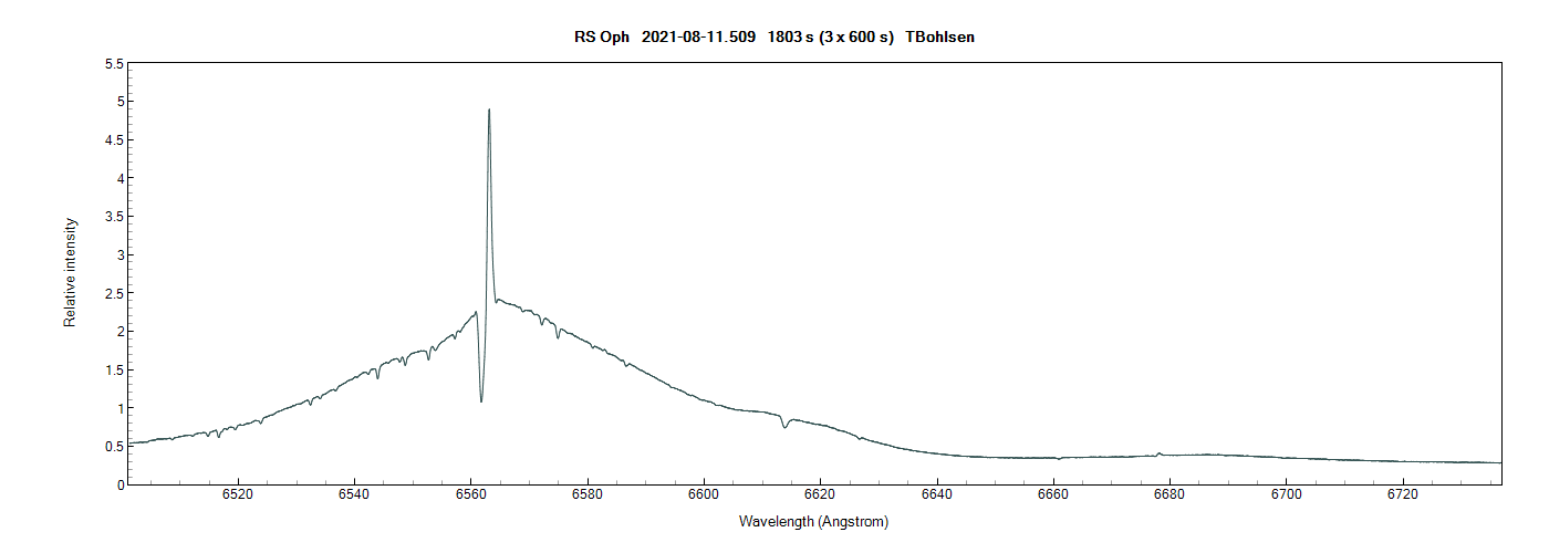

Terry Bohlsen
Posts: 191
Post by Terry Bohlsen »
Hi All
This is my effort from last night.
I used my LOSPEC at R=~4700 and my LHIRES R=16000.
Interesting to see the difference that the resolution makes.
Terry
Terry Bohlsen
Armidale NSW
Australia

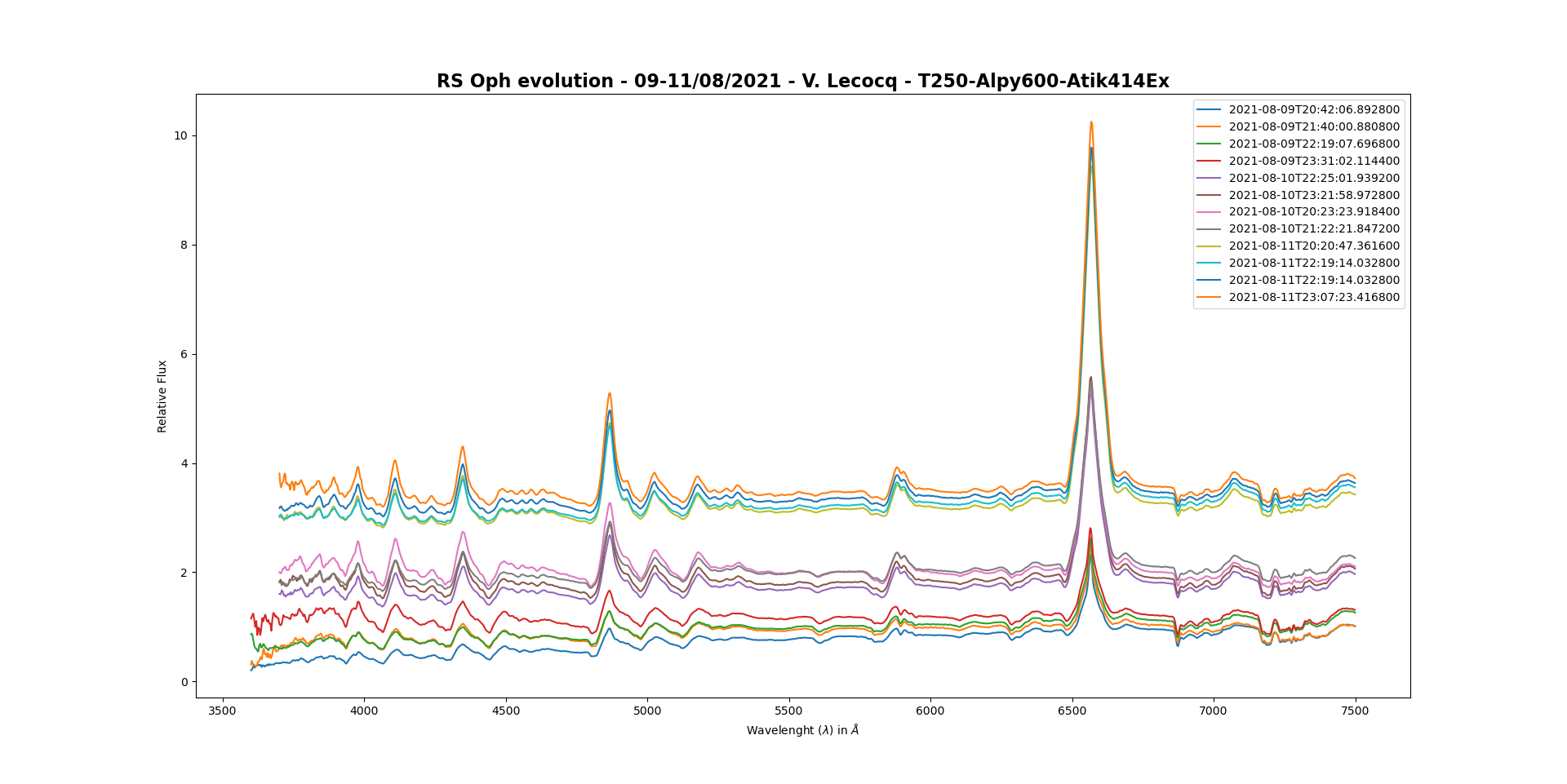

Vincent Lecocq
Posts: 40
last night, good night, and now bad weather is coming back :(
so here is a low res comparison between 09 and 11 august, 4 spectra by night (1/hour):
vincent
