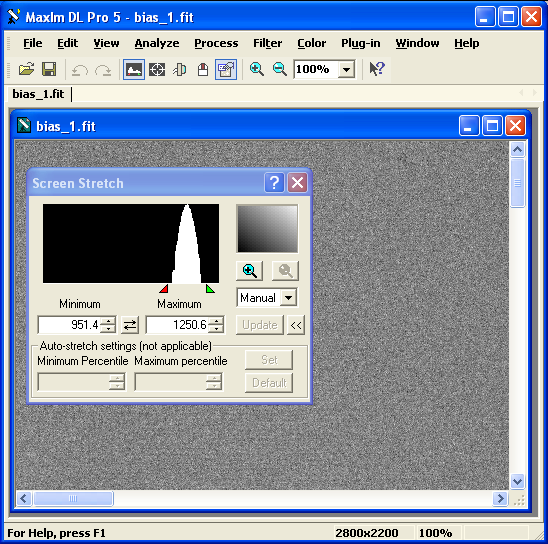

I guess Maxim has a somewhat special display of the histogram with a logarithmic scale for the vertical axis. A Gaussian has the following shape, taken from a bias of my camera (SBIG ST8300):
bias from ST8300 in screen stretch
bias histogram Maxim.png (152.21 KiB) Viewed 7767 times
The logarithmic scale changes the Gaussian shape into a characteristic sugar loaf shape.

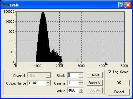

The logarithmic scale you can see if you open process - levels and stretch the intensity values so you can see the principal intensity range:
bias in Levels diagram, stretched
bias levels Maxim.png (10.42 KiB) Viewed 7767 times
In this display the vertical scale is plotted, down to 1, so you see also rare warm or hot pixels. The pedestal is cut off in the previous screen stretch histogram.
The pedestal in your histogram indicates that apart from the gaussian noise you have some pixels with a wider distribution of intensities. This might indicate some additional noise from readout, I have seen this with poor quality cables, if the cable picks up some noise or ripple on the power supply. With a linear scale this hardly shows up so you can work with your CCD.
If the pedestal comes from a constant nonuniformity of the pixels it might be subtracted out during processing. For measuring readout noise you take the difference between two bias images. If you have some fixed pattern noise the diffference bias should show lower noise, if the noise is completely random, the difference noise is larger by a factor sqare root 2.
Unfortunately the documentation of Maxim does not say exactly what is displayed in the histogram, you normally don't bother about it for making nice images.

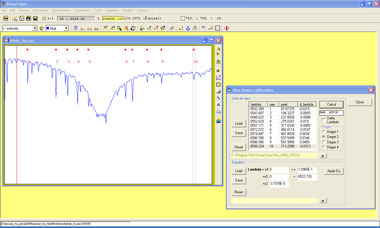

You can certainly make good scientific measurements with your small size CCD. It is true that you can only get a linear calibration at H alpha with 2 neon lines but unless you live on a mountain top or in a very dry region, you can make a more accurate non linear calibration using telluric H2O lines from the atmosphere which can usually be seen in the spectrum. Many amateurs use them instead of the neon lamp calibration as they are very accurate, even when they have larger CCD .

I use Visual Spec to do the calibration but I am sure you can do the same thing in ISIS. Here is a screen shot showing the H2O telluric lines I normally use. This was taken using a LHIRES III with a 2400 l/mm grating and a CCD of similar size to yours.
H2O tellurics used for non linear calibration
