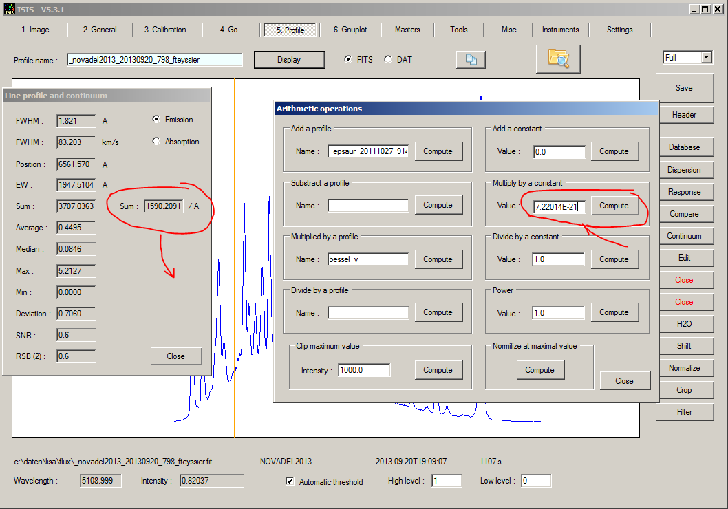

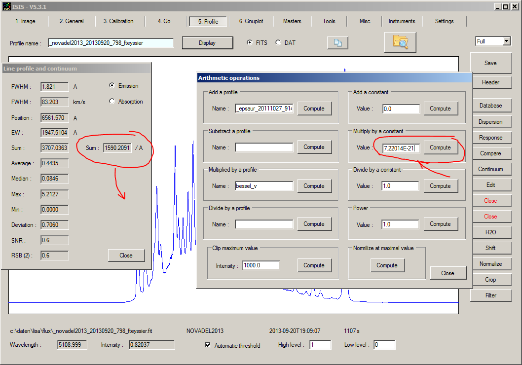

a while ago I suggested to look at H-alpha intensity in flux calibrated spectra. This has been done in the meantime by Robin. Christian has advanced the technique of absolute flux calibration to a new standard. If no flux calibrated spectra are available one can do an absolute flux calibration if the magnitude mV is known.
The procedure is the reverse as described by Christian for the determination of magnitude from a flux calibrated spectrum:
http://www.astrosurf.com/buil/calibrati ... ration.htm
With the help of ISIS the calibration is actually quite simple.
- Load a spectrum calibrated in relative flux.If a reference star nearby has been used for the instrument response this eliminates also the atmospheric extinction.
- Multiply it with Bessell V response function. This closely resembles the function of a Johnson V filter which is used by AAVSO
- Integrate the relative flux with the FWHM tool in ISIS. The spectral range of the spectrum should be from 4700 to 7300 A.
I0 = integral[Bessell_V(lambda)*F0(lambda)*dlambda] is the integrated relative flux:
calculating I0
calculating I0
flux calculation3.PNG (71.09 KiB) Viewed 88804 times
- Calculate the calibration factor with the following equation:
F(lambda) = F0(lambda)/integral[Bessell_V(lambda)*F0(lambda)*dlambda]*10^[- 0.4*(mV + 13.70)]
Here F0 is the relative flux
The integral has been computed in the step before
mV is the measured V magnitude taken from e.g. AAVSO database or an independent measurement
13.70 is a constant to convert the magnitude to the flux in the Landolt system. It was determined by comparing the flux and magnitude of stars in the Calspec database. It is valid for all spectral classes.
- Reload the original spectrum and multiply it with the calibration factor C = 1/I0*10^[- 0.4*(mV + 13.70)]
- Save the spectrum with _flux appended.

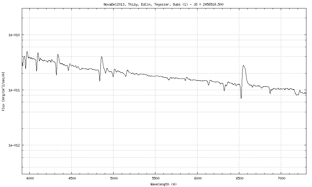

For the following animation, spectra of ALPY and LISA spectrographs from the of the Nova database:
http://www.astrosurf.com/aras/Aras_Data ... l-2013.htm
have been used, with spectra from Olivier Thizy, who recorded the first days continuously, supplemented with spectra from Jim Edlin and Francois Teyssier for the gaps, with spacings of one day in the beginning and 2 to 3 days in the later phases.
Notice that spectra taken with different instruments, different observers, different weather conditions have been used, so some imperfections are visible. But despite this it shows that the method works. The magnitudes mV have been obtained by eye from averaging the AAVSO observations over one day bins, rounded to 1/10 mag. Of course the absolute flux is only as good as these measurements. The relatively large scatter of individual AAVSO measurements may come from the fact that not everybody uses the correct CCD filter combinations, which is not so important for regular stars but especially important in the case of strong emission lines like H-alpha.
Of course it would be an advantage if all measurements would be taken with the same equipment, same reference star and same photometric equipment with correct spectral response.
These files were renamed and animated with the ISIS animation tool.
The use of a log scale has the following advantages:
- It allows to show large intensity variations over three orders of magnitude (especially if spectra will be added with a decrease of Nova intensity).
- Both the continuum and the H-alpha peak are shown with good detail.
- a constant S/N shows as a constant amplitude, irrespective of intensity of the signal.
- the ratio of line intensity is shown as a constant difference in height. This is particularly well visible for the Balmer series in the later stages, but also for other line groups.
animated sequence of flux calibrated spectra of Nova Del 2013, log scale, corrected!!!

Ouuaahh !
That's great and very interesting.
But, there's an issue with the scale : the current value of continuum is 10e-12 ers/s/cm2/A (ordre de grandeur)
Note également Martin, que je ne suis toujours pas d'accord sur la non-prise en compte des raies d'émission (biais de 20% environ), mais ceci est un autre sujet, qui n'enlève rien à la remarquable qualité de ton travail
Martin Dubs
Posts: 144
Post by Martin Dubs »
Hello Francois,
thanks for pointing out this error to me. What a silly mistake :(
The equation given in the text is correct, but in the EXCEL sheet I misplaced a bracket, so the results were off by a factor 10^(-.6*13.70) = 1/1.6596e8. I have corrected the image in the meantime.
Just to make sure I compared my flux calculation, comparing your measurement of sep20, assuming m8.1, with a direct flux measurement by Christian:
comparison of different flux calibration methods
comparison Teyssier0920Buil0920_flux.PNG (55.41 KiB) Viewed 88788 times
The difference in the two curves comes probably from an inaccurate estimate of the AAVSO magnitude.
Of course I should have made that comparison before sending the last post ;) .
Wrt to your statement about the inclusion or noninclusion of emission lines I still stick to my opinion. The measured V magnitudes include the emission lines, so I think they also have to be included in the flux calculation. My integral over the weighted relative flux corresponds to a measurement with a Bessell V response (detector sensitivity * filter transmission). What I am not sure about it is what observers at AAVSO actually use for their measurements.
Regards, Martin
