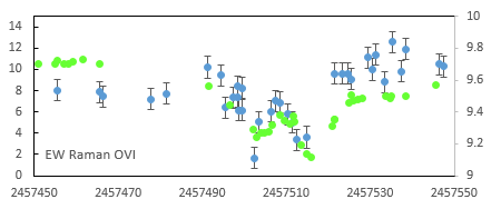

Update of Raman OVI equivalent width
The V curve in green (inversed scale)

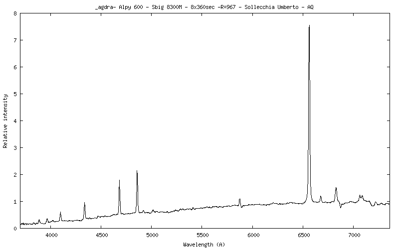

- Posts: 247
Re: AG Dra brightening
Bonjour à tous, voici ma contribution à cette symbiotique .
Sincèrement.
Sincèrement.

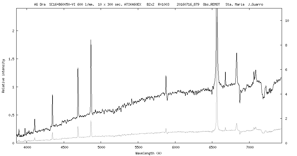

- Posts: 731
AG Dra, in the night 2016 07 16.
J. Guarro
J. Guarro
- _agdra_20160716_879_J. Guarro.png (8.64 KiB) Viewed 11055 times

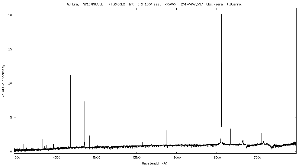

- Posts: 731
AG Dra on the night 2017 04 07.
Cheers, Joan.
Cheers, Joan.
- _agdra_20170407_937_J. Guarro.png (6.73 KiB) Viewed 10830 times

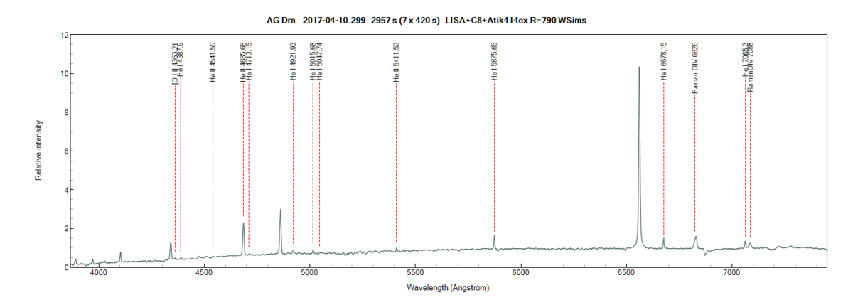

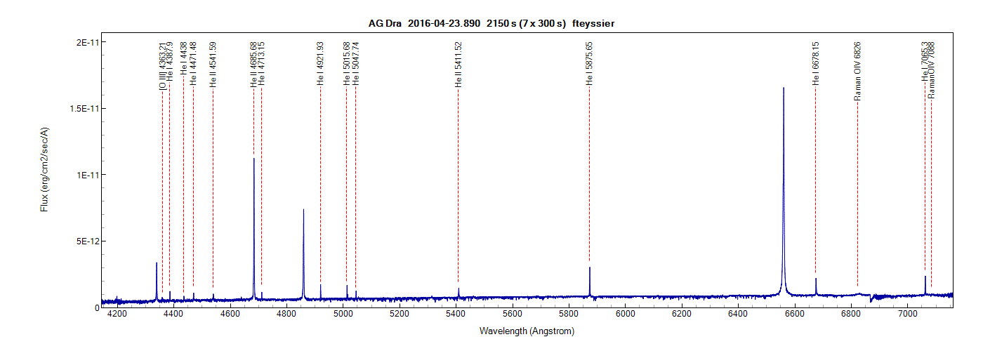

- Posts: 1562
A full commented spectrum, using Tim's PlotSpectra
Taken during last outburst (cool outburst), so Raman OVI very weak

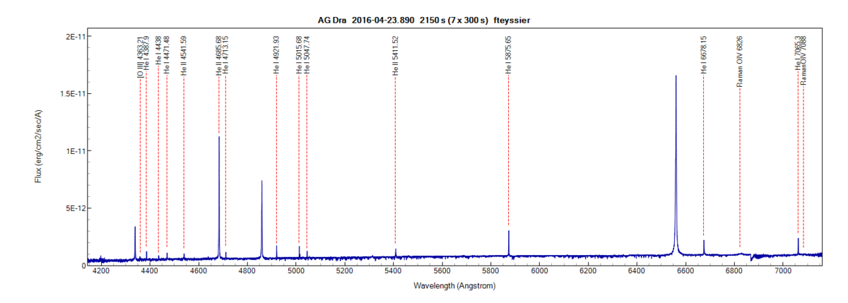

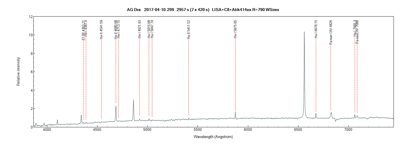

Forrest Sims
- Posts: 86
Here is a commented (ignoring the Balmer lines to reduce clutter) spectrum using PlotSpectra of AG Dra from last night. Maybe someone could enlighten me on the significant lines to look for and how to interpret the strength or weakness of these lines as compared to François spectrum in outburst?
Thanks!
Forrest
Thanks!
Forrest

- Posts: 1562
Hi Woody
The giant of AG Dra is a K0-K3 giant of low metallicity. This is the reason why Fe lines do not appear
At low resolution, what can we do?
Measure Hb and HeII 4686
Let K = 0.534 * F(HeII)/F(Hb)
The temperature of the hot object can be estimated: T = 19.38*K^1/2 + 5.13 (in 10000 K unit)
This is a simplified Iijima's formula (1981), derived from Zanstra method
The ratio between HeI singlets and triplets (for instance 6678 and 5876) is a valuable indication of the electronic density
The flux of Raman OVI lines 6830 7085 (Raman scattering of O VI λ1032, 1038 A photons off neutral hydrogen) allows amateurs to "see" the farUV
The évolution of the flux of these lines will depend of the type of outburst ("cool" : they will nearly desappear "hot" : remain bright)
Interesting : the ratio F(6830)/F(7085). See Shore &al. (2010) : https://arxiv.org/abs/0912.1890
At higher resolution : lines profiles, radial velocity of the RG, ratio between the bue and red part of Raman OVI lines ...
Look at: http://www.astronomie-amateur.fr/Docume ... CE2016.pdf
All the best

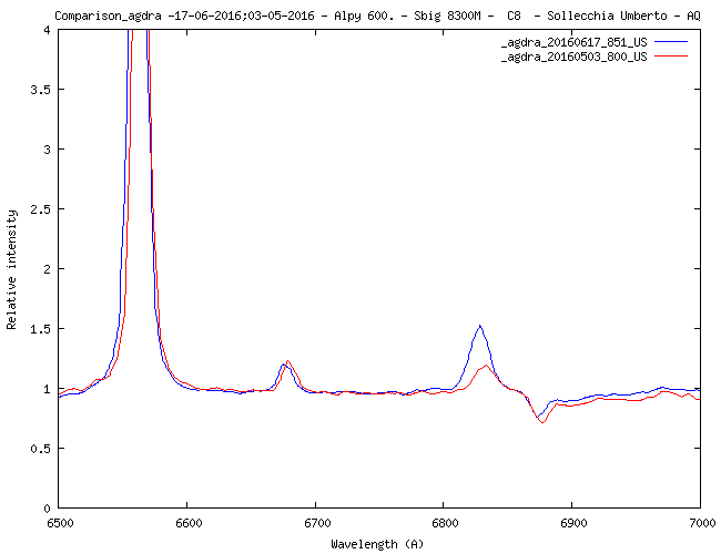

- Posts: 1424
Comparison of 11/04 and 14/04 observations of AG Peg (Halpha). No very significant variation (the telluric are removed for a better comparison) :
