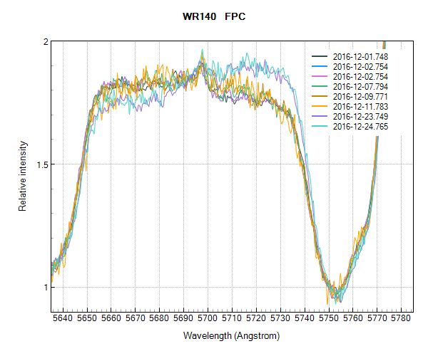

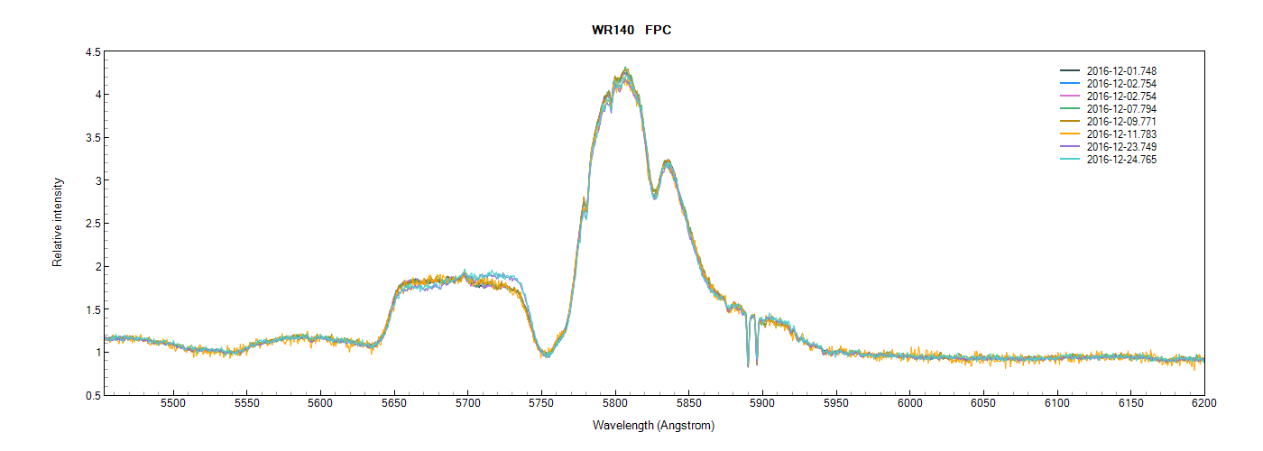

Hi, Robin,
mistery solved (I think so). Thanks to the advice of Joan Guarro, I could reduce all the spectra taking a spectrum of October as a pattern and correcting the instrumental response comparing all the spectra with this pattern. Here are the results:
wr140_ 20161201_748_FPC amp.png (69.27 KiB) Viewed 9075 times
I think all these spectra are ready to be send.

For this I only focused on the region of 5630-5760 A for the dates 18-25Dec16:
The is definitely a change in the region just right of the C3 line, between
5690 & 5740 A after 20-Dec-16.

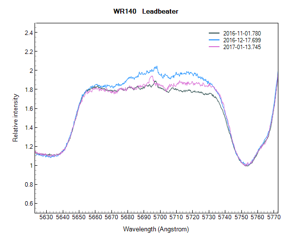

The CIII line compared with pre periastron and at perisastron
wr140_ 20161101_20170113_Leadbeater.png (28.69 KiB) Viewed 8978 times

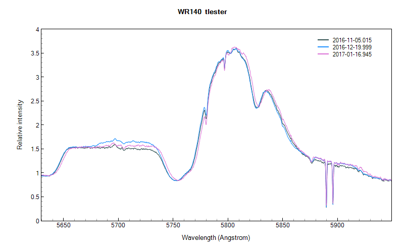

Here is may last spectra plotted along with my results at periastron and early Nov.
Robin - this is a very similar to your last plot but I find that post periastron the CIII line is shifted to the red. I am correcting for HRV and the Na lines line up nicely.
Did you align the CIII line in your plot? I am worried that something funny may be going on with my dispersion calculation (although everything looks sensible).
v1687cyg_ 20161105_015_tlester.png (34.98 KiB) Viewed 8920 times
Weather permitting I may be able to get one more spectra before WR140 disappears behind trees.
Re: WR140 aproaching periastron
Hi Tim,
Yes the spectra are approximately shifted to the WR velocity frame of reference. Sorry I should have stated that in the post. The RV of the two components is changing fast around periastron.
