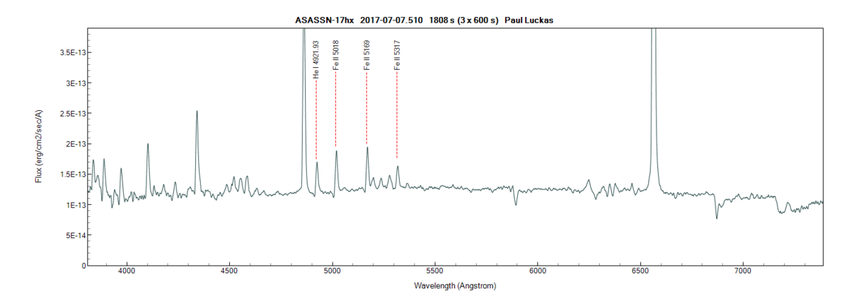

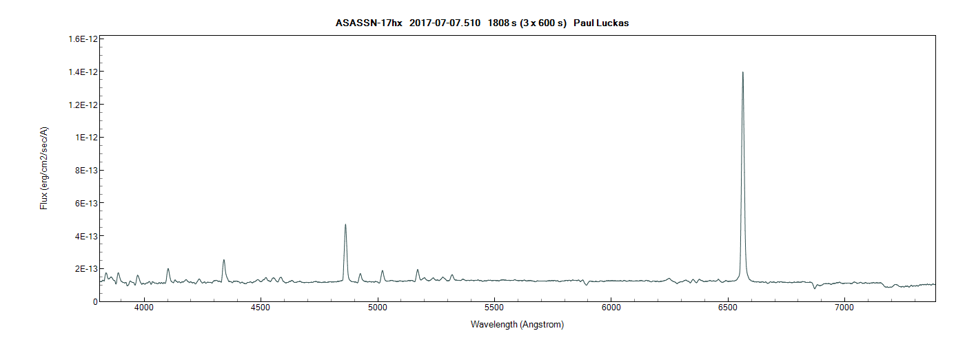

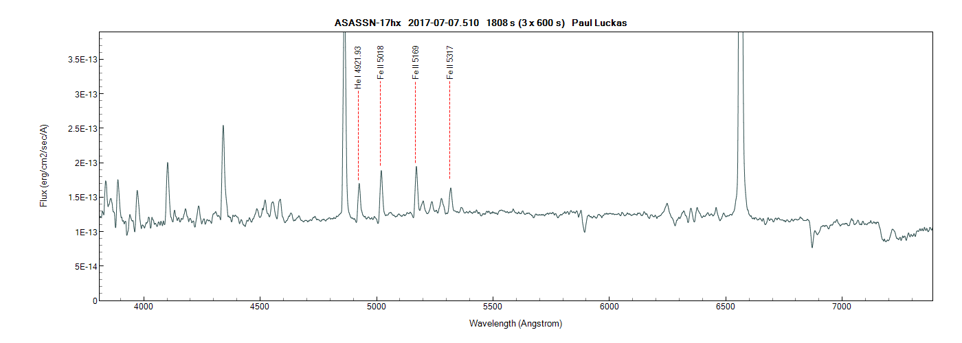

I'm joining the party.
R = 540, Flux calibrated using photometry taken at the same time (V = 11.142)

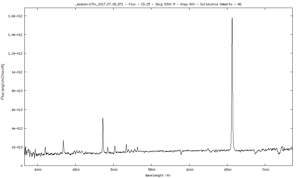

- Posts: 577
Hi all, the nova brightness appears to be further increased (yesterday I measured V mag = 10.93).
The July 8 spectrum:
The Fe II lines seem to have a more prominent P-cyg profile. The multiplet 42 velocities, measured on the P-Cyg minimum, are slightly decreased (~ 320 Km/s).

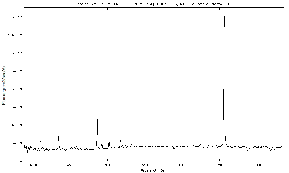

- Posts: 247
Bonjour à tous, placez le profil d'osservazione della nuit de 10-07-2017.L'étalonnage est flux absolu avec photométrie simultanée de Paolo Berardi.

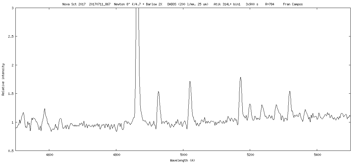

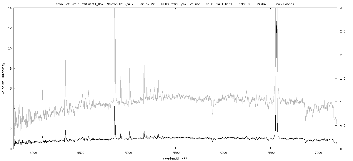

Francisco Campos
- Posts: 88
very late, but finally yesterday I could take a spectrum of the nova. Only three shots; these last nights we stand hot temperatures and a very wet ambient, so the sky is often covered by low and persistent clouds. For this spectrum I used HD 179761 as comparison star.

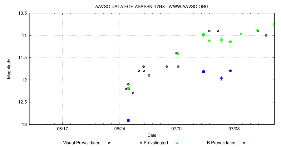

Photometrycally the nova is now at his maximum brightness, according to AAVSO observations. Maybe Nova Sct 2017 is a slow nova (Nb)? Definitively it seems quite different if we compare it with Nova Del 2013.
Greetings
Fran

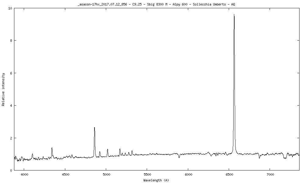

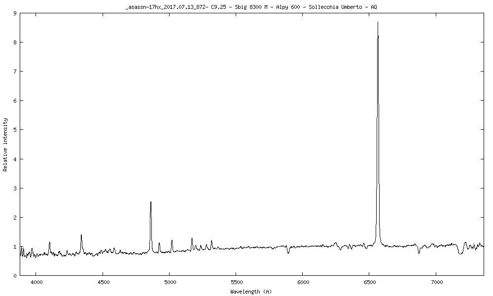

- Posts: 247
Bonjour à tous, placez le profil d'osservazione della nuit de 12-07-2017 et 13-07-2017.L'ampleur de la nova est encore augmentée comme indiqué par la courbe AAVSO.
Umberto.
Umberto.
