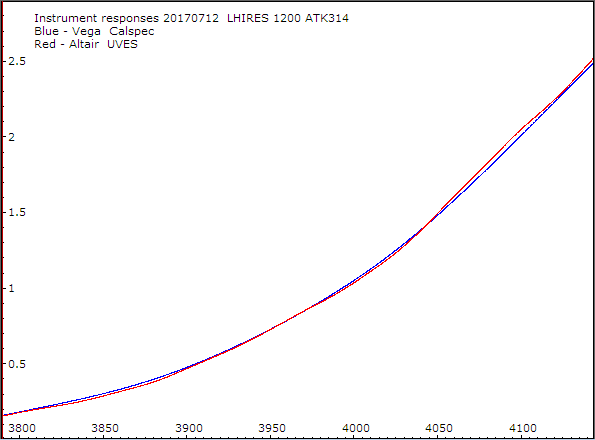

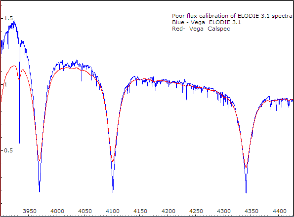

Here is a comparison of The Calspec and ELODIE 3.1 Vega spectra at the blue end and my instrument responses in this region for Vega (Calspec) and Altair (UVES)
- instresp_ 20170712_Altair_UVES_Vega_calspec.png (6.6 KiB) Viewed 15137 times
- flux_error_vega_elodie_v_calspec.png (11.88 KiB) Viewed 15137 times

RE:......but when using Vega as a reference in this region for high resolution work, I use the Calspec spectrum. It is not ideal as it is lower resolution but filtering the measured spectrum to match produces an acceptable instrument response."
Thanks! I was uncomfortable using the ELODIE 3.1 as the spectra of Vega start so high (4100A is even worse). I'll reprocess my IR using Calspec in Isis database.

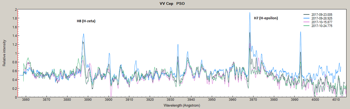

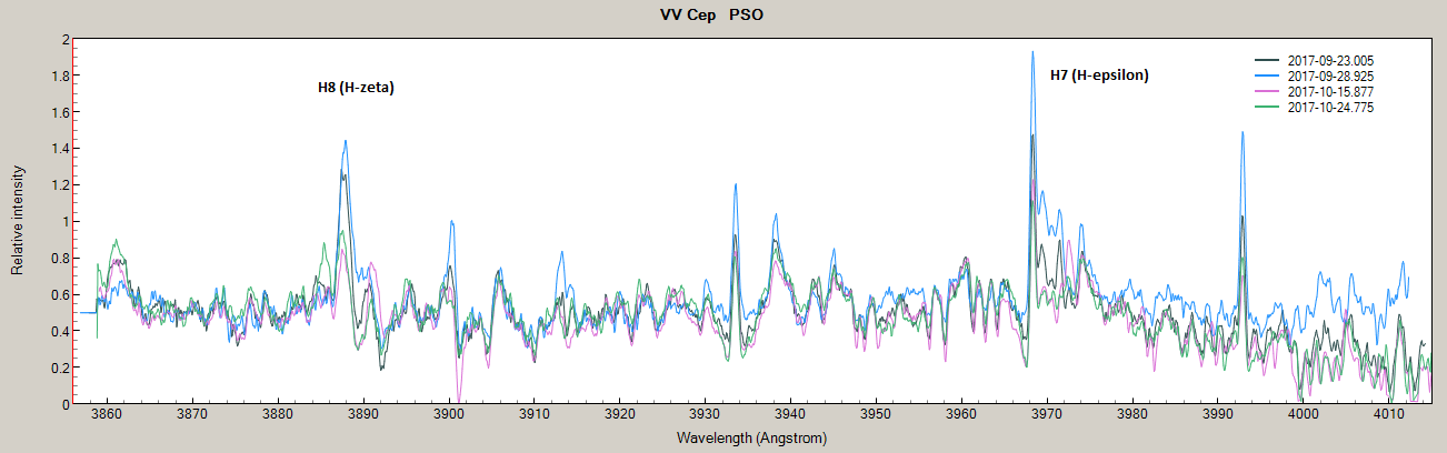

- Posts: 420
Re: VV Cep this night
James,
I'm looking forward to see your fits file showing up in the database!
It is important for me getting confirmation, as I can see this variation since the chromospheric eclipse (yet a question when the "total eclipse" is coming).
Once after subtracting Alp Ori (+ adding 0.5 constant) this is how my serie looks: So this 1:1 subtraction uncovering lots of unconfirmed variabilities above noise threshold, but even I'm unsure how valid are these!

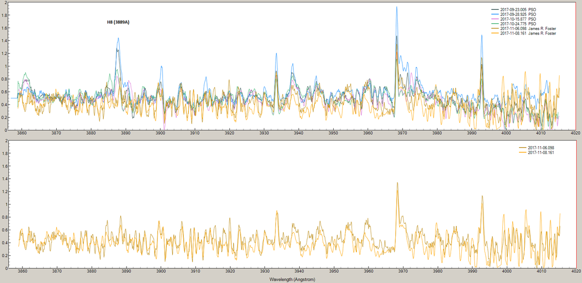

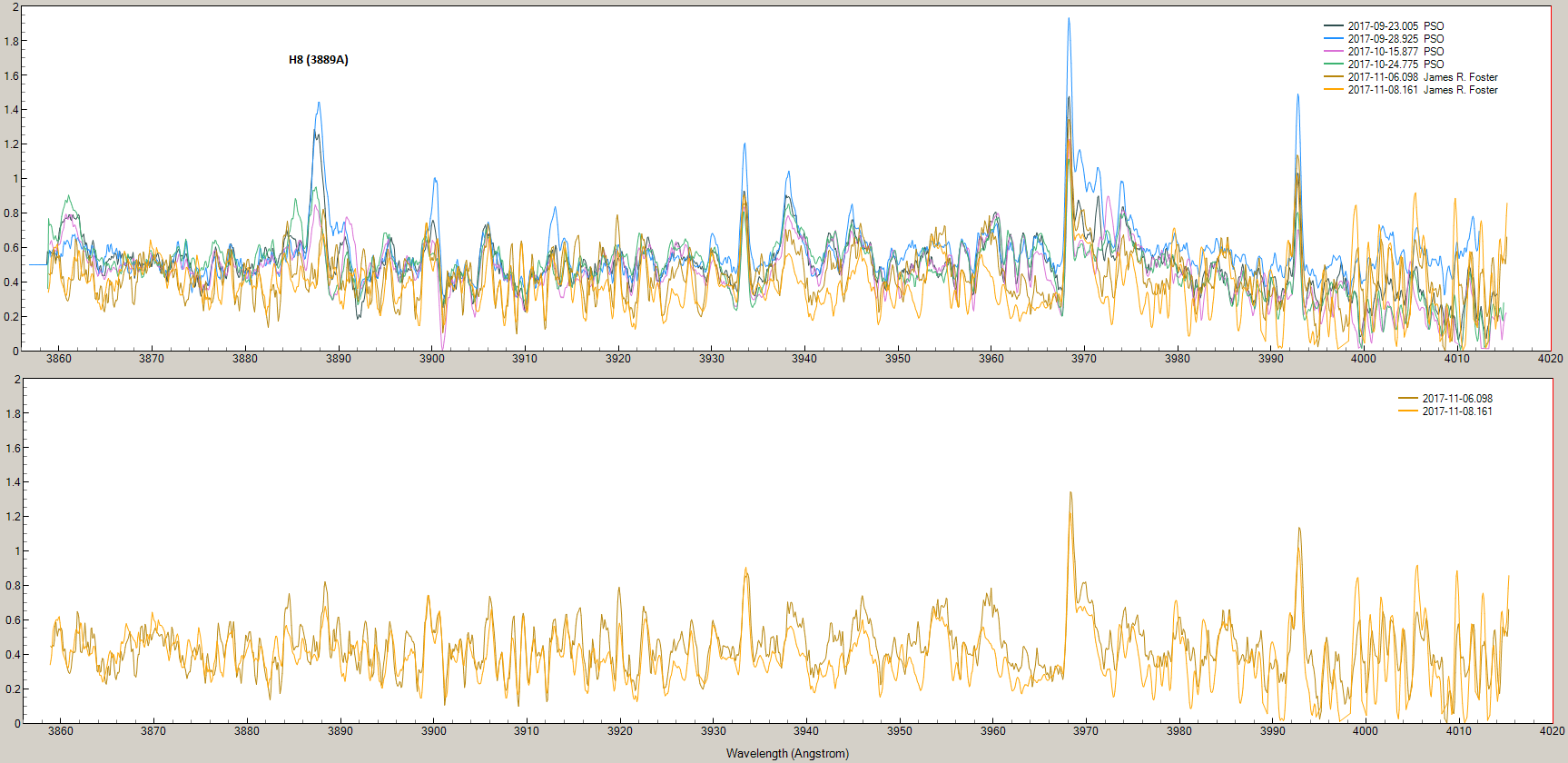

- Posts: 420
James,
Your spectra in the CaII region seems to be compatible, after subtracting my Alp Ori from yours + adding 0.5 (PlotSpectra 1.5.1.0 doesn't support negative values): H8 has disappeared, so we have caught this important event together!
