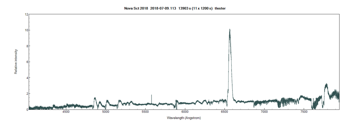

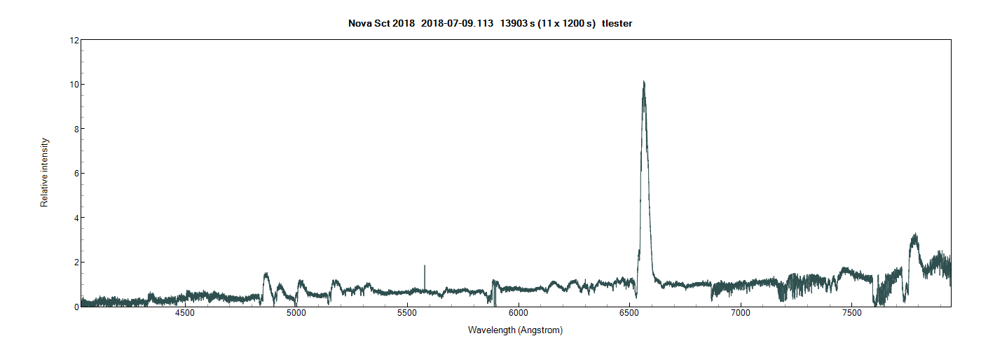

Here is my echelle result for July 9th.
I have replaced my QSI583 imager with an ASI1600mm pro. I am getting much better S/N, particularly at the blue end. Very pleased. :D

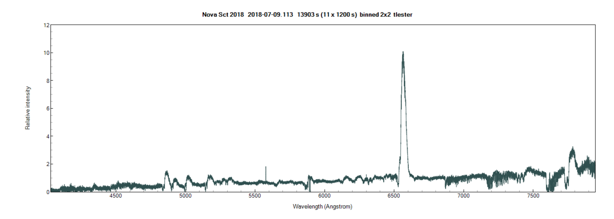

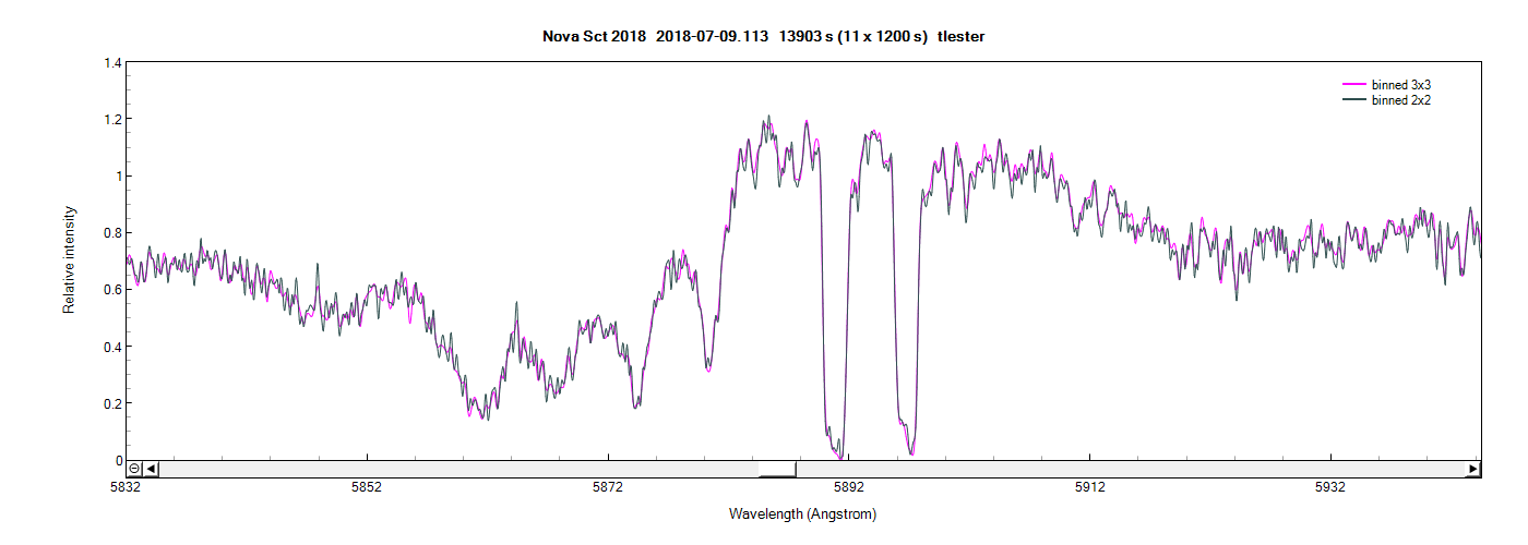

To answer your question Francois I actually binned 3x3 (after calibrating and combining the images un-binned).
This gives a sampling factor of only 2.1 which is not really enough. Also I had to leave optimum binning turned off in ISIS.

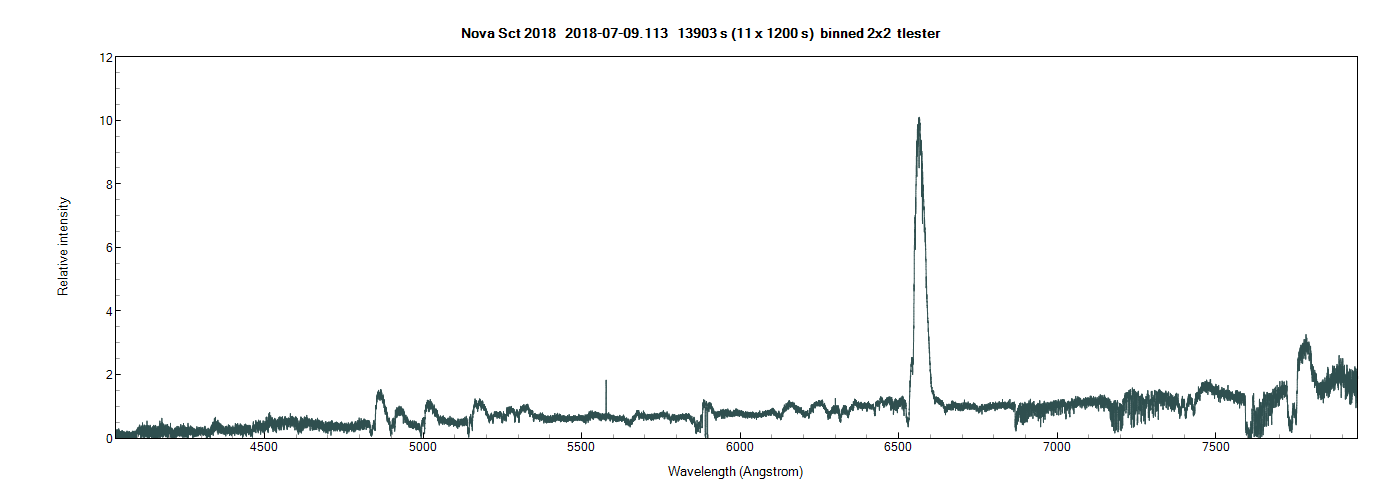

Here is the same data processed with 2x2 binnnig and with optimum binning turned on. Sampling is 3.2.

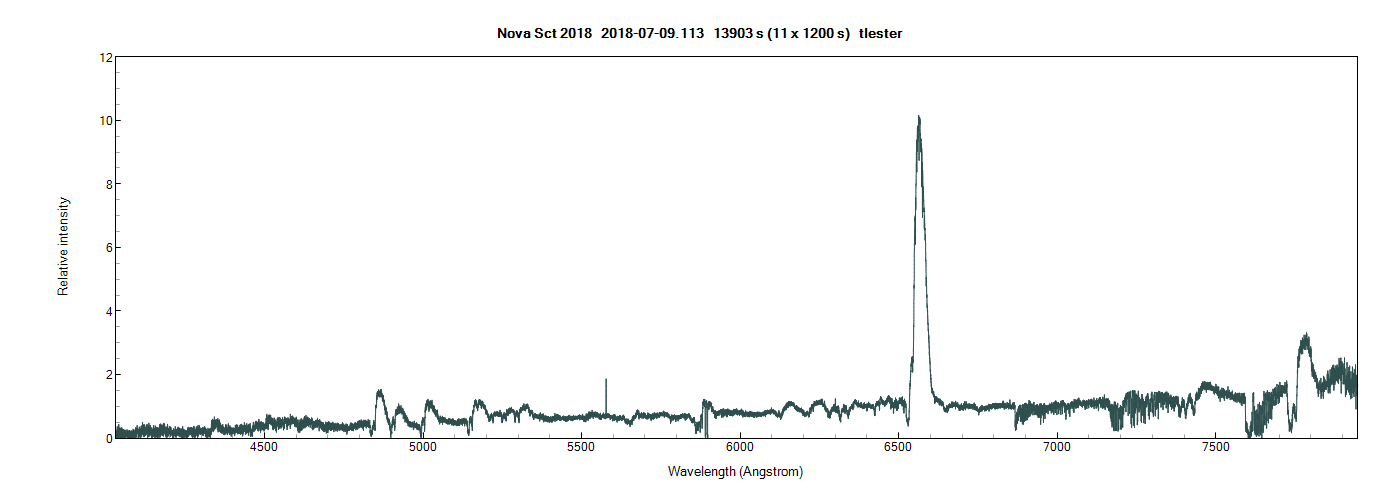

And here is a detailed comparison.
I'm not sure if the gain in S/N for 3x3 binning is justified for very faint objects due to the marginal sampling.

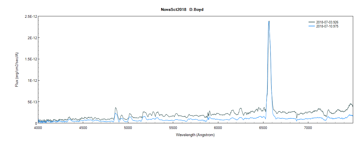

Change in the spectrum of the nova between 3rd and 10th July. V mag has dropped from 10.76 to 11.62 and the (B-V) colour changed from 1.22 to 1.08.
Flux in the H-alpha emission line has increased by almost 30%.

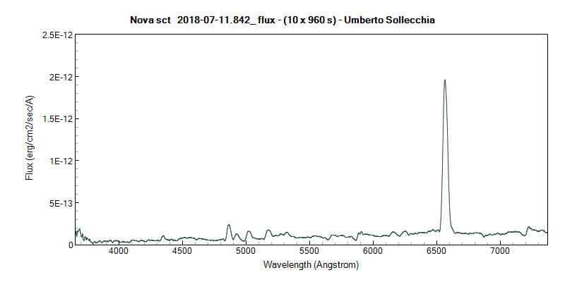

Bonjour à tous, placé le profil de la nova observé le 11-07-2018 calibré en flux absolu avec la photométrie contemporaine de Paolo Berardi.

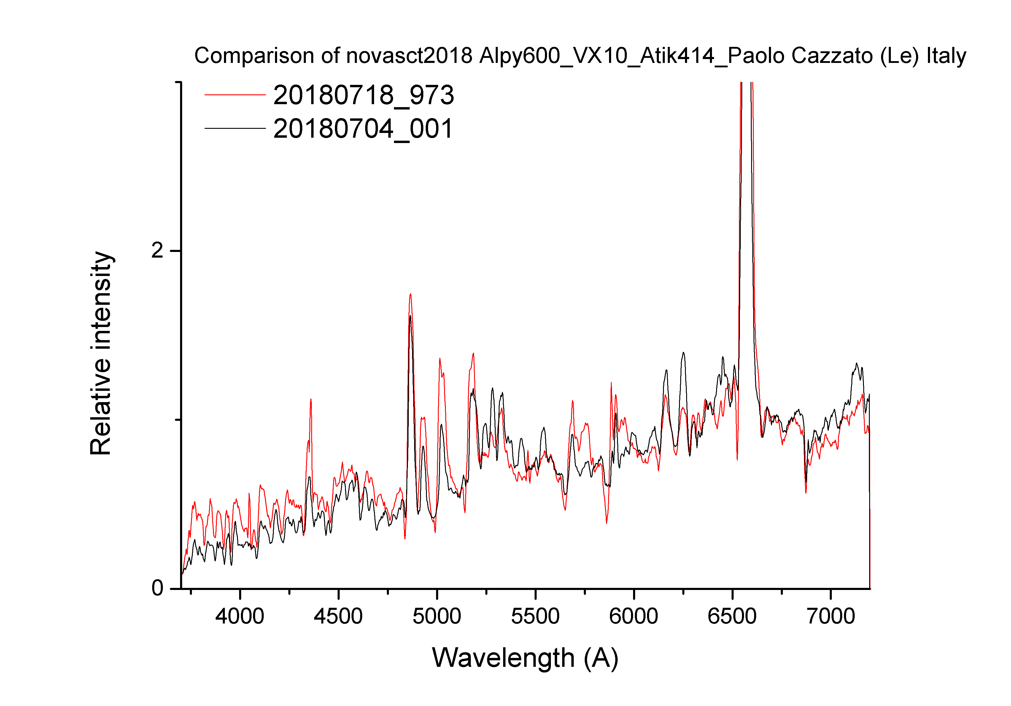

Hallo everybody,
here my last spectra compared with the 4th July consistent with those reported at low resolution.
Since we use a Newton telescope togheter with an Alpy setup, i am strong interest to know more information about calibration spectra and problems about the weight of the cameras and the spectroscope on the newton focuser. I Read Stephane Charbonnel used a newton; does someone tell me more?
