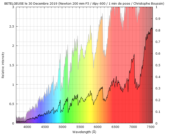

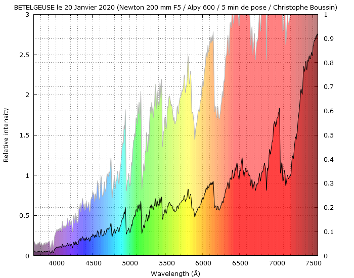

After a long period of cloudy nights, here is my contribution to the monitoring of Betelgeuse with two spectra.
The first one was obtained on December 29th, 2019 at 00 h 02 TU (Alpy 600, resolution 503, JJ = 2458847.502, 6 exposures of 10 s) :
The second spectrum below was obtained on January 20th, 2020 at 20 h 49 TU (Alpy 600, resolution 501, JJ = 2458869.3675, 15 exposures of 20 s) :

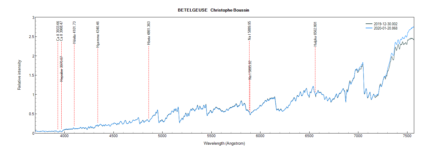

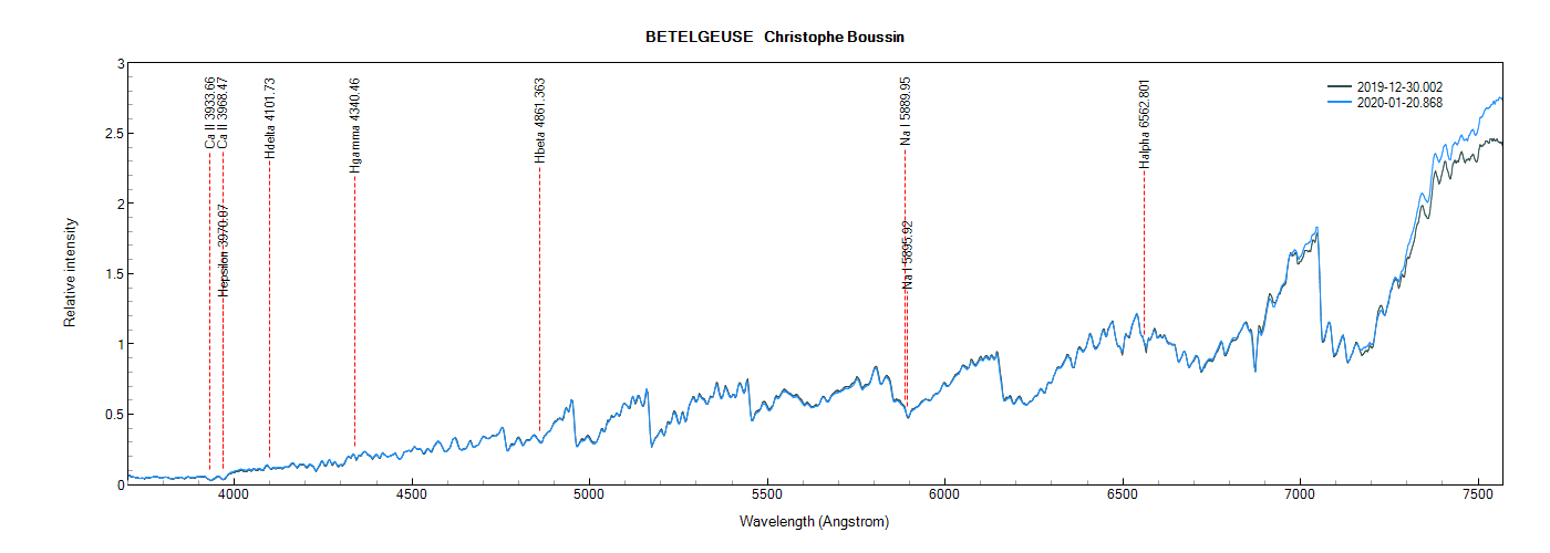

Comparison of the spectra :
Since December 29, I have not noticed any significant changes in the spectrum of Betelgeuse except maybe in the red part of the spectrum ?
Clear skies,

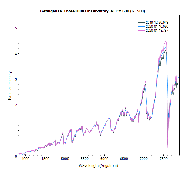

Hi Christophe,
My spectra also confirm the change you are seeing. There has been a continuing increase in the IR compared with the visible region this year (This is consistent with the decrease in V magnitude compared the H,J magnitudes in the AAVSO data)

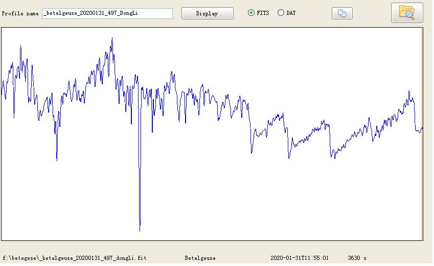

Hi all:
Here is my try with 1200L grating tonight. From 6450----6786.
