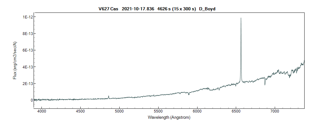

David Boyd
- Posts: 164
Here is a spectrum of V627 Cas taken on 17th October with a LISA spectrograph. The spectrum has been calibrated in absolute flux using a concurrently measured V magnitude of 11.99. The spectrum has been submitted to the ARAS database.

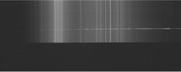

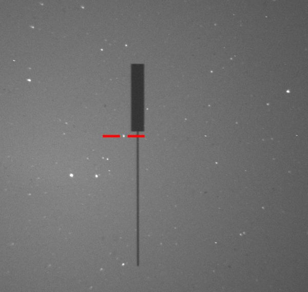

Hello everyone,
thanks to Jaroslav for giving us this new and exciting challenge. From his list I decided to treat the simplest Gaia object, Gaia10dxh, and acquired some spectra yesterday 20 October from my observatory located in the light pollution of a small town. After a comparison with the star map to be more sure that I selected the right star, I started to place on my slit the star that should be Gaia19dxh. As you can see from the scatter image taken in 1000 seconds, it appears to be a cold star. I compared the resulting spectrum from a combination of just 5 spectra with an M6III (from ISIS software) and it seems to match. Can anyone confirm or deny this?
Clear skies
Clear skies
- comparison with M6III_resized.jpg (56.81 KiB) Viewed 28206 times
- Gaia19dxh Dispersion_resized.jpg (8.83 KiB) Viewed 28206 times
- Gaia19dxh su fenditura_resized.jpg (35.91 KiB) Viewed 28206 times

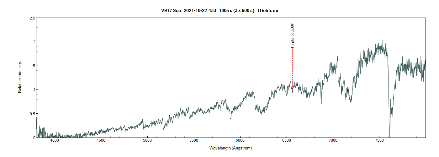

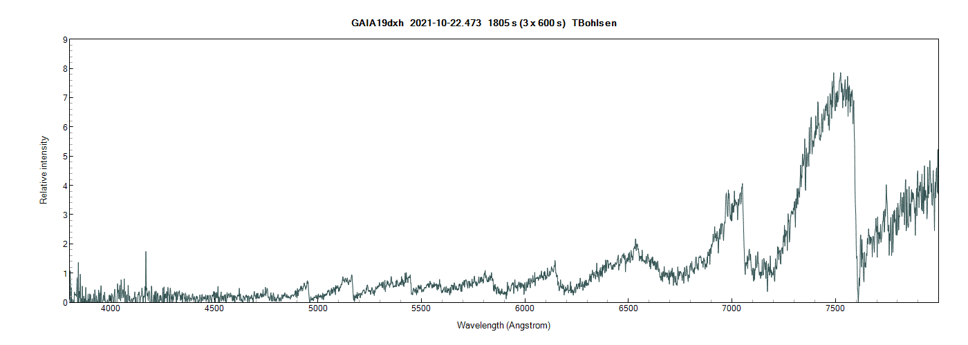

Terry Bohlsen
- Posts: 191
I have also tried a couple of these targets. Most set soon after dark so will not really be observable until next season. I took spectra of V917 Sco and Gaia19dxh.
V917 Sco shows a K type star with a small Ha absorption.
Gaia10dxh is a M star with no emission lines as Paolo also found. I will send them to ARAS also.
Terry
Terry

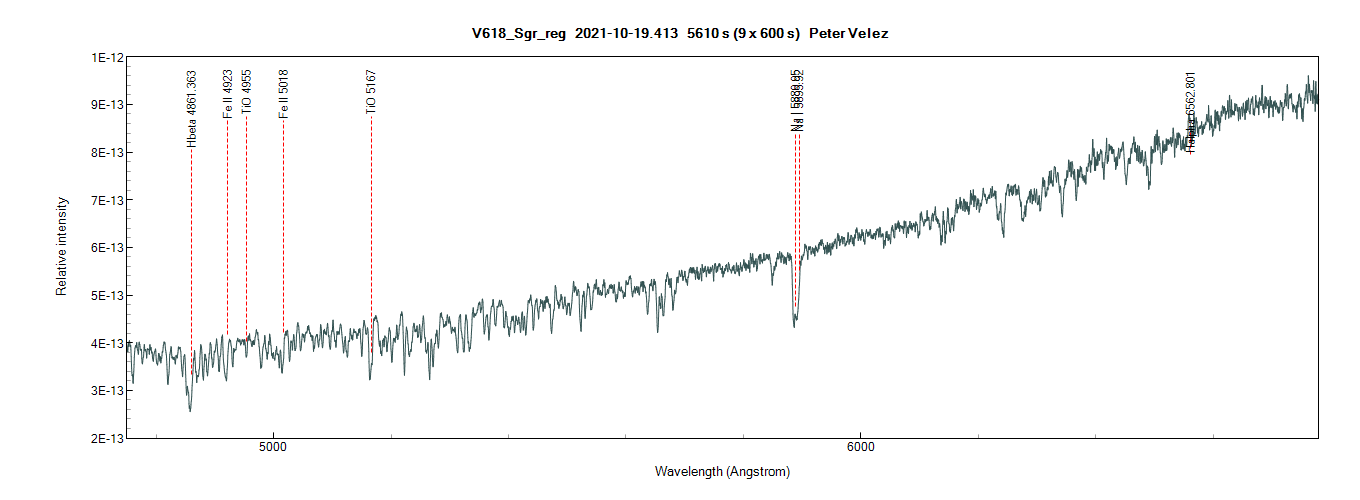

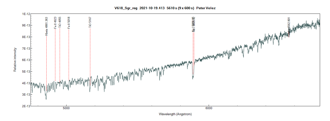

Peter Velez
- Posts: 153
I obtained spectra for V618 Sgr on 18 and 19 October 2021. I have attached the spectrum for 19 October 2021 - the 18 October observation was in close agreement with this. It represents 1.5 hours taken with a UVEX mounted on a PW CDK 12.5. ISIS reports the resolution as 1461. SNR is around 45 - 50. I measured a V mag of 9.54 with simultaneous photometry. The spectrum has been adjusted to reflect this.
I've marked the key emission lines identified in Kilkenny, D in 1989 (https://ui.adsabs.harvard.edu/#abs/1989 ... K/abstract) I don't find any emissions that correspond with the 1989 observations. Given this, I'll do a follow up observation in the next few days.
Pete
Pete

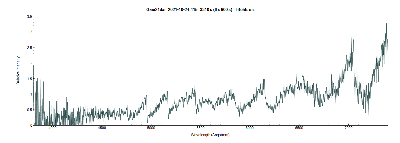

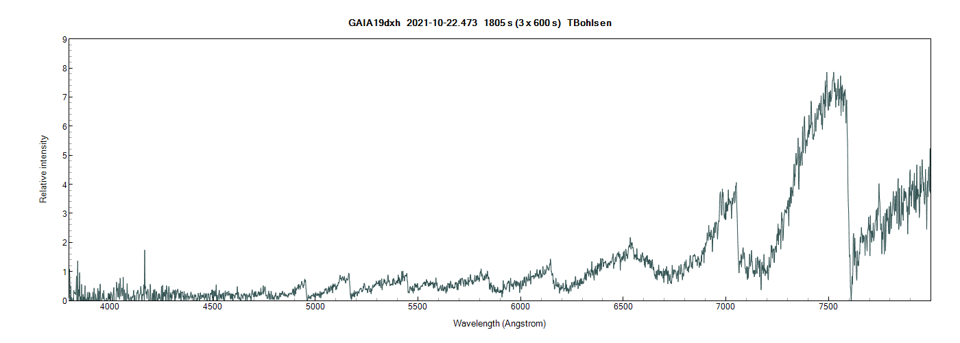

Terry Bohlsen
- Posts: 191
Hi All
another star from the list.
Gaia21dxi. Looks like a late K or M star to me with no emission or unexpected absorptions. It is a bit nosy as it was only 20deg above the horizon when I finished.
Terry
Terry
