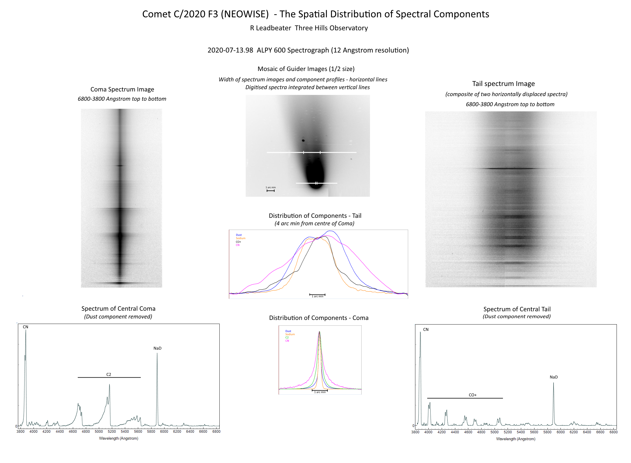

I have finally completed the analysis of my spectroscopic cross sections through coma and tail taken 2020-07-13
Click for full size poster. Also on my BAA members page https://britastro.org/node/23655
It shows some interesting differences in the distribution of the various components which make up the cometary material.
The CN and Sodium components are seen in both coma and tail but the C2 component which dominates the coma emission spectrum is absent in the tail, replaced by the CO+ component.
The spatial distributions are significantly different for the various components. In particular the sodium emission in the coma is confined to a narrow central region but the CN component is widespread in both the coma and tail. The Sodium distribution in the tail is skewed anticlockwise relative to the dust, consistent with the presence of a separate sodium tail.
NOTE: This means the relative strength of the components in spectra of the coma will be different depending on the height of the binning zone.

Hello Robin,
Interesting study, I wondered, in practice how did you proceed to remove the dust component of the spectra?
Hubert

Hi Robin,
Impressive and smart analysis ! I am sure we will all learn from these observations of that unusual event .
It clearly demonstrate why we need to be very careful in comparing data from multiple observers at different time. However, if we assume that most observers (unless specified) will focus the binning area around the coma centre we may in position conclude that, for relative Na intensity point of view, the most important parameter will be the time (day of measurement). Then, relative intensity versus time (or distance) could still be a valid approach despite the sensitivity to the other effects… I already agree to say this is an intuitive, non professional statement… ;)
Thanks again for the data and analysis you are sharing here.

Hubert Boussier wrote: I wondered, in practice how did you proceed to remove the dust component of the spectra?
Hi Hubert,
The spectra were first calibrated in relative flux using a nearby reference star. (The sky background was removed using a region at the edge of the slit away from the comet). The dust component was then subtracted using a template derived from the Pickles G2v spectrum, modified to fit the shape of the continuum in the comet spectrum.

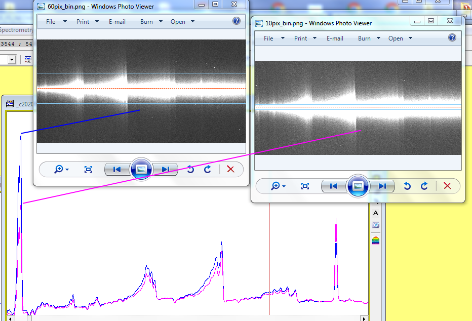

I made a quick comparison with 10 and 60 pixel wide binning zones on my observation 2020-07-13.
The differences are probably small in your graph of sodium intensity but in general the differences can be large (for example the ratio between sodium and CN)
The direction of the slit will also affect the result. (different materials extend by different distances in the tail direction for example)
Your sodium graph is probably ok qualitatively but for quantitative measurements you also have to consider what you are measuring. If you are measuring the emission intensity relative to the dust continuum then if the dust signal decreases (because there is less dust or the distance of the comet from the sun increases) the ratio of sodium to dust signal would increase even if the sodium emission remained the same.
