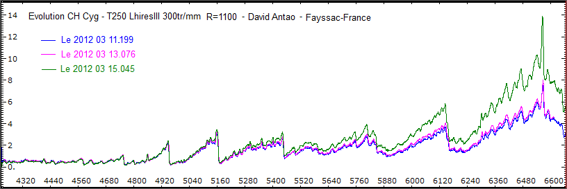

Re: AAVSO Alert Notice 454: Monitoring of CH Cyg requested
Je note une modification du continuum le 15 mars. J'ai refait plusieurs fois le traitement, bien vérifié l'absorption atmosphérique. Est-ce quelqu'un voit la même chose que moi?
- Comparaison ch_cyg.png (18.05 KiB) Viewed 19677 times

Thierry Garrel
- Posts: 182
- Location: Montpellier
David,
en réalité elle bouge trés peu. En haute résoltuion sur l'échelle de quelques heures les modifications, surtout en H alpha, sont trés subtiles.
Ici tu as surement un effet due à l'extinction atmosphérique. Tes spectres ne sont pas pris à la même élévation. Il n'y aucune chance, je pense, en basse résoltuion de voir quoique ce soit mais tu peux toujours demander à nôtre PI, principal investigator sur ce survey.
Amitiés
T
Amitiés
T

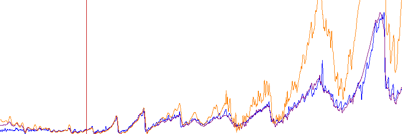

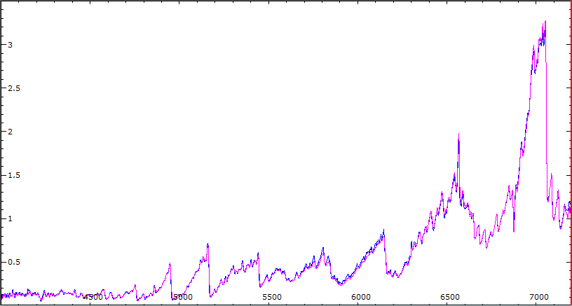

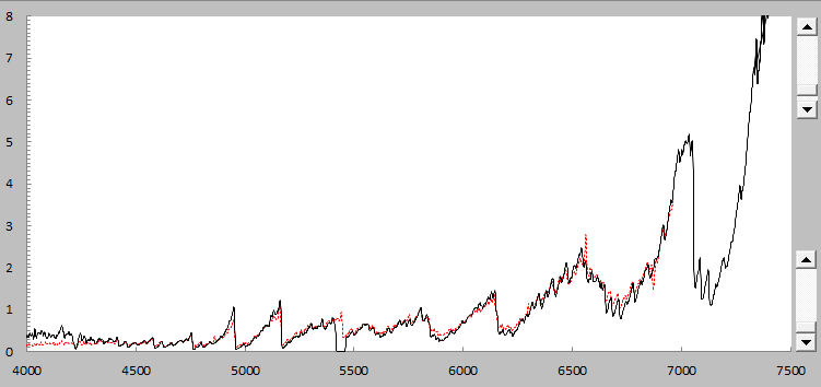

Thanks Thierry,Thierry Garrel wrote:I discussed a lot with Margaritta who didn't know well what we were able to do in spectroscopy. Format question was important and at first this was puzzling me. Wavelenght resolution came after and finally time resolution. When she finally succed to open fit or dat spectra her request on wavelenght coverage increased to H beta and quick graphic plot to her. It took us dozens of mail and fortunately the ARAS page help to cleared the survey conditions.
Now with the graphic nightly direct report and FIT/DAT archive, ZIP by night, gathered on ARAS evrything in on the tracks, except the weather for me.
I would like to say that Margaritta is an exceptional person, who is an open mind astronomer, and i can only encourage everybody to directly talk to her about this campaign.

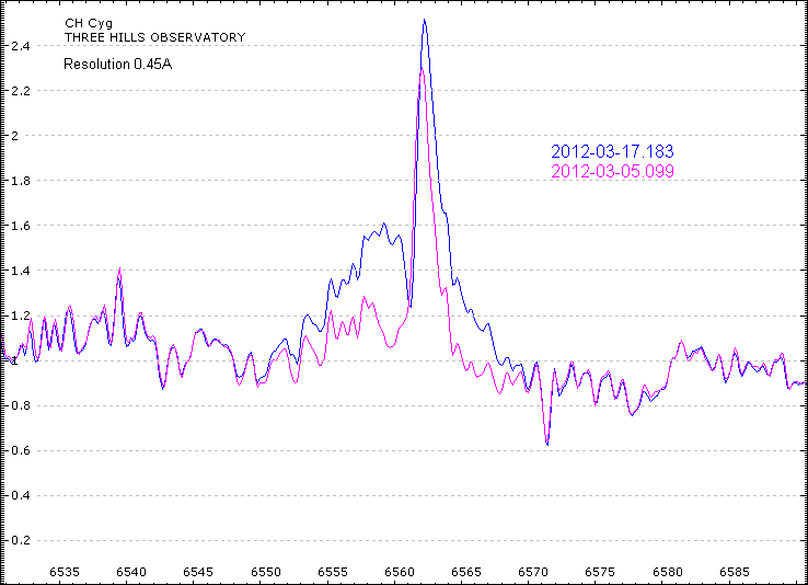

It is good she can now use fits files. (That was worrying me too.) I have also been sending her my plots and all the data will be on the web page of course. I think she has used AAVSO quite a bit but amateur spectroscopy still surprises the professionals. We seem to be doing something useful
I was able to get H alpha and O[III] last night. H alpha has changed quite a bit since 12 days ago.
- Posts: 1562
David,
Il n'y a a priori rien d'impossible avec cette étoile. C'est l'une des rares symbiotiques à montrer un flickering important à l'échelle de quelques minutes ou quelques heures (quelques dizièmes de mag, dans le vert et le bleu notamment).
En ce qui concerne tes spectres, si le pseudo-continuum produit par la géante rouge a réellment varier, tu doit retrouver cette variations au niveau des intensités relatives des différentes bandes d'absortion TiO, notemment dans le rouge.
Tu peux faire l'exercice de comparer tes spectes dans VSpec avec des références Pickles M6, M7, M8. Tu vas te rendre compte que l'un des deux séreis colle bien l'autre non.
Voici une comparaison de mon spectre du 12 avec une M7 Une comparasion avec une M7 et une M8 Tu as donc un probléme avec la RI. C'est ce qui est le plus difficile en basse résolution. En revanche, tes deux derniers spectres collent bien. Il faudrait que tu compare ton protocole (hauteurs, moment d'acquisition de la référence, choix de la référence)
CH Cyg est plutôt basse et sa hauteur varie de façon non négligeable.
Il est donc recommandé de prendre un spectre de référence avant et après l'acquisition et de comparer les RI.
Il existe aussi une autre cause difficile à maîtriser : varaition de l'atmosphère durant l'acquisition et entre l'acquisition et celle du spectre de référence (apparition de brume notemment).
C'est l'un des aspects intéressant dans ces suivis collaboratifs que de pouvoir comparer méthodes et résultats avec d'autres observateurs. J'avais énormément appris en suivant V407 cyg pendant plusieurs mois en parallèle de Christian.
Dans cette veine, voici une comparaison entre les spectres de Thierry Lemoult (16-03, violet) et moi-même (15-03, bleu) C'est excellent ; on peut à peine passer une lame de rasoir.
Un bonne promotion pour LISA et ISIS -;)
(ce qui n'empêche pas LHIRES 150 ou 300 l/mm d'obtenir de trés bon résulats comme le montre David)

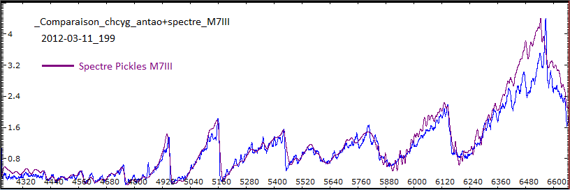

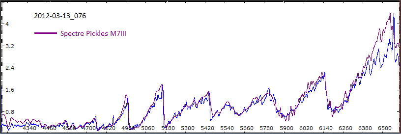

David Antao
- Posts: 20
- Joined: Thu Nov 03, 2011 4:21 pm
- Location: Midi-Pyrénées FRANCE

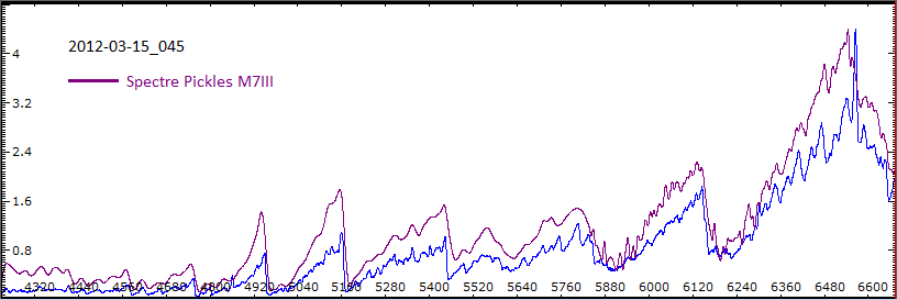

Merci pour les infos.
Voici une comparaison de mes spectres avec un spectre Pickles M7III. Il y a toujours une différence sur mon spectre du 15 mars.
Pour le calcul de la réponse instrumentale j'ai utilisé Iota Cyg qui est juste à coté, donc à la même hauteur. C'est qu'une nuit il y avait un tout petit peu de brume. C'est possible que ça vienne de là !?
David Antao
David Antao
- _chcyg_20120315_045_antao+spectre_M7III.png (18.39 KiB) Viewed 19655 times
- _chcyg_20120313_076_antao+spectre_M7III.png (17.74 KiB) Viewed 19655 times
- _chcyg_20120311_199_antao+spectre_M7III.png (19.64 KiB) Viewed 19655 times
- Posts: 1562
David,
Tu en as donc deux bons. Juste la RI dans le proche IR à essayer d'améliorer.
Pourquoi celui du 15 a t-il une bonne RI? C'est, encore une fois, toute la difficulté sur une spectre aussi étendu.
Si la brume est constante, cela ne pose pas de probléme. Ce sont les variations qui peuvent engendrer des différences. J'ai par exemple une série de 30 spectres de P Cygni sur 3 heures. 29 ne montrent pratiquement aucune variation du continuum. Le 30ème est décalé ...
J'utilise également iota Cyg comme référence.
C'est également un point important dans un suivi collectif d'utiliser la même étoile de référence.
Bonne continuation.
Ca vaut la peine de continuer à la suivre
a+
Bonne continuation.
a+
