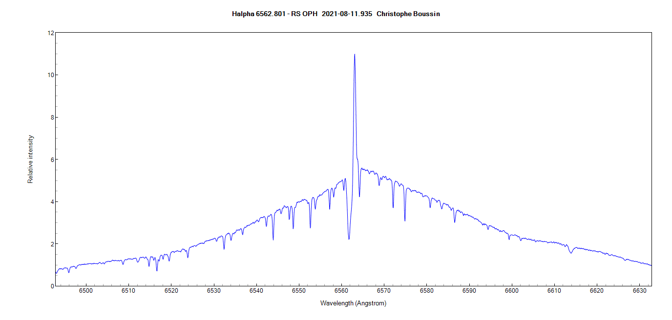

- Posts: 172

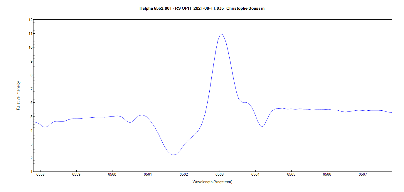

Finally a clear sky to follow the evolution of the RS Oph outburst !!
Here is my contribution with a spectrum of the Halpha line at high resolution obtained on August 11 at 22 h 26 TU (resolution of 18696, JJ = 2459438.435) with my LHIRES III (grating of 2400 lines / mm, acquisition time of 30 min (3 x 600s)).
More than ever, clear skies to all !!

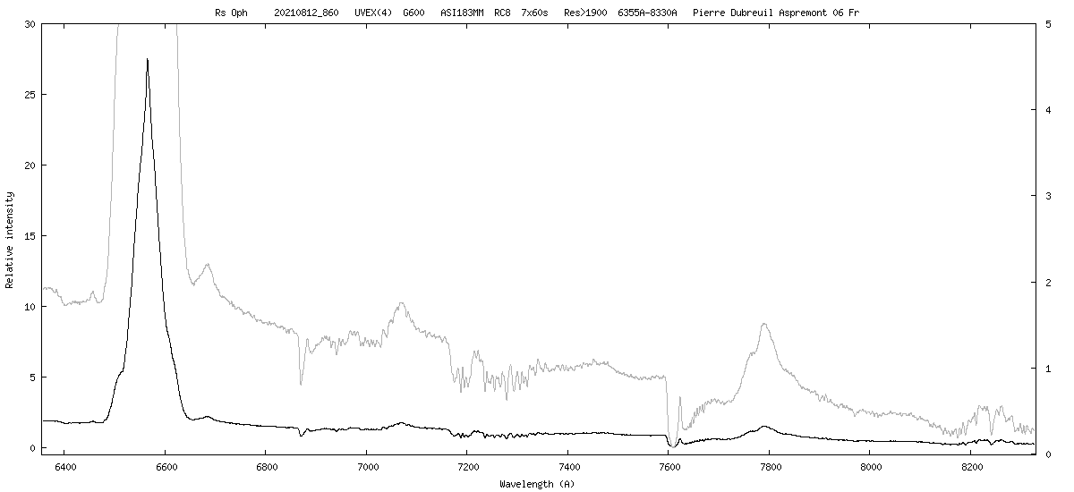

- Posts: 206

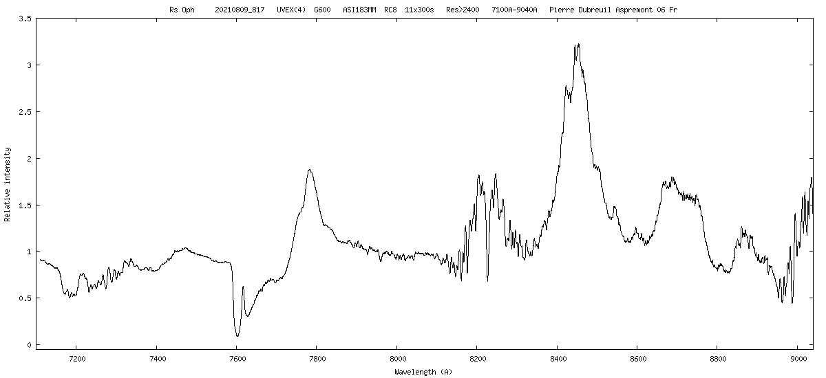

Bonjour à tous
Un peu de ciel hier soir après des orages dans la journée.
Spectre réalisé avec le spectrographe UVEX(4) G600 750nm RC8 Slit 23µ ...
détails autour de O I 8446
François, si tu à quelques infos sur ce profil ?
Et avec H-Alpha
j'envois le spectre FIT
Et avec H-Alpha

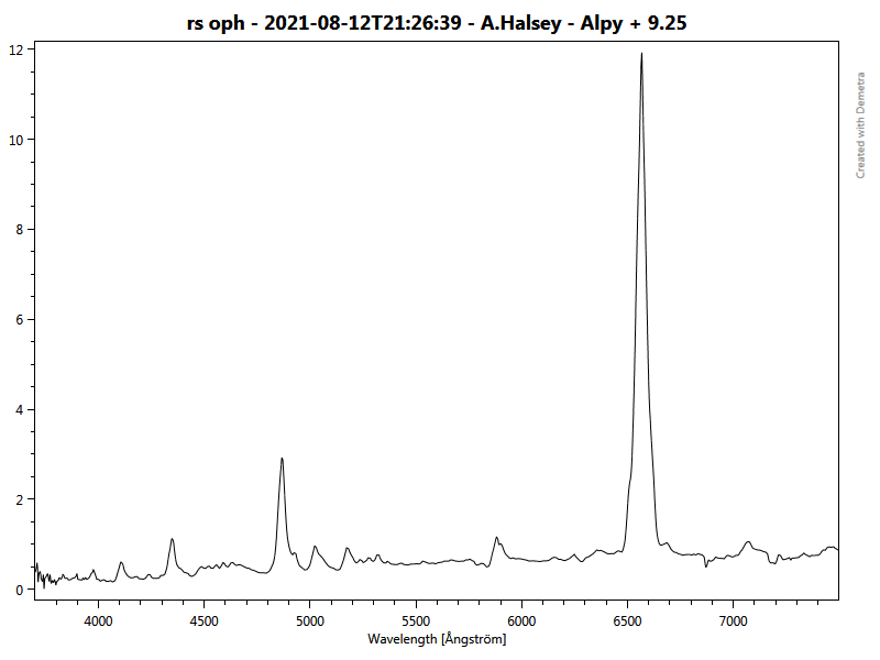

Alun Halsey
- Posts: 20
- Joined: Fri Jan 19, 2018 10:53 am

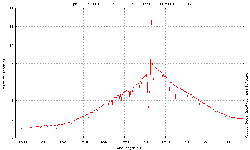

Having both my Alpy 600 and Lhires III attached to C9.25 via flip mirror I managed to acquire lo and hi res spectra last night (12th). Acquisition time for Alpy working at f/6,90 seconds (9x10sec) and
acquisition time for Lhires 21 minutes (7x180sec) both instruments with 23 micron slit.
Alun
Alun

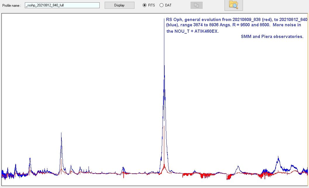

- Posts: 722
You can see the general evolution of RS Oph.
J.Guarro.
J.Guarro.

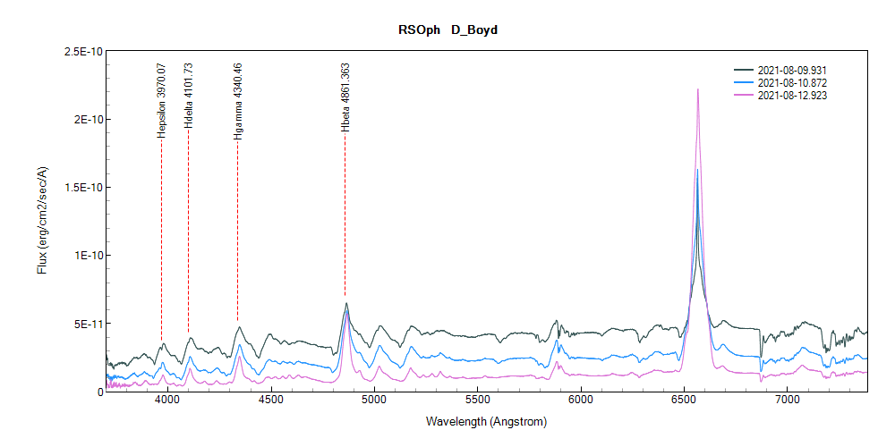

David Boyd
- Posts: 164

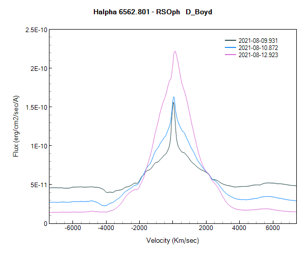

Continuum flux level dropping as the magnitude fades, V=4.88, 5.44, 6.24 for the 3 spectra below.
H-alpha now less sharply peaked, line flux has increased 3 times, peak velocity relative to rest wavelength increased from ~+30 km/s to +120 km/s

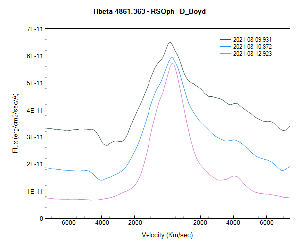

H-beta narrower, line flux unchanged, peak velocity relative to rest wavelength increased from ~+160 km/s to +320 km/s

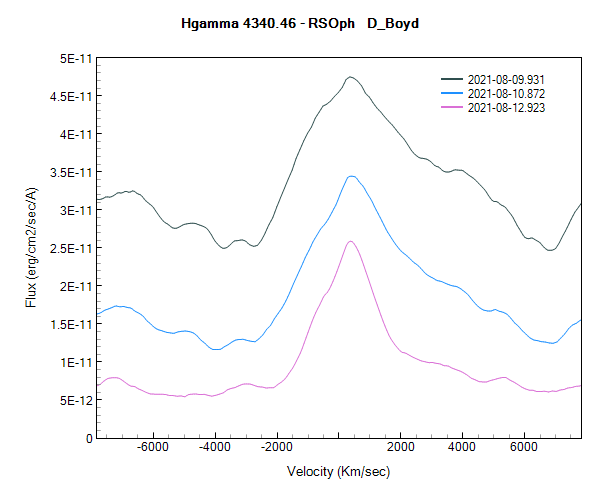

H-gamma narrower, line flux reduced by factor 0.4, peak velocity relative to rest wavelength steady at ~+360 km/s

- Posts: 1432
Three RS Oph observations night by using Star'Ex at the direct f/5 focus of a a 200 mm Newton (8-inch).
11.84 / 08 / 2021 : infrared by using a 600 lines/mm 750 nm blaze grating (R=1750) (note evolution of OI 8446 line relative to continuum):
12.89 / 08 / 2021 : H-alpha region by using a 2400 lines/mm grating (R=17000, very similar to Lhires III)):
13.84 / 08 / 2021 : UV by using a 2400 l/mm grating (R=6000 near 4000 A):
Note the detection of an emission on the H & K Ca II core lines:
For info, the UV spectrum of Vega by using the same setup:

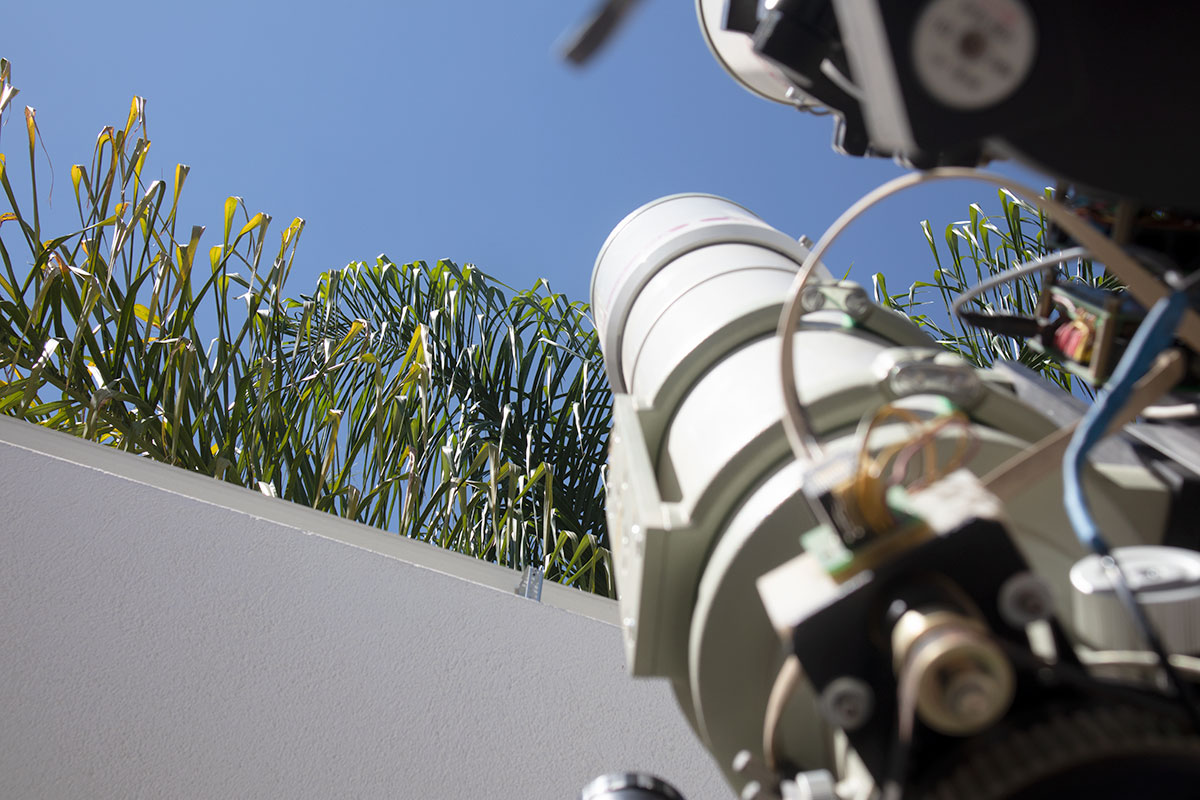

Rainer Ehlert
- Posts: 135
- Joined: Thu Sep 29, 2011 9:36 pm

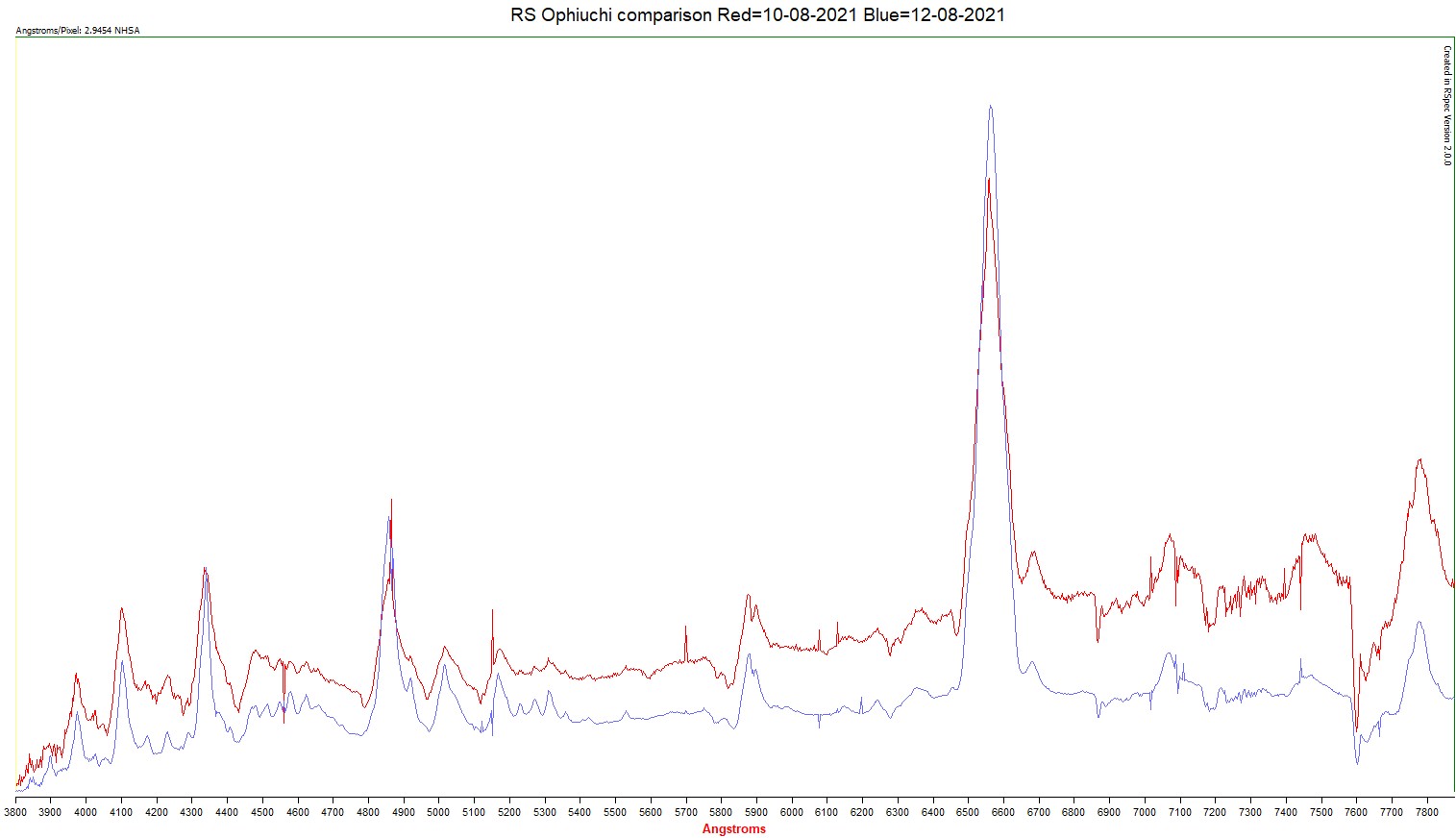

Having read a lot about RS Oph I told myself maybe I try it. Maybe, because to the South my neighbour has a Palm tree and that one covers up the whole South
OK, I was lucky to get RS Oph between two branches
I took some images on August 10 as well as on August 12. See attached image.
Now I have a question. I guess comparing images with different exposure times is not a good idea, or ? August 10 I used 60 seconds and August 12 I used 120 seconds.
Telescope is a TOA 130 with a 0.6>X reducer with a LISA @25 µm slit and CCD camera QSI520i in binning 1x3.
Thanks in advance for your comments
Rainer
Rainer

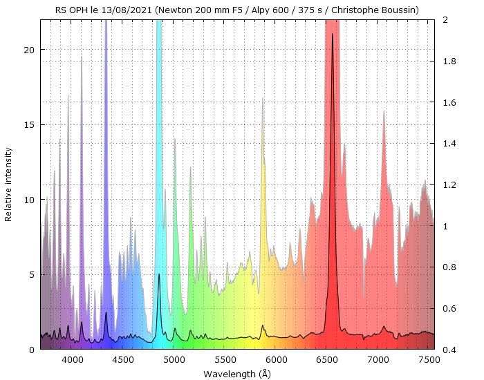

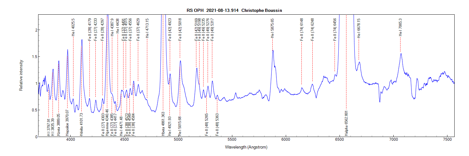

- Posts: 172
Here is my update for the monitoring of the outburst of RS Oph with a new spectrum obtained the 13th of August at 21 h 56 TU (resolution of 520, JJ = 2459440.4137) with my Alpy 600 and an acquisition time of 375 s (25 x 15 s) :
Clear skies to all !!
