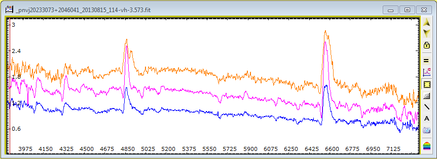

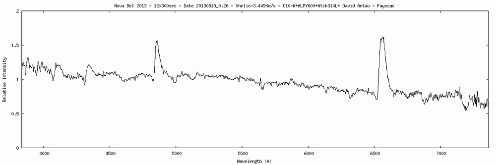

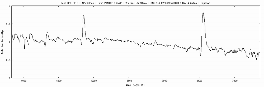

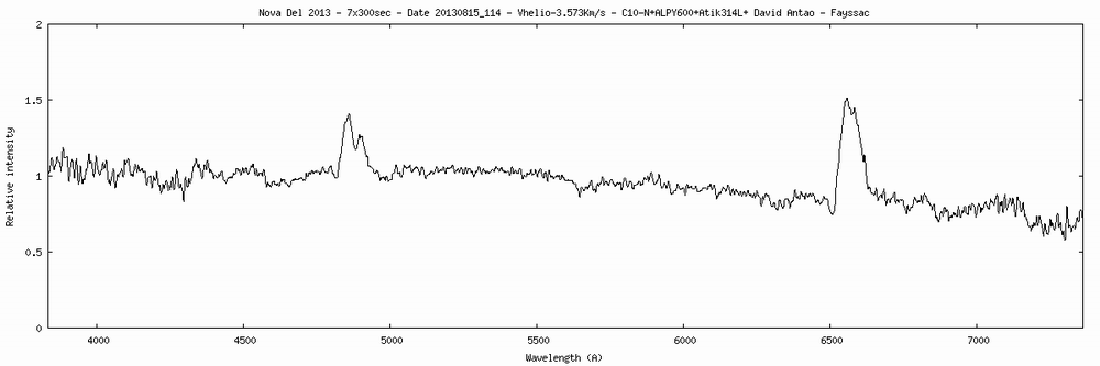

Hier j'étais aussi sur la nova. Voici mes résultats. J'ai pris Altair comme réf (je sais que ce n'est pas top, mais en faisant vite...)
Amicalement
David Antao
Amicalement
David Antao
- NovaDel2013_pnvj20233073+2046041_20130815_026_David_Antao.png (49.35 KiB) Viewed 95441 times
- NovaDel2013_pnvj20233073+2046041_20130815_072_David_Antao.png (49.2 KiB) Viewed 95441 times
- NovaDel2013_pnvj20233073+2046041_20130815_114_David_Antao.png (49.19 KiB) Viewed 95441 times
- SUPERPOSITION NOVA DEL 2013.PNG (24.37 KiB) Viewed 95441 times

David,
bravo! Côté référence, je suis passé sur hd196544 car elle est dans la base MILES de ISIS... à priori c'est le mieux comme référence.
Sinon, penses à envoyer tes spectres à François Teyssier. La collection sur ARAS montre combien la communauté amateur a été réactive et contribue au suivi vraiment fin de cette nova:
http://www.astrosurf.com/aras/Aras_Data ... l-2013.htm
Pour le format de fichier, c'est du BeSS avec extension .FIT et un nom normalisé pour aider à la gestion administrative des fichiers:
Cf: http://www.astrosurf.com/aras/Aras_DataBase/Usage.htm
Olivier
Olivier

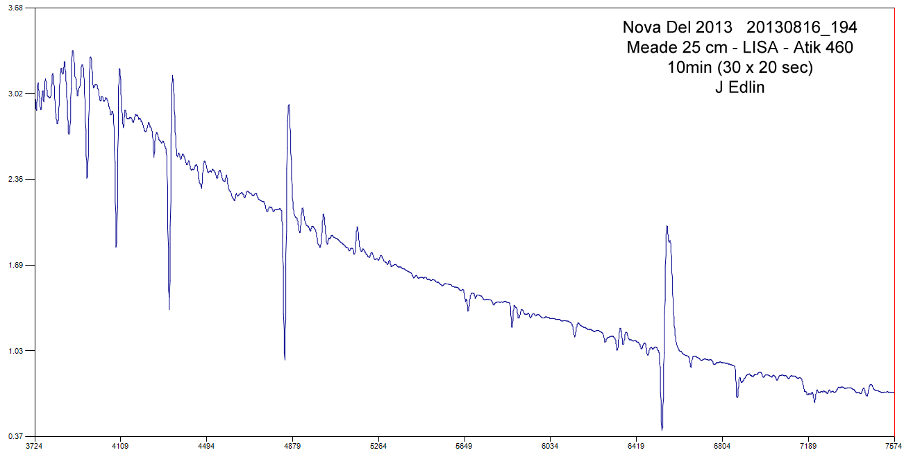

Tonight was clear and free from the dense forest fire smoke I had last night. Could see the nova easily and it nearly saturated the ccd in 20 sec exposure. Took new spectrum tonight with 25 cm Meade. See attached.
Jim E
Jim E

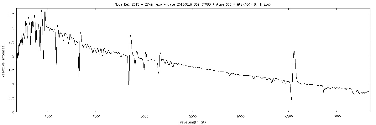

- Posts: 370
after some cloudy evening, the sky go clared and this is my third nght in a row on the new nova. It is brighter than last night and I had to shorten my individual exposure from 5min to 3min. Equipment is still my small 85mm refractor and Alpy 600 spectrograph with Atik 460EX (-10°C) camera.
Spectrum is very nice but I see several changes compared to last night. The P Cygni profile are less pronounced (blue absorption less visible compare to last night) specially on Fe lines. Halpha changed profile and the line at 6660A (He I 6678A blue-shifted at a speed of ~800km/s!) disapeared. Not sure what is hapening there...
I am now using hd196544 as reference star and MILES database in ISIS to calculate the instrumental response of my setup. But I do not take into account difference in airmass.
http://www.shelyak.com/en/

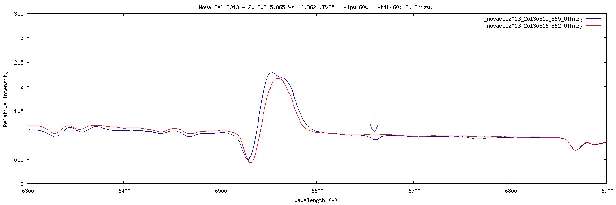

- Posts: 1276
Here's a graphe of the evolution of Halpha region during the 3 last days.
Voici un graphe montrant l'évolution de la région HAlpha sur les 3 derniers jours à 24H d'intervalle à quelques minutes pré...
