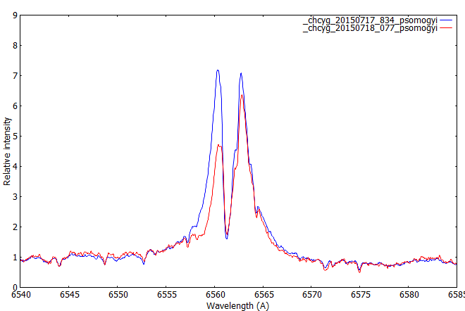

Before yesterday I did another experiment with the 600/mm by taking automatically Ne/Ar per exposure, finally I just did "Wavelength Registration" so used only the 1st of them - still saw the skew of lines at higher magnification (1-2A) that Wav.Reg. feature removes - but question then which of my per-exposure calibrations was correct.
So here is the basic result (this time 5 min x 29 frames), all processed by ISIS, using only 1st cal.frame:
(LHires 600/mm, 15 um slit, ATIK 414 EXm, R~3000 - 2500 in the end, Helioc. corrected)
At least caught a bigger outflow at H-beta, with tons of other lines varying.
The blue peak of Hb was down comparing to previous day.

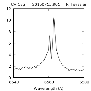

Re: Dramatic change of H alpha profile
H alpha line tonight
Double pic
Almost stable during the acquisition
Double pic

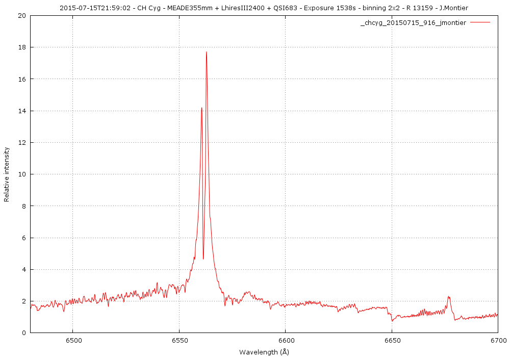

Jacques Montier
- Posts: 242
François, we have been recording the same target that night

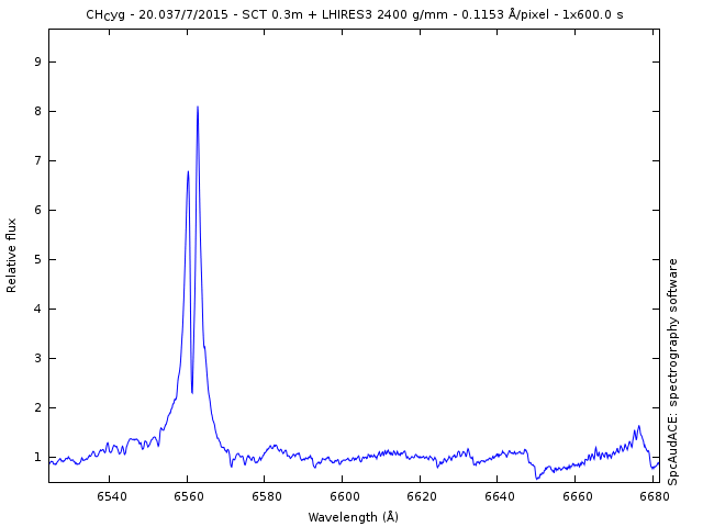

Here is a 2 hours animation of 10 minutes spectra with Lhires3 2400 g/mm and 12" SCT.
Spectra and animation were done sith Spcaudace:
We can see V/R inversion of Ha line while at the same time He I 6678 A line is maximum when V(blue) pic of Ha is at maximum.
Is there any interpretation of such phenomenon?
Benji
Benji

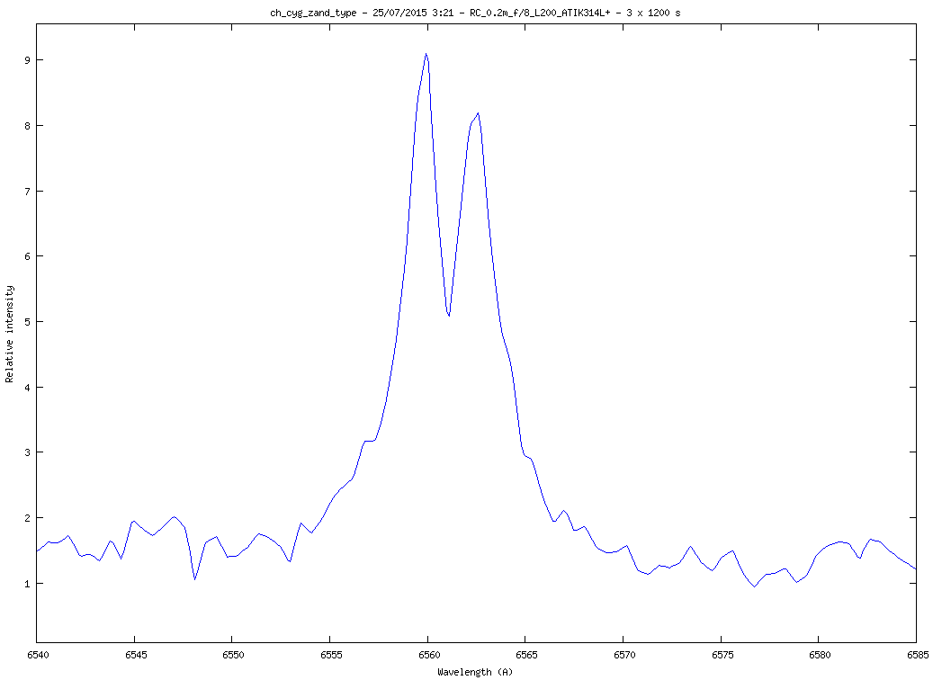

Spectrum from last night. Double peak. L-200 spectrograph with 600l/mm grating. R=4351 computed by ISIS.
- _ch_cyg_zand_type_20150725_140_Miguel_Rodriguez.png (8.31 KiB) Viewed 25989 times

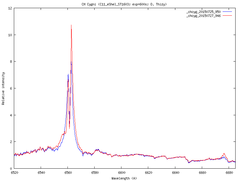

- Posts: 1276
Here's a time serie during 4H30 (one exposure each 5 minutes), a compilation of 52 spectra taken with eshel spectrograph (R=11000).
The graph show the variation of the blue part of H alpha line;

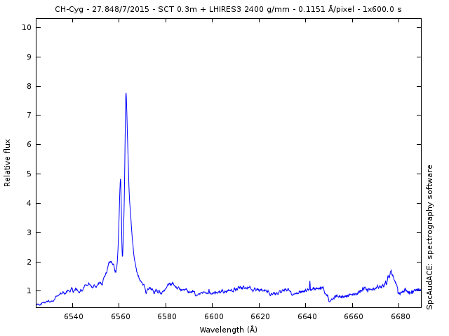

Hello everyone,

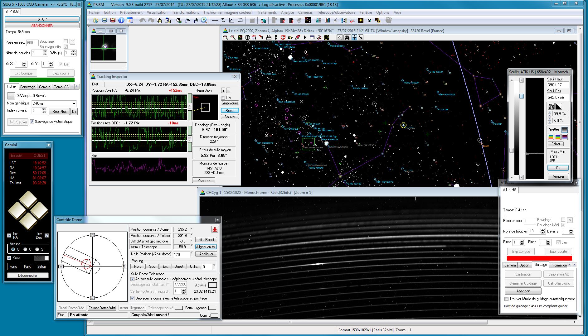

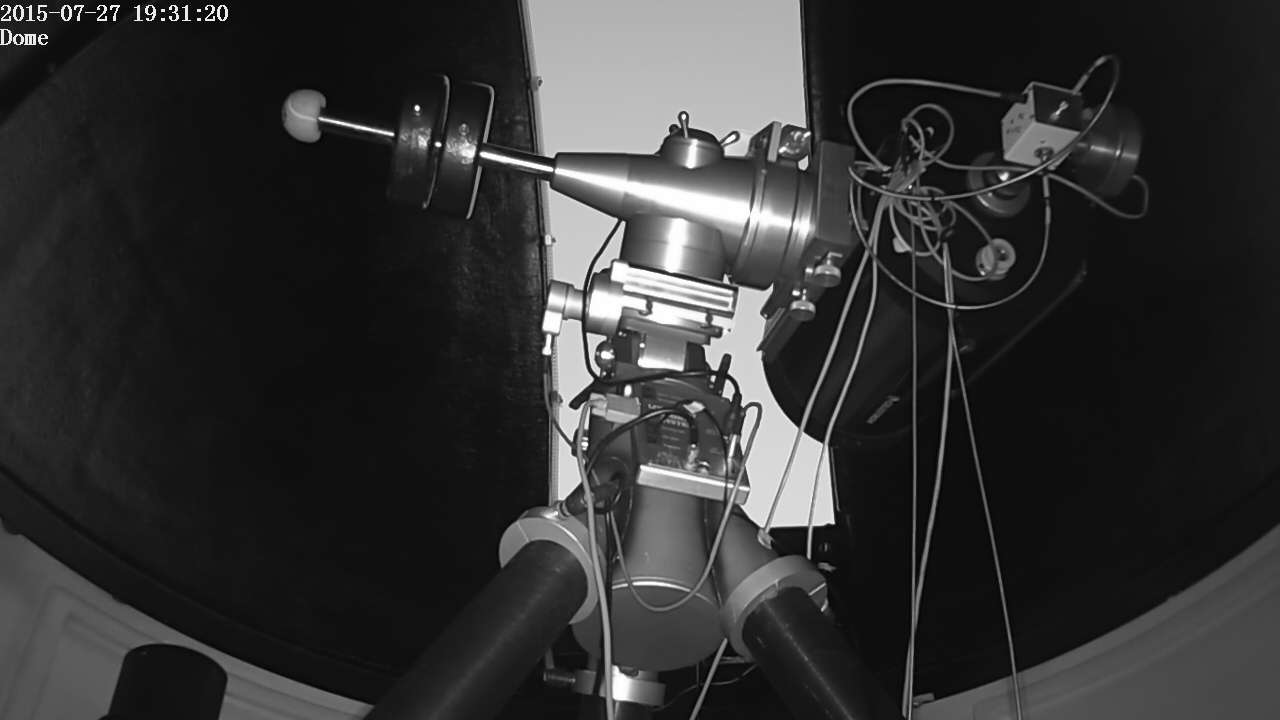

During July 27th, I've made a 7 hours run of spectra (10 minutes each). It started at 10h30 pm local time and stoped at 5h30 am local.
This automatic observation was done by running a script under Audela.
It takes calibration lamp spectrum every hour, then finish by parking the telescop, switch off all devices, backup and send the archive to the home computer and close observatory's roof.
This time, CH Cyg's spectrum started with an triple pic on Ha line. Then it disapeared.
We still see that maximum emission for blue Ha line and He 6678 line are synchronized.
Clear sky,
Benji
Clear sky,
Benji
