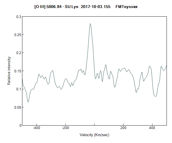

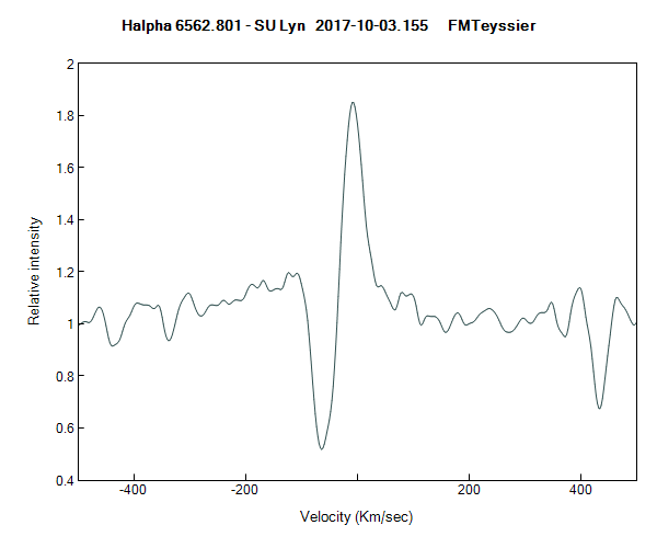

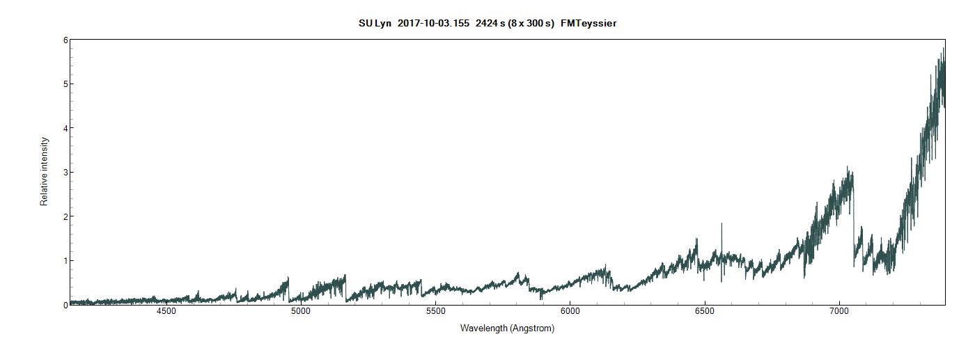

Re: SU Lyn Call for observations by Katarzyna Drozd
Last spectrum taken with eShel spectrograph (R=11000) and comparison with some previous observations
The full graph (23 orders merged)
H Alpha evolution
H Beta evolution

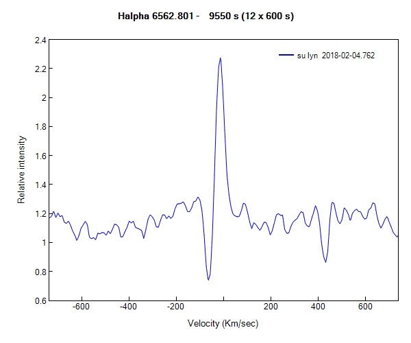

First clear night of the year!

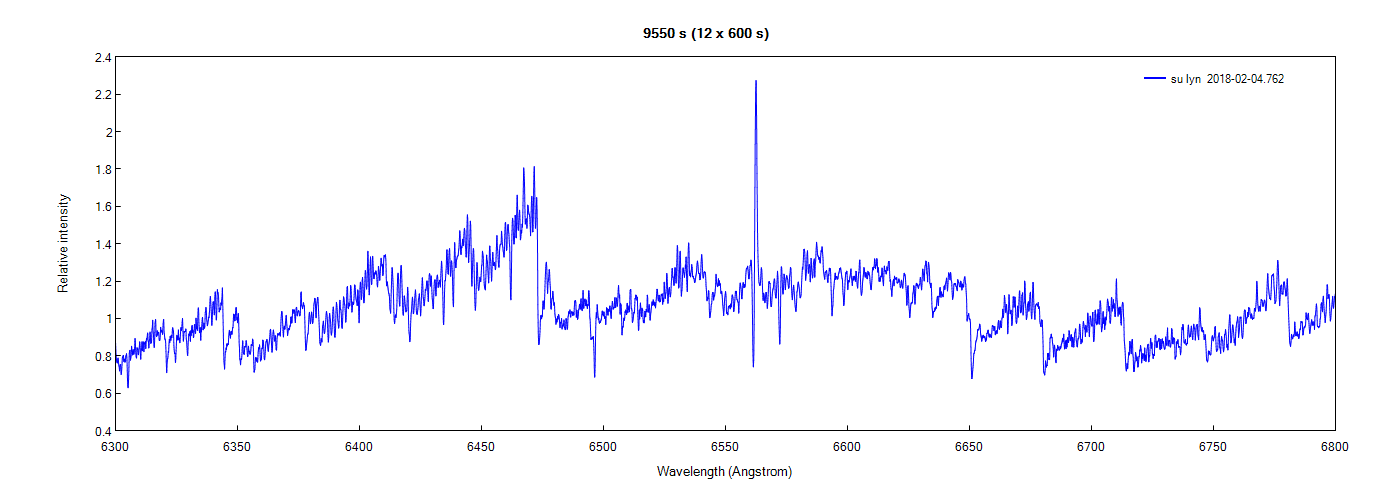

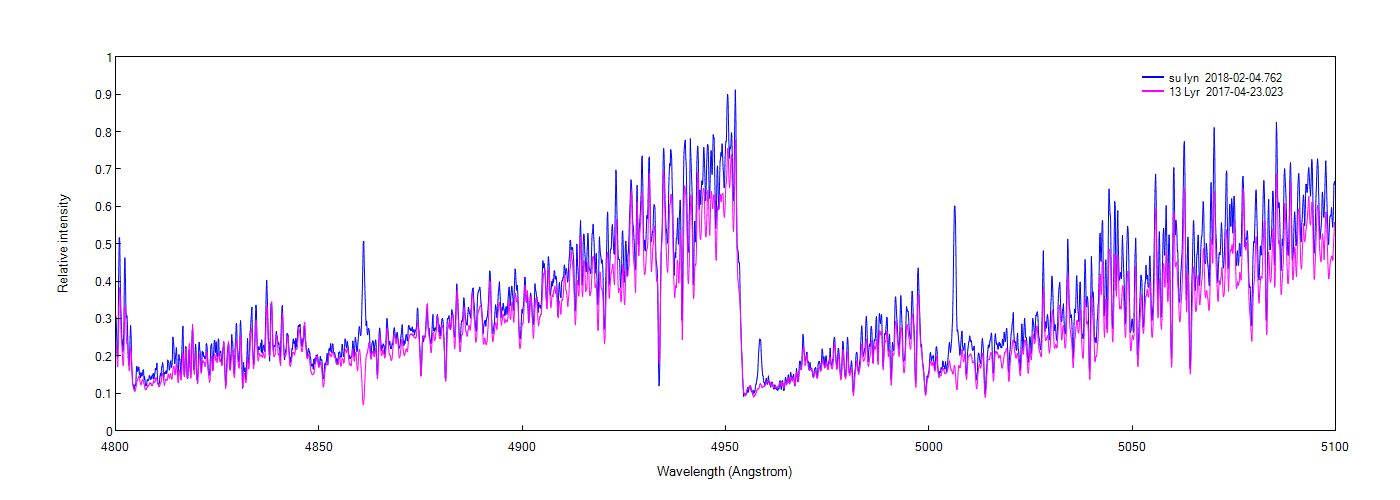

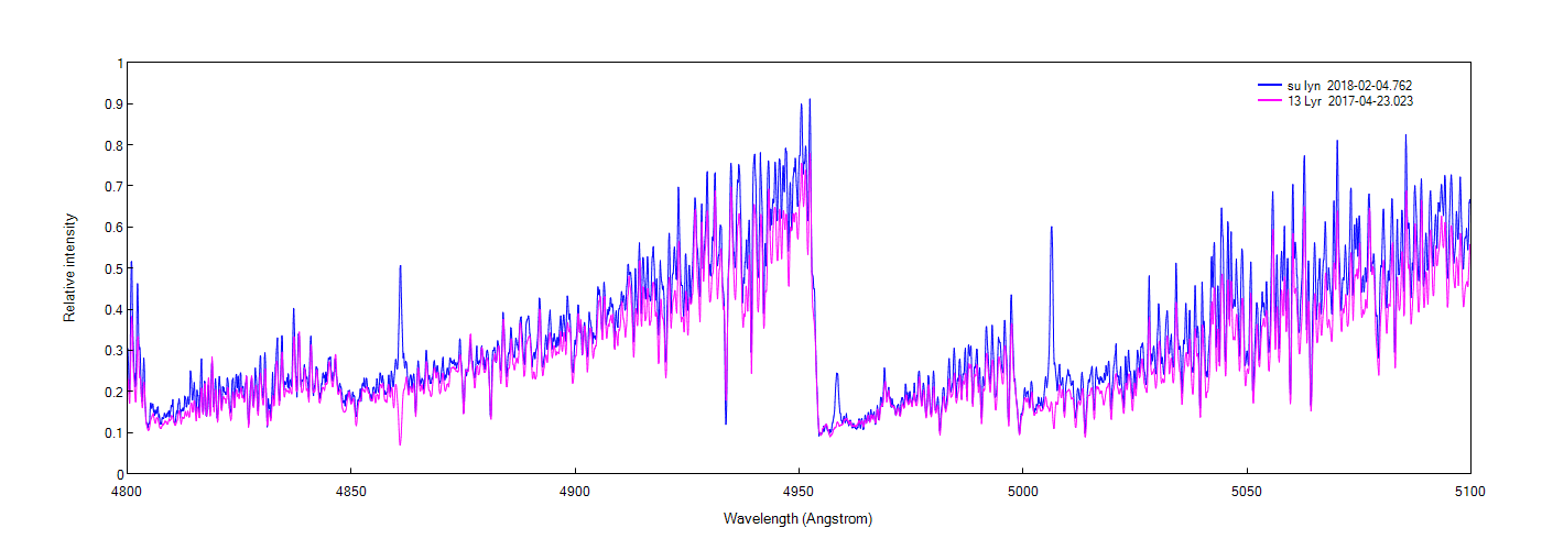

A spectrum of SU Lyn with eshel
H beta - [OIII] range, with a comparison with the M5III 13 Lyr, useful to highlight the emission lines
[OIII] 4959 and 5007 appear clearly

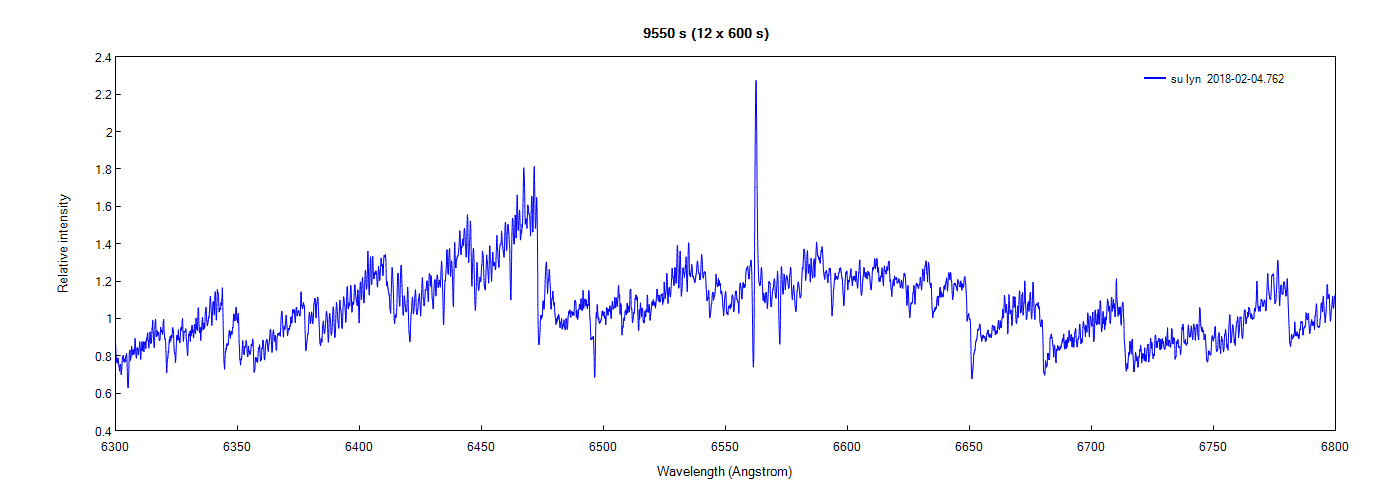

H alpha range
Ha in RV

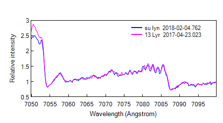

James,
He I 7065 range : no line
For line identification, you have to consider the emission spectrum as a all.
He I 7065 appears with He I 5876 (triplets) and also He I 6678.
No He I in emission in SU Lyn
[Ne III] 3869 makes sense (considering [OIII]). So the line at 3969 could be the other [Ne III] line.
