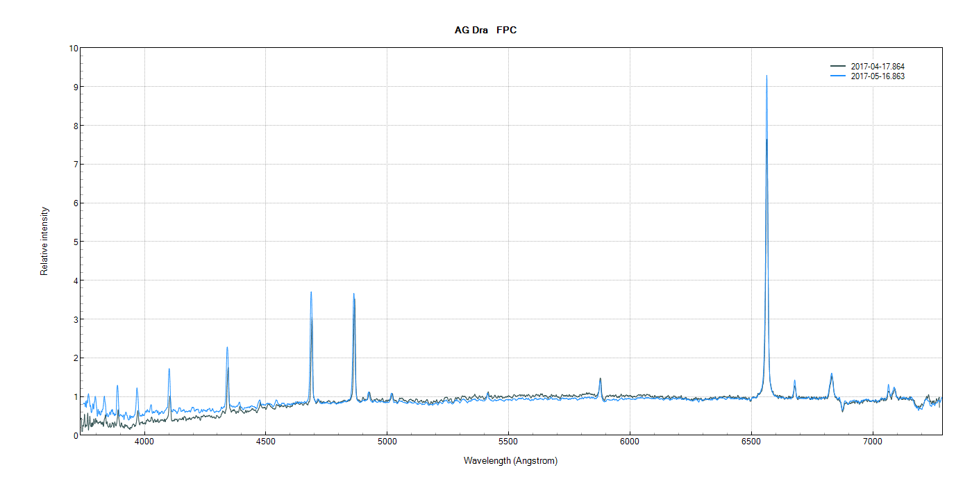

Here's the evolution of AG Dra in one day.
Very strange.... Because now the emissions lines increase.
Francisco Campos
Posts: 88
Post by Francisco Campos »
a comparison of two spectra of AG Dra, one a month ago and the second, from this last night. A lot of changes I see: the blue wavelenghts show a increase of continuum and all emission lines are stronger. Definitively interesting, I will continue the monitoring (hélas, today the sky is cloudy). My only doubt: concentrate observations at low resolution or at medium resolution (R=5000) in 6500-7200 A? :?:

Nice result!
Joan's spectrum obtained the 16th shows an increase of the recombination lines; OVI reamin almost constant
I suggest R 5000 on 6500-7200 range

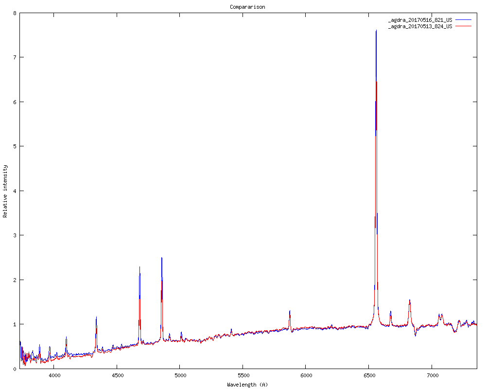

Bonsoir à tous, placez une comparaison entre le jour 13 et 16/05/2017.

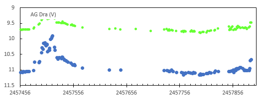

Update of the AAVSO lightcurve
Last edited by Francois Teyssier on Thu May 18, 2017 3:20 pm, edited 1 time in total.

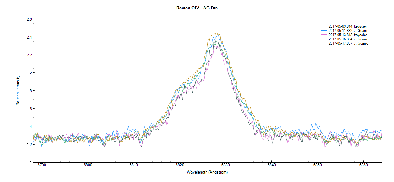

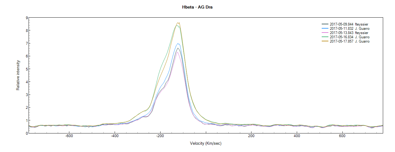

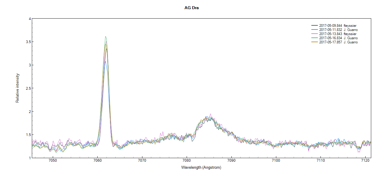

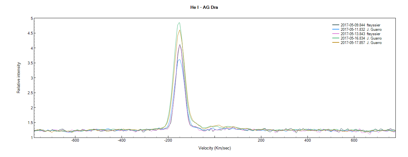

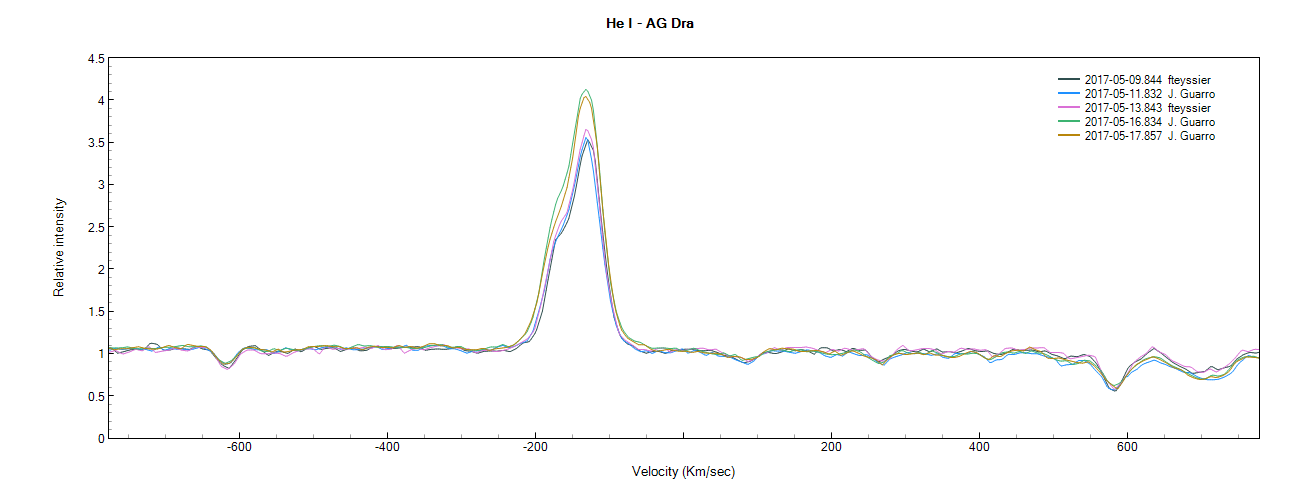

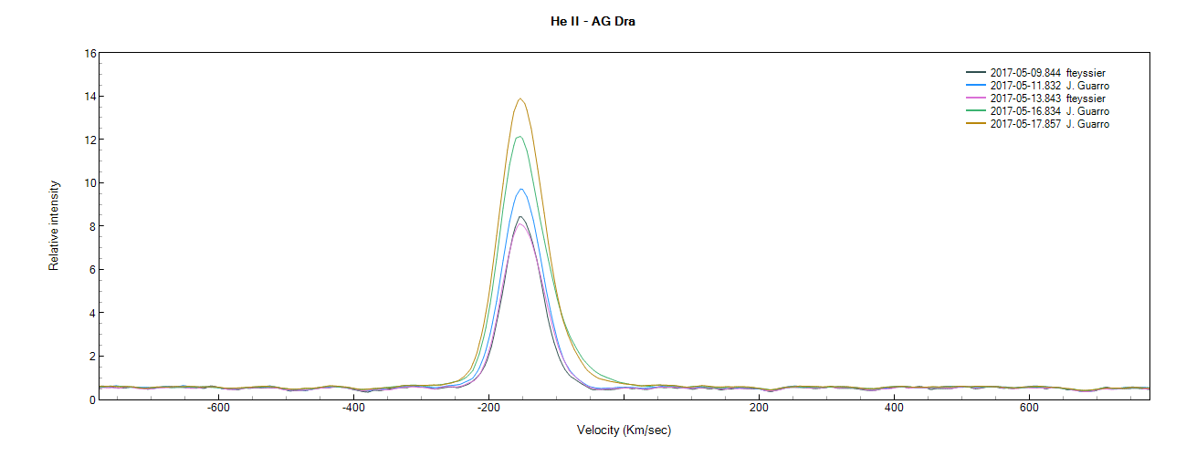

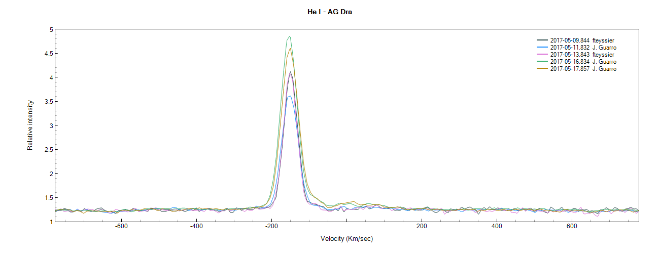

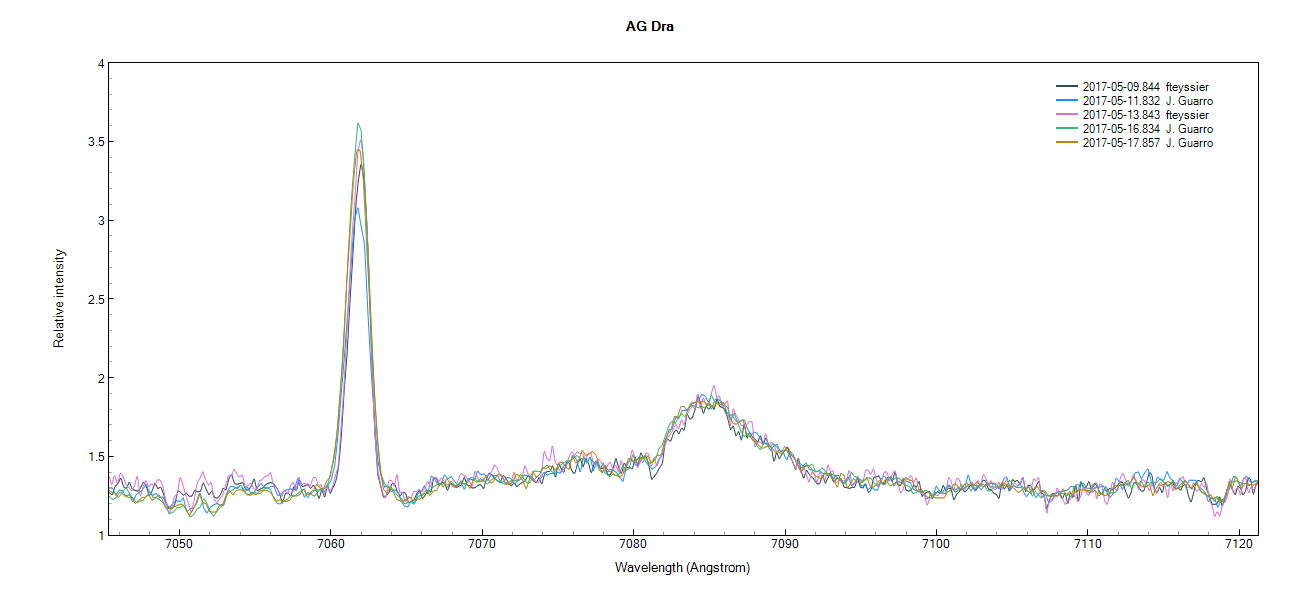

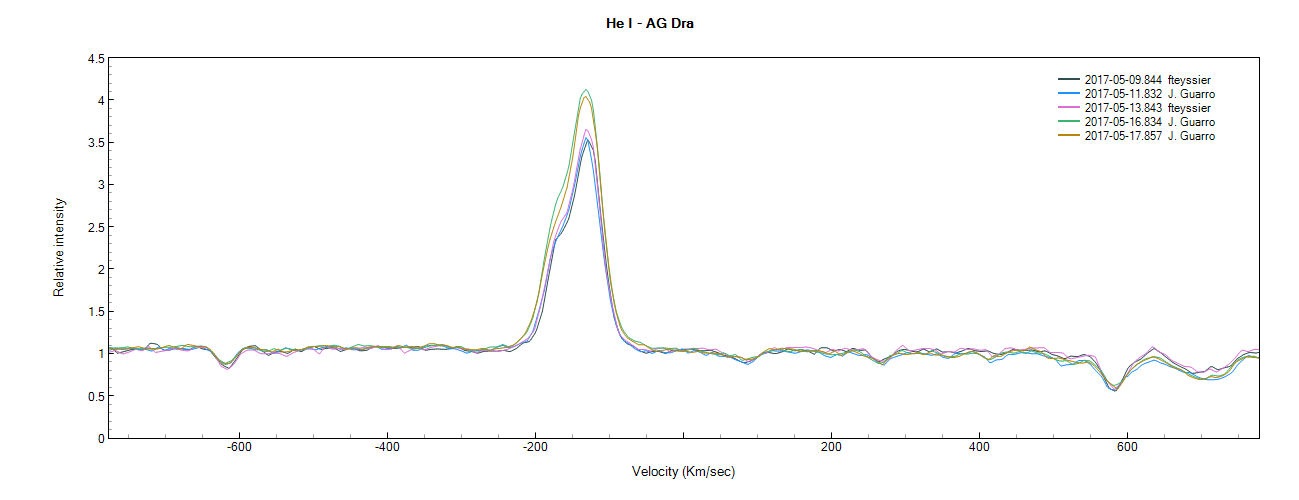

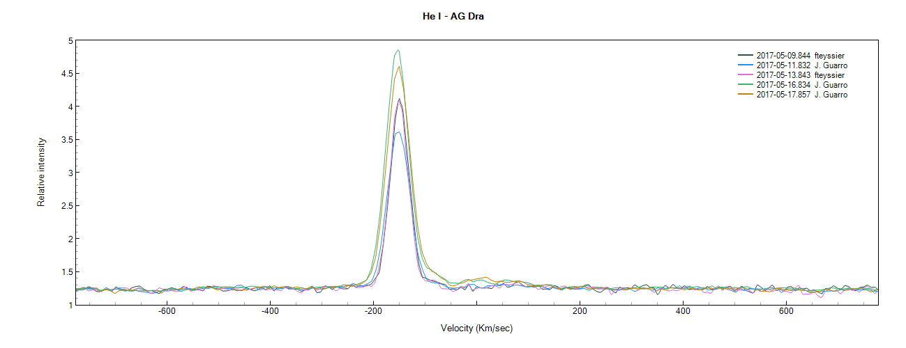

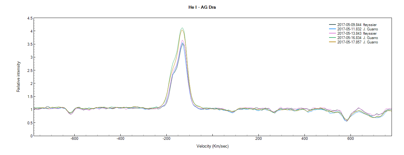

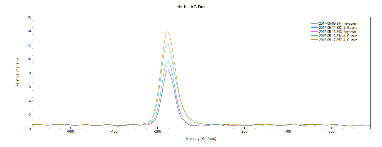

Lines evolution in May
Increase of Recombination lines
He I triplet and singlet
Raman OVI (6830)
Raman OVI 7085

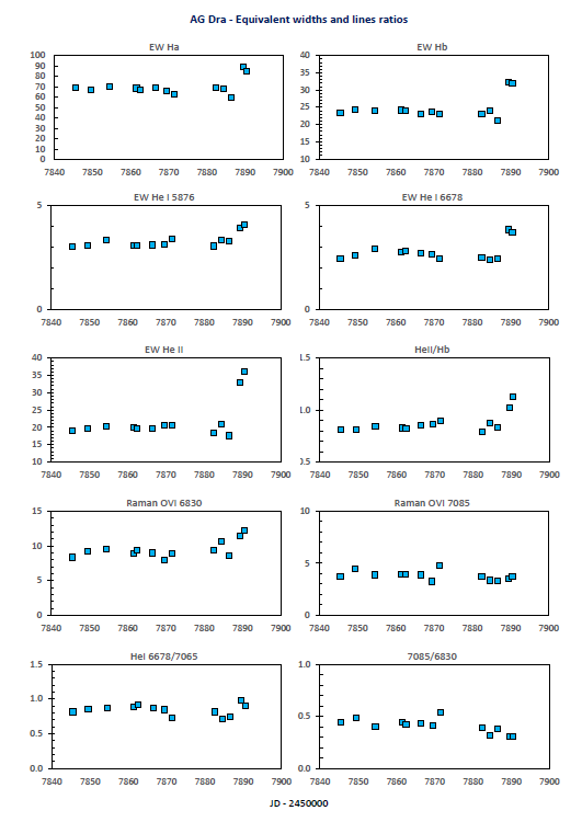

And the EW

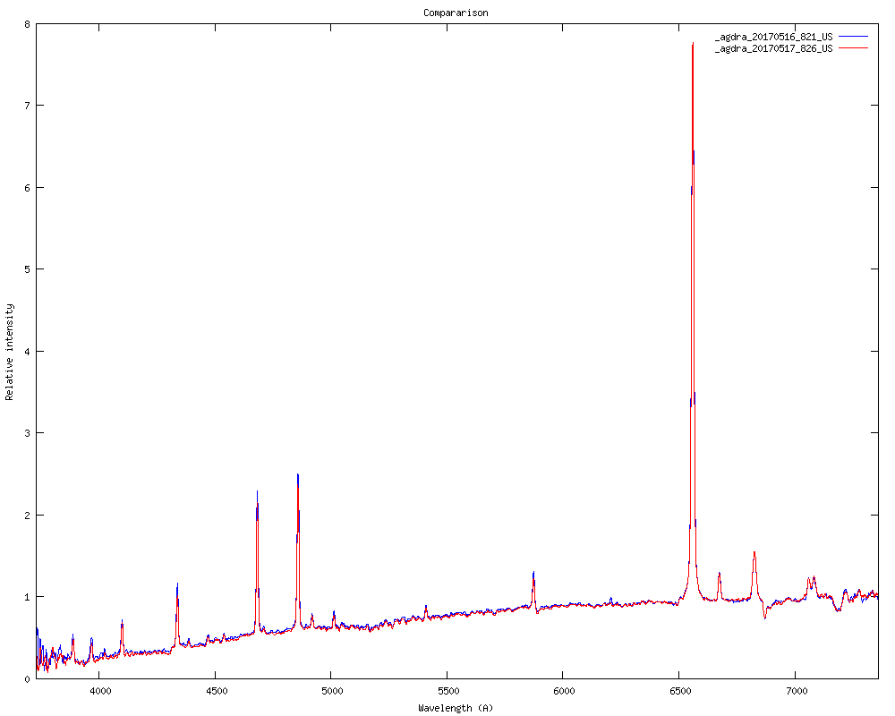

Post by umberto sollecchia »
Bonjour, une nouvelle comparaison entre le 16 et le jour 17/05/2017
