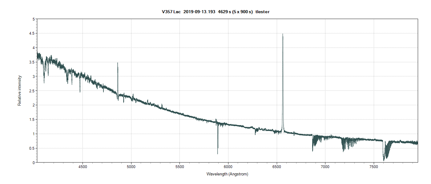

Here is V357 Lac for Sept 13th. R = 14000 and I estimate the S/N to vary between about 80 to 120 over the range.

Hello Tim,
Nice spectrum.
What spectroghraph are you using?
Benji

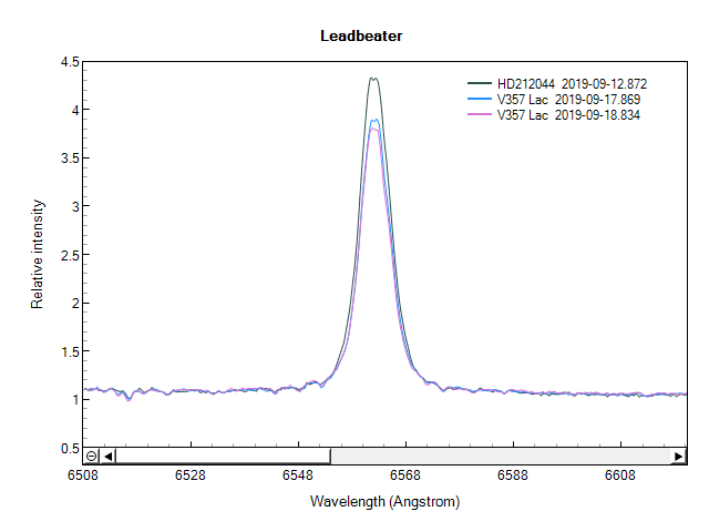

- The rapid decrease in the Halpha intensity relative to the continuum (from ~4.5 to ~3.5) as seen in Olivier's recent plot over just 2 days is dramatic. Perhaps this is a situation where the continuum flux is rapidly increasing, and so the line emission relative to the continuum appears to weaken. From most Be stars I know, it seems difficult for the Halpha emitting material to dissipate so quickly, but there are many cases where the nearby continuum flux can increase very quickly. Hopefully the TESS light curve can help here. This is actually a key aspect to having both spectra and photometry simultaneously- since the Halpha line is within the TESS photometric filter, if the Halpha emission increases it will cause the TESS brightness to increase (even if there is no increase in the continuum flux). On the other hand, if only the continuum flux in TESS increases, it will appear to cause the Halpha intensity (relative to the continuum level) to decrease. So it is essential to have both to properly interpret the variability.
Olivier GARDE wrote: and a comparison with the 2 last spectra in Bess database
Hi Olivier,
The spectrum from 13th is normalised to a different level so the difference from 13th to 14th is probably exaggerated. My measurements (R~5500) do confirm a continuing decrease of approximately 0.8 A EW per day though. (If this trend continues the emission would disappear in approx 25 days)

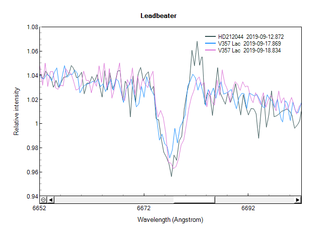

Evolution of the 6678 He line for the same dates. (SNR ~150)
The maximum of red emission wing visible on 12th is shifted by ~200km/s relative to the absorption minimum

Great work with these observation! Very interesting to see the variability in the Helium lines in particular. I've been doing some more reading on the topic, and this is convincingly suggestive of ongoing and inhomogeneous mass ejection from the star (the He emission wings in particular). The other variability in the He line profile (not in the high velocity wings) could be from stellar pulsation distorting the surface of the star and/or some combination of emission/absorption from circumstellar material. Regardless, these lines are excellent tracers of what is happening very close to the star at the shortest timescales. This is exactly what I was hoping to see in this star.
I also read about an alternative hypothesis for the decreasing Halpha peak intensity. At the very beginning of an outburst, possibly something acts to decrease the amount of ionizing UV flux the disk receives (in short, less UV flux --> less line emission). This could be something in the photosphere, or perhaps recently ejected material blocks some UV flux from 'seeing' the rest of the disk. Anyway, I thought that was an interesting idea. The TESS data will tell us a lot about this, since it is sensitive to material in the very inner disk.
