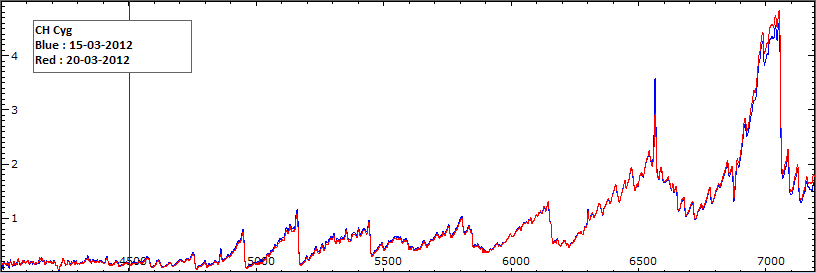

Spectre du 20 mars (bleu) comparé à celui du 15 mars (rouge).
Significatif accroissement de l'intensité des raies de Balmer.
On notera également [OI] 6300
On voit là tout l'intérêt qu'il y a à suivre trés régulièrement cette étoile trés active.

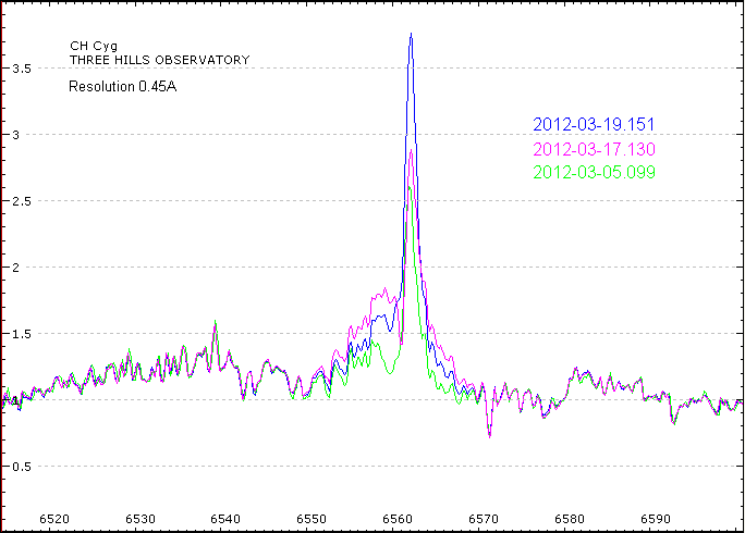

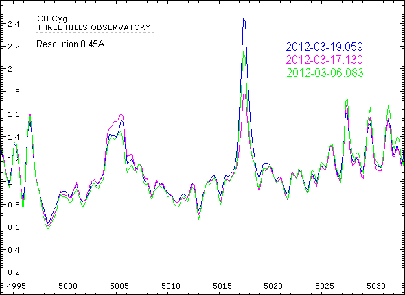

Attached are my latest spectra at H alpha O[III]
The peak intensity at H alpha increased from 17 to 19 March but the wings decreased so the total EW stayed ~constant.

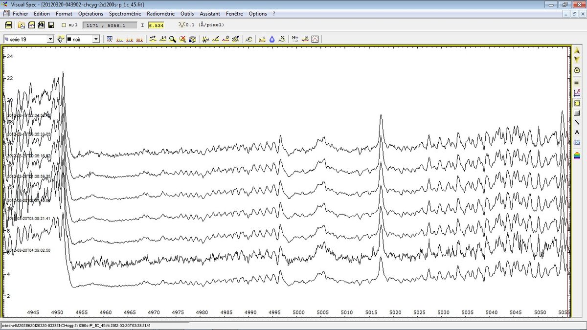

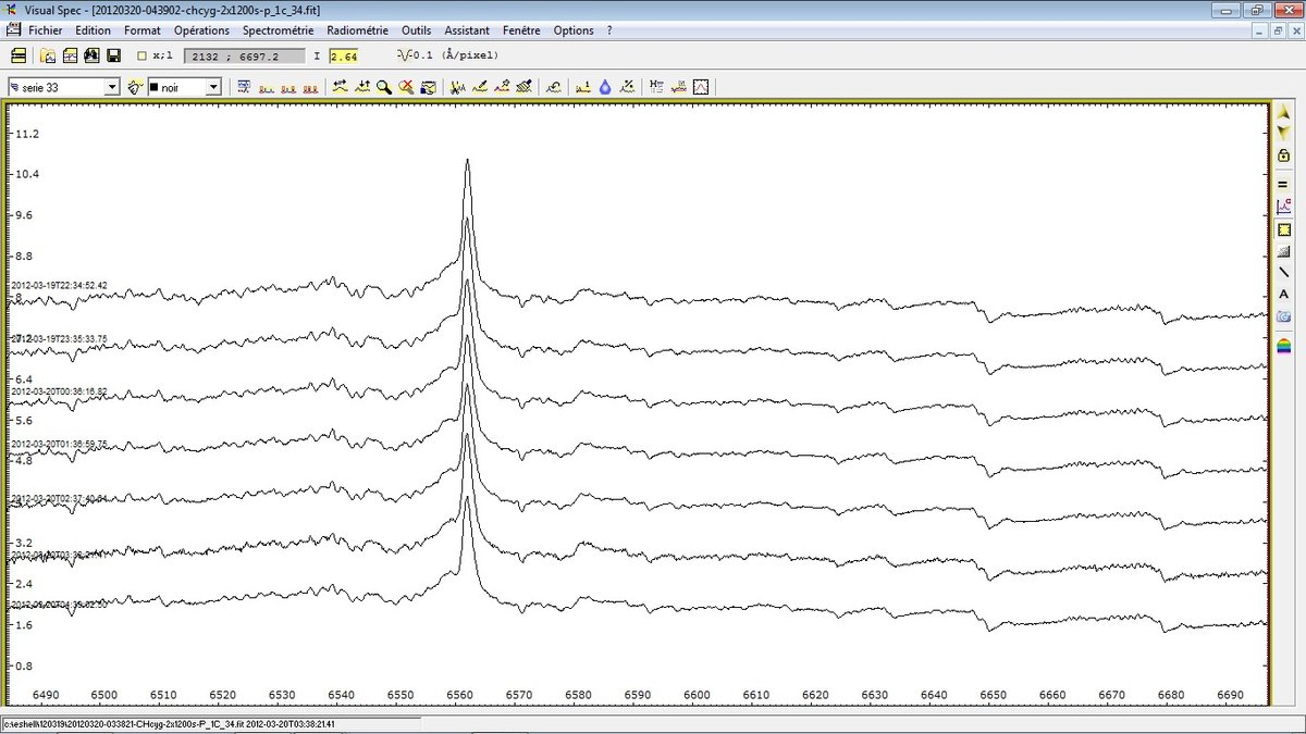

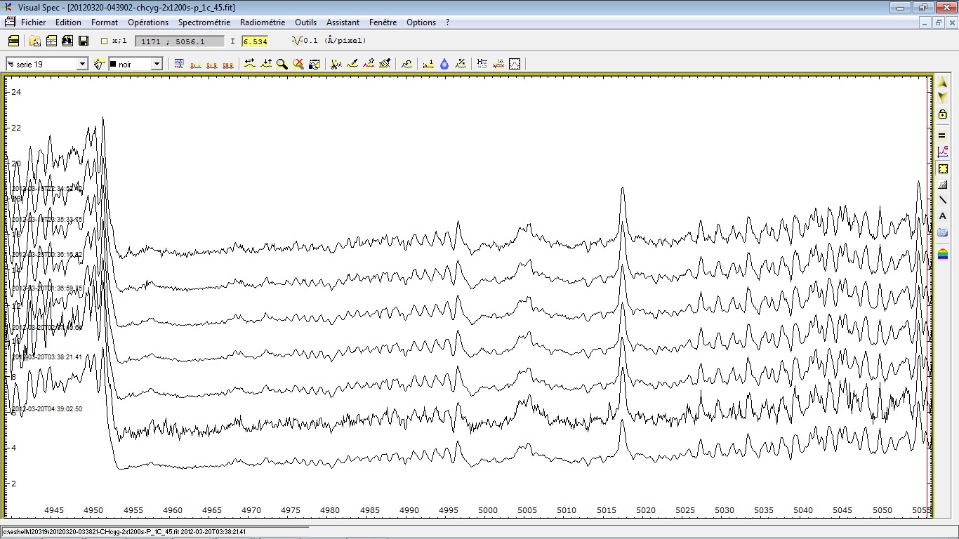

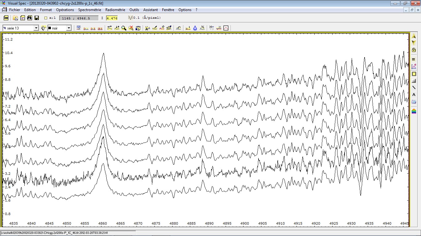

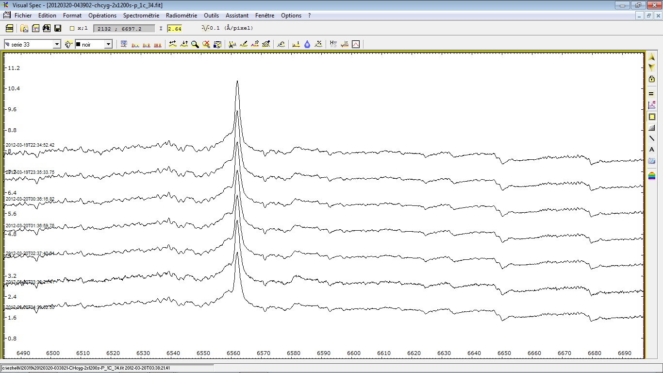

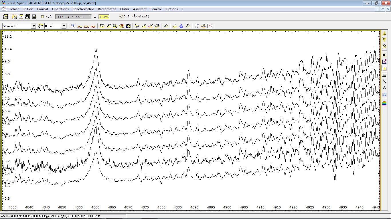

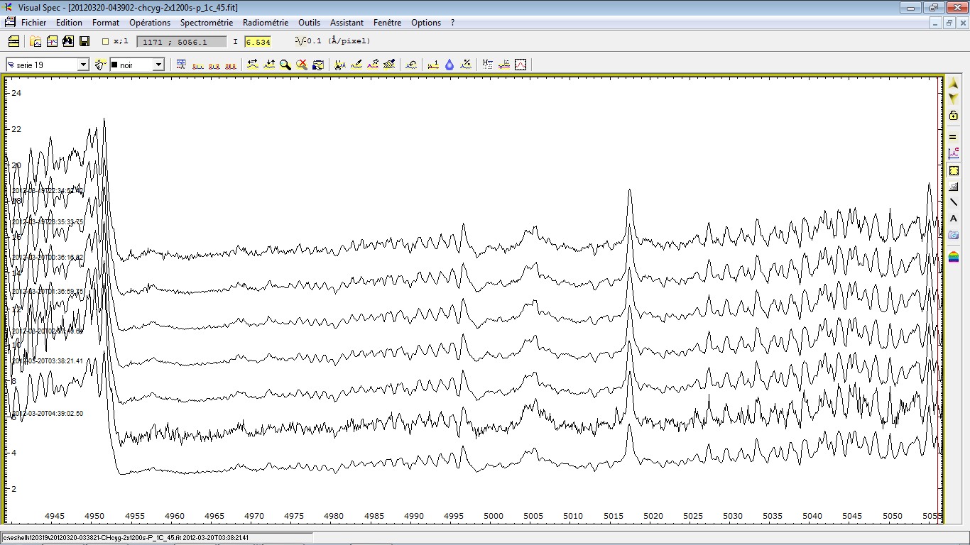

i had an opportunity to a all night session on CH cyg during the 19-20 March. 7H of observations. I had also a spectacular solar spectrum at the end...not includes in the CH cyg series of course.
Ha alpha as seen during the last 40H of observation shows small hourly (time resolution) variations of the blue peak. This is not due to tellurics and must be real. I localized a second sky emission line at 5661A. Both 5551A and 5561 are sensible to the height of the star above the horizon or bad guiding (letting sky background enter the fiber).
No variations seen in H beta and [OIII] during this 7h run.
No [OIII] variability during 7H
No H beta variability during the night
H alpha variation during the night
