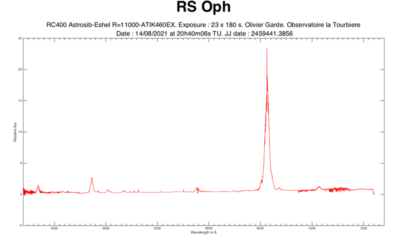

My spectrum of last night and the evolution since the 9th august with 4 spectra

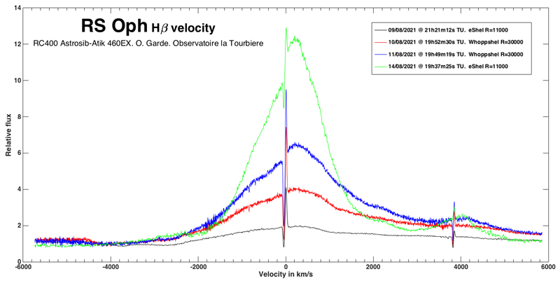

H alpha and H beta velocity evolutions
And the evolution of Iron line at 5753 Å

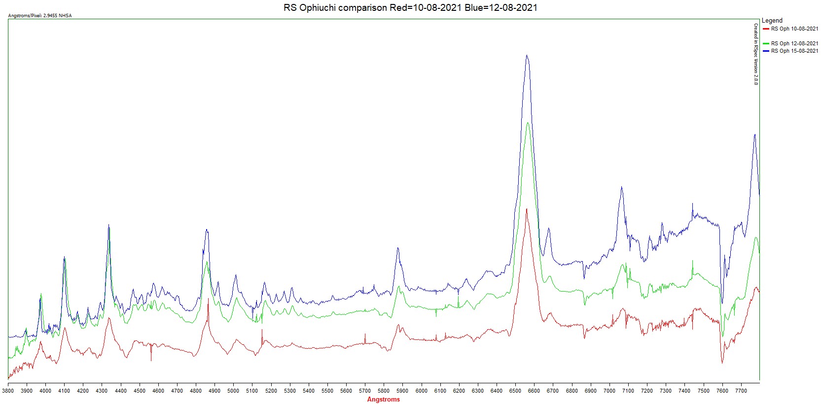

Rainer Ehlert wrote:Hi,
I guess comparing images with different exposure times is not a good idea, or ? August 10 I used 60 seconds and August 12 I used 120 seconds.
Hi Rainer,
Comparing different exposures is not a problem. In fact it is a good idea to increase the total exposure time as it fades so the SNR is maintained. Just scale them to 1 at the same wavelength. Or even calibrate them in absolute flux, for example using V magnitude values so you can compare the line strengths directly, as described in the document "A method of calibrating spectra in absolute flux using V magnitudes" by David Boyd on the BAA spectroscopy resources page
https://britastro.org/node/19378
Posts: 1565
Olivier,
Je ne pense pas que la raie soit [Fe II] 5753.
C'est [NII] 5755 (FWHM = 47 km/s) - pas de composant large comme pour beaucoup d'autres raies: HI, He I, Fe II - et qui se forme dans la nébuleuse symbiotique formée par le vent stellaire de la géante rouge et qui existe avant l'explosion nova.

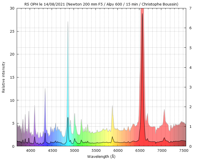

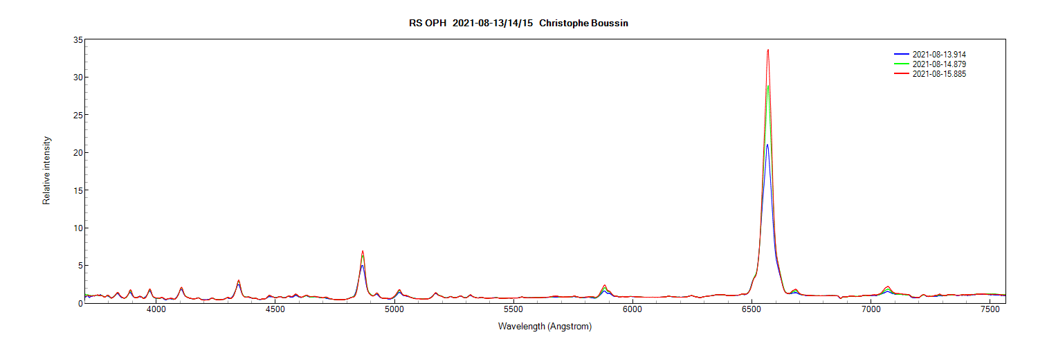

Here is my new update for the monitoring of the outburst of RS Oph with two new spectra obtained with my Alpy 600.
The first one, the 14th of August at 21 h 06 TU (resolution of 521, JJ = 2459441.3793) and an acquisition time of 15 min s (60 x 15 s) :
RS Oph on August 14th, 2021
_rsoph_20210814_879_Christophe Boussin_3700_7565.png (66.63 KiB) Viewed 11187 times
The second one, the 15th of August at 21 h 15 TU (resolution of 535, JJ = 2459442.3853) and an acquisition time of 7 min s (14 x 30 s) :
RS Oph on August 15th, 2021
_rsoph_20210815_885_Christophe Boussin_3700_7565.png (67.19 KiB) Viewed 11187 times
The relative intensities of the Balmer lines have increased significantly as well as those of HeI :
RS Oph on August 13th, 14th and 15th 2021
Overall, the relative intensities of the FeII lines seem to have changed very little.

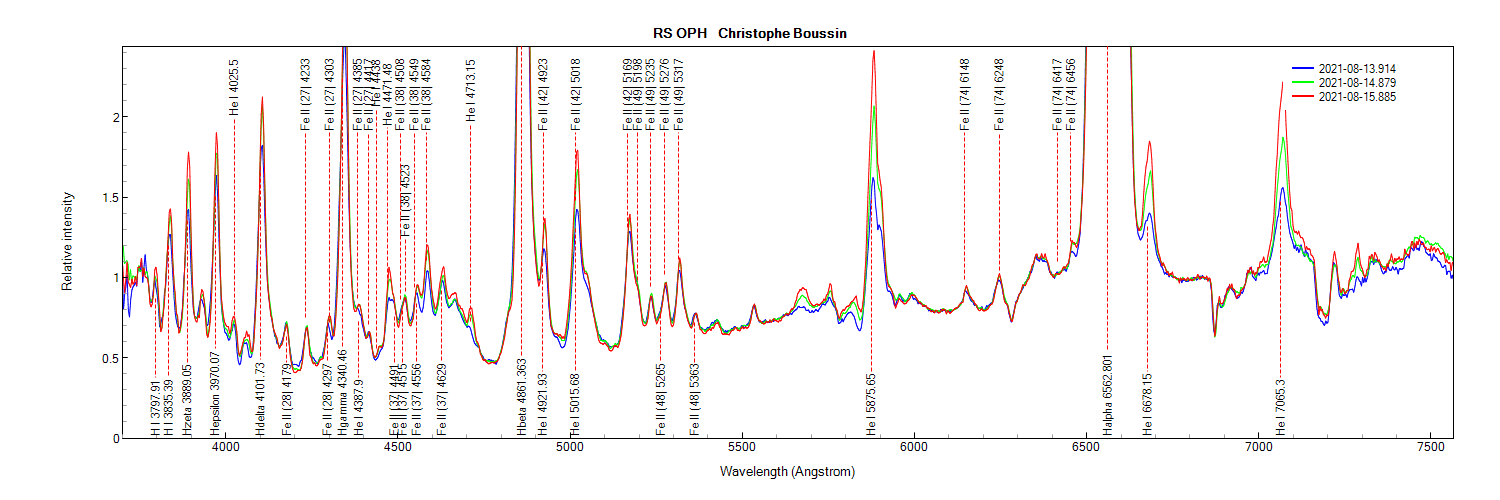

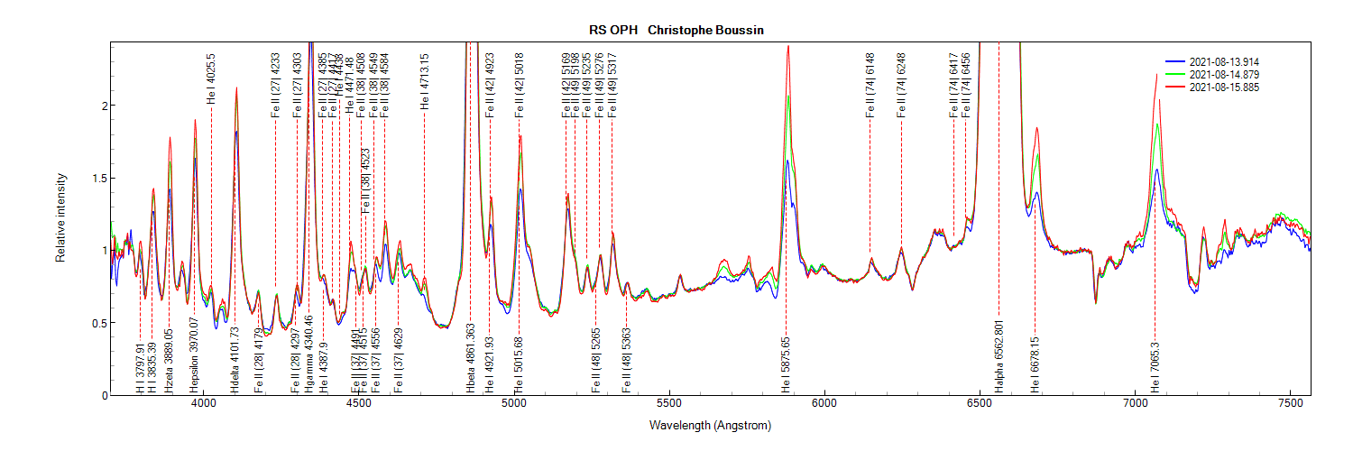

The larger increase in the relative intensity of some FeII lines seems to be due to the presence of HeI lines blended with them (e.g. at 4923 and 5018 A) :
RS Oph on August 13th, 14th and 15th 2021 (identification of some lines from PlotSpectra)
Clear skies to all !!

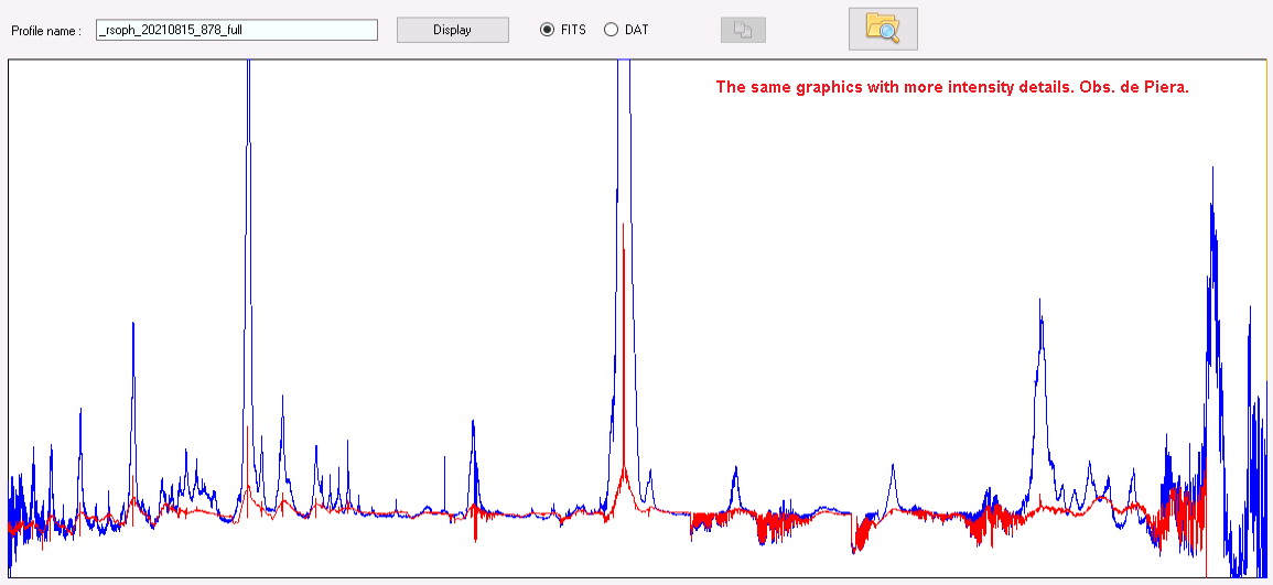

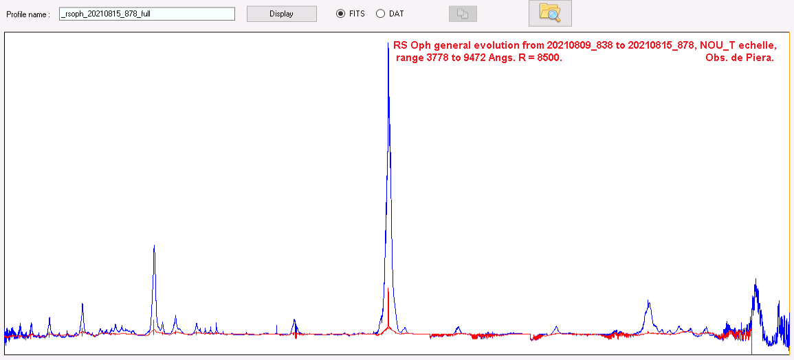

Yesterday I was able to shot another series of RS Oph. Below the comparison of August 10, 12 and 15.
Posts: 722
Post by Joan Guarro Flo »
You can see here more evolution details.
J.G.

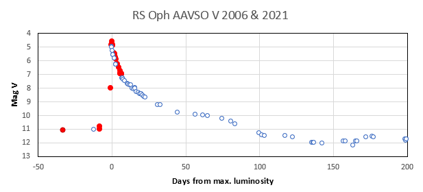

Tout se passe comme prévu
Comparaison des courbes de luminosité des outbursts de 2008 et 2021:
