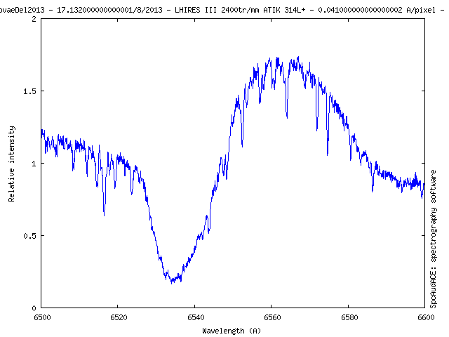

Bonjour a tous,
Que faire avec un 2400tr/mm au LHIRES III... J'ai suivi Ha toute la soirée mais pas beaucoup d'évolution. Doit on se concentrer sur d'autre longueurs d'onde Fe II He I ou Na I comme francois le préconise? Quelle stratégie adopter? D'autre LHIRES 2400 sont ils sur les rangs... dans ce cas il faudrait se coordonner.
Faut-il prendre un spectre de référence d'une étoile A0V pour mon cas? ou une simple réponse instrumentale utilisée pour BESS suffit?
Stéphane

- novaedel2013_20130816_936.gif (200.39 KiB) Viewed 95019 times

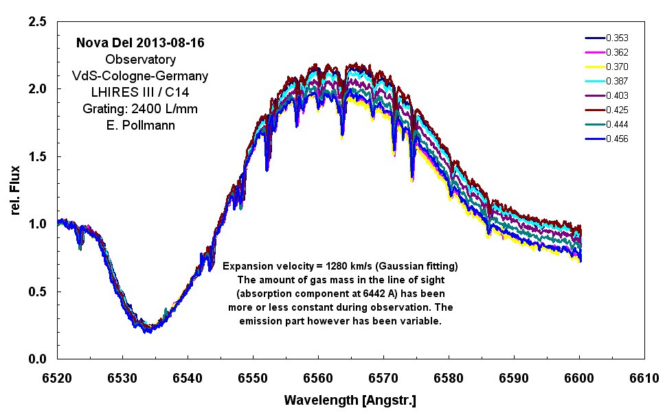

Here my spectra of the nova, taken last night with LHIRES III, grating 2400 L/mm and C14 SC.
Each spectrum in the plot = sum spectrum of three individual spectra.
Exposure time for an individual spectrum = 240 sec.

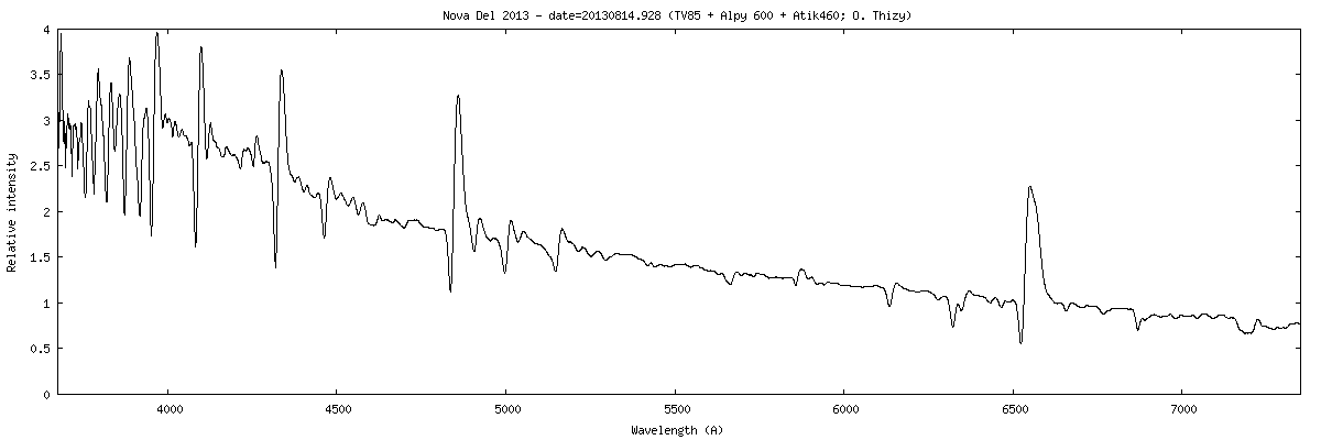

- Posts: 370
Paolo,
the spectrum changed drastically compared to last night. Absorption in P Cygni profiles is less pronounced in the blue region and as you mentionned there are lot of absorption lines... we are seeing this object changing over time "live" - incredible!

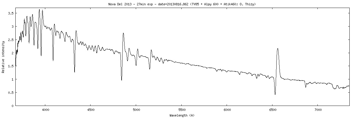

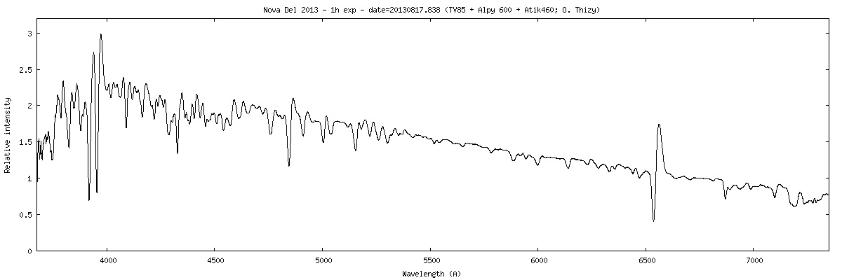

Here is my first serie of tonight: Compared to last night serie:
An animation of four night's spectra (clic to enlarge):

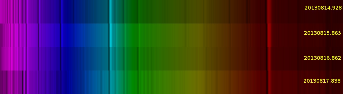

I have assembled 4 spectra (one for each night) in a colored 2D spectrogram which shows the evolution overall:
I hope lot of people are observing in higher resolution... and hopefully also continue to observe in the US and Australia for exemple... we need time coverage on this nova...

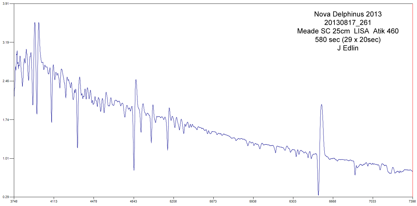

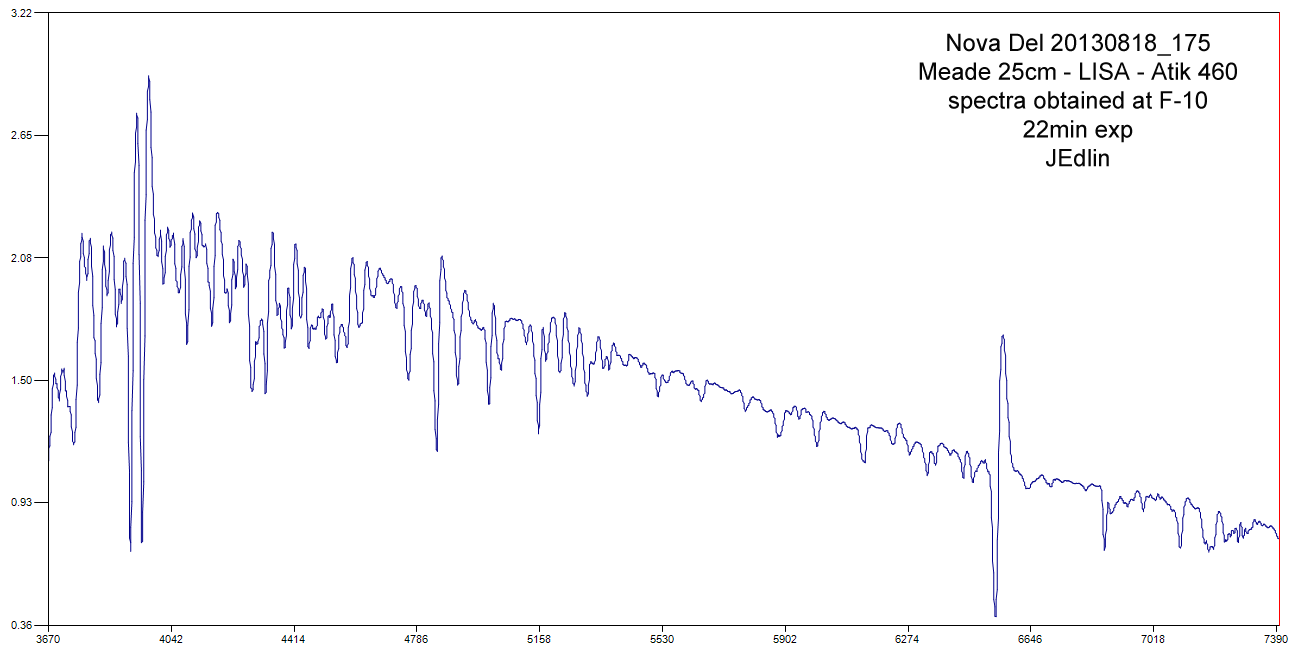

My latest spectra from Aug 17, 2013 with 25cm telescope - LISA - Atik 460ccd. The spectrum has changed significantly over the past several days.
Jim
Jim

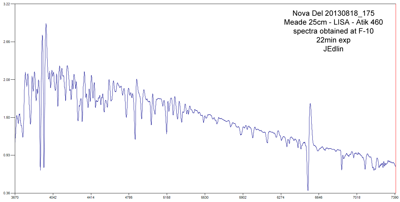

James Edlin
- Posts: 13
- Joined: Mon Oct 10, 2011 3:22 am

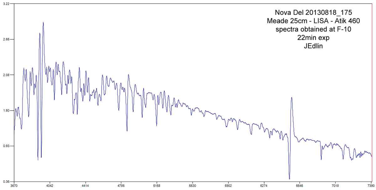

Observed the nova tonight using F-10 focal length of Meade 10 inch telescope. This dramatically sharpens the line detail shortward of 4000 angstroms. Only bad part is it takes 3x more exposure. My spectra from tonight also shows dramatic changes to the blue part of spectrum.
