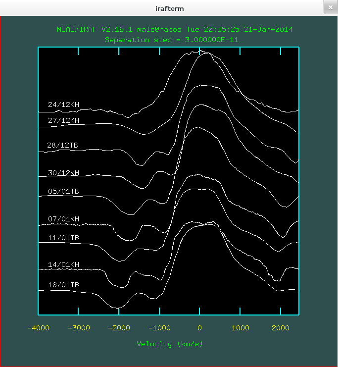

Attached is a plot of the evolution of the absorption systems in the Hydrogen beta line. Velocity zero point has been set to 4861 Angstrom for all plots. Data is taken from the ARAS database from spectra provided by Ken Harrison and Terry Bohlsen.
There is a clear progression upwards in velocity over the 25 days covered, with the main absorption feature centre moving from around -1500 km/s to around -2100 km/s, and the secondary feature moving from around -750 km/s to around -1200 km/s. The main feature now extends to a maximum negative velocity of around -2500 km/s.
The absorption visible on the red wing of the Hb line in the latter spectra is the high velocity feature from FeII 4923 and has a similar velocity to the Hb feature.
Thanks as always to Ken and Terry for the data.

Great graph Malcolm.
I will have to learn to use IRAF.

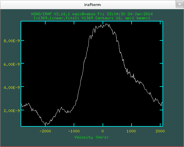

The evolution of the expansion velocity based on our H-Alpha profiles follows the same trend already indicated by Malcolm and based on H-beta. Since January 03 and up to Jan 21, we have estimated an increase in expansion speed from about -1800 km/s to some -2100 km/s. We would also appreciate to hear from our more experienced fellows about what is actually going on here…
Tasso.

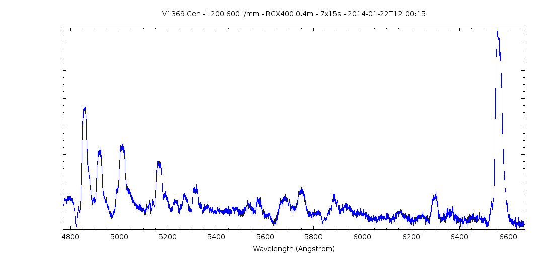

Spectrum from 22nd Jan attached. My first effort with a slit spectrograph, so a little bit shabby I'm afraid. Still there is some useful data hiding in there.
16" Meade RCX400, L200 600 l/mm, Canon 550d camera, unguided. Focus is a little soft in the red end so the Ha line has lost some of its intensity.
The velocity profile is from Hb.

Congratulations Malcom
This is excellent as a fisrt sepctrum
Just a little bit noisy in the continuum (how many images did you stack to get this result ?
Of course, I"m wating for the fit file for the data base
Bonne continuation

I'm working on it François, should be with you shortly ;)
7 x 15 second exposures. Lack of guiding is a severe issue, doesn't take long for the star to drift off the slit. I will work on this.

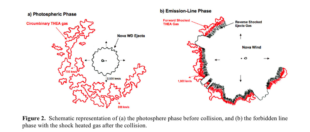

There seem to be two explanations - or two possible causes - as to why we see an increasingly blue-shifted set of absorption lines in this phase of nova evolution. One (the simpler to understand, at least by me!) is advocated by Bob Williams (see Williams and Mason, 2009, Nova ejecta as colliding shells, http://arxiv.org/ftp/arxiv/papers/0908/0908.3810.pdf):
"[We see] multiple absorption systems having different radial velocities in the spectra of a large majority of novae and interpreted the observations in terms of discrete clouds of gas that are progressively accelerated outward. The innermost ejecta, having the higher velocities, correspond to the surface layers of the white dwarf (WD) that have undergone nuclear reactions. The outermost ejecta are circumbinary gas having lower velocities, and their presence at maximum light surrounding the primary WD ejecta strongly suggests that the outer circumbinary transient heavy element absorbing (THEA) gas has existed before the TNR." (Williams and Mason, 2009 p.1)
Basically he argues that previous outflow from both the WD and in particular the secondary star creates a circumbinary gas envelope moving outwards from the pair at relatively low velocities. This is successively energised (ionised, heated, and collided with) by the initial nova outburst hence is the first set of absorption (and emission) lines we see. Later, as the fireball become less optically thick, we see faster moving lines from the actual ejecta themselves. The attached diagram is from p.7 of that article.
One of the problems with this theory seems to be that the energy required to push this much material out into the circumbinary envelope is substantial, and we see little evidence of this sort of emission from the system prior to the nova outburst. But it seems true to say that the recent literature seems to be dominated by discussion of the evidence for and against some sort of steady-flow stellar wind (as opposed to a ballistic expansion) as a contributor to novae spectral evolution.

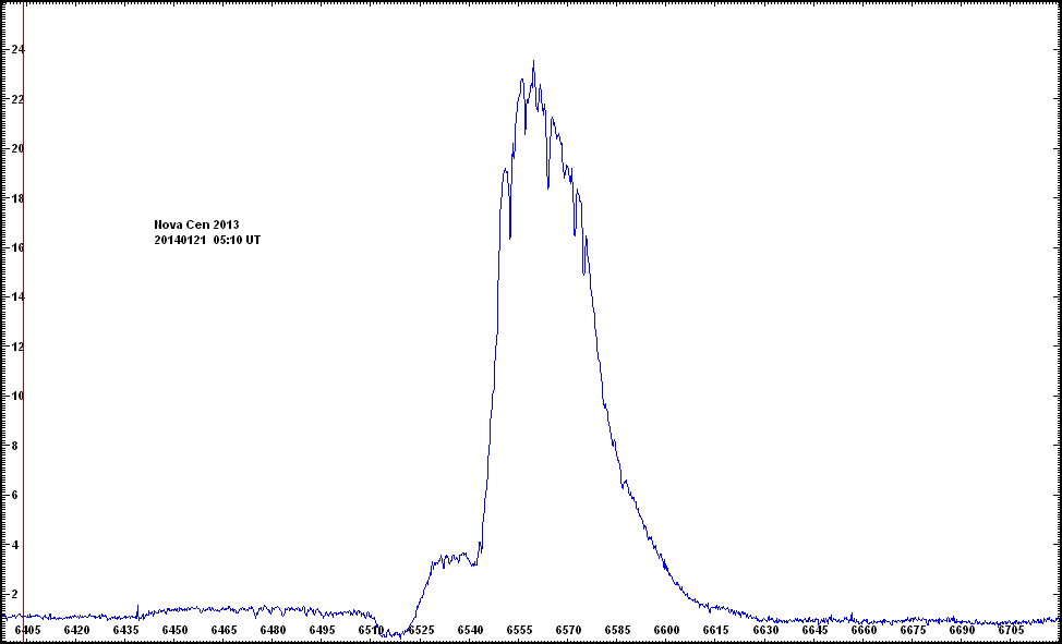

Spectra from last night. The P Cyg profiles are mostly gone. It has brightened in Ha in absolute flux but has reduced otherwise.
Can someone tell me how I make gnuplot change the Y axis so that it displays scientific notation rather than lots of zeros.
ie 1 E-10 rather than 0.0000000001
I'm using the std2.gnu file in ISIS.
Terry
