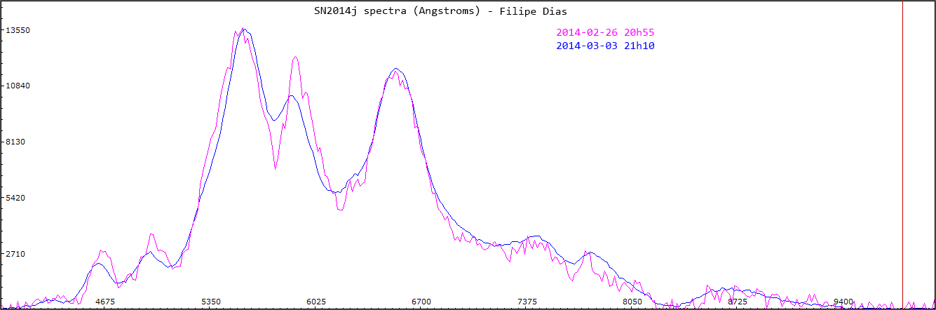

I have these two observations taken with SA100.. These are the two first spectra I ever took with SA100.. So I expect them to be wrong in some aspect... How "wrong" do they look?
They represent SN2014j, subtracted by the just-above&below sky background that includes M82 spectrum.
No attention to instrumental response. Callibration using 0-order + O2 absorption (on the second bright star from M82 - TYC 4383-1099-1)
Pink: 20140226 20:55UT SA100, Atik314L+, 8,3" Newt F/3.9, 22 x 3min, disp 12,57 ang/pix
Blue: 20140303 21:10UT SA100, Atik314L+, 11" Cass F/6.7, 26 x 3min, disp 15,96 ang/pix
Pink - Subtracted the sky in Iris before subtracting again (M82 spectrum) in Vspec, so this is likely a cause for the noisy spectrum.
Fil

Hi Fil,
That looks like a great start for your first Star Analyser spectrum (but of course you are not a beginner in spectroscopy :-) ) It is indeed very easy to add extra noise when doing the background subtraction. The key is to use as wide a region as possible to give a good average but still make the background representative, something which is difficult to do in this case of course.
The usual way to wavelength calibrate is to use the Balmer lines in reference A star which gives better defined lines and allows a non linear calibration. This star can also be used for instrument response correction. I normally start a Star Analyser observing session with the reference star and use it to adjust the focus before moving on the fainter targets.
Another question. did you guide your exposures or can you take 3min exposures unguided?

Hi Robin,
They are unguided, yes.. the star was drifting about 1 stellar diameter (3.6") per 3 or 4 images (~10 min).. But I did spend around 45 min drift-aligning the mount (not in an observatory yet). Having this light drift causes hotpixels to fall out of place in consecutive images, but they were all cleaned-out with the dark! (hotpixels in registered images are a nice way to measure drift, by the way)
The stars, however, are longer in roughly the N-S direction.. I suspect there is backlash/play in DEC, and some tiny wobble in that direction (light wind), or most likely wobble in the up-down direction of the entire mount due to my "tripod adapter" made of wood that was bent by humidity/moisture providing precarious attachment..
The mount used for the images is a very pleasing Takahashi NJP :) Its periodic error is not easy to notice at the declination of M82 (+70º), and far less in 3 min exposures... But it is not advisable to push much longer than this unguided...
But the star with the C11 + reducer is a bit largish.. Maybe I placed the camera too far away from the reducer... The SA100 might have been too close to the camera, so all that may have smoothed my spectrum.. The dispersion direction is also very close to the N-S wobble and so the star is longer in that direction as well.. So all that is conspiring against the resolution of the spectrum :(
Fil
