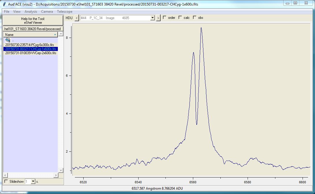

Here is my last spectrum from tonight.
Unfortunately I don't have enough time span to monitor profile changes through the night.

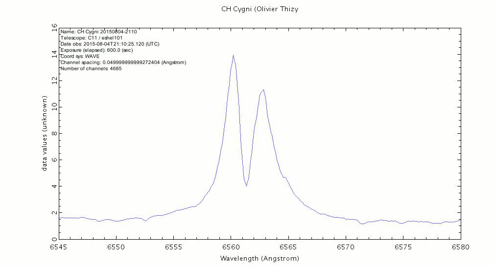

Post by Olivier Thizy »
a single shot tonight as I didn't want to return the mount and reached the limits. But it shows some changes from your spectrum:
CH Cygni preview.JPG (83.42 KiB) Viewed 27967 times

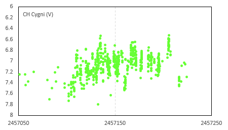

AAVSO Light Curve
General trend : decreasing since the beginning of June

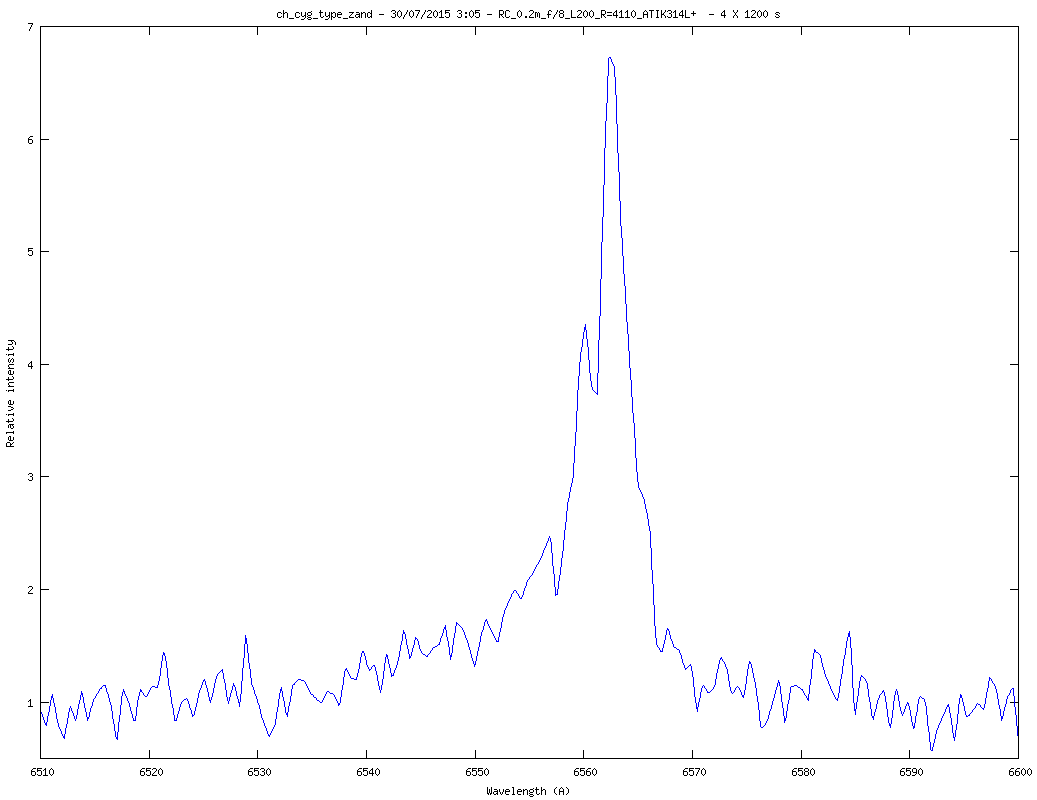

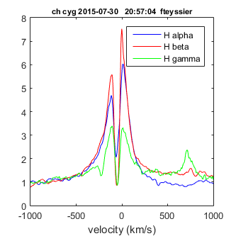

Results from 29th and 30th of july :

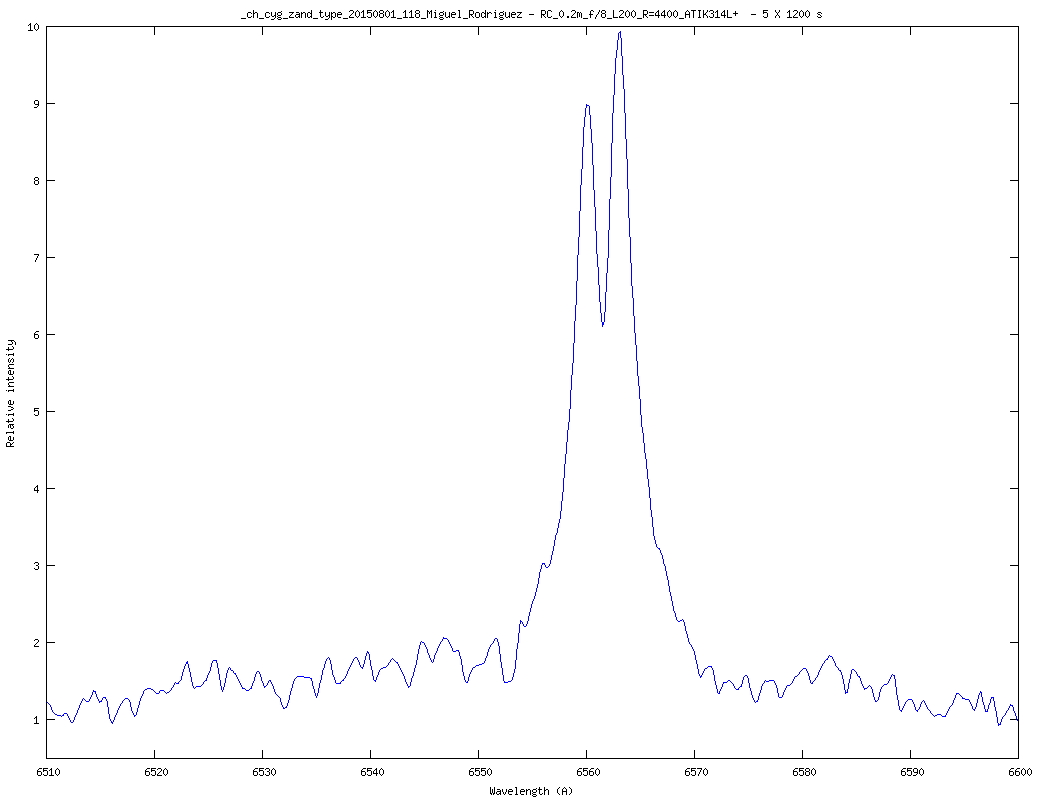

Re: Dramatic change of H alpha profile
Post by Miguel Rodriguez »

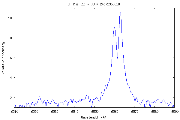

Spectrum from two hours observation.
_ch_cyg_zand_type_20150801_118_Miguel_Rodriguez_6510_6600

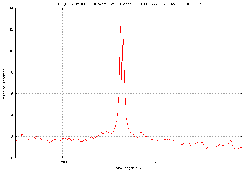

Hi to all.
Here is our animation of CH Cygni H alpha line rocorded at the night of 02 Aug 2015 over 2 hours.
Instumentation: Meade SC 10"f/10 + Lhires III 1200 l/mm + CCD SBIG ST10XME
Time of single exposition: 600 min
CH Cyg - 02/08/2015 - Associazione Astrofili Fiorentini
Clear sky
Nico Montigiani
Massimiliano Mannucci
Lapo Ferrini
Associazione Astrofili Fiorentini A.A.F., Florence, Italy (mpc code 632)

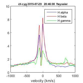

A time serie spectra taken just after Olivier Thizy sequence.
3H30 long : A total of 71 spectra of 180s each with eshal spectrograph.
I have also the same animation for H beta and H gamma

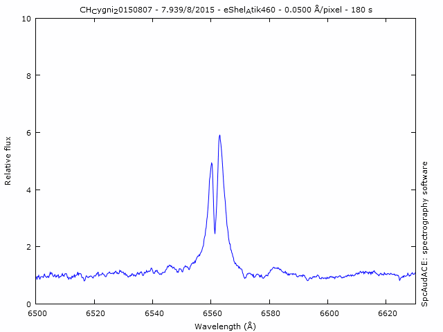

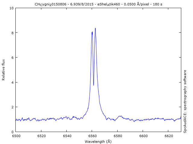

Here is an animation of the night of august 6th and one from last night (data reduction in ISIS, animation in SpecAudace with 'norma' option):
Equipment: C11 + eShel
