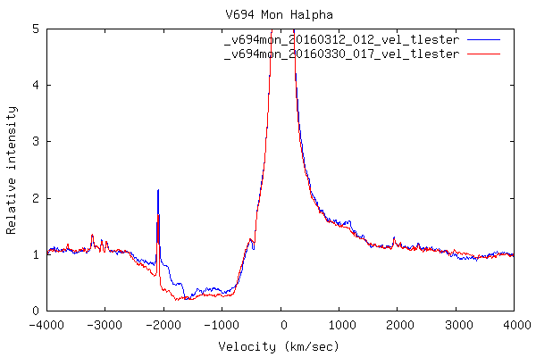

V694 Mon for Mar 30th.
Halpha velocity plot compared to my last result on Mar 12th.
Maximum velocity now ~2700 km/sec.

H-alpha radial velocity plot comparisons.
11 and 18 march:
18 and 30 march:
Recently the absorption component has become more "flat-bottomed" (also visible in the 30.017 march observation by Tim).
Jim, welcome aboard! Very nice spectra, congratulations! You can appreciate how the low-res profile of this very interesting star changes, looking at the great animation by Peter (previous page).
11 and 18 march:
18 and 30 march:

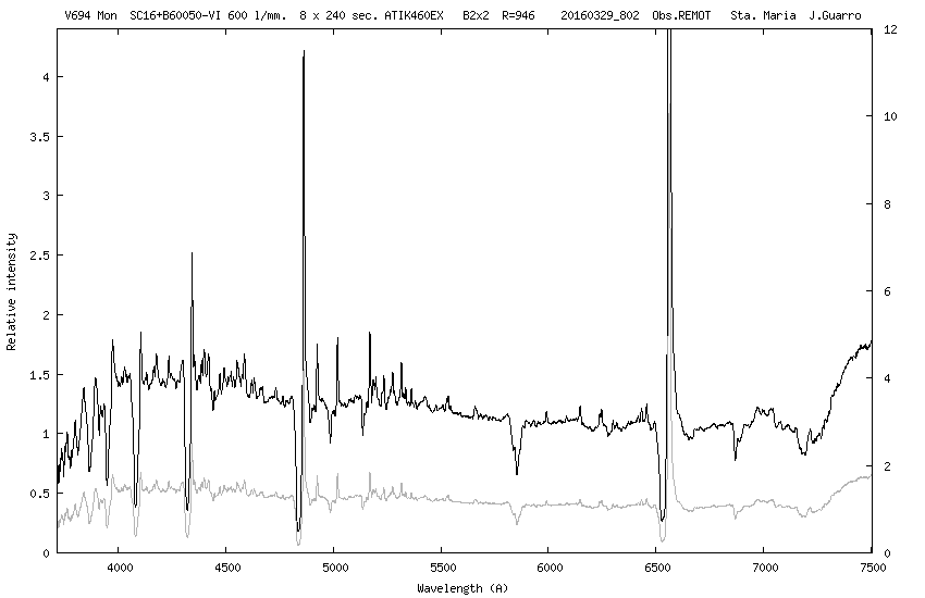

I leave here a low-resolution graphics.
Joan
Congratulations to all for the results of the star V694 Mon.
Joan

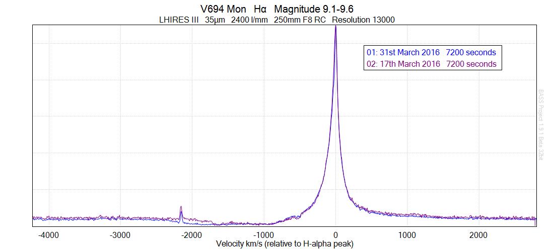

I've been following V694 Mon at high resolution (about 13000) during March. I did not notice much change in my spectra from early March, but I did notice the change seen by others when I obtained a spectrum on 31st March. A deepening of the H-alpha absorption at shorter wavelength / higher velocities. Here is a comparison of my spectra from 17th and 31st March.
Andy

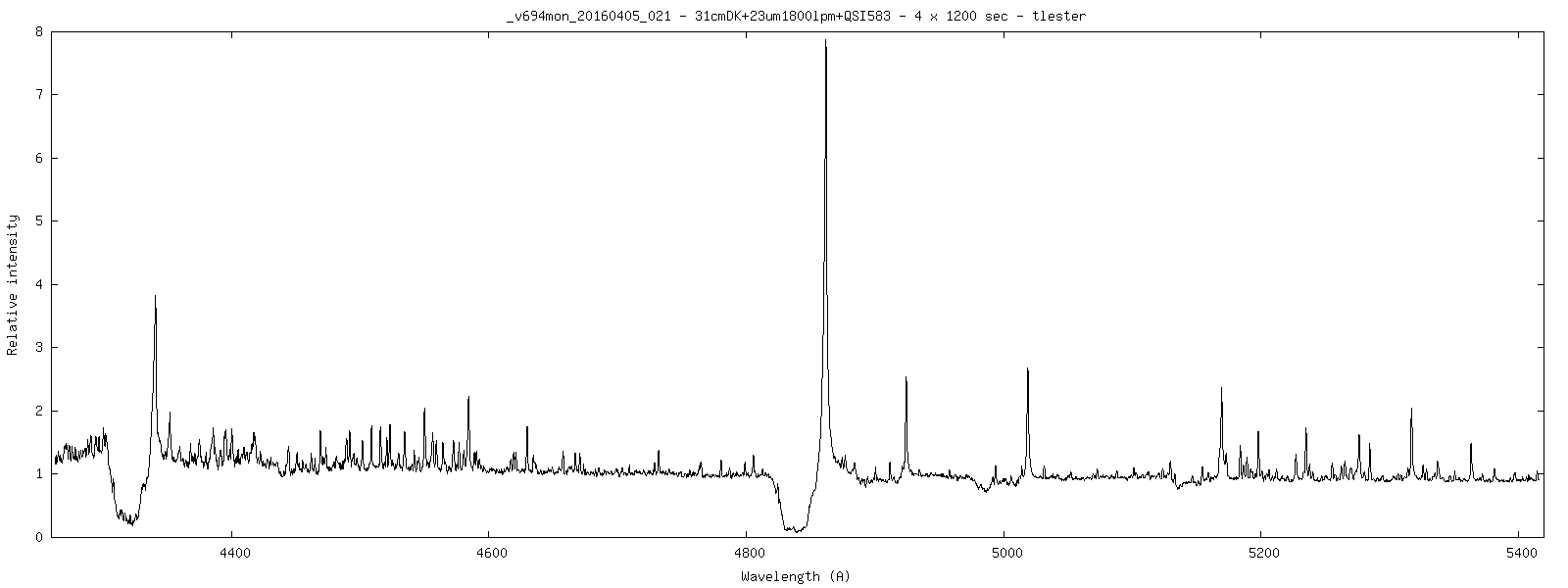

Here is my spectrum for Apr 5, centered on Hbeta at R=6000.

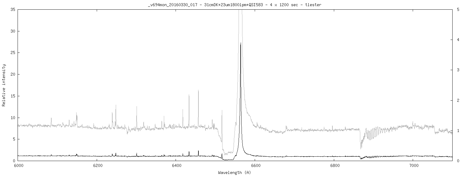

here is my last spectrum taken a week ago. After a couple of weeks with no observations, I could take this one. Finally, I have learnt how to present the graphics with ISIS, much easier than with Vspec.
Outstanding all the work you are all doing!
Greetings
Fran
Greetings
Fran
