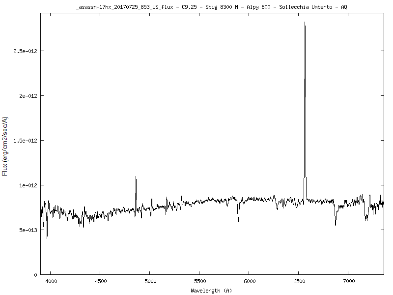

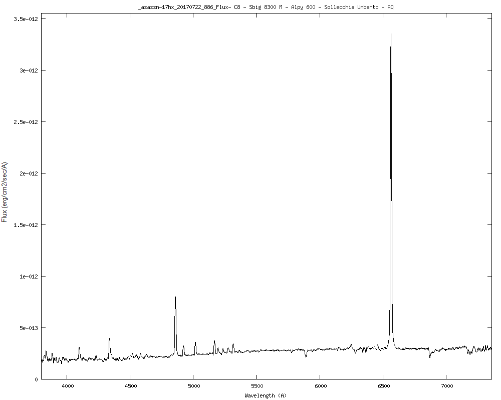

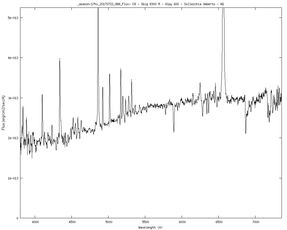

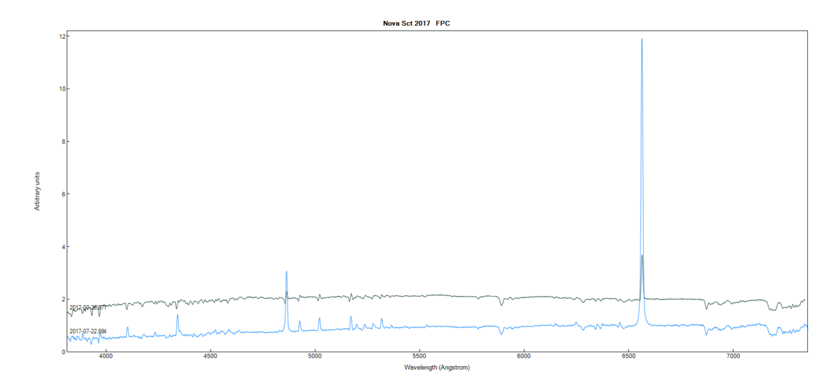

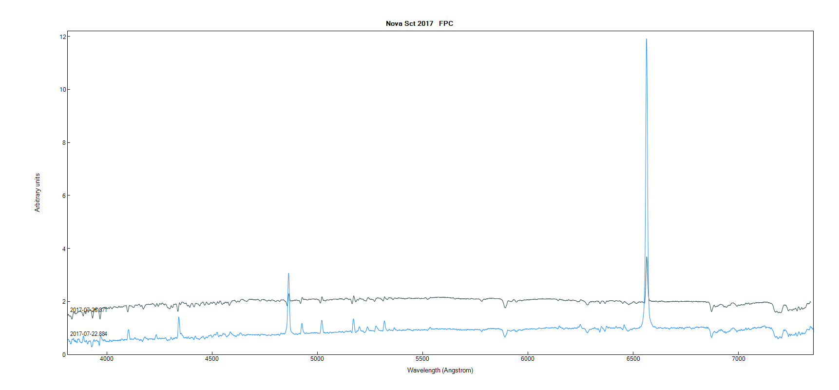

Bonjour à tous, le week-end passé, moi et Paolo Berardi nous sommes allés à un camping astronomique sur le Gran Sasso à 1600 mt. Dans la nuit du 22/07/2017,nous avons observé la nova aussì avec photométrie.
Voici le profil spectral calibré dans le flux absolu.
Profilo Nova Flux.png (11.21 KiB) Viewed 17129 times
Profilo nova flux 2.png (20.97 KiB) Viewed 17128 times

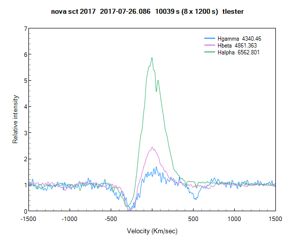

Post by Tim Lester »

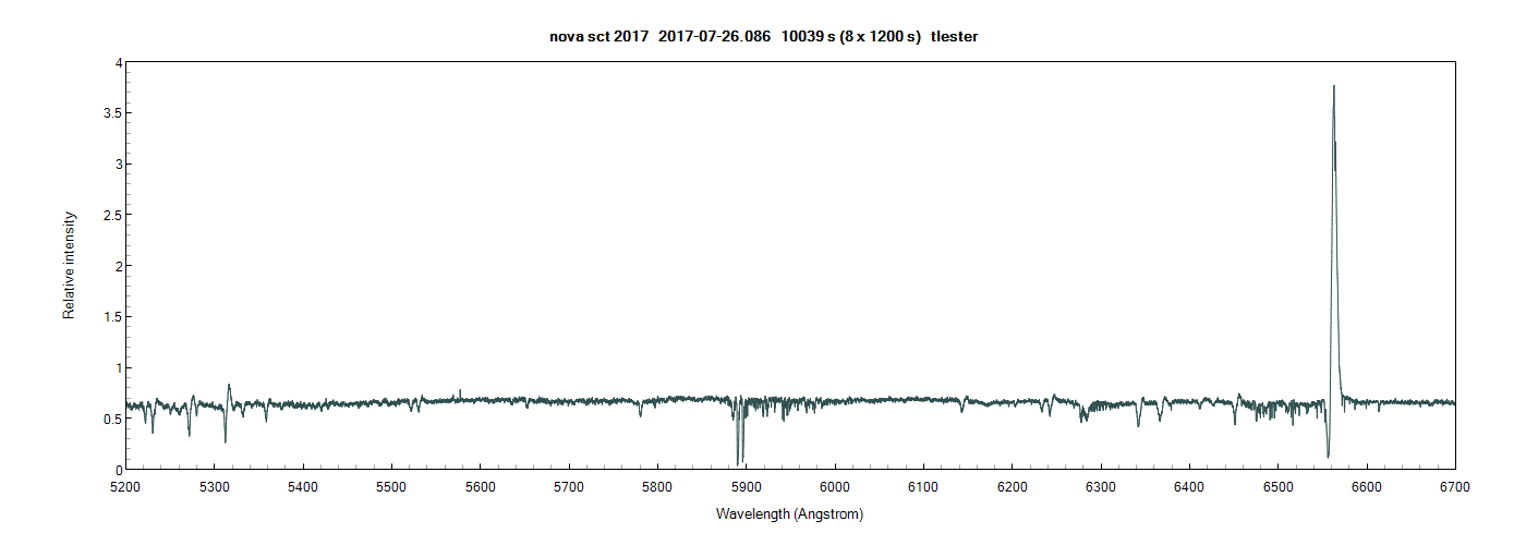

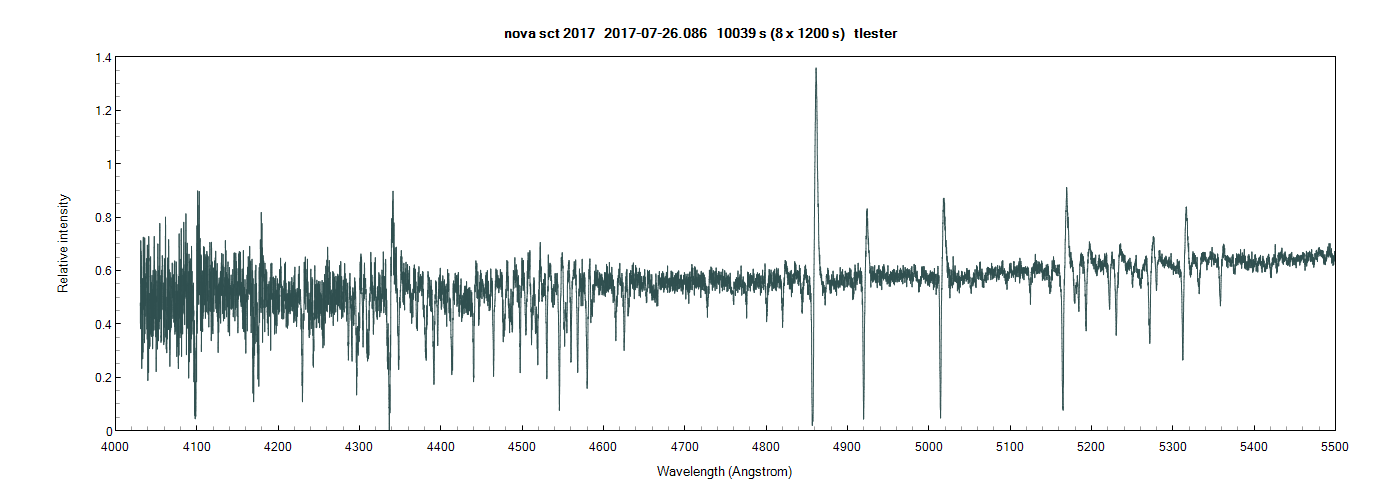

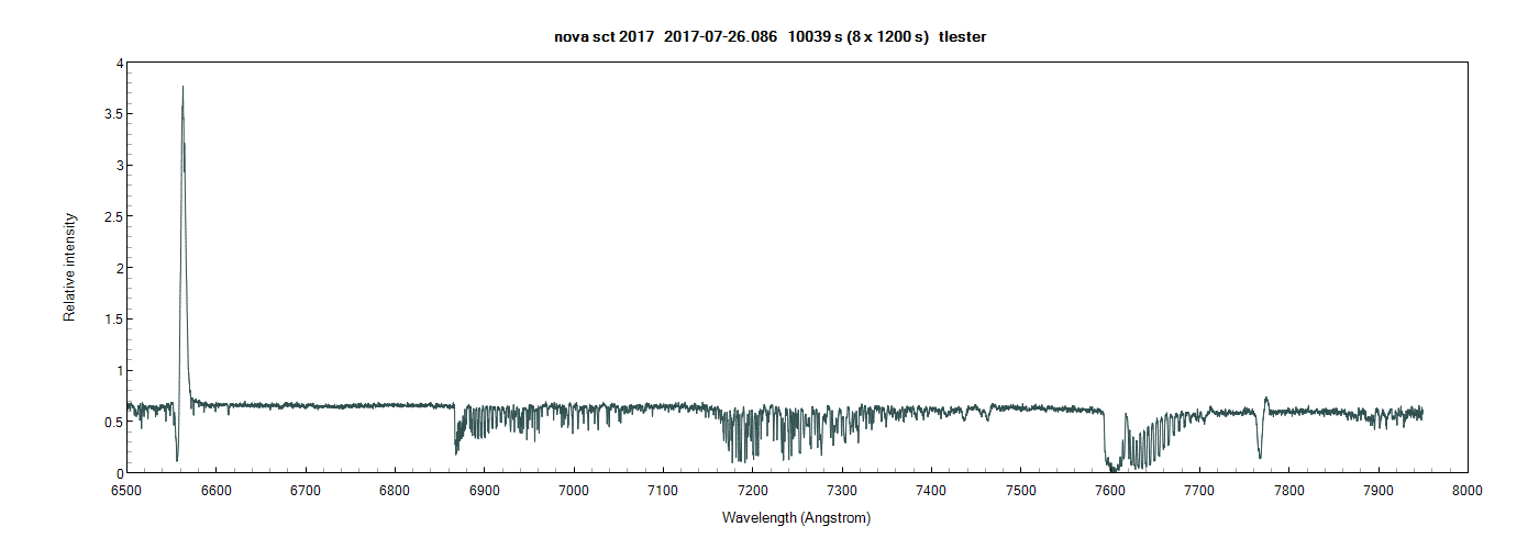

The nova has brightened significantly. Here is my result for July 26 with my new echelle.
Hi all! Fran, thanks for your comment. Very nice echelle spectrum Tim! I can confirm the extremely high brightness of the nova. Yesterday I measured V mag 9.15 at ~ 21 UT. Even with 1200 l/mm grating, the continuum is very intense and shows clearly the telluric lines in the H-alpha region (removed in the plots below).
Absolute flux calibration is obtained by rescaling the continuum to a low-res fluxed spectrum taken by Umberto (Alpy 600) at the same time.
H-alpha P-cyg profile changed again. The double absorption minimum seems gone. The heliocentric velocity of minimum is ~ -305 Km/s. The same measurement for Si II doublet return ~ -220 Km/s. Fe II 6456 Rv is ~ -235 Km/s.
Prof. Taichi Kato (who is looking at ARAS spectra, ref. VSNET ml), talks about a similarity of ASASSN-17hx evolution with the old nova V723 Cas.

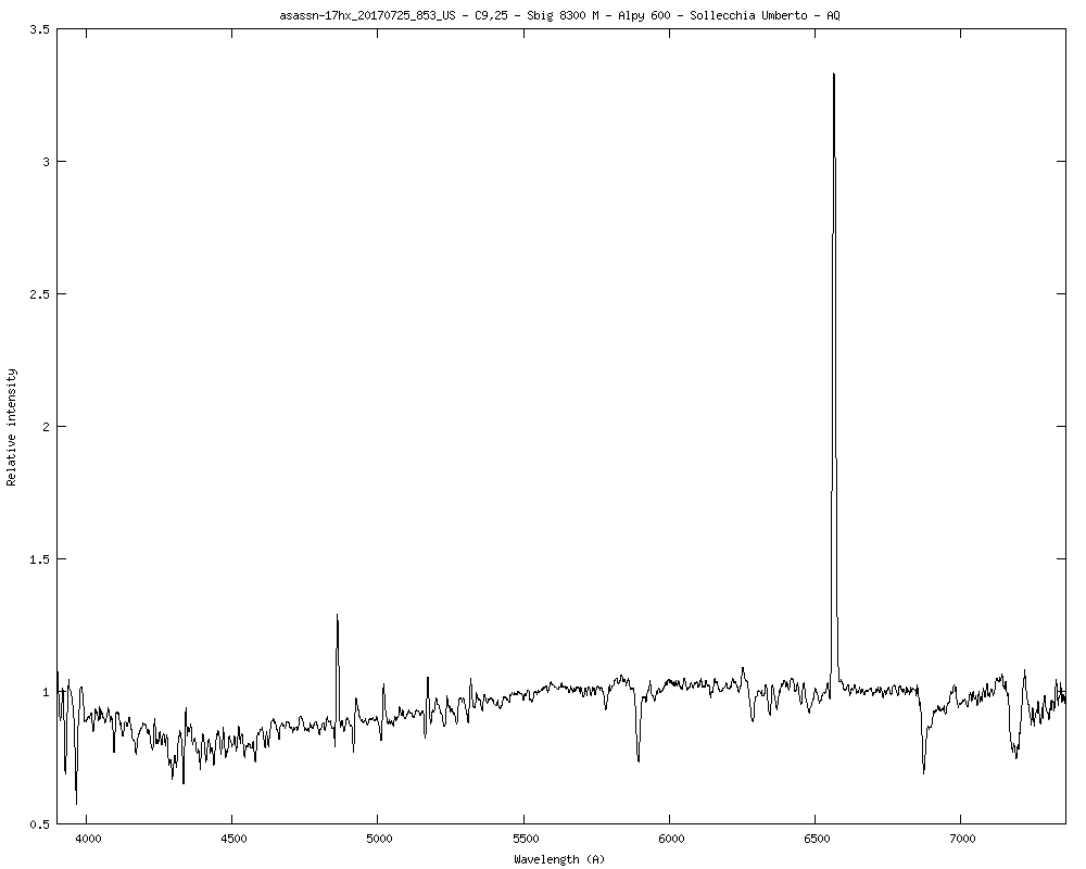

Post by umberto sollecchia »
Bonsoir, hier soir, je remarquai la nova. Voici deux profils, le premier calibré flux absolu 12x360, et l'autre 23x360, en intensité relative parce que la photomètrie ne couvre pas tout au long de l'intégration.
Profilo nova flux.png (10.15 KiB) Viewed 17084 times
Profilo nova .png (9.18 KiB) Viewed 17084 times

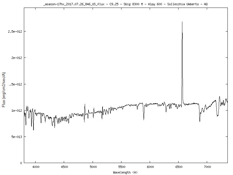

Posts: 248
Bonjour à tous, placez le profil d'osservazione de la nuit du 26-07-2017. La nova est encore augmentée par magitudine,maintenant mesurer 8,86.
Umberto.
Profilo nova flux.png (9.8 KiB) Viewed 17044 times

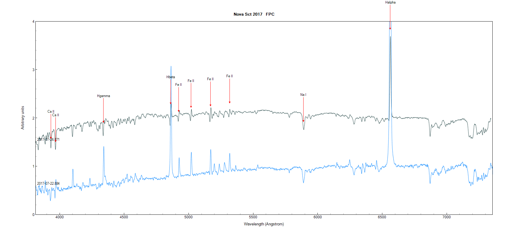

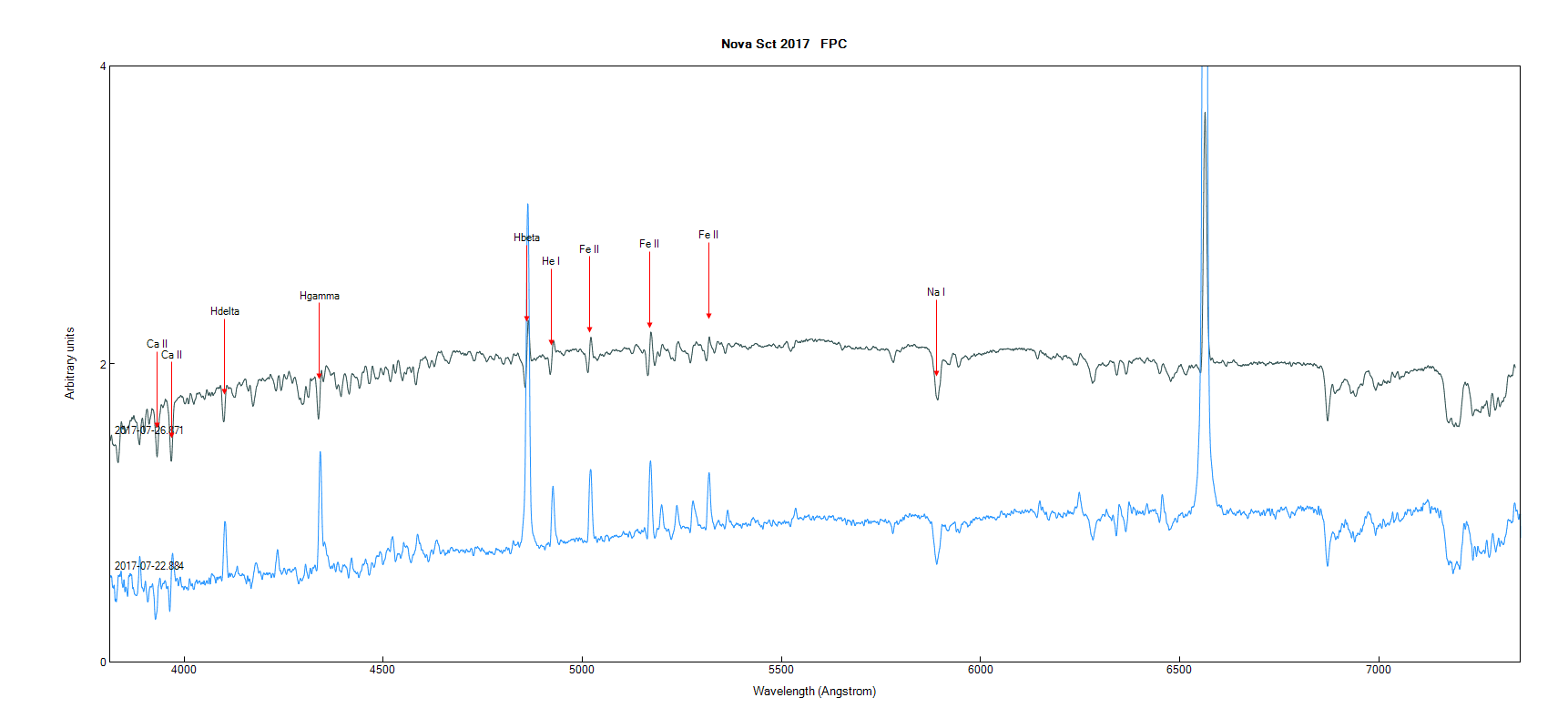

Very interesting all the spectra.
Here is a comparison of two spectra, from July 22th and yesterday. The brightening began 3-4 days ago and the changes are dramatic!
Greetings
Fran
