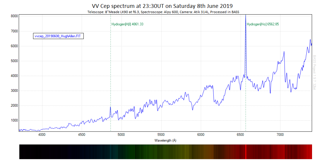

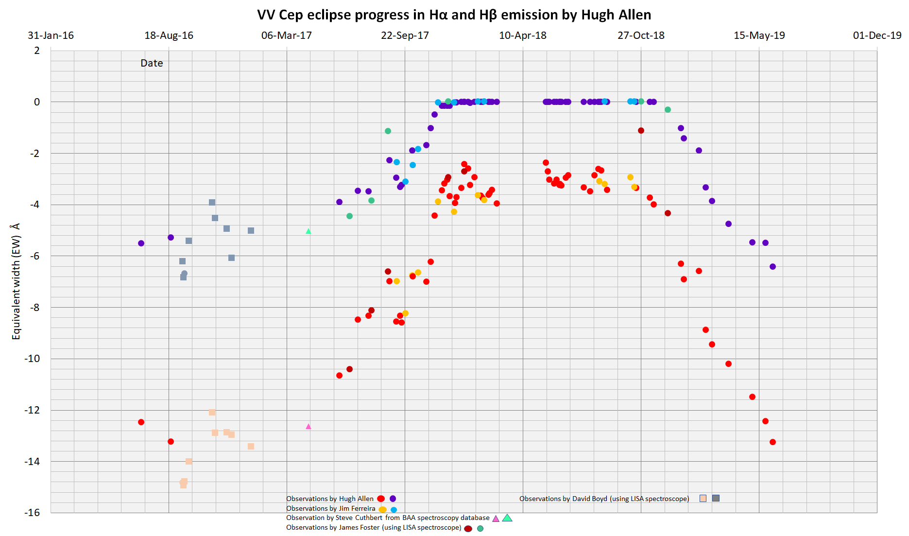

Latest update on the progress of the VV Cep eclipse. It looks like the eclipse of the Balmer emission region is fully over. I'll follow the star for another month or two in order to complete the baseline this side of the eclipse. Thanks to all those who allowed me to include their low res spectra in the analysis: Jim Ferreira, James Foster, David Boyd and Steve Cuthbert
Hugh

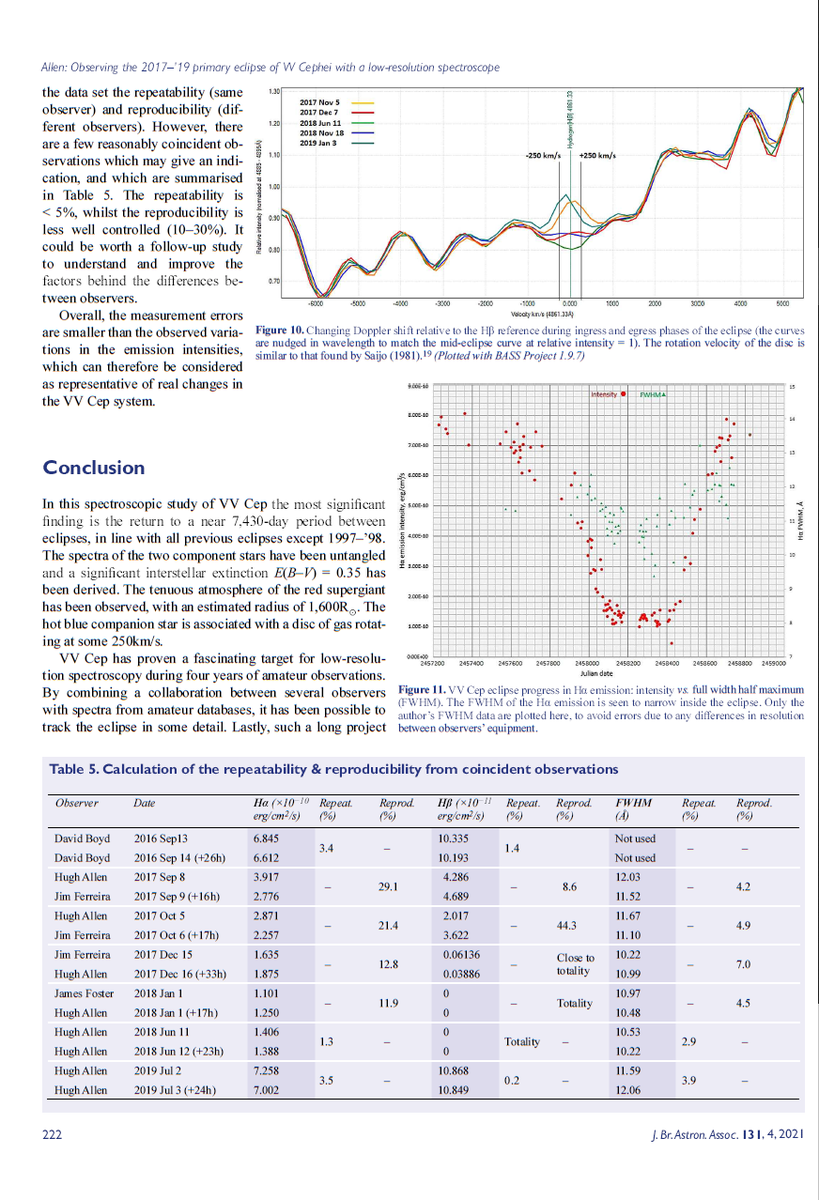

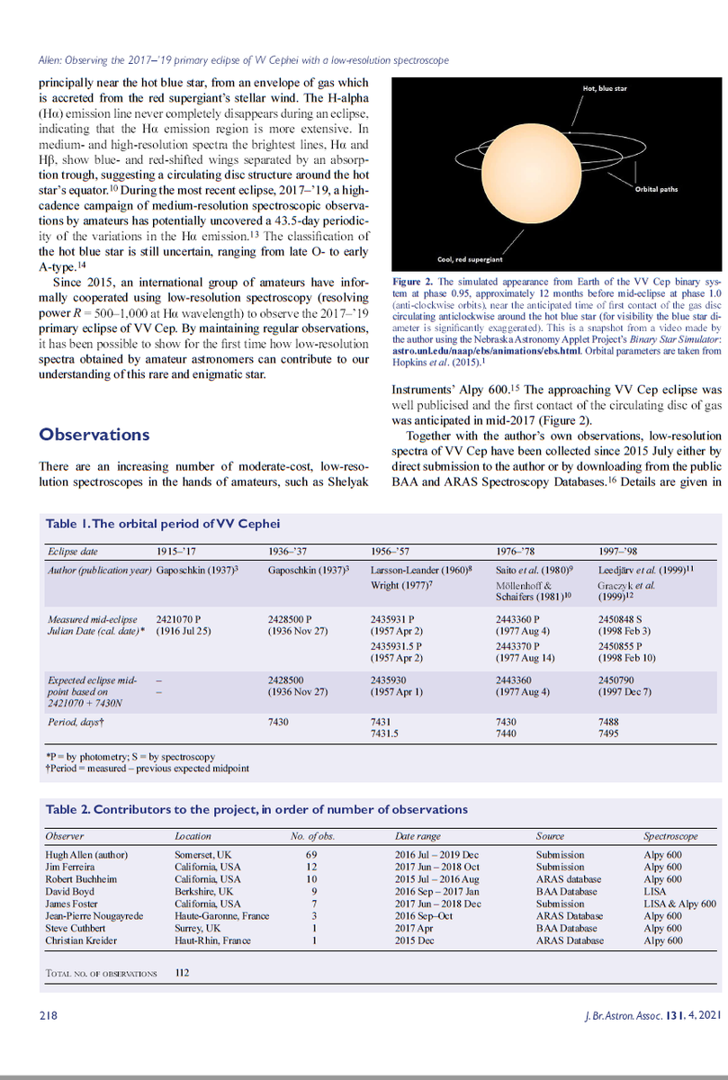

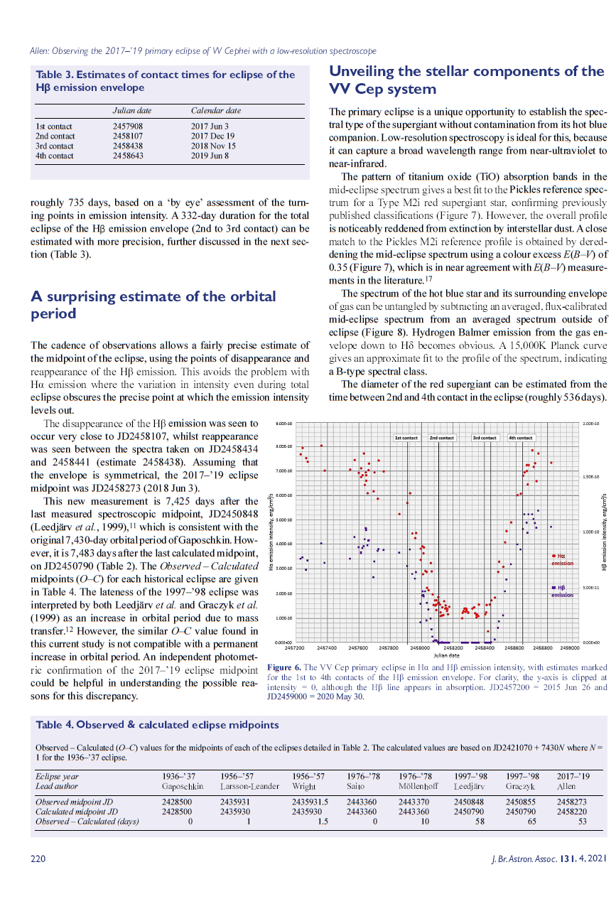

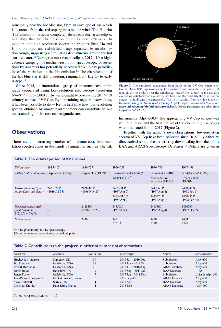

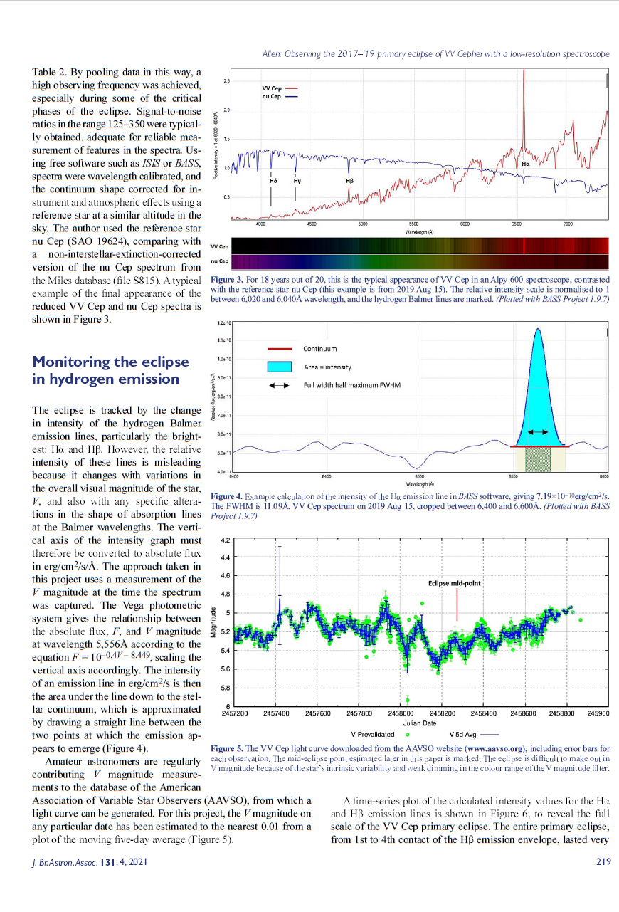

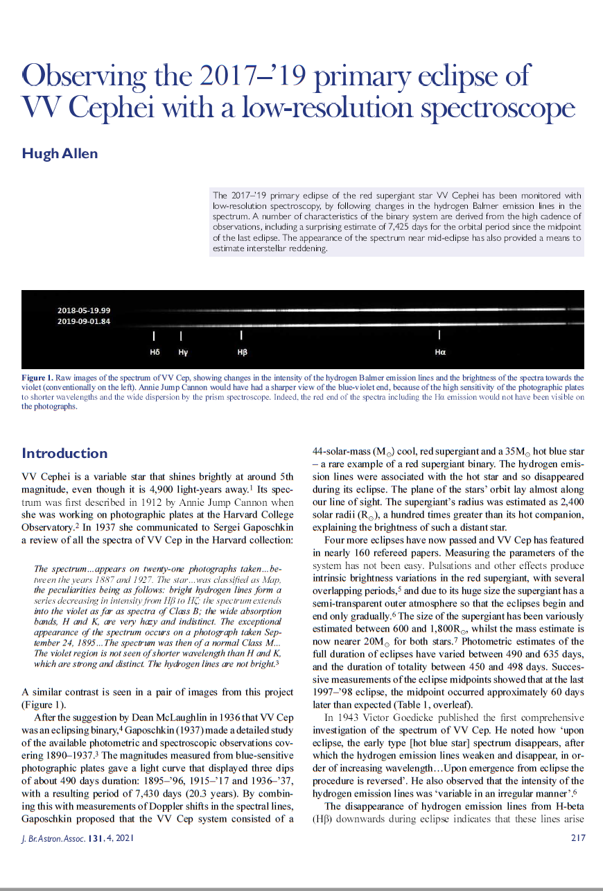

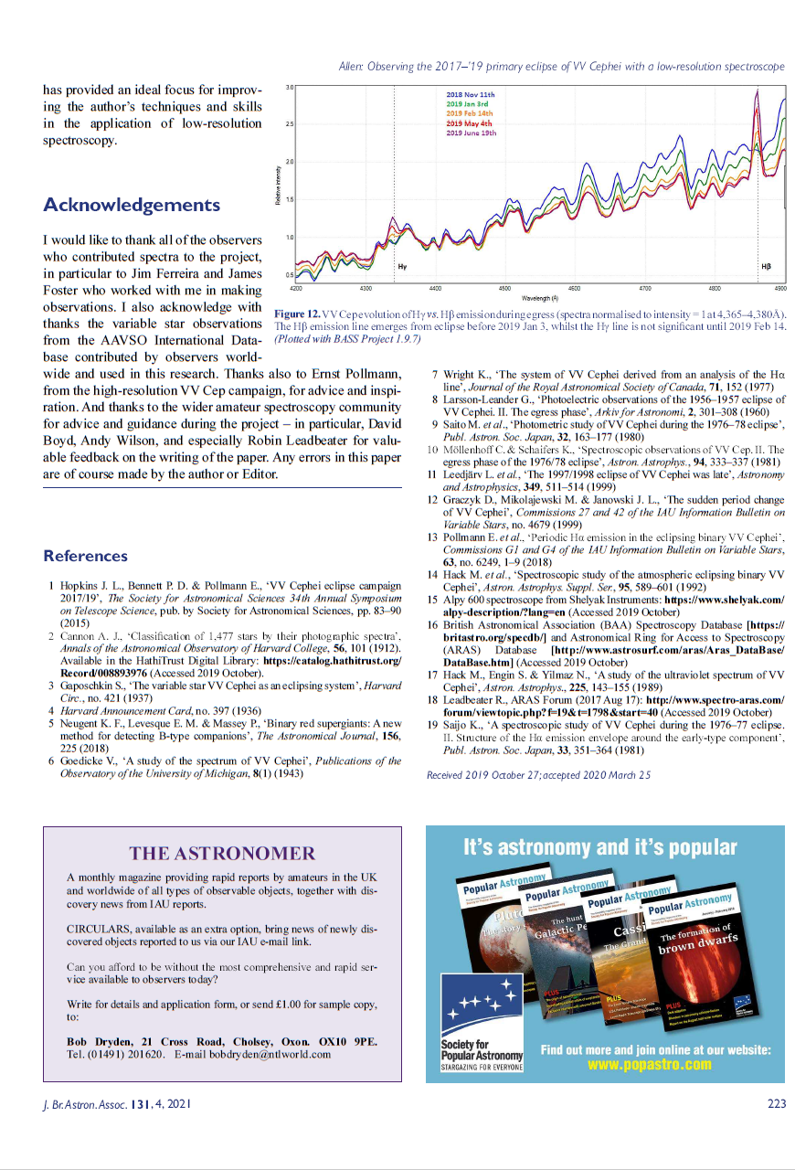

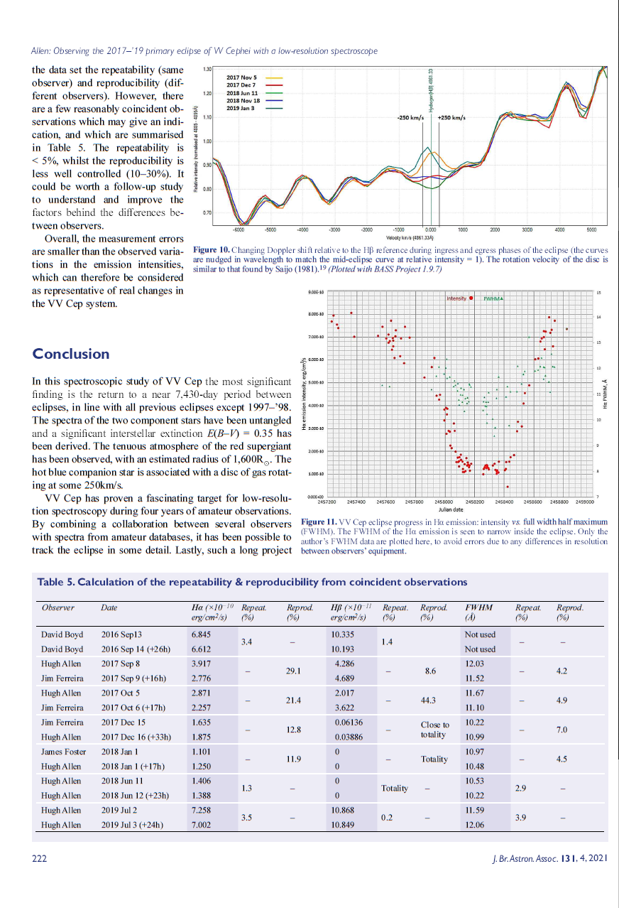

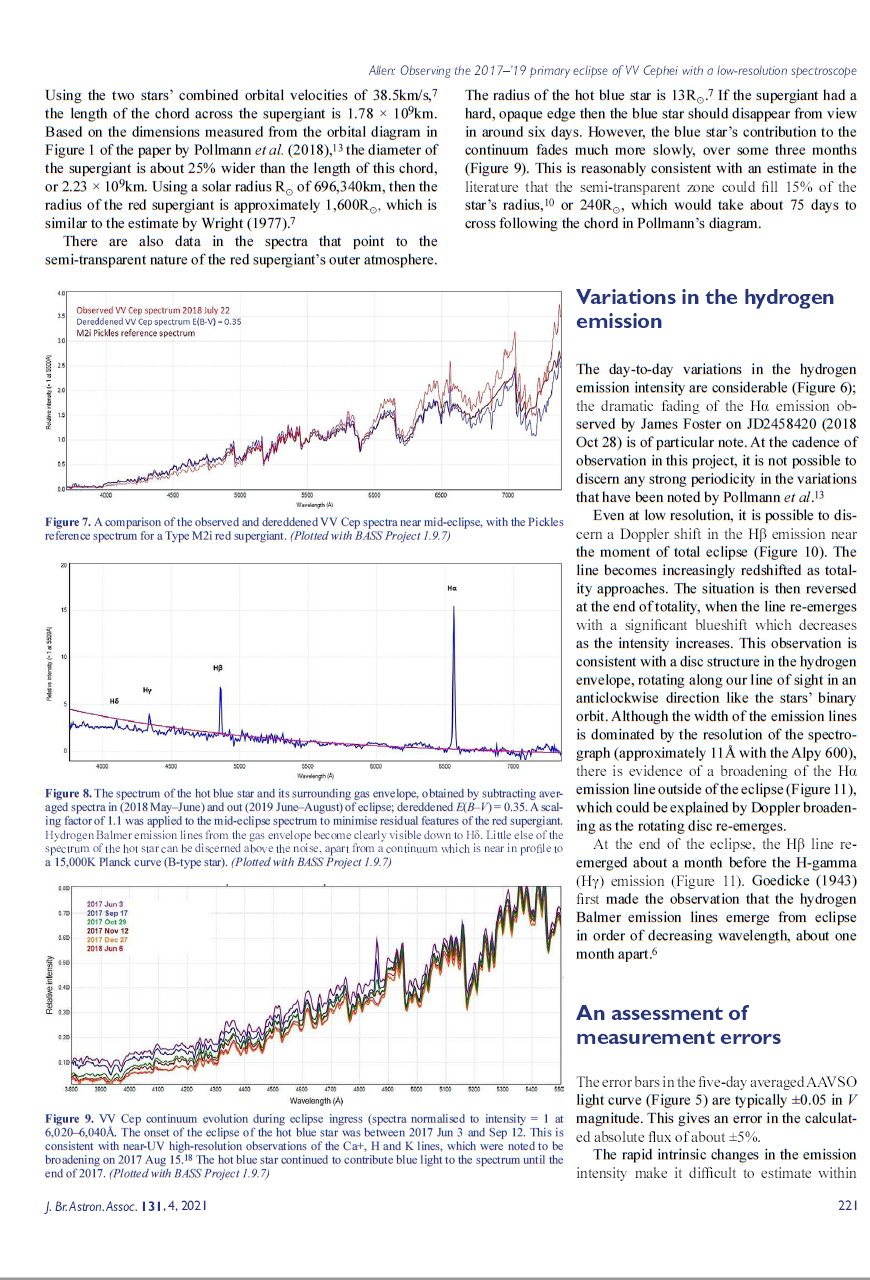

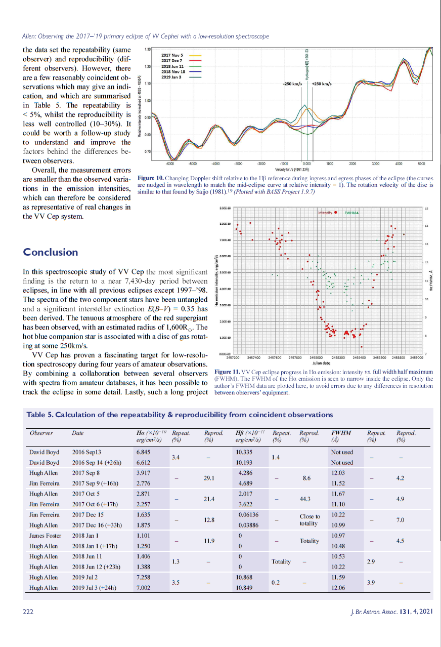

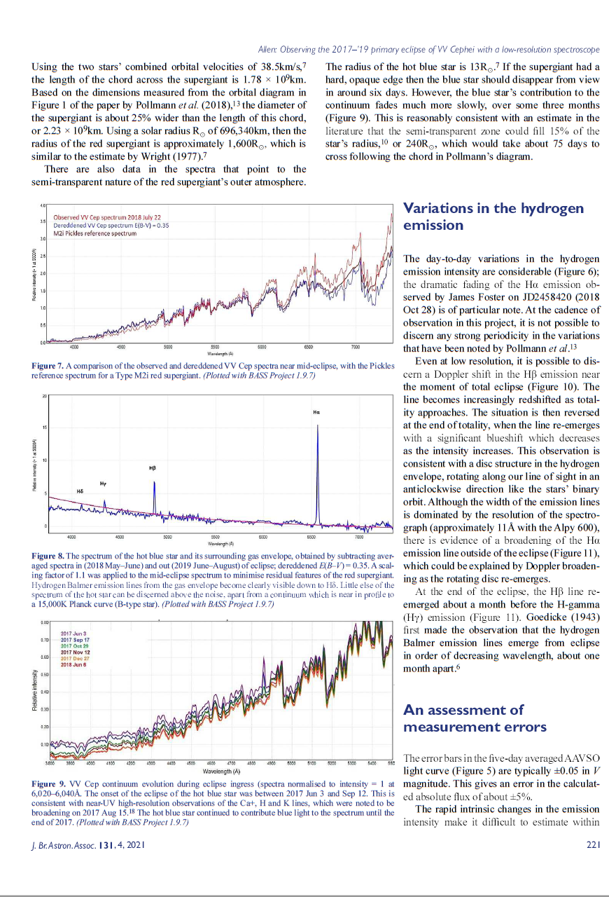

The British Astronomical Association has published in the August Journal my refereed paper on the spectroscopic evolution of the 2017 - 2019 eclipse of the red supergiant VV Cephei https://britastro.org/journal-full/26122
The BAA does a lot to encourage and support amateur spectroscopy, with mentor schemes, equipment loans and of course the BAA Spectroscopy Database. It's not possible to attach the paper here in pdf format so instead I'm attaching screenshots of each of the 7 pages of the paper if you'd like to read it. Apart from showing how much can be learnt from low resolution spectroscopy, the remarkable result from the study is the changing period in the orbit of the binary star which is quite difficult to explain!
Hugh

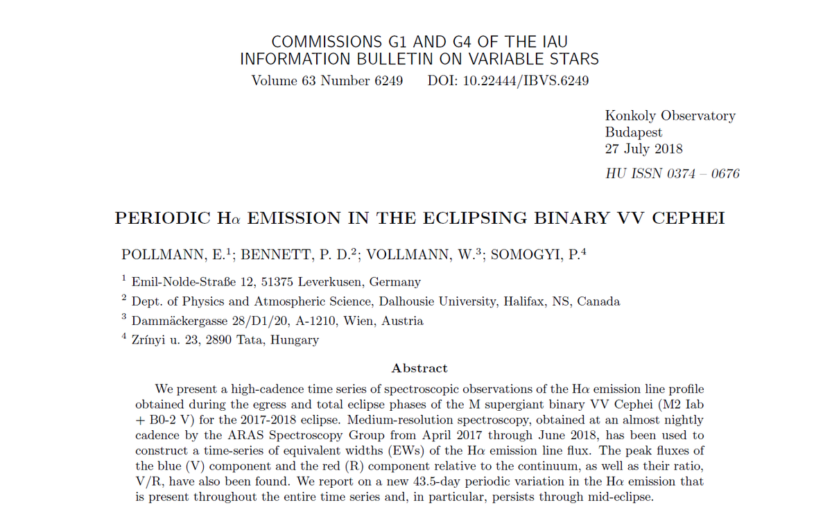

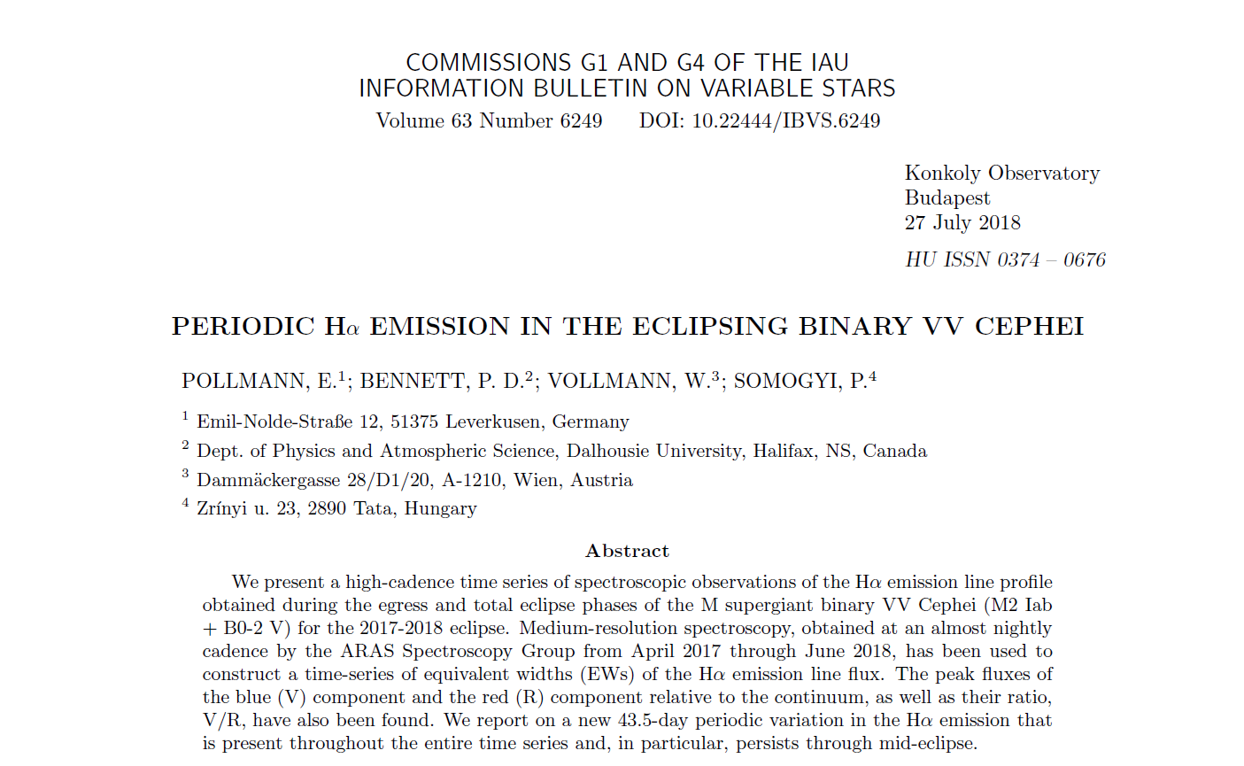

P.S. This is a screenshot of the abstract of your paper in reference 13

Hi Hugh,
sorry, you are right. The periodicity of 43 days of EW and line flux has been published in two paper, whereby its character have been described more in detail in the journal of AAVSO.
Here my email address:
ernst-pollmann(et)t-online.de
Ernst
