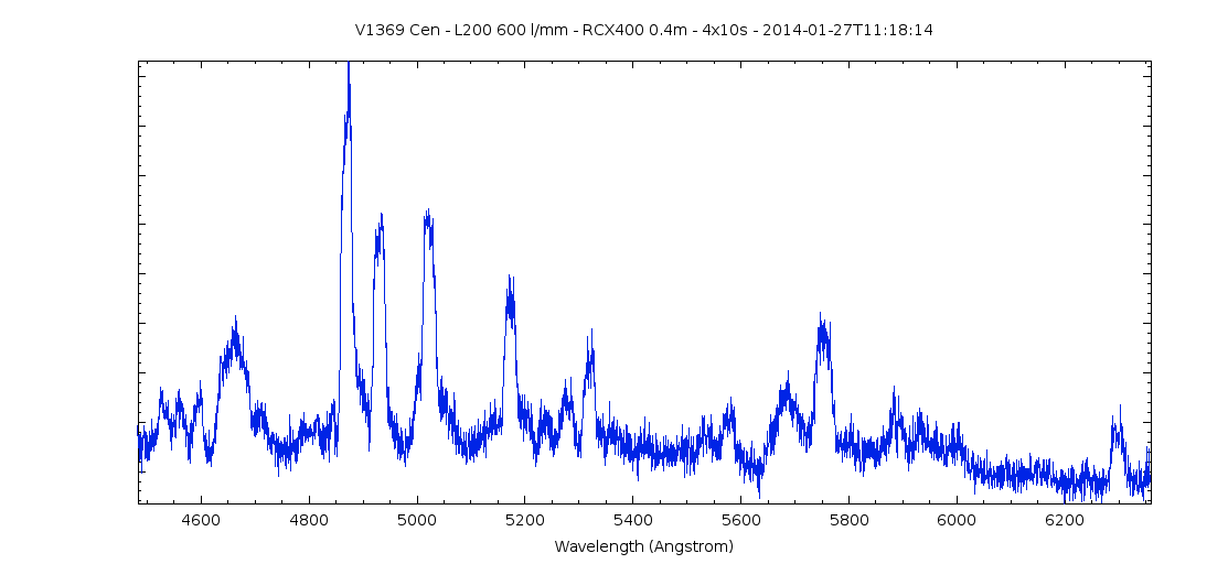

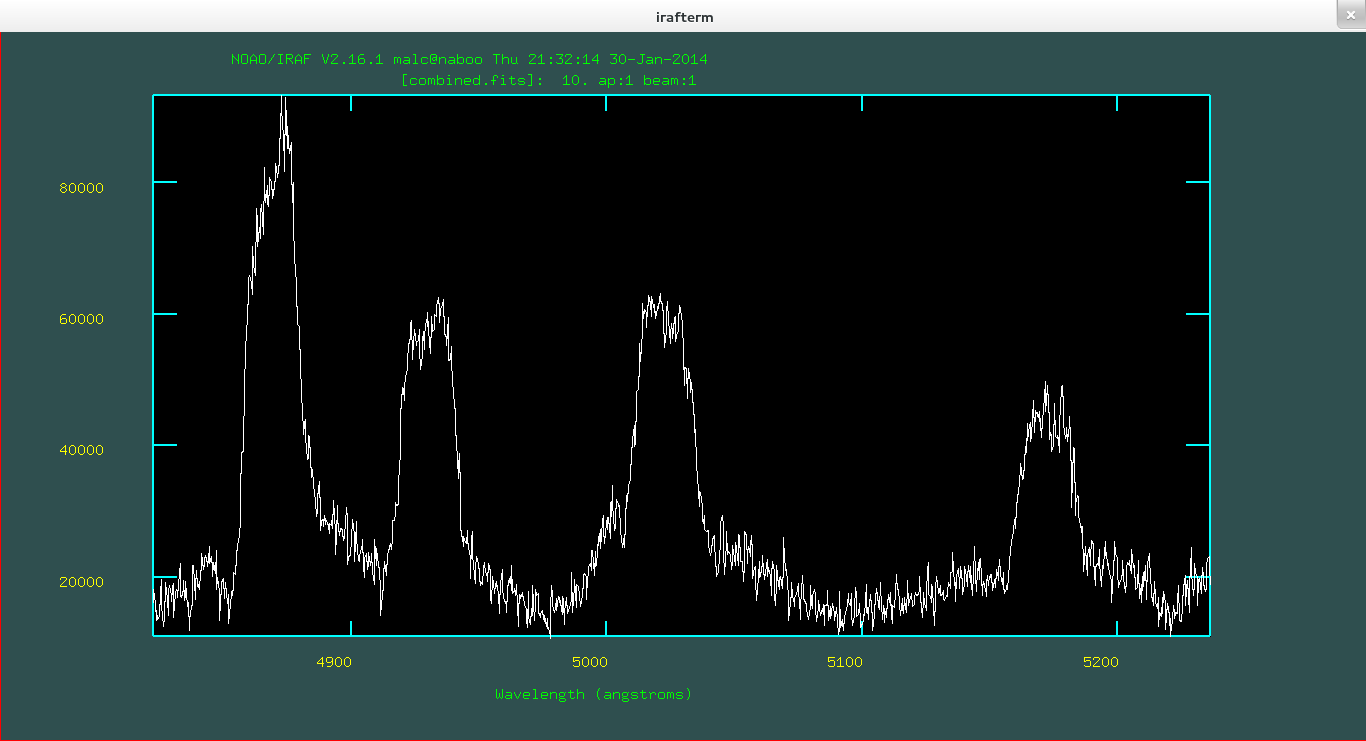

Some belated results from the 27th Jan. Terribly noisy I'm afraid. Still no guiding and I tried to narrow the slit gap slightly which made things worse, plus battling with various other technical issues. Shame as it was an incredible night down here, best we've had in months.

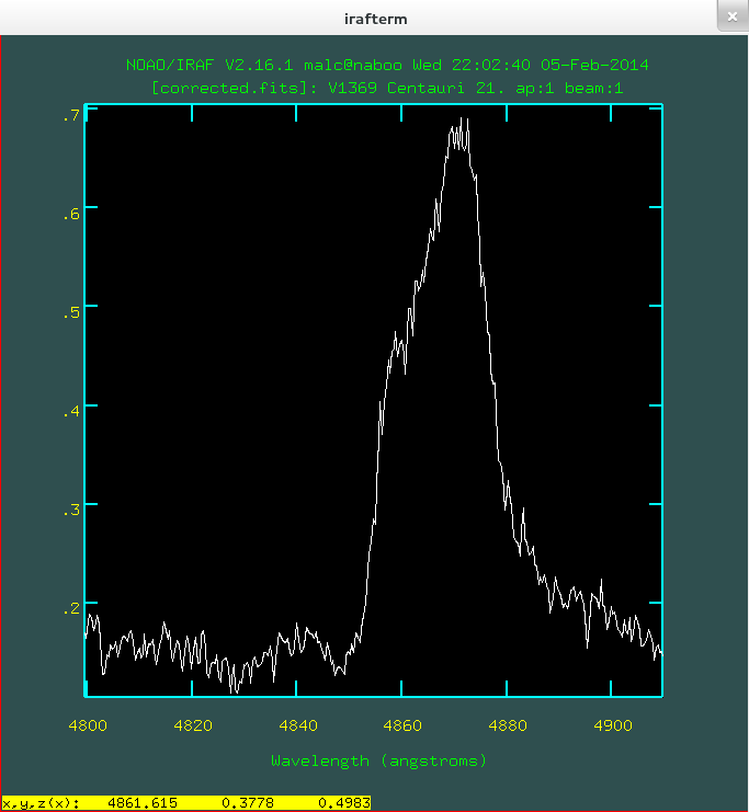

Close up of Hb an the FeII lines.

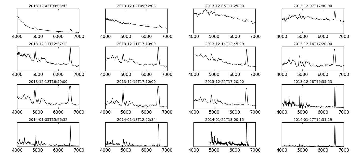

Post by Malcolm Locke »

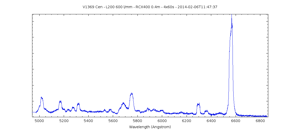

Finally got around to writing a python script to plot a grid of spectra. Here's all of the low / medium resolution spectra for the nova that are present in the ARAS database. Spectra are from myself, Jonathan Powles and Terry Bohlsen.

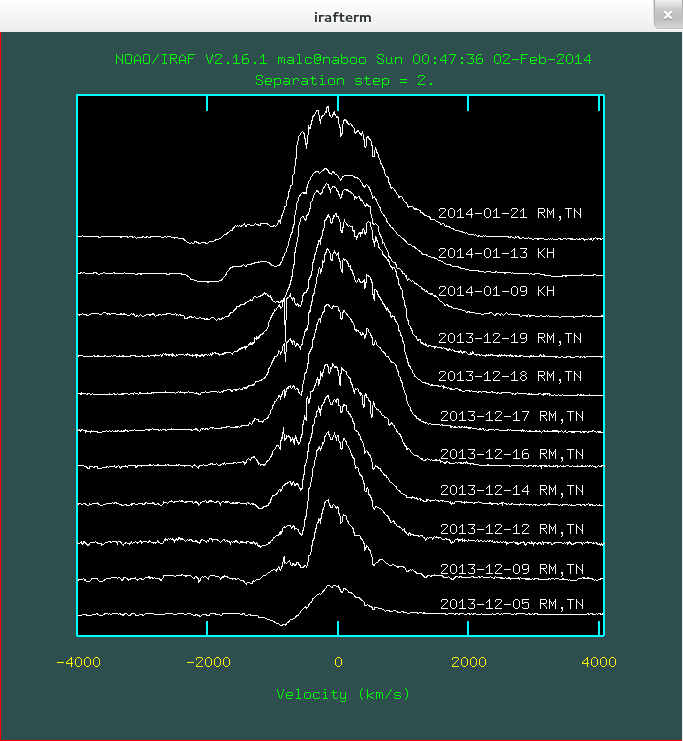

H alpha velocity evolution to date. There is a large gap in the sequence between 19th Dec and 09 Jan, hence the
pronounced jump in velocities and line width at that point.
Thanks to Rogerio Marcon, Tasso Napoleao and Ken Harrison for providing the data in the ARAS database.

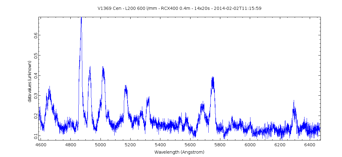

Another dodgy effort from Feb 2nd. I left my t-ring at home and had to use a different one so the imaging camera focus was off :(
Can still just make out the asymmetric shape of the H beta line though.

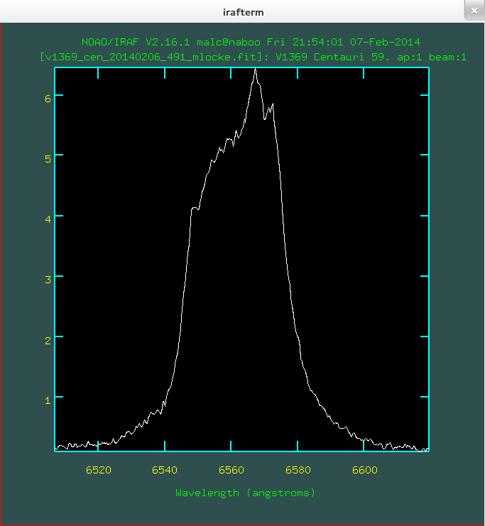

My best result yet, from Feb 6.491. A huge thanks to Andrei Cotiga from Canterbury Astro Society for helping me to get guiding working.
Some structure showing in the H alpha line.

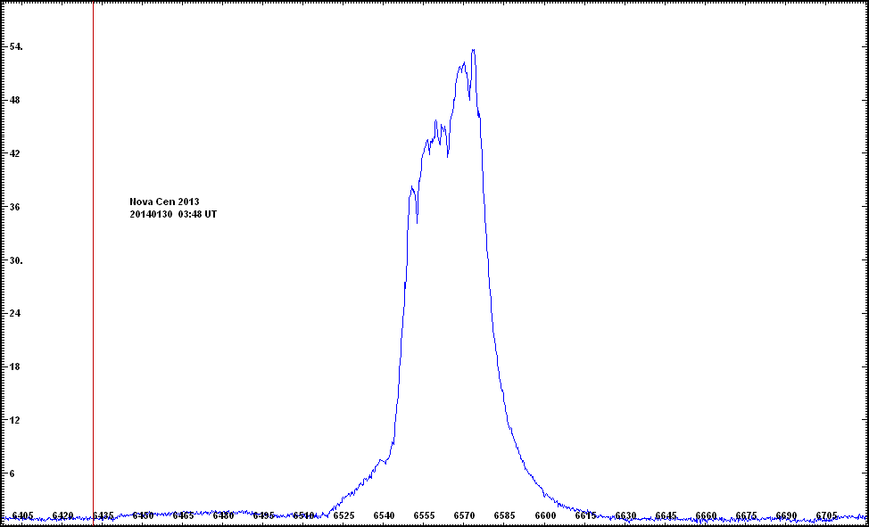

Below is our last profile, made on Jan 30 with a 2400 l/mm grating. I believe the line structures are quite the same perceived on Malc´s spectrum. Also, the trend for brightening, already pointed out by Terry on Jan 28, seems clear.
